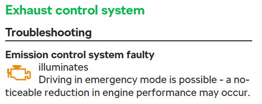

Is it this light?
Unfortunately it does say that you can continue driving with the light illuminated...
