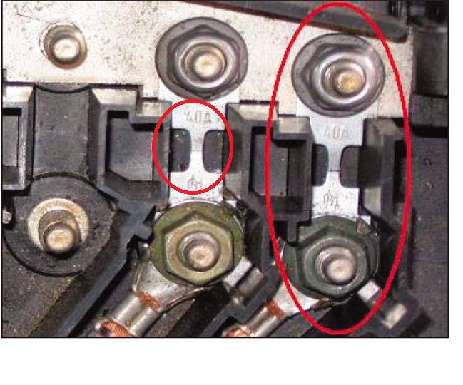

It's worth checking the strip fuses on top of the battery as they can develop very hard to see cracks which can make intermittent connection.

thank you for this suggestion :) will ask them about that too!

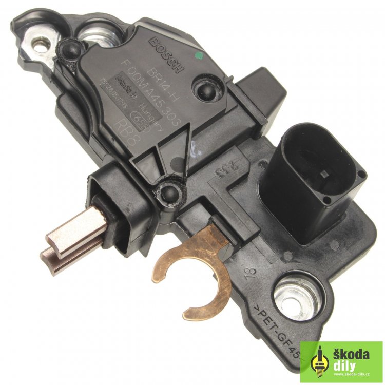

Hello @SophieMilne, I would suggest checking voltage, amps and resistance through the electrical system under load. When  my voltage regulator failed, I experienced the symptoms you describe. If that little guy is toast, your new battery won't last long -I know because I had to replace mine just a week after the fact. Of all the things they changed at the garages, this contraption would help the most, at least that was my case.
Before I replaced the voltage regulator:
-ABS and ASR stopped working: the strip fuse was blown for no reason (brake fluid was OK, tyre pressures OK, etc).
-Power steering stopped working while the car was running, especially at idle. Wouldn't come back unless I restarted the car.
-Speaking of restarting the car, since the voltage regulator was toast, the battery would discharge completely WHILE THE ENGINE WAS RUNNING so restarting the car after a power steering failure wasn't an option, except on downhill or towed.
Replaced the little fellow, haven't got those failures ever since.

Hi Juanse_2691 - this sounds EXACTLY like the problems I have been having! Thank you so much - will show this to the garage! :)
