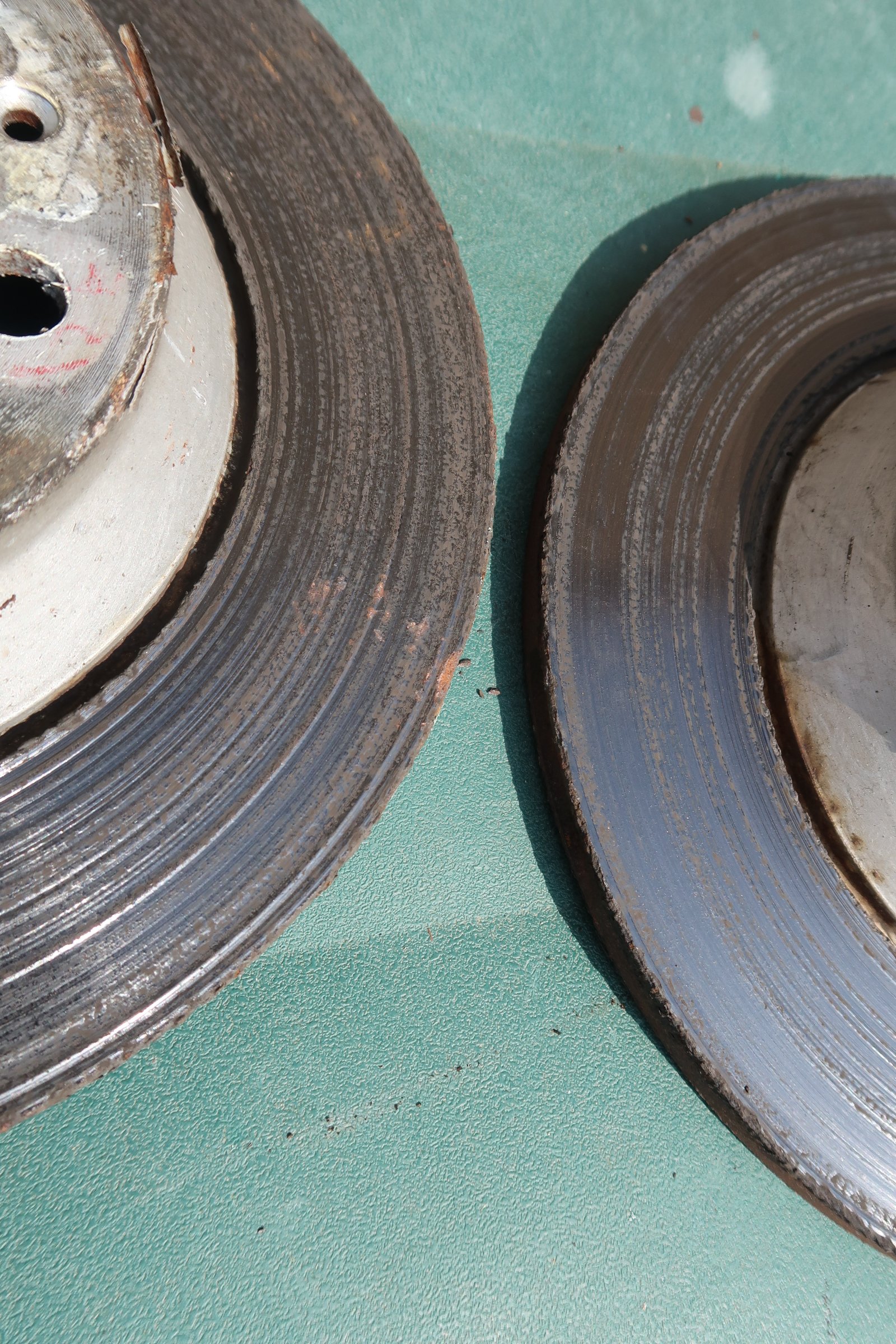

I recently changed mine @ 52K miles, they had started to wear unevenly (grooves) from around 2K miles old.
I went for Brembo discs and pads as the discs have a UV coating on them to prevent rusting (the silver ‘hub’ part not the pad area)
These were the 52K mile old discs I removed :o :
The Brembos 2K miles in:
I wouldn’t hesitate to use the Brembos again.

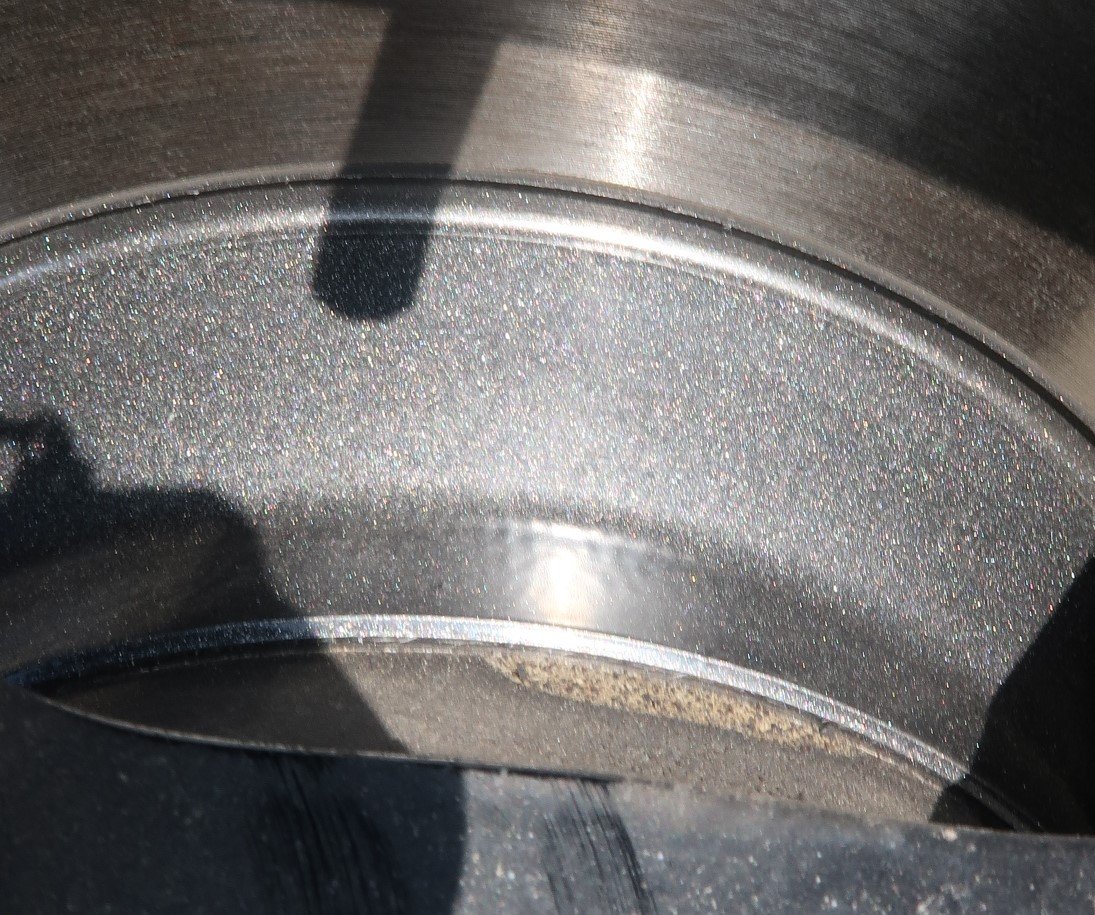

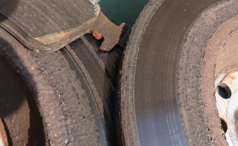

The pictures below are my old 25k mile rear discs.  At the last service on 14/1/2019 at 23.3k miles the "Vehicle Health Check"  advised  that "Rear Disc/Drums Condition" as "Visually OK" .  I raised the  issue of the rear disc condition when booking the service and when dropping the car off.  Skoda's servicing schedule doesn't involve removing the wheels - is this acceptable?
Inside faces
Outside faces
Finally - the "paint" finish on the replacement Brembo discs
Are these horrible original ones TRW (a member in the other thread said he’s were OEMed by them?) or ATE (skoda-parts.com lists them as one more OEMs apart from TRW and next to “Skoda genuine part”) or someone else?
If the discs are according to  Skoda "acceptable"  with nothing wrong with the braking efficiency why don't they look like that when the car is brand new . Why do the front discs not look the same after the same amount of mileage despite being used to provide more braking than the rear brakes..... answer.... because the rear brake discs must be made of inferior steel.

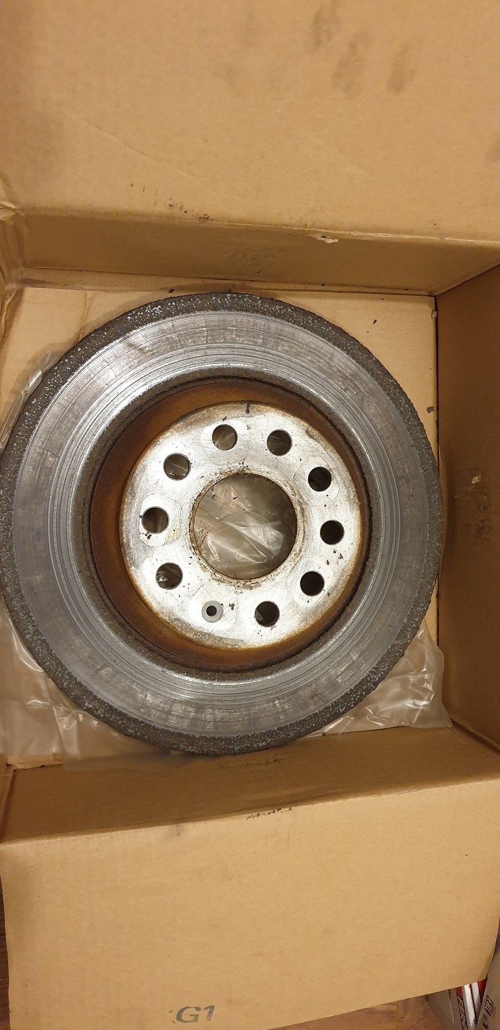

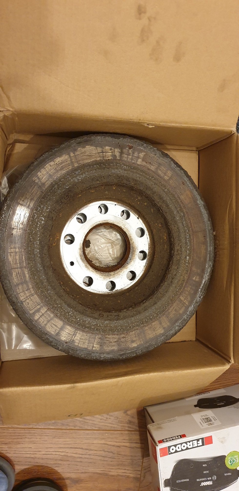

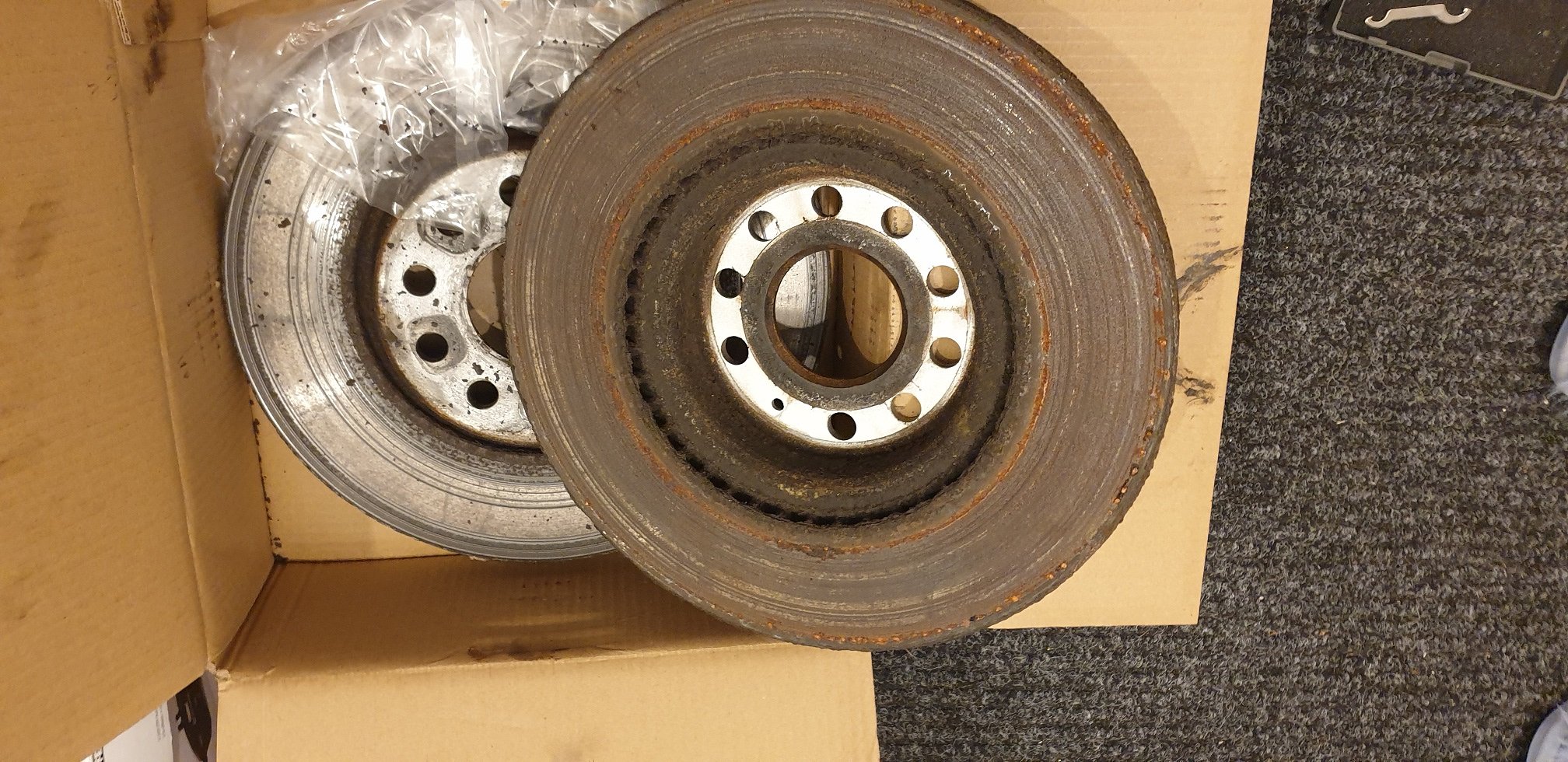

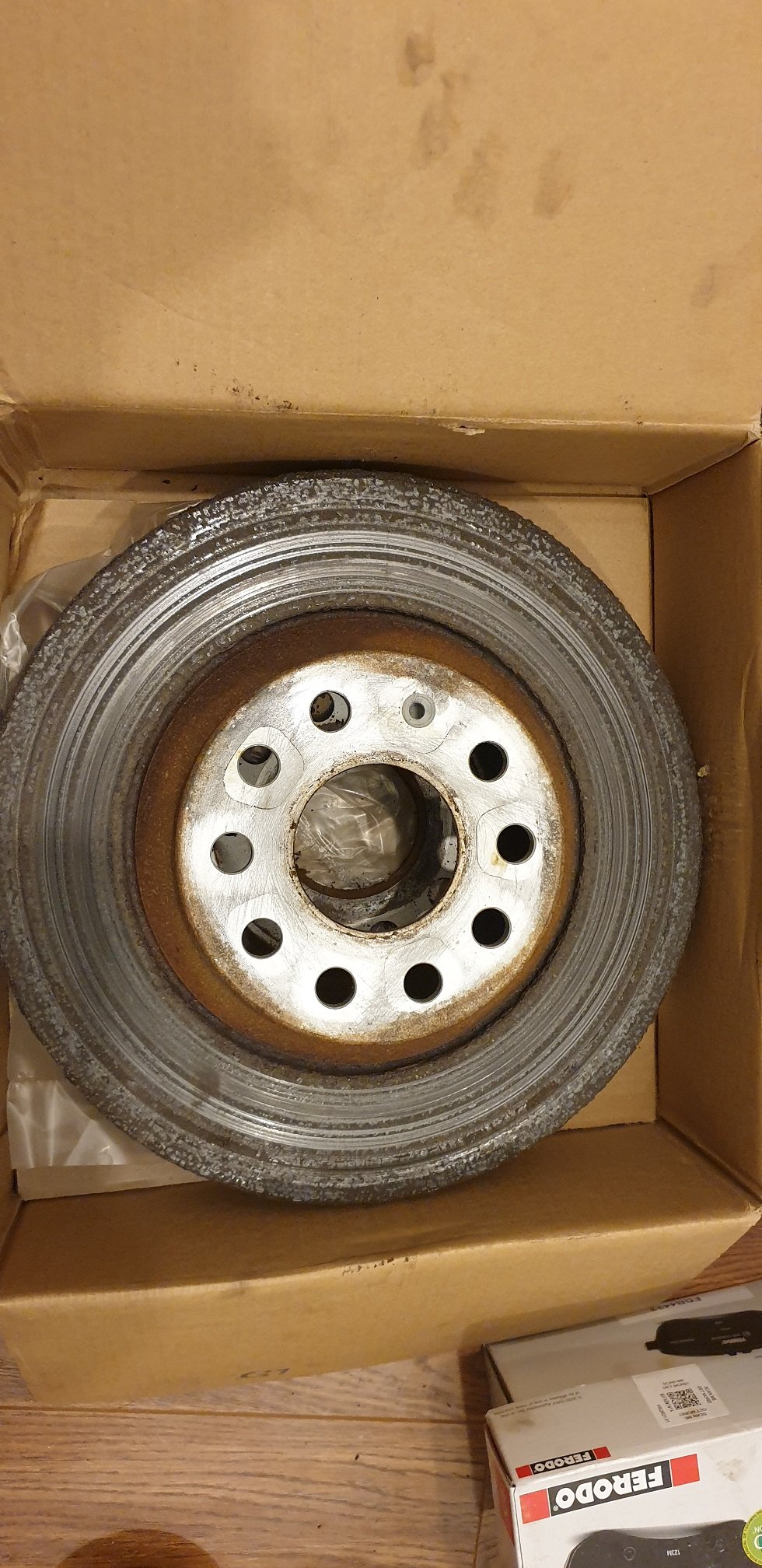

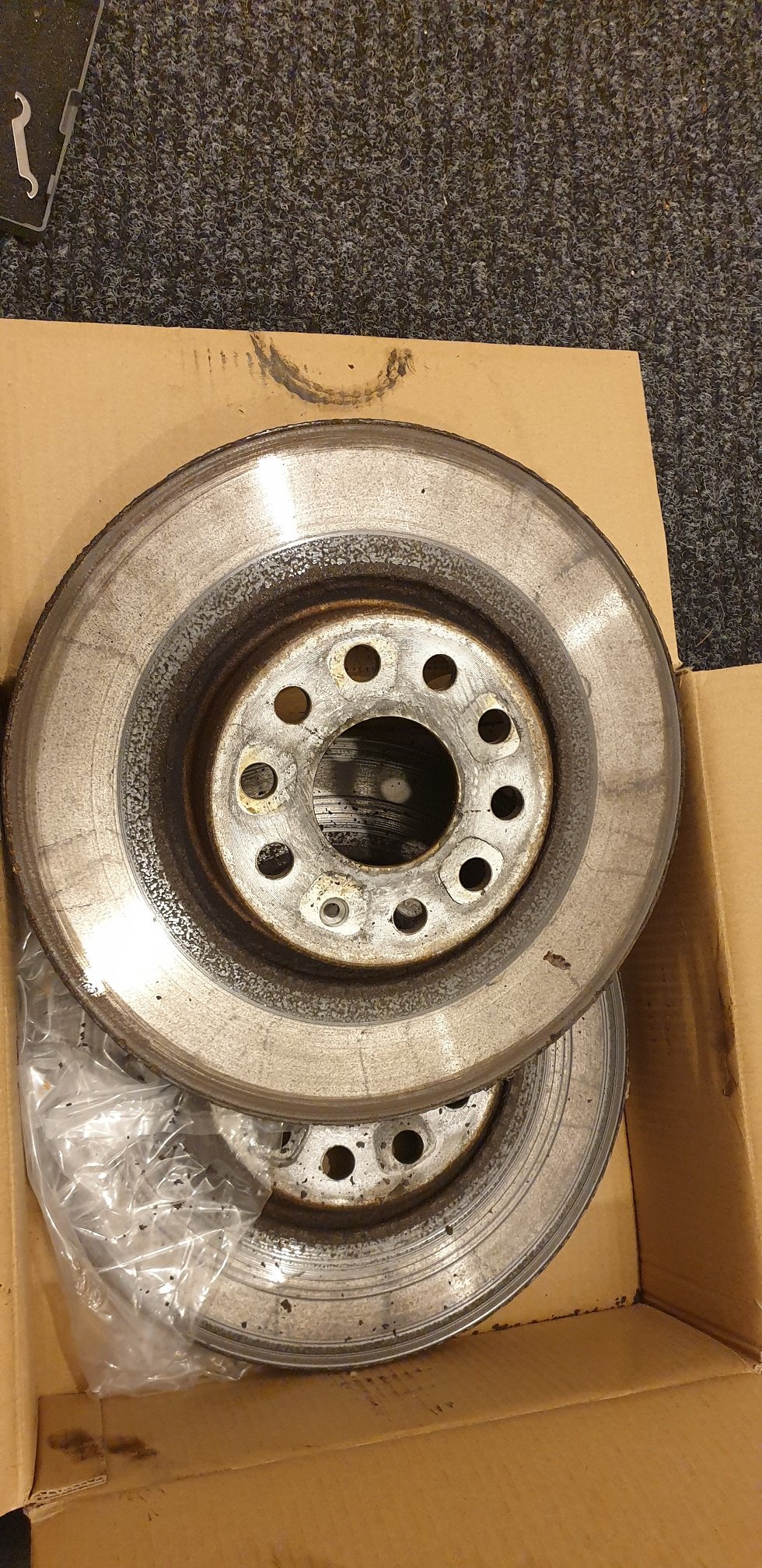

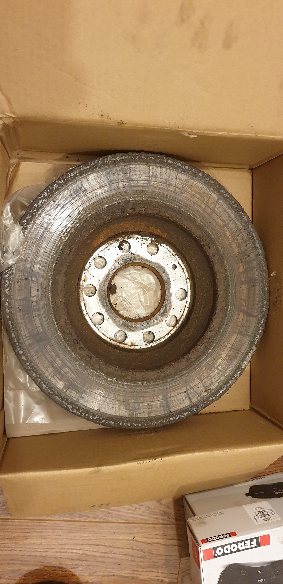

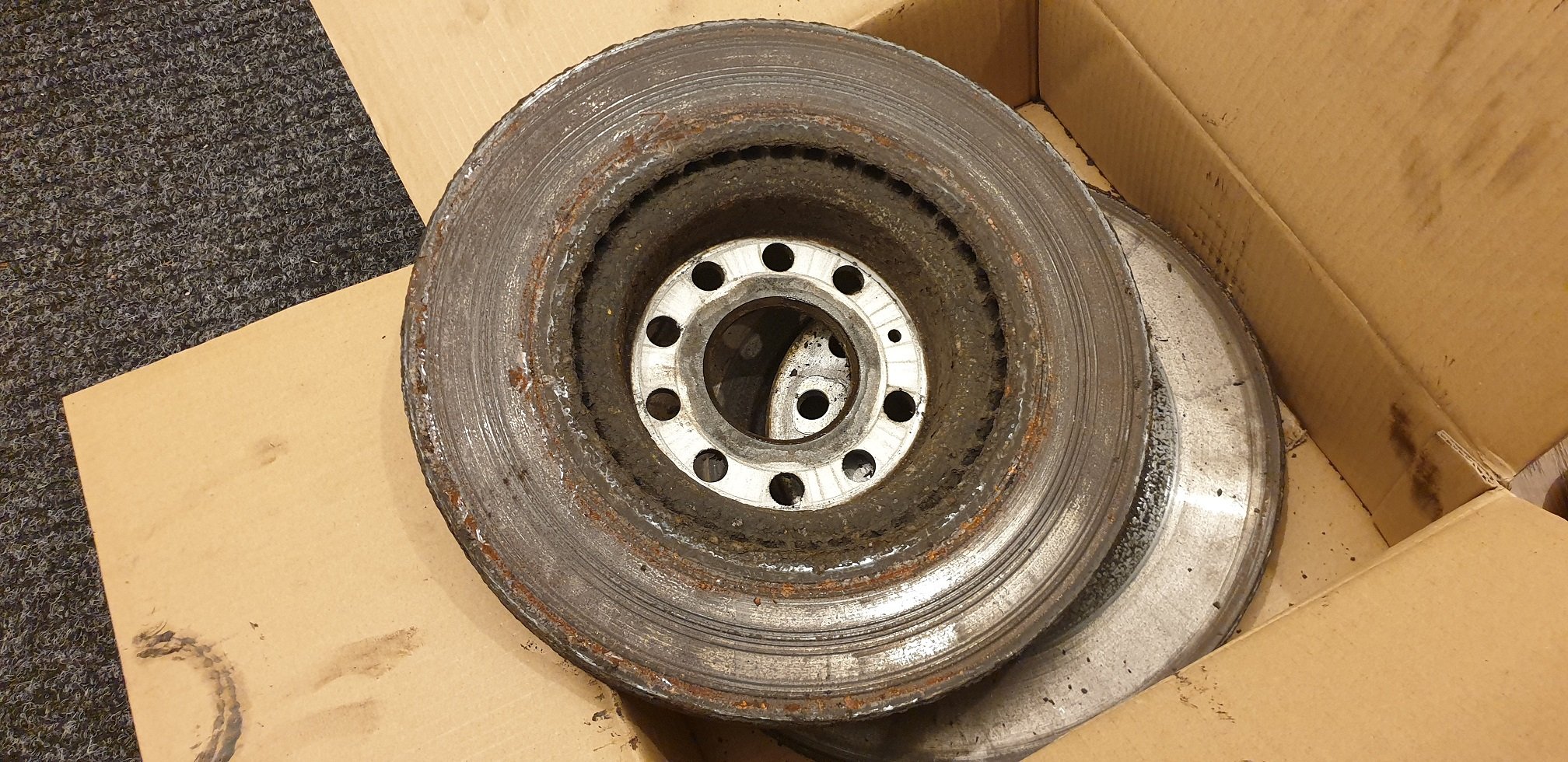

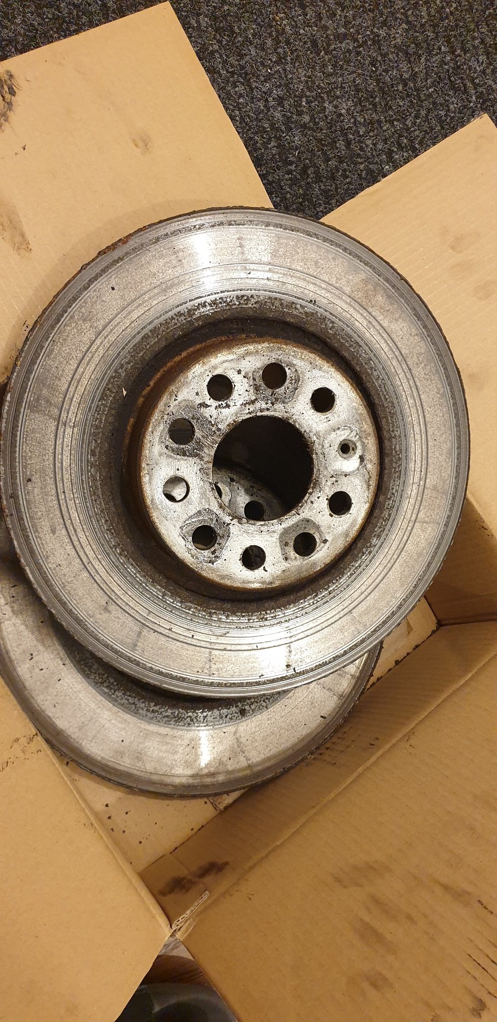

Although by now all know Skoda discs are so poor, I thought will share my experience in old thread. Changed all front and rear at 48500 miles/ 5 years, started to hear grinding noise and some rear pads were shot. Discs look horrendous but amazingly measuring thickness they still had ...in theory (poor surface affects braking efficiency I think)....few mm of life left. Similar most pads had 4-6mm life left but 2 rear pads were destroyed by poor disc surface. I recon could do 100000 miles looking at thickness if not for the poor quality. I was surprised inside of front discs looked much worse then outside. After shopping around (independent garages, kwikfit/National (just to check prices :) -, one of them quoted £725 for all discs/pads - Delphi), Skoda dealer came much cheaper at  £417 for Ferrodo Premier and got my business. Did not fancy to buy myself with garage fit only and do not have fitting warranty in case bought parts would have defects. Dealer told me part of the problem with rear disc poor "cleaning" how he called it could be my engine braking....not convinced...My work pal 1 year old Golf has poor rear discs as well, front looks good.

@kewals Would you explain if the Skoda dealer offered you a range of replacement brands, or if you said what you wanted, or if you supplied the parts? Thanks.
Hi Ivan,
Sorry just noticed your query today. They would not supply range of brands (I asked initially for cost of Brembo, Pagid etc.) as they have one supplier of aftermarket parts (they don't want to have to set up new accounts for different supplier etc. just for me- I think it is fair enough). Their supplier was representative of Ferrodo so I went with this as reading online forums it seemed Ferrodo Premier should be decent. Skoda replacement parts would be more than £200 more than Ferrodo Premier so I kindly declined that :)
