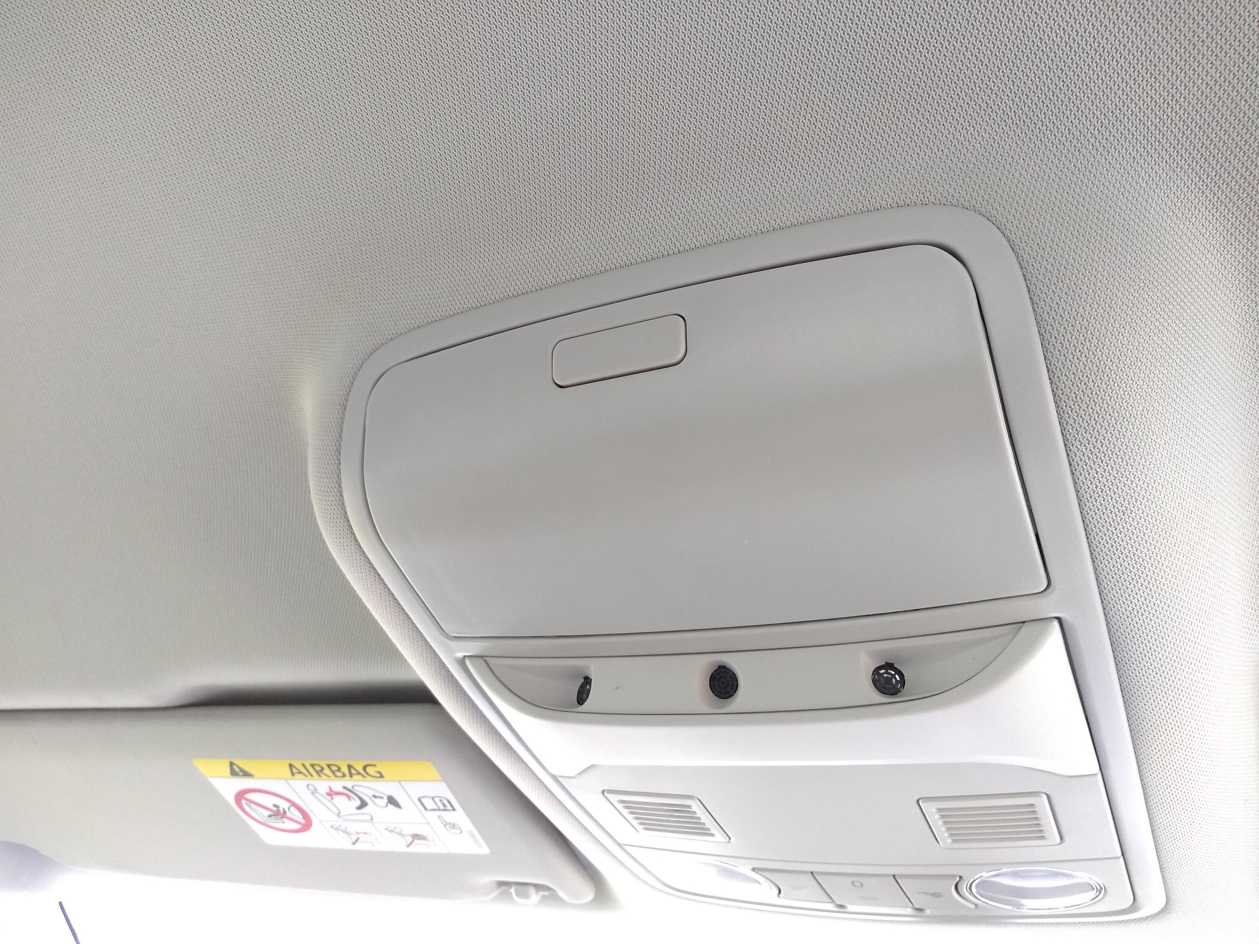

There's an option on the Yeti for a glass storage box at the back of the roof console behind the driving mirror but Zebedee doesn't have that, just a blanking plate. I see that several Chinese vendors on eBay sell this part but I'm worried as to how easy it will be to remove the blanking plate and fit one, if indeed it's possible at all. Has anyone been this way already?

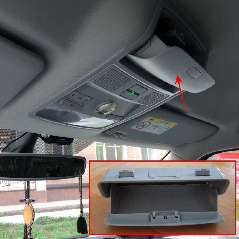

The blanking plate is just clipped in and can be levered out using some hard plastic sticks, and then the glasses case clipped back.
The picture above shows where the clips are.

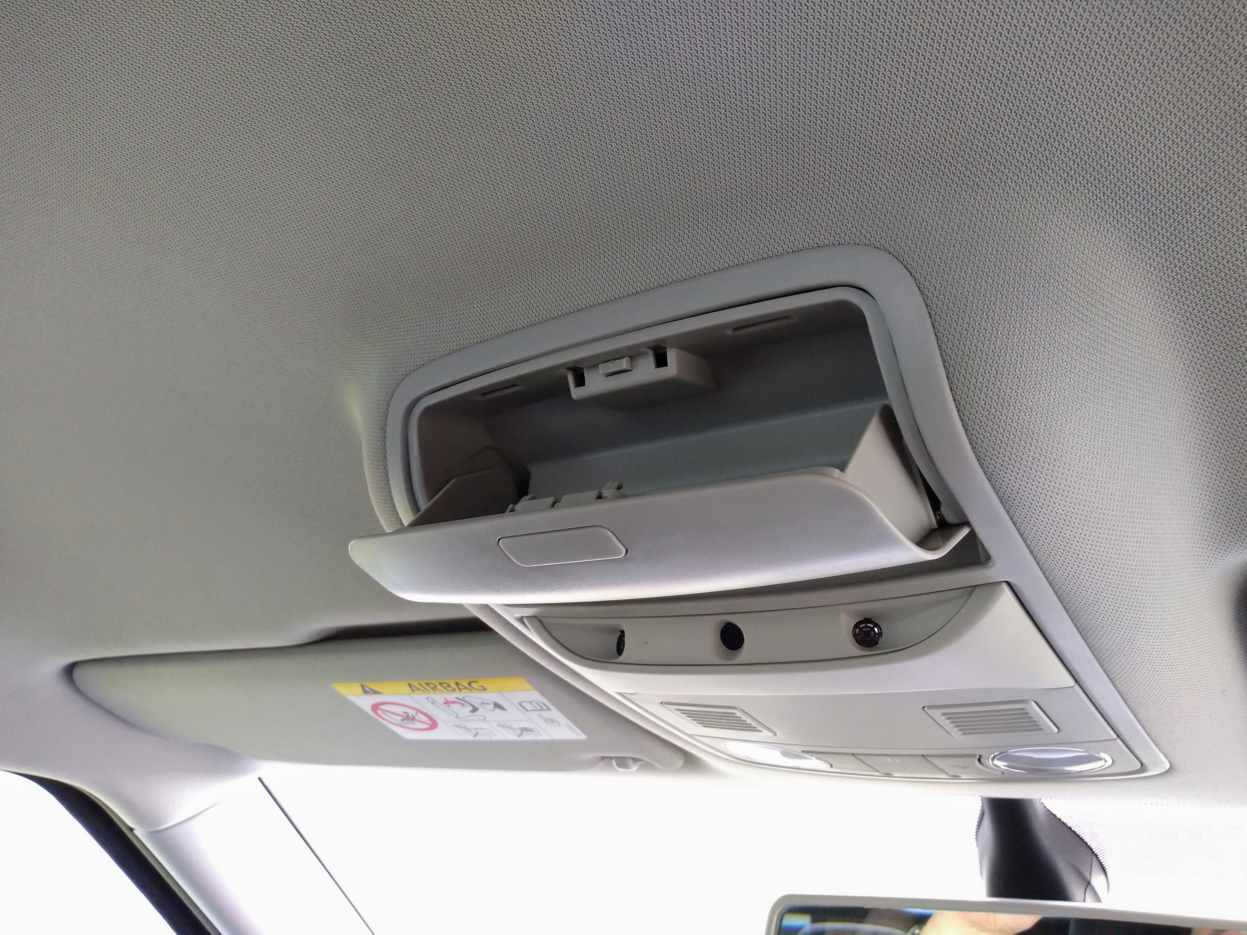

Well that came from China remarkably quickly (ordered 5/4, arrived today, a week later) and, as Llanigraham predicted it was easy to fit. Used a credit card to free the two top clips on the blanking plate and it then popped out. Just needed a bit of violence to get the new one in. Cost me £7.49 from these people of anyone else wants one.

No,  you just have to use a bit more force than I anticipated. The thing I'd missed initially was that the bottom goes inside the lip. Once I've realised this was necessary then it popped in with a bit of force.

My experience was the same as paul's, same price and supplier, really quick delivery. I used the handle of a Boot's medicine spoon to release the clips on the blank plate for removal. The new case was a bit reluctant to clip in, but eventually in she went. Identical colour match! I'm going to use it for static caravan keys, so I always know exactly were they are when I visit it. And spare fuses. It'll soon fill up I suppose.
