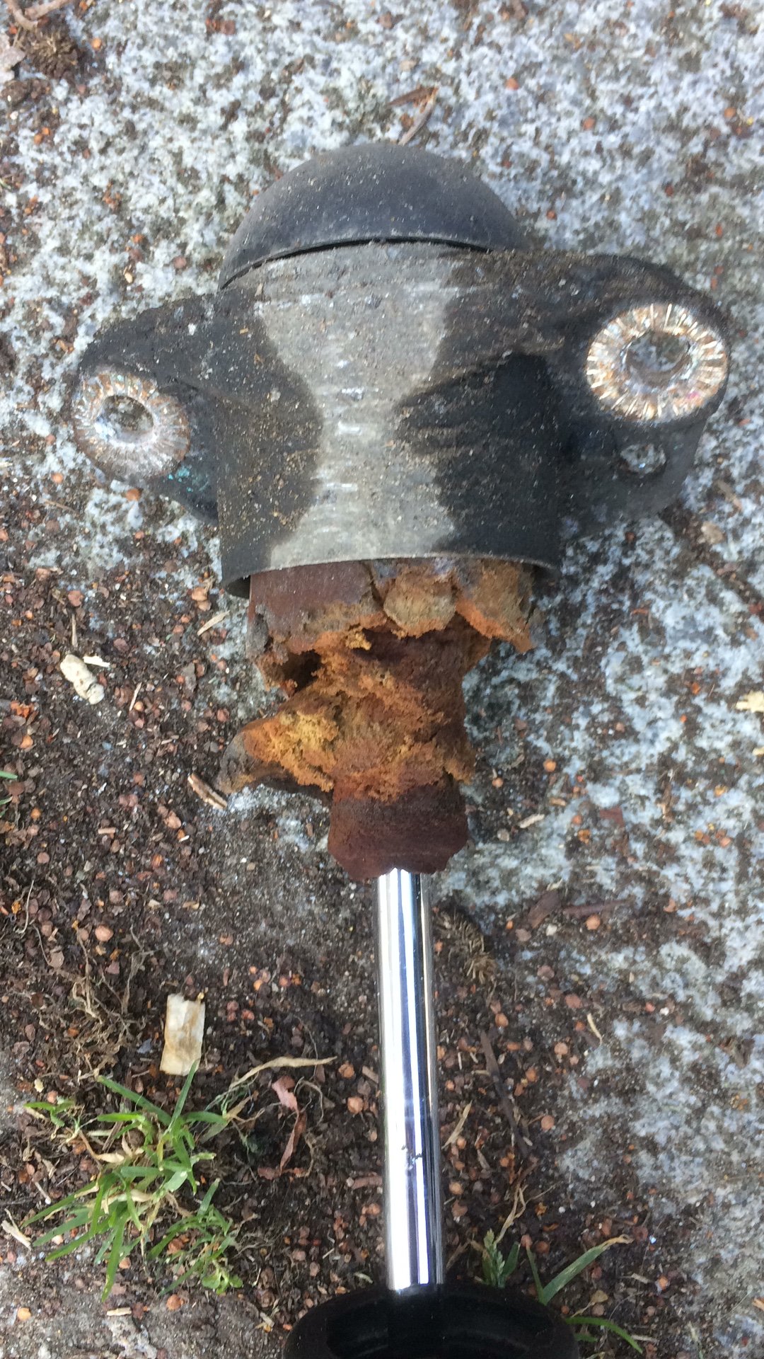

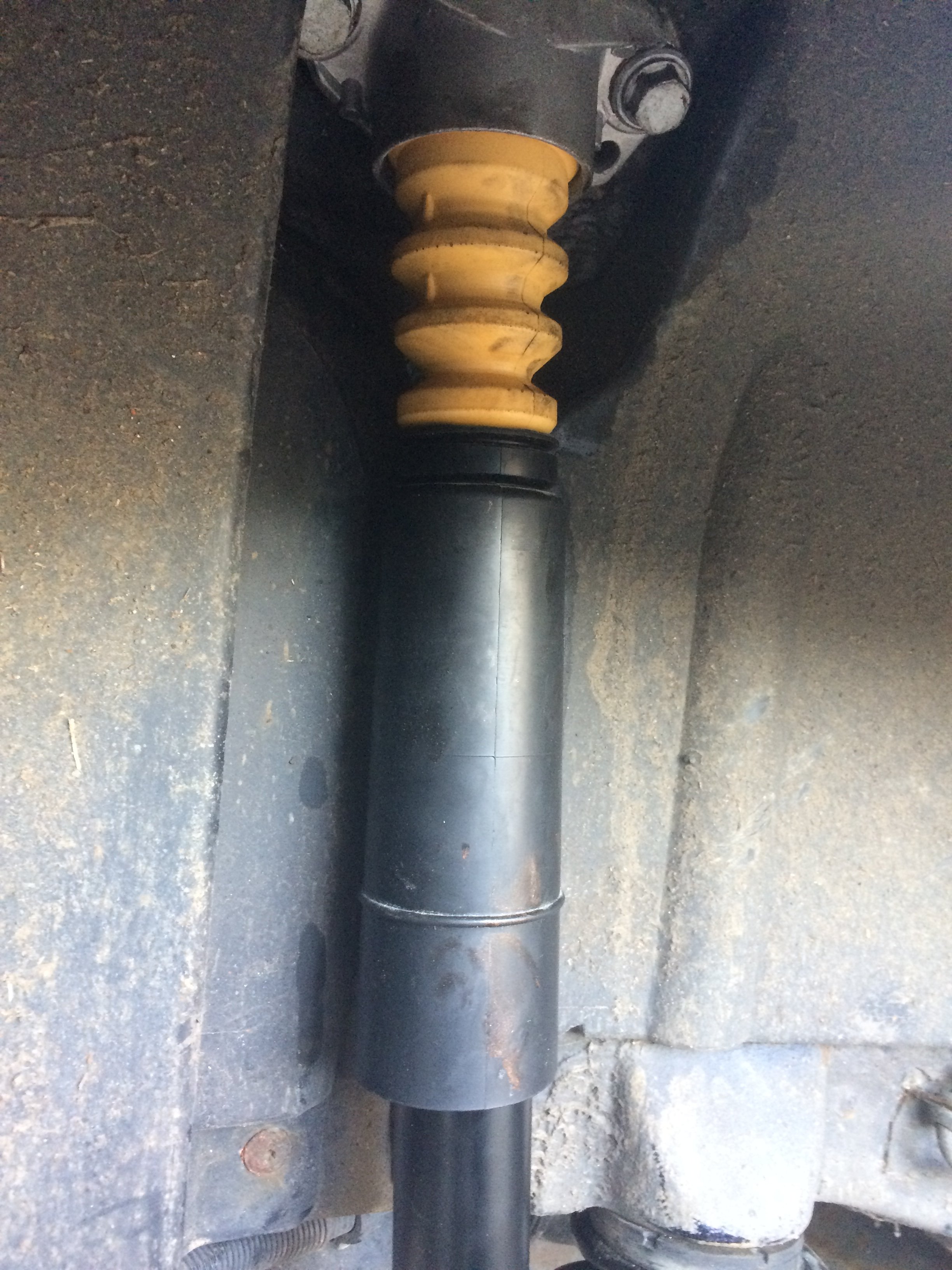

As you can see my bump stops were non existant and the dust covers were split
Nice new ones :thumbup:

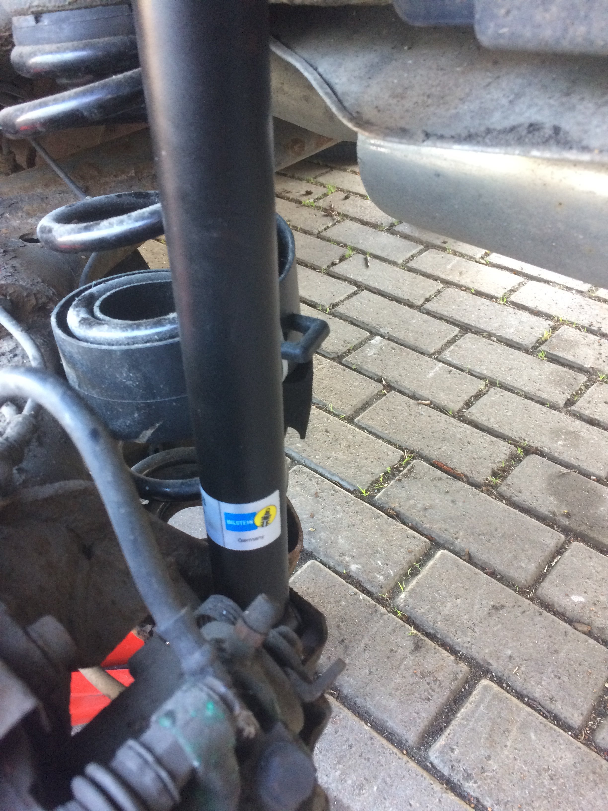

I ordered the parts form three places, absorbers from ebay and the bump stops and covers also, the nuts and bolts from AVS.
Took me two house to do.
Wary about the comment about upper bolts and rupturing the nuts on the housing, but otherwise not too hard.
