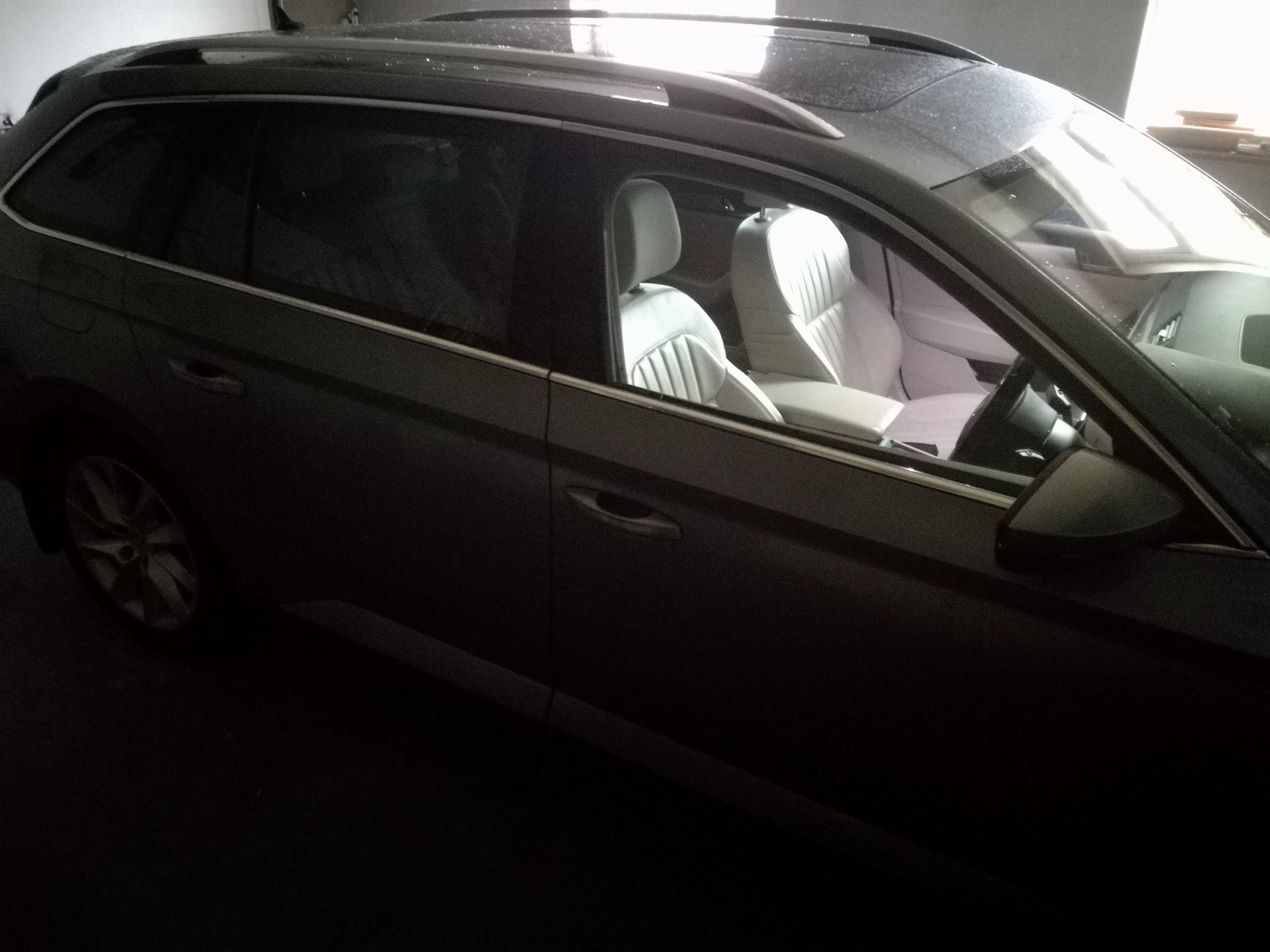

I have had them on for a year now and no issues. I bought the car 2 years old and it didn't have the tinted windows.
Perfect fit.  First picture car in the garage,  Interior lights switched on to show the difference
