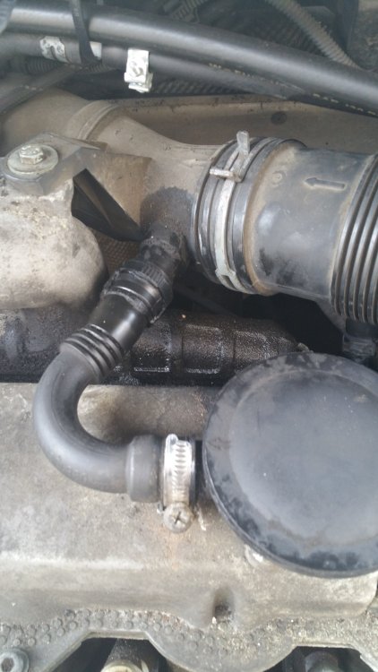

I have a leak and tried to pull off the breather out of the cover to clean it out , anyone got any advice please .
I have warmed the car up and got the pipe off , the 0 ring inside is in good order , at least it isn't hard . the car has done 170 K
Just thought I could try a jubilee clip on the pipe that pulls off the adaptor piece.
Thanks but that is'nt it , my pic is of the breather pipe from the head that goes to the turbo intake. Going by that pic in you ebay link that car has had the same problem , I am going to try a jubilee clip on that adaptor you can see that is covered in oil , thanks.
Edited by Ambient7
It think this is correct part...
The off take pipe on the right in you pic  is the breather pipe , you can depress a collar and pull off that adaptor , on the other end of that piece is a pipe ( missing in your pic )  that has no clip , I have put on a clip and will see if this stops the leak on to my exhaust , thanks .
