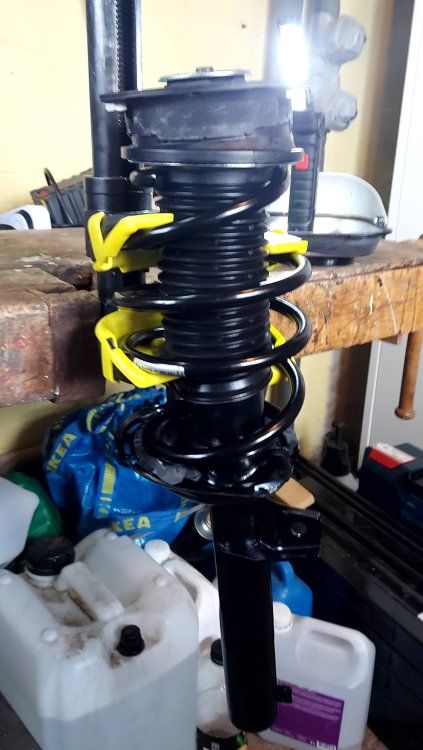

I own a Octavia mk3 ,1.6 TDi, 2015,  station wagon ,4×4.  I noticed my front right shock to be leaking( same amount of dirt on the left side) and the metal round ring around the right shock to be broken. I already ordered a pair of Sachs Shock Absorbers , bearings. Will change both sides next week. Car doesnt sound strange over bumps or so  . A good call or do you consider as an early change? The car has 171 000 km on the clock and original shocks...

Thank you for your reply! I will be changing the coils as well, because why not 😃 So I don't have to do the same repair procedure next year

Yes, I got the right part number from Sachs customer services. It should be Sachs 315 910, Sachs Coil springs 993 820, and Sachs top mount and bearings.  I have changed front shocks on a Volvo before. I studied the procedure both with YouTube videos and with workshop manuals. I think I have all the tolls needed, of course there is gonna be some rusted bolts . Typical Sweden, road salt .
I changed the front suspension items at past weekend. It was quite straightforward beside some tugging and pulling on lower control arm and a top strut mount bolt I had to cut.
