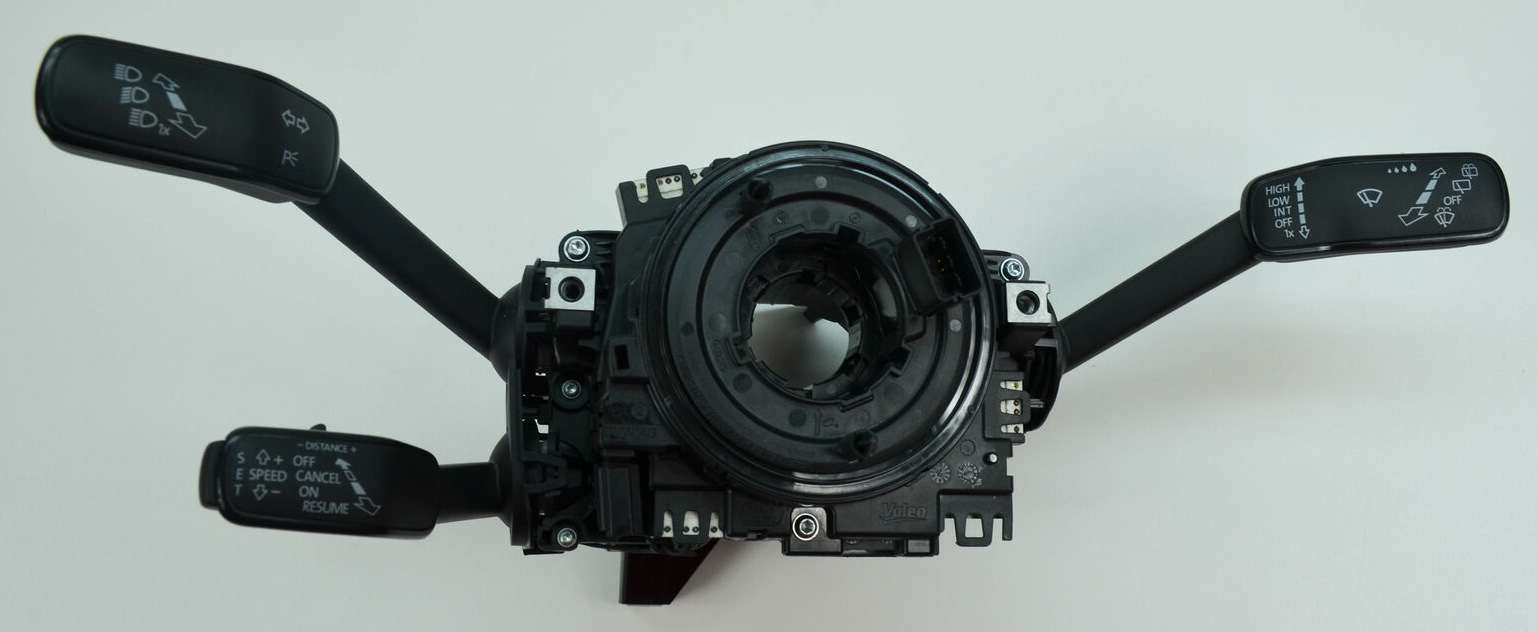

1) ACC  as our cars have front radar  for automatic brakes , it is possible to recode/swap coding of the radar to work as ACC distance meeter as swap stalk / steering control module. Steering module is on its way.

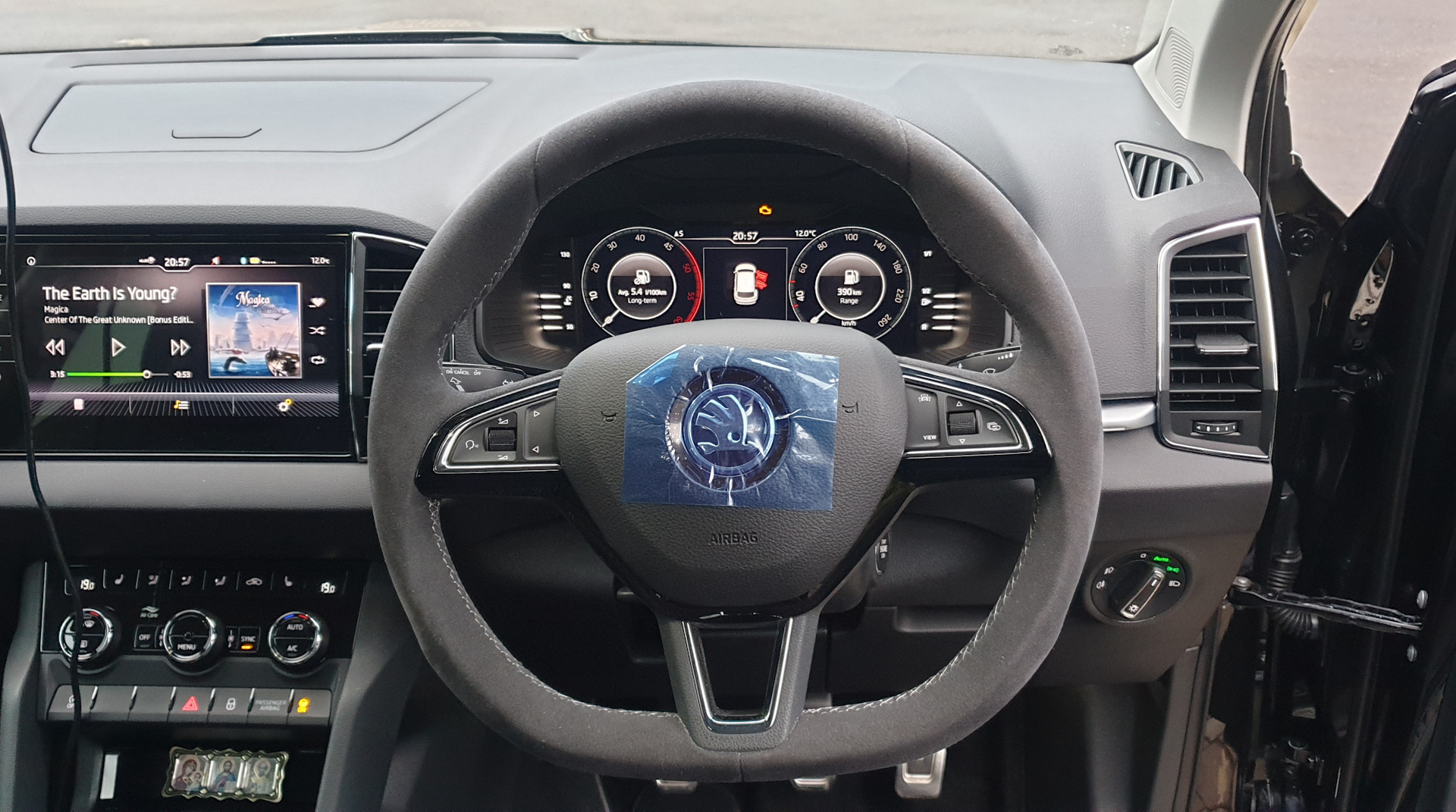

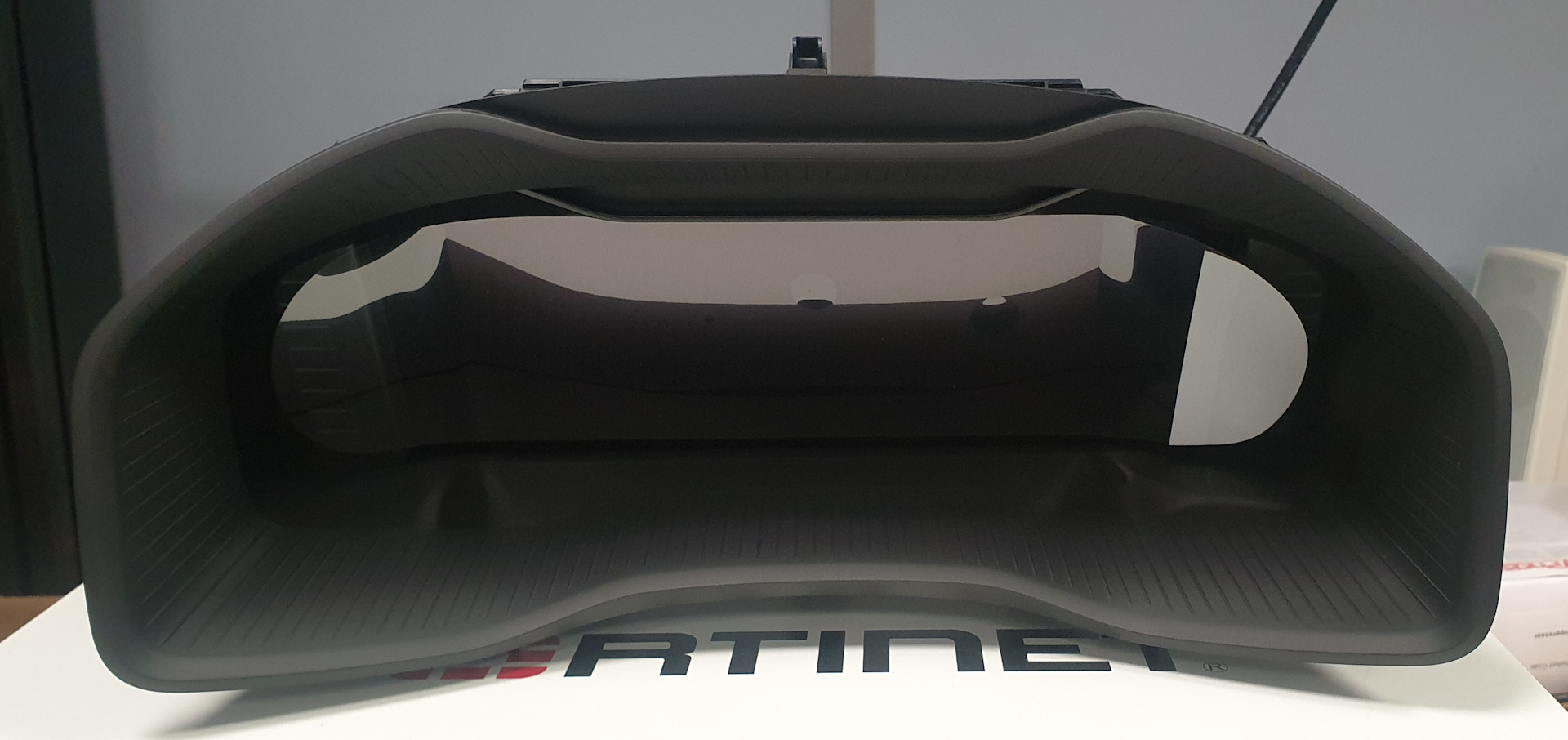

2) Digital cockpit.  Sitting on the table and waiting to be installed/recoded. Got it here https://www.facebook.com/groups/441582886578377

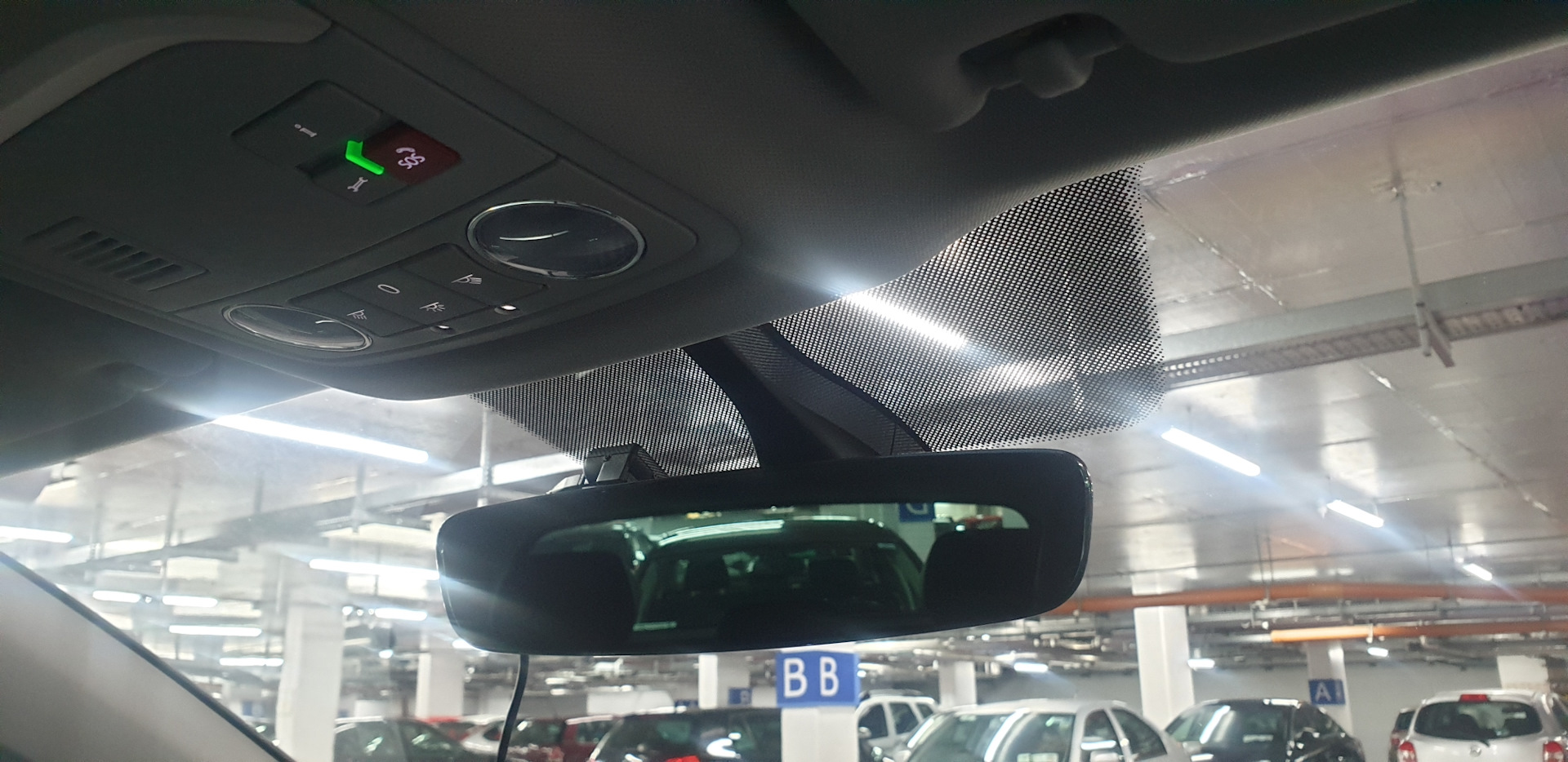

3) Borderless mirror , I had one retrofitted on my SUP3 and its brilliant. Mirror on its way as well.

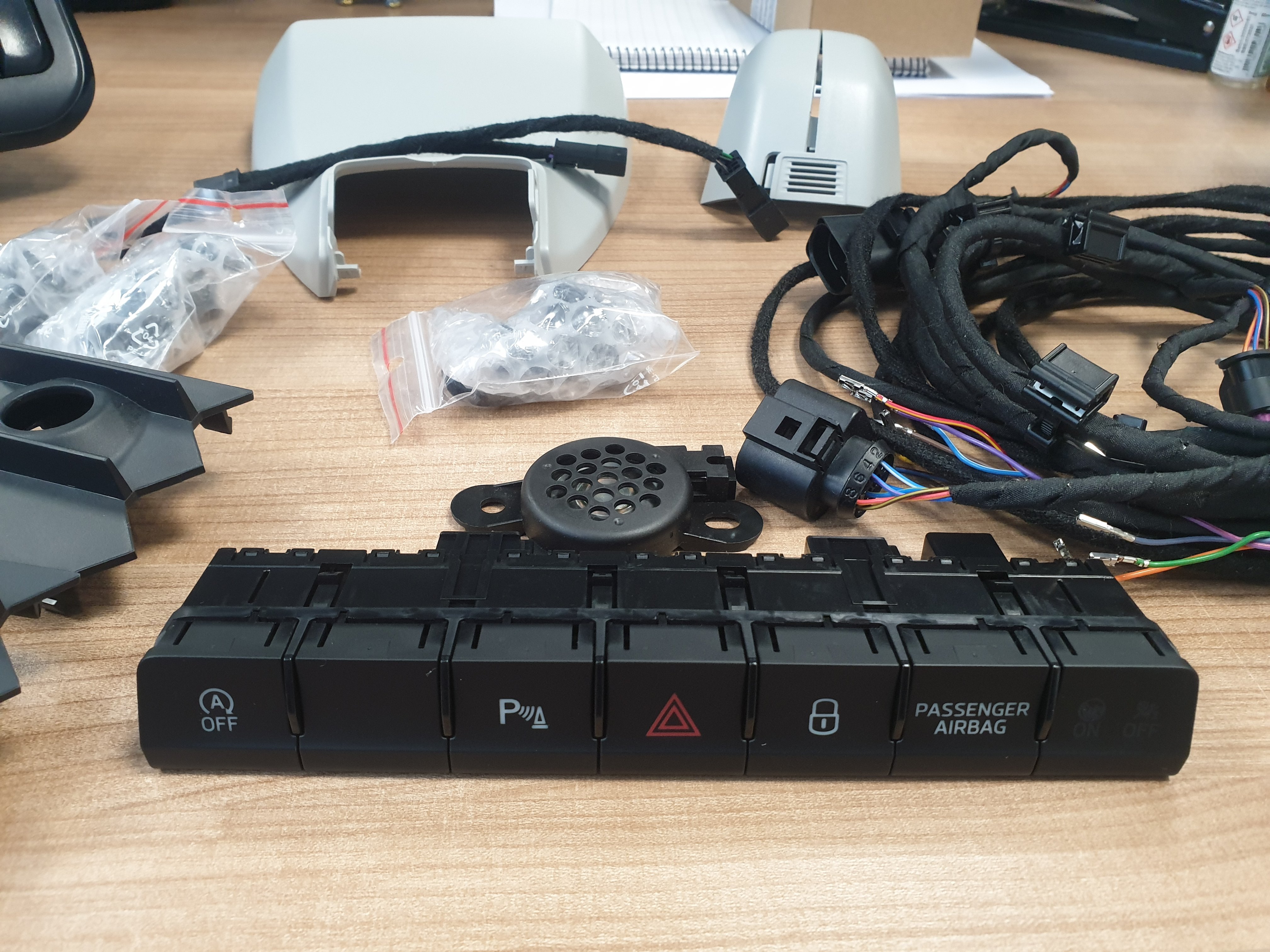

5) Another thing I am missing very much is front parking sensors. Did not purchase yet. Dealer denied to install and offered instead cheap Chinese  (no offence ) alternative.

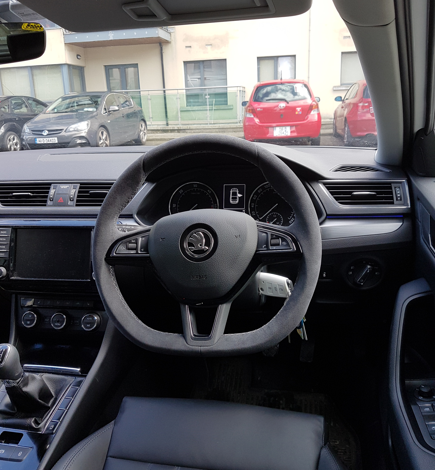

7) Alcantara sport steering wheel left from Superb. Might need to swap buttons from current steering wheel to sport one  due to this "View" Button .

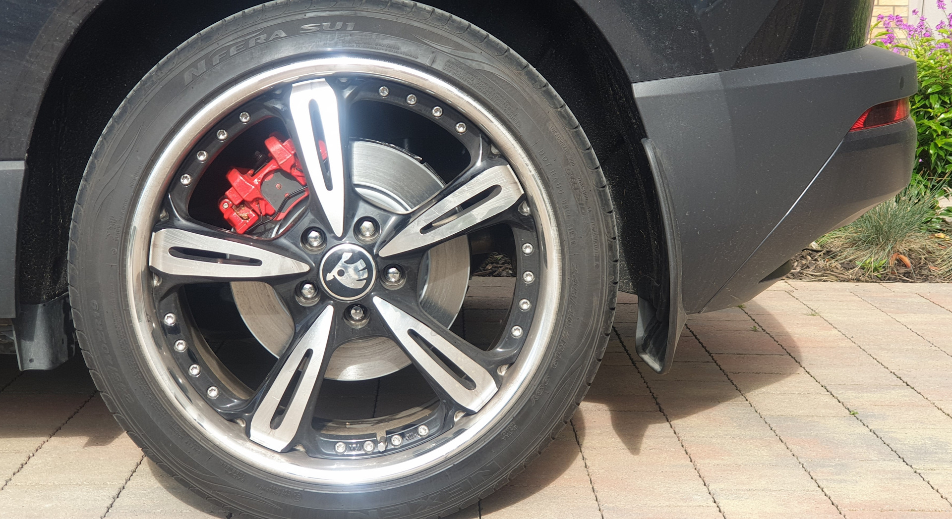

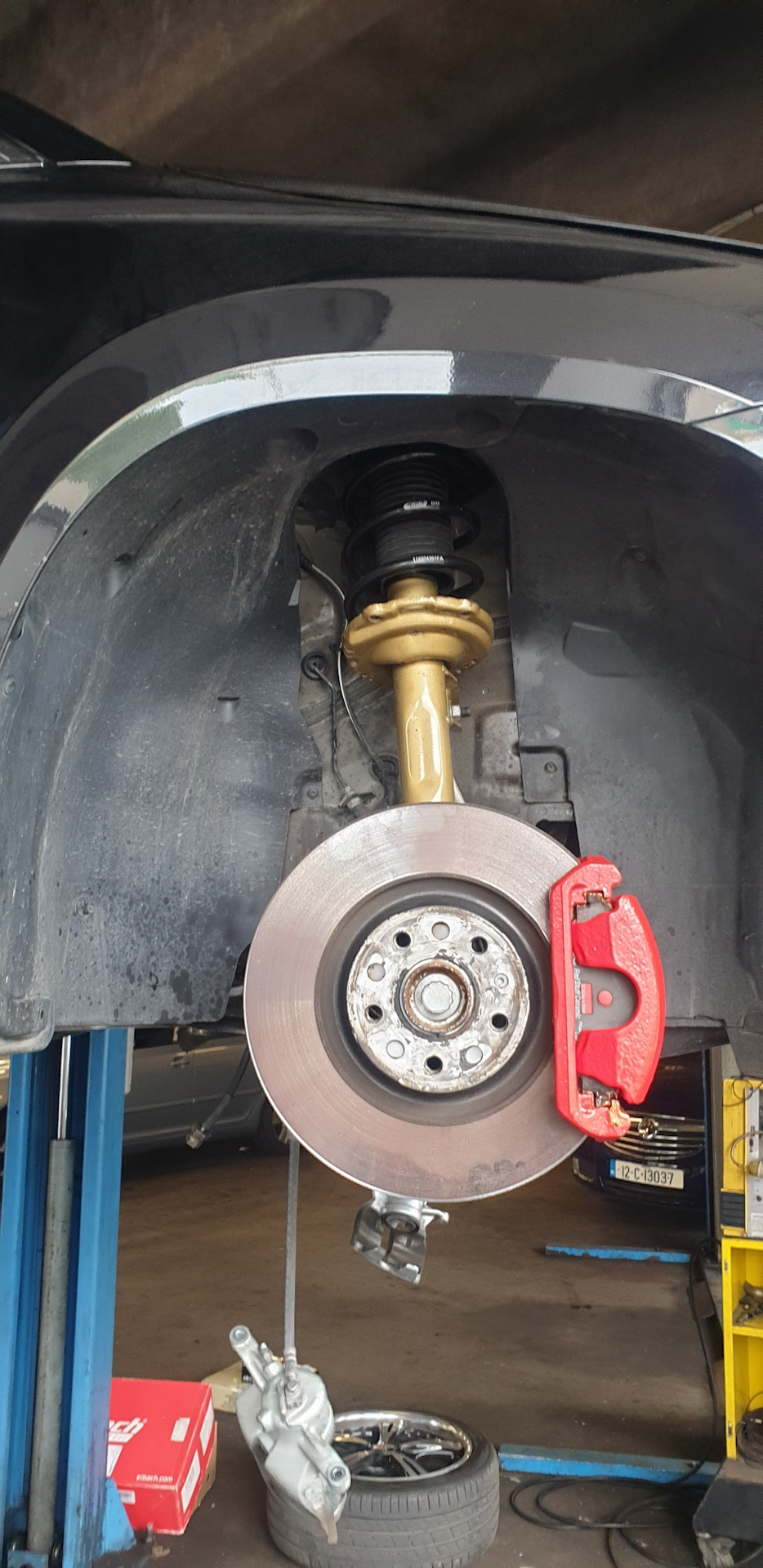

  • Eibach springs all around, front Koni FSD suspensions and 340mm front brakes are implemented.

They ship from Russia.  Took me  1.5 week to get my dashboard.

Nope , coding will be done remotely via team viewer with help of ODIS. VCDS is not good enough for this swaps.
I retrofitted ACC previously on my SUP3 and yes , this requare  so called "SWAP CODES" . Our radar is capable of being ACC radar , however you need to tell radar itself to became ACC plus Gateway needs to now how to work.  So this task technically require access to VW codes. Dashboard looks like a bit simpler , but still need remote access to VW databases as IMMO needs to be moved and keys readded.

Digital cockpit 90% retrofitted  (10% for missing Optical cable between head unit and dashboard require for maps to be displayed)

Retrofitted borderless inside mirror. As I did this second time in my life its took me only 5 minutes of my lunch brake.
Had to purchase old shape airbag as my current one did not fit in to the Alcantara flat bottom steering wheel I had on my  Superb.  But found relatively cheap source and here it is:

Yes , I just finished today  fibre cable install and coding to get full dashboard  functionality.
ACC retrofitted as well.  No limiter , but who need it ?
(Airbag is not yet fully installed at that stage.)
(No speed limiter/mode selector)
340mm front and Koni FSD

Got my parts for front parking sensors today. And a bit of plastic for front camera assist
