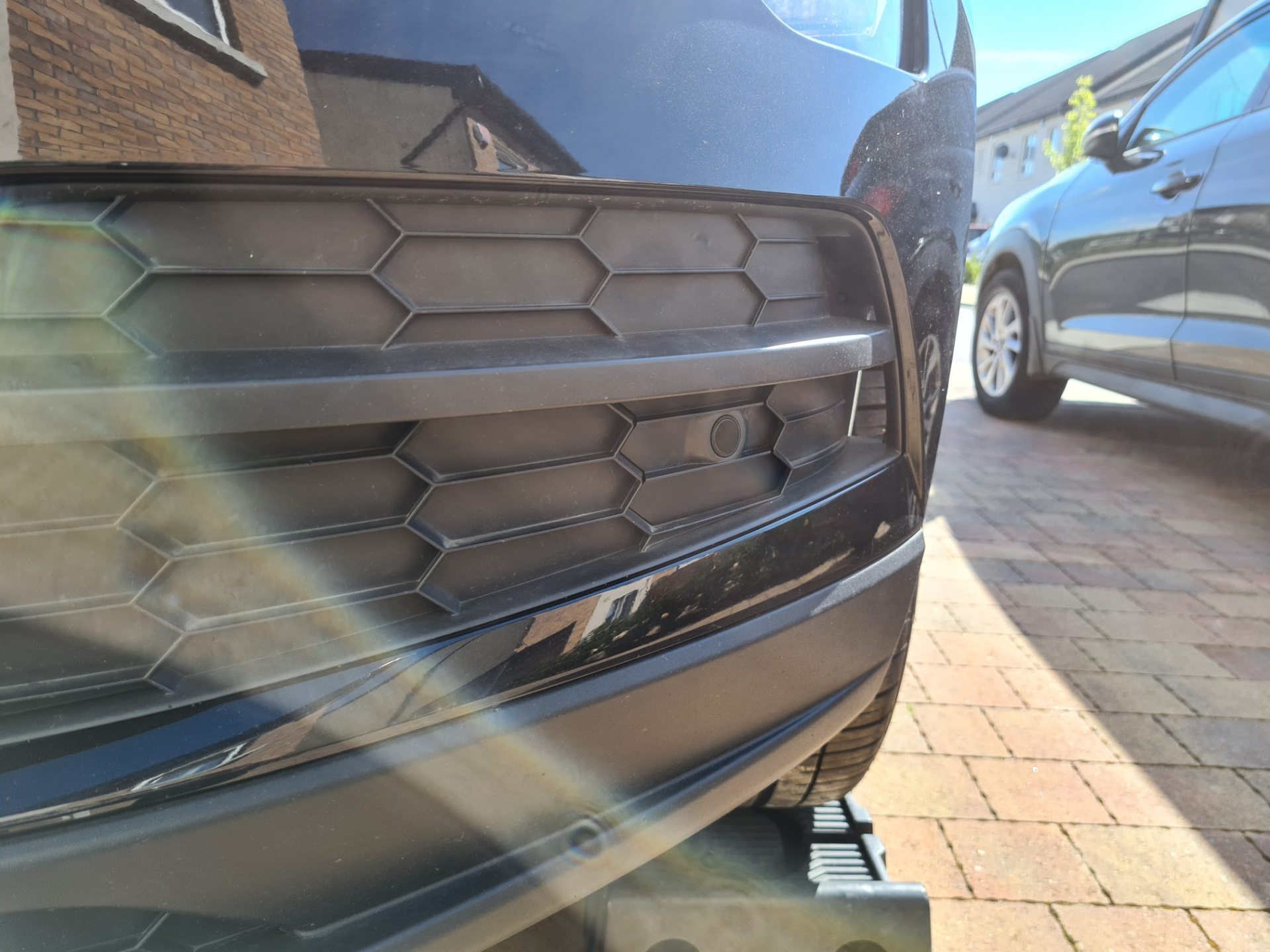

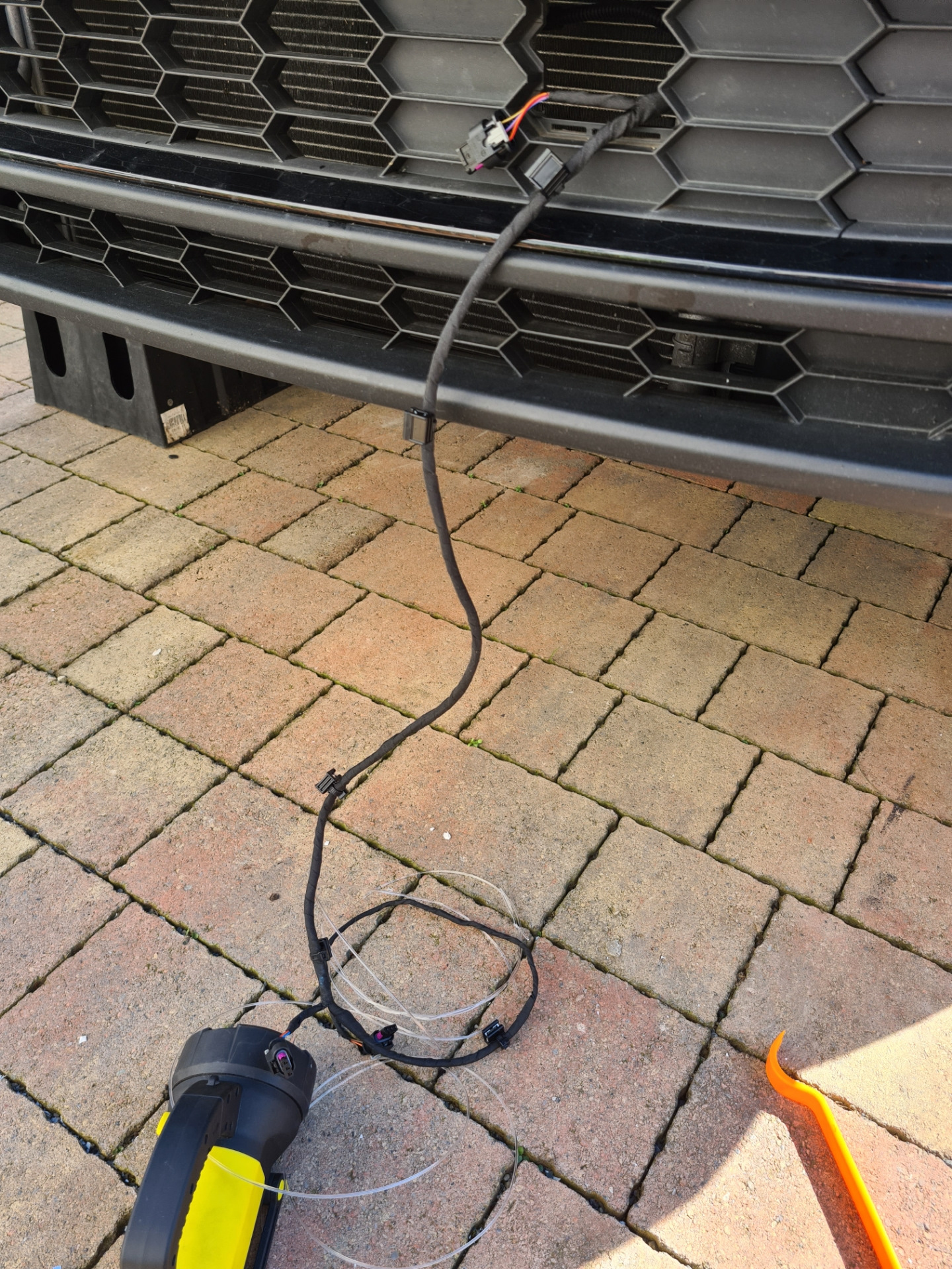

Managed to install front parking sensors without removing bumper. Now need to run cable to inside and change switches on the central console

Have you also had to drill the painted part of the bumper to install the parking sensors or are they all in the black plastic? Looks great by the way.
