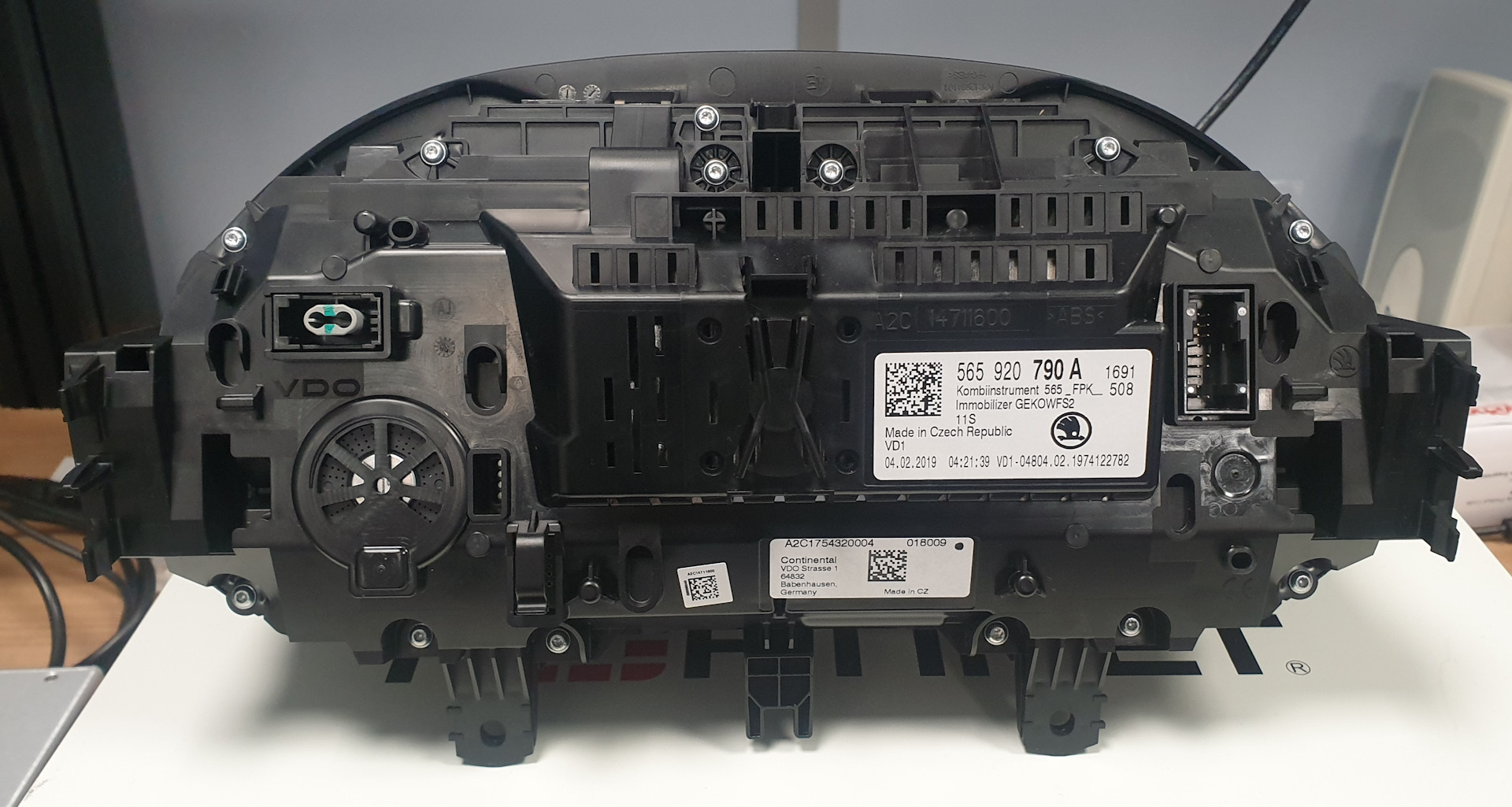

    Hi, you can change into Sportline/VRS so Red/carbon via VCDS coding.  STG17 > Anpassung > Kanal "Tuben Darstellung" > Change code  For the skin, ...... > Kanal "Displaydarstellun
23 hours ago, Shahoff said:
Will work with Bolero but will be no maps. However then you do not need to run ANY extra cables as standard  dashboard cable will do.
Thanks! Was it too hard to unmount existing dashboard? Screws involved or just clips?
You have any advice for an amateur like me? Where to start first on cockpit and how many hours to allocate?
Mechanically its not big deal , but you need dealer or someone who have an access to VW database to reprogram  your dashboard and  register the keys. This usually cost some money as well.
That's great, less cables to take care and run. But the key reg didn't think at all :-)
If you got any other fitting advice or guide, please let me know.
Thanks again

This is not simple coding. You need to have an access to VW online Database via ODIS or similar. The main reason is IMMO keys are sitting inside the dash.

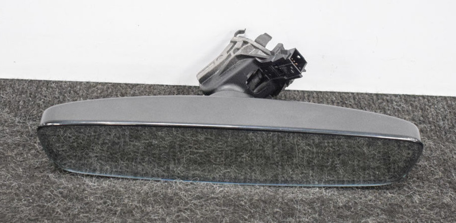

On 13/04/2019 at 00:13, Shahoff said:
3) Borderless mirror , I had one retrofitted on my SUP3 and its brilliant. Mirror on its way as well.
Hey there Shahoff, thank your for your post.
Can you please tell me the reference of the bordless mirror that you installed as there are multiple references out there and I'm not sure which one will work on my Karoq.
Thanks
3G0857511AD , but if you are are from Europe - I have brand new for you, jut got it with front camera.
Hey there! Thank you for your quick reply. Yes I'm from europe (France to be more exact).
Ok for the one with the front camera. But it is still Plug and Play?
Thanks again!
3G0857511AD  is not FLA mirror , just normal mirror but without border.

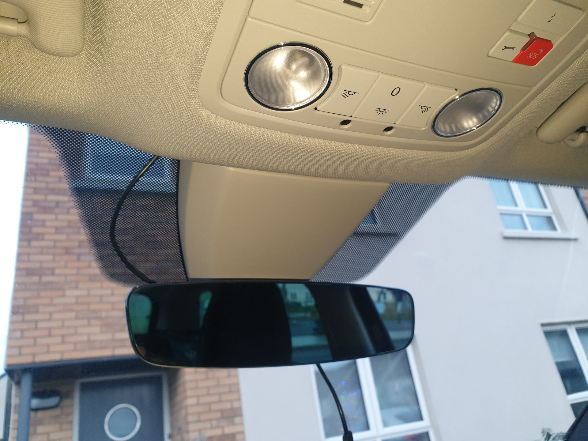

So thanks to Shahoff I installed my bordeless mirror. There were to videos that helped me with the installation:
 I know it is not that hard but when you're doing it for the first time it really helps to watch some of them before.

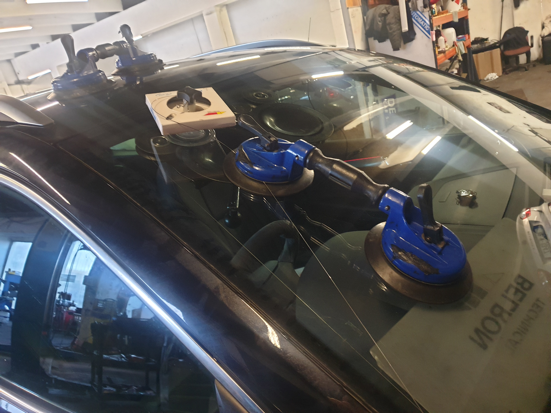

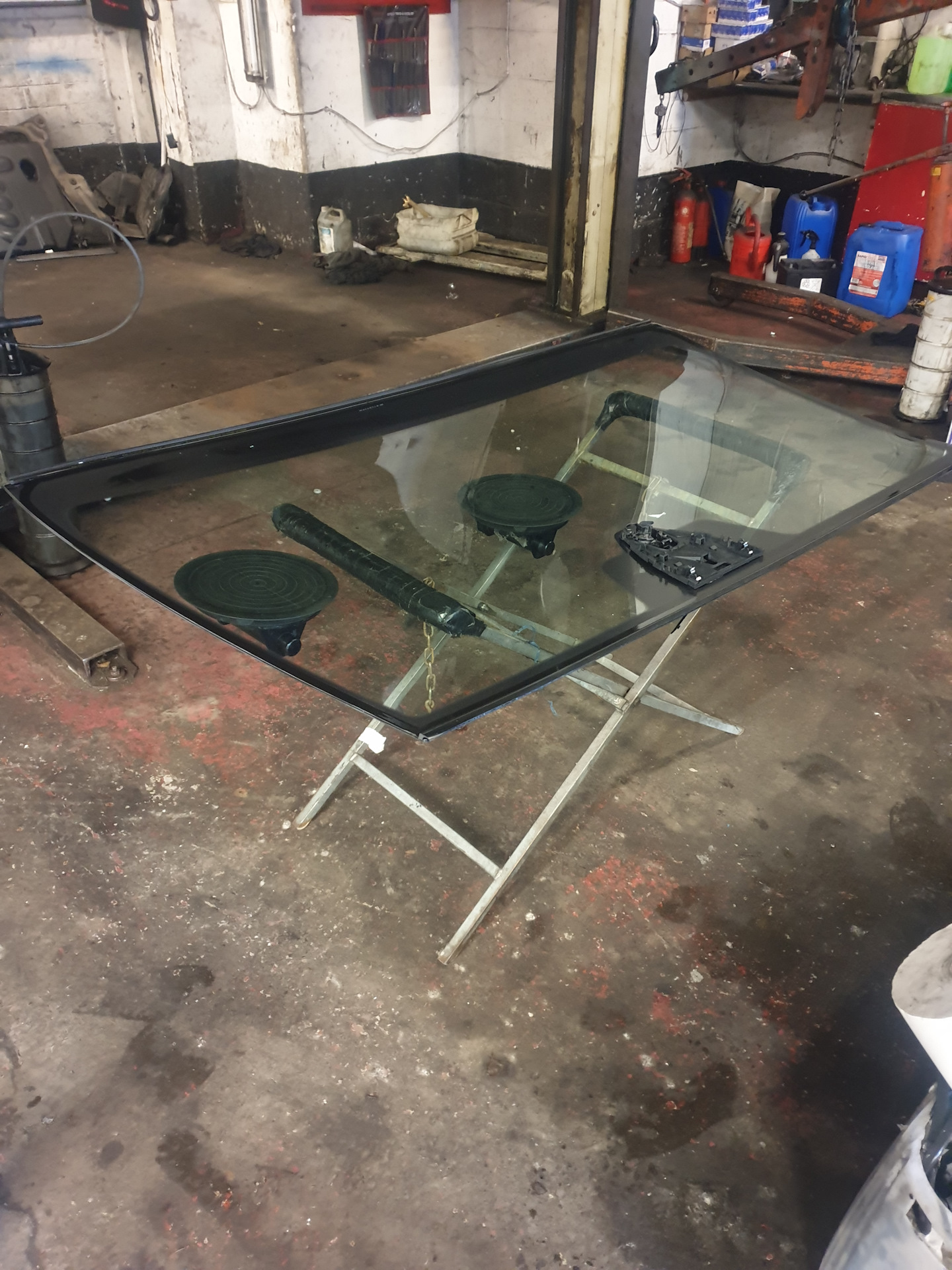

Windscreen changed, camera installed, wires run to the point. But need to connect , code and calibrate camera assist.
Process is complex
That how  its looks like from inside now.

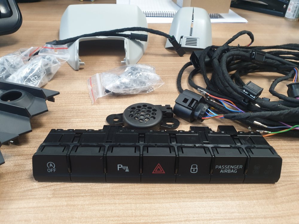

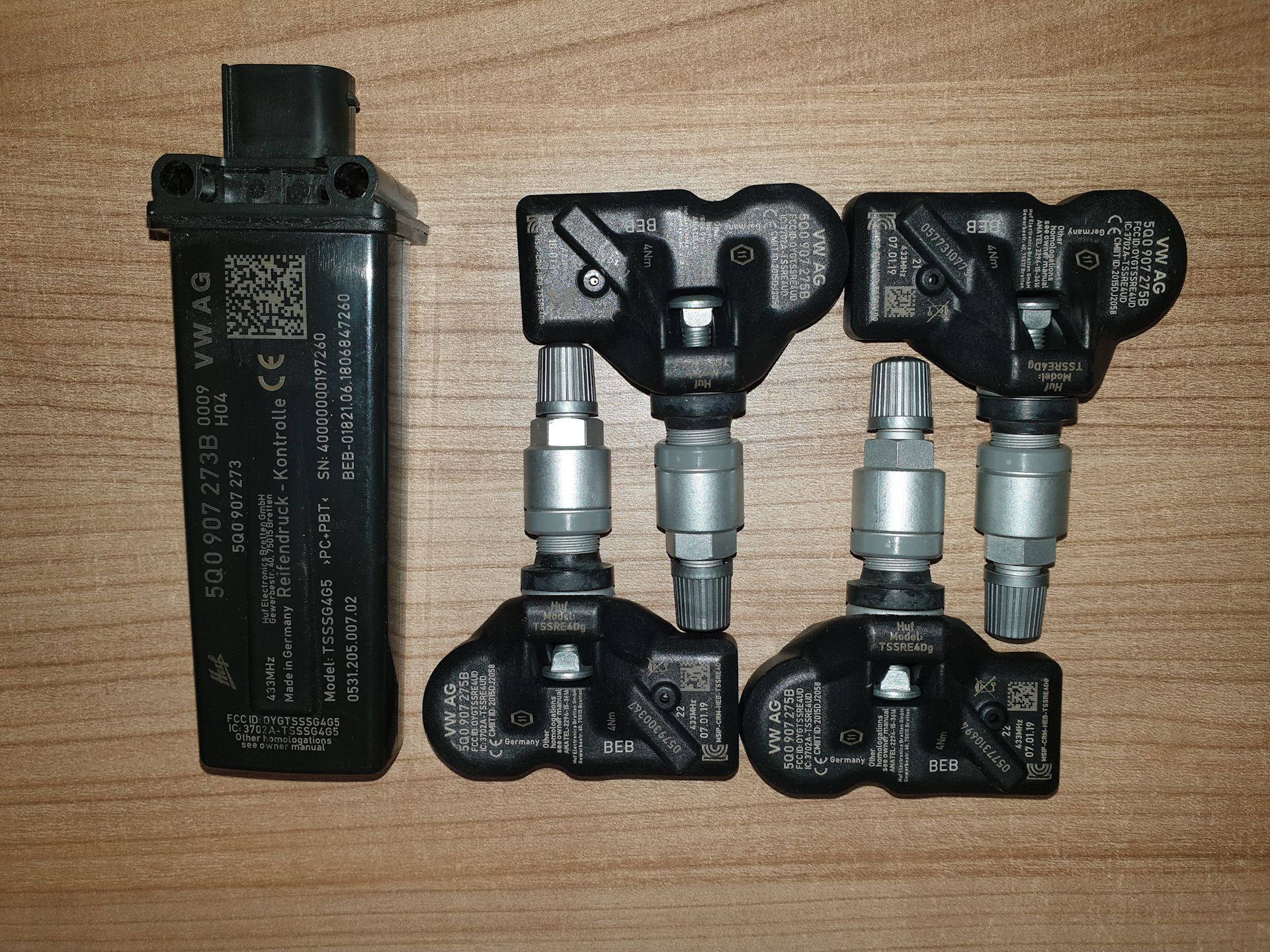

On 26/09/2019 at 12:06, Shahoff said:
Retrofitting  TPMS :) as well. Just want to know exact pressure.
Hi.
sorry if this has been covered before. But how do you retrofit TPMS? I have a KODIAQ L&K of October 2019 and this is something I would like to add as well. System only tells me if tire pressure is down. But would like to have TPMS. Thanks.
Hi, congratulations on your great work.
I am very interested about the acc retrofit. Could you please tell us what were the steps and parts required to make it work? Any information about would be great!
Thanks
On 25/01/2020 at 21:39, wdufour105 said:
Hi.
This are exact parts on the photo + cables. A bit of VCDS coding require as well.
Thanks
Stalk, underneath cover and somebody with ODIS and access to the VW/Skoda database and SWAP codes.

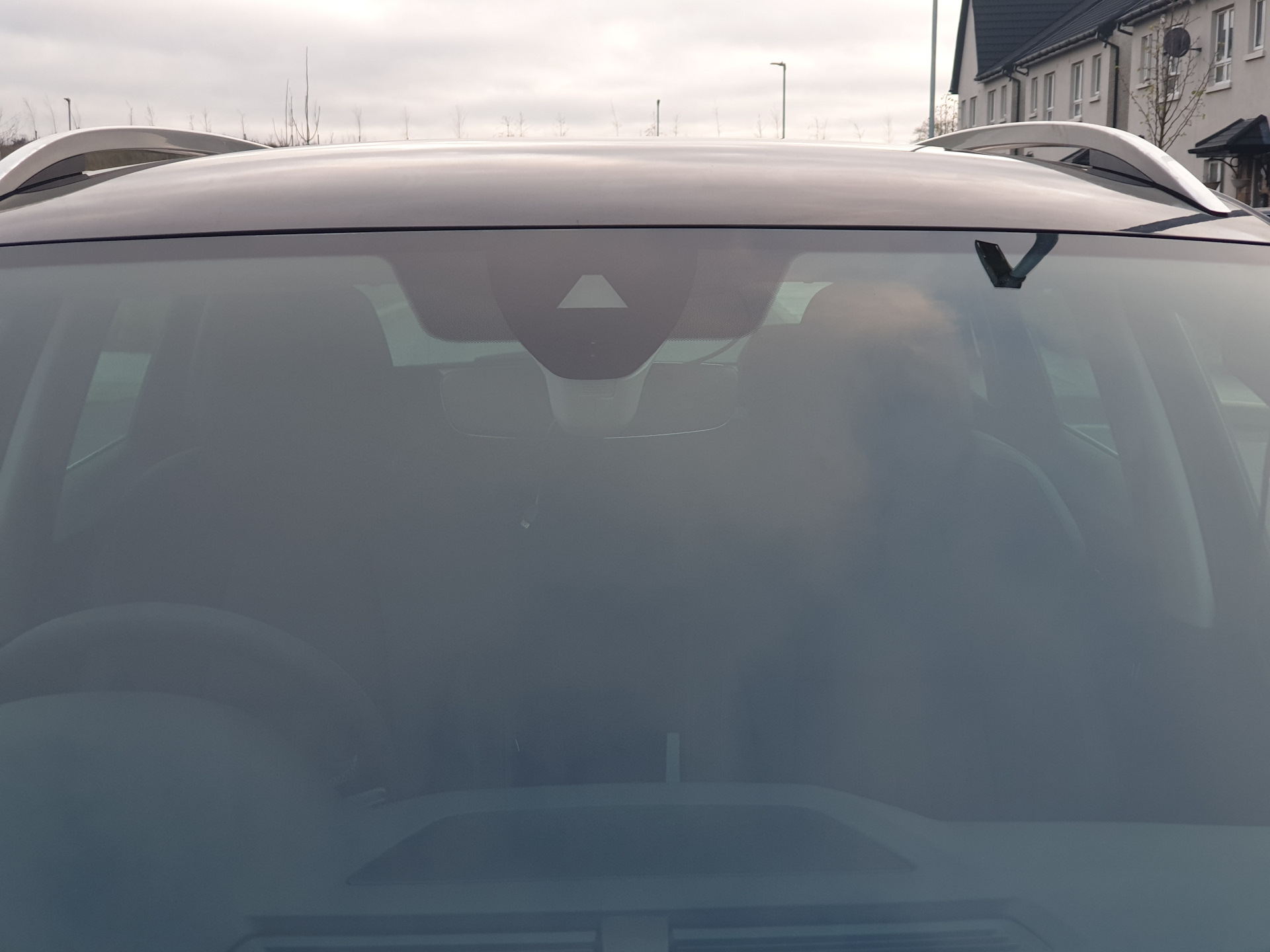

Retrofit Traffic Sign Recognition and maybe Lane assist:
Hi, I ordered my Karoq with the option of Traffic Sign Recognition but Skoda forgot to install it. They reimbursed me but now I'm without and since I travel a lot I would like to know if it can be retrofitted. My dealer has never done and doesn't want to do it.
Can anyone assist here?
you need to find a VCDS cable  , and come back when you do that
Edited by Tezaman
only if you have the A5 camera in the windscreen
No, I only have  the small camera

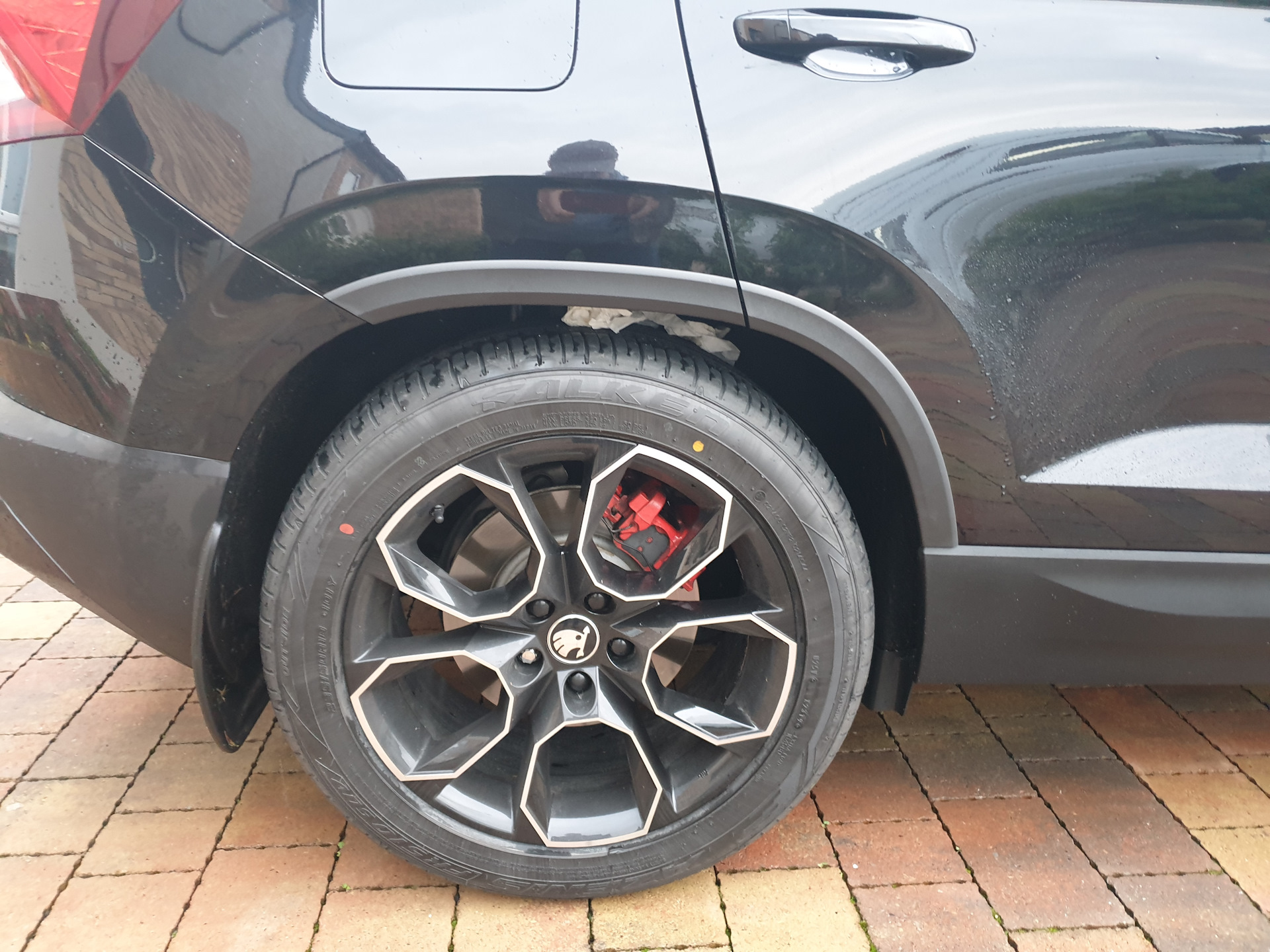

What’s the brakes off of they look spot on
