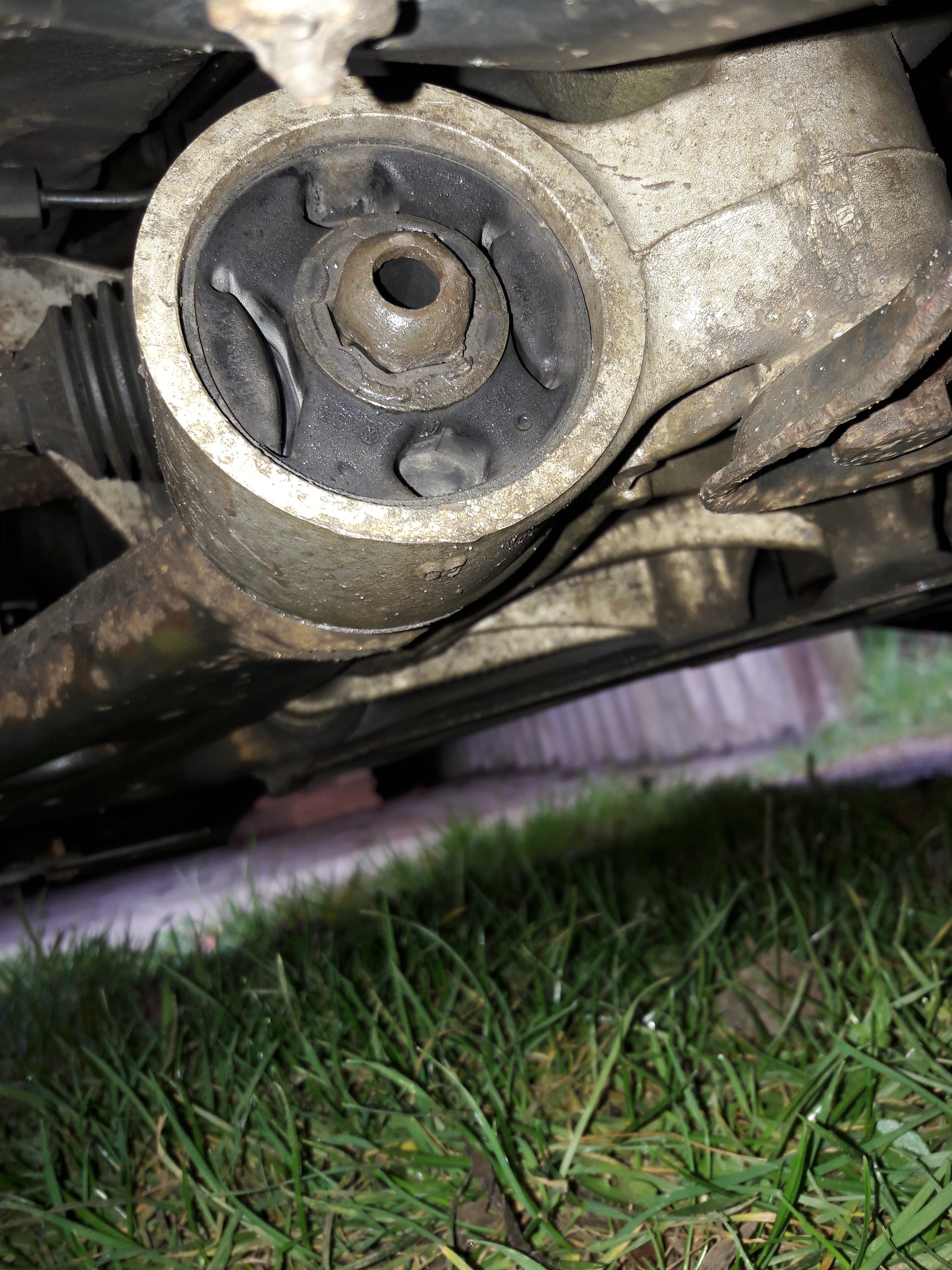

16 minutes ago, mikey362 said:
The bushes are just the standard ones
If that means the single, central rubber web up and down from the central hex, just don't do it.
Get and fit the X-type ones, with two diagonal webs above/below. I'll pop up a photo in a sec when I find one.

On the subject of console voided/nonvoided bushes, while the Cupra solid, ie nonvoided versions are the best plan, I think that they can be harder to pull/press into the consoles, so might destroy your nice new tool.
Okay maybe I'll steer clear of those for now then... Id much rather it just stopped squeaking for now plus the car doesn't get much hammer she only uses it to take the youngest to nursery and ferry herself to the gym and back lol.

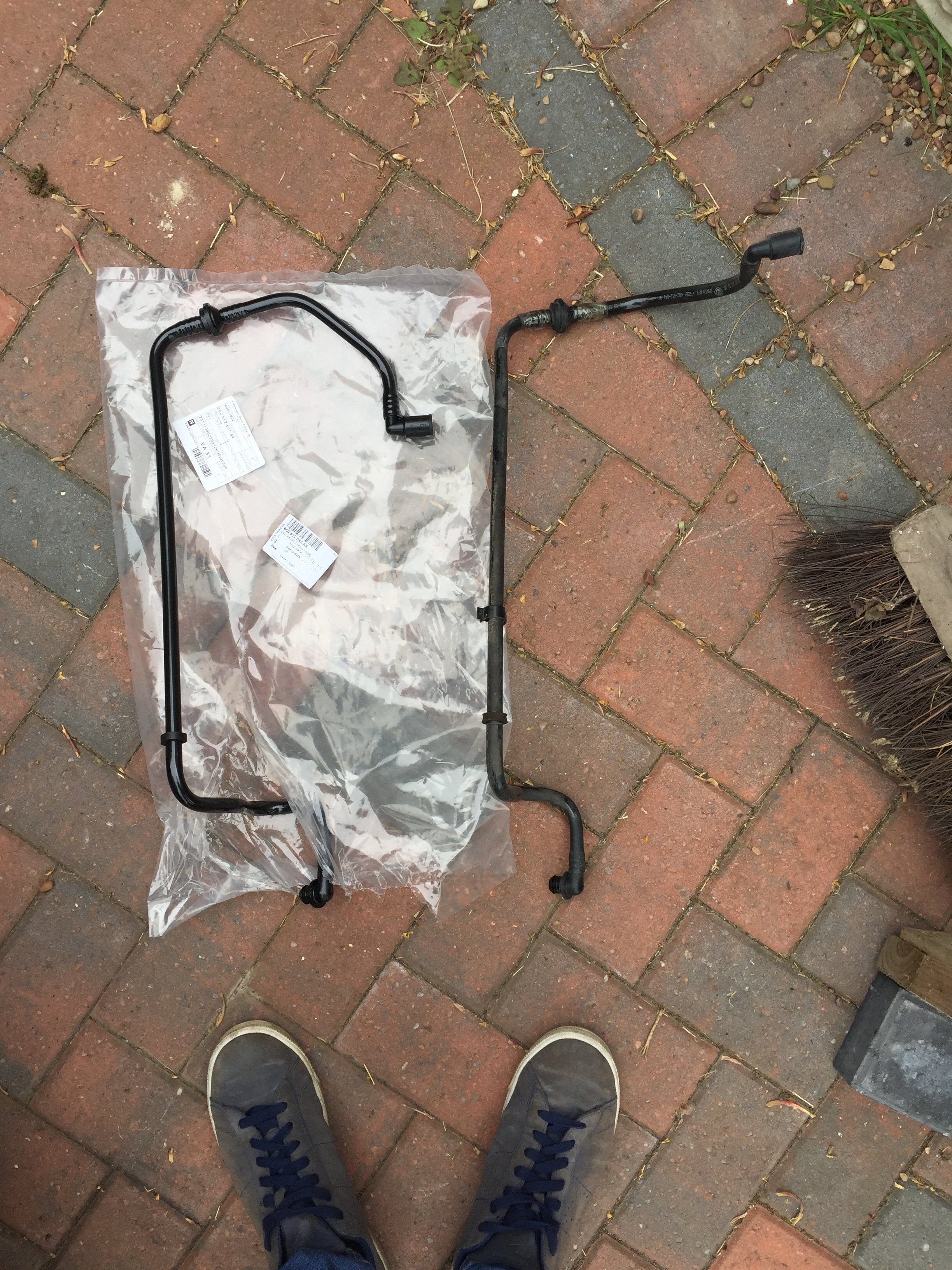

So not actually managed to do anything on the car this morning as the misses is a bit worse for wear so stuck on kid duty all day. The bushes will just have to wait but I might take the chance to order the cupra ones now as they should be here for my next chance to do them.
Ive also managed to get a new vacuum pipe sorted. Thanks to mike at lister group for sorting that out for me very quick response to my email and all done and dusted within about 20 minutes. I’d tag him to say thank you but don’t know his tag on here.
On 16/04/2019 at 11:13, Wino said:

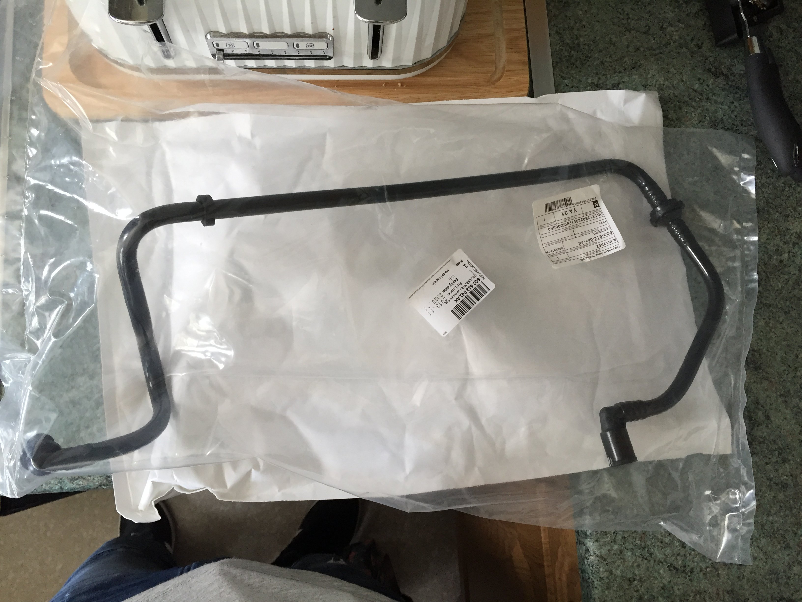

Thanks Mike @Skoda4Life I picked up the new servo vacuum pipe from the post office today and if nothing else I can’t fault you on packaging :D.
but seriously thank you for sorting this out for me just the way it looks compared to what’s on now is gob smacking.
It will get fitted on Tuesday with the passenger wishbone!

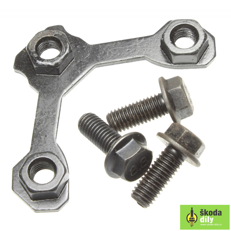

Well this morning was fun... started by attempting to replace the drivers side wishbone to find that the ball joint just would not split. So I started to undo the 13mm bolts for the ball joint and the last one decided it wasn’t coming out so put everything back on and will try and again tomorrow but this time with a hack saw.:blink:
that said the dodgy idle is now gone with new vacuum hose in
They often snap if they've been there ages. The part number for the retaining plate is 6N0407175A. The bolts are N10127707
Edited by TMB
2 minutes ago, TMB said:
They often snap if they've been there ages. The part number for the retaining plate is 6N0407175A. The bolts are N 10127707
 Thanks @TMB I’ve actually got completely new wishbones going on so I’ve got them already which is why it was so annoying that I didn’t have anything to cut through the bolt at the same time.
