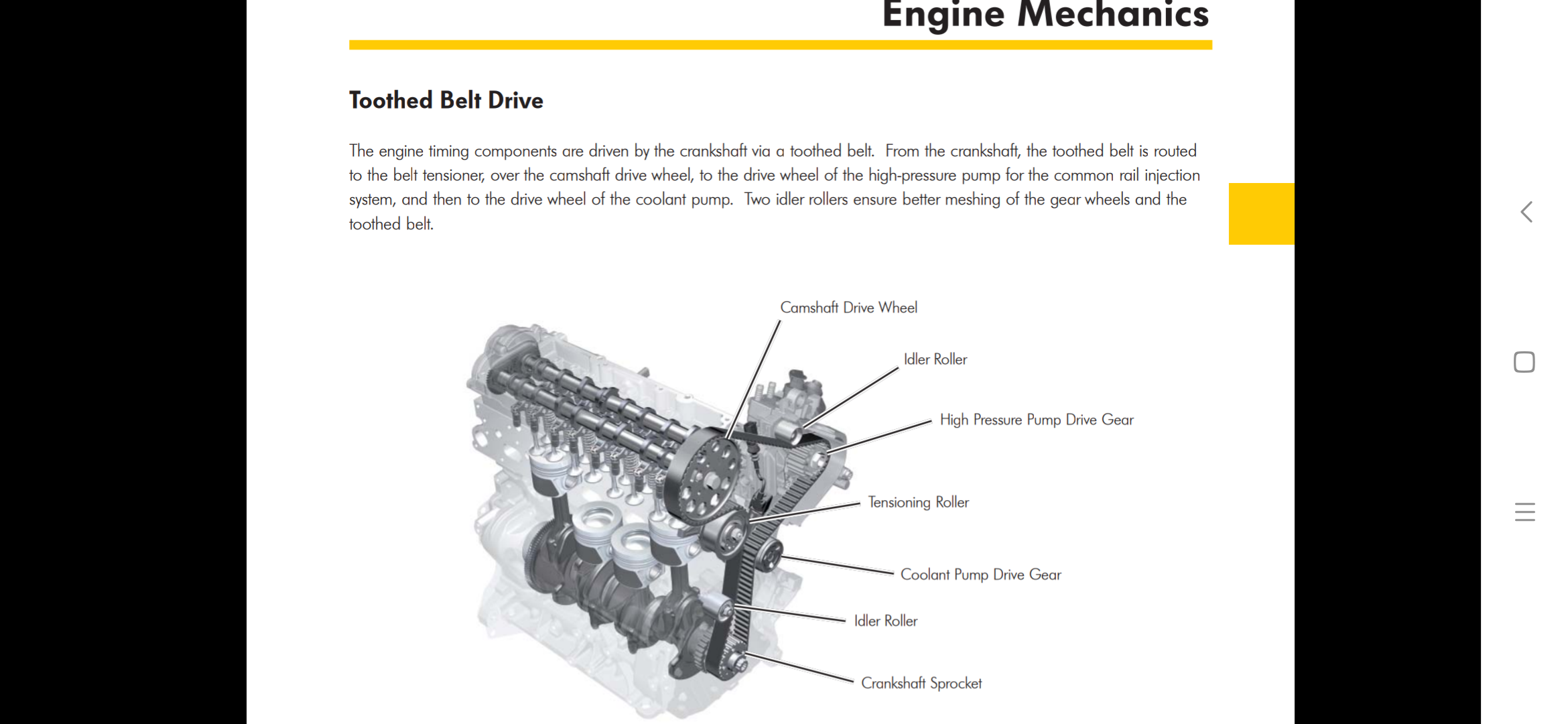

This is the timing belt diagram. I didn't change any of the above.

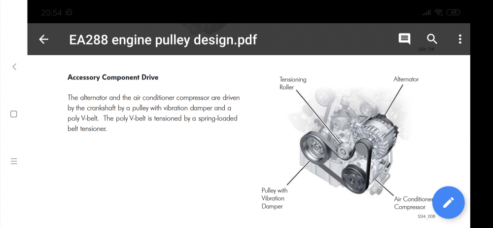

I changed the belt, tensioning roller, and alternator pulley in this accessory component drive diagram.
What else could be making the squeaky sound?
