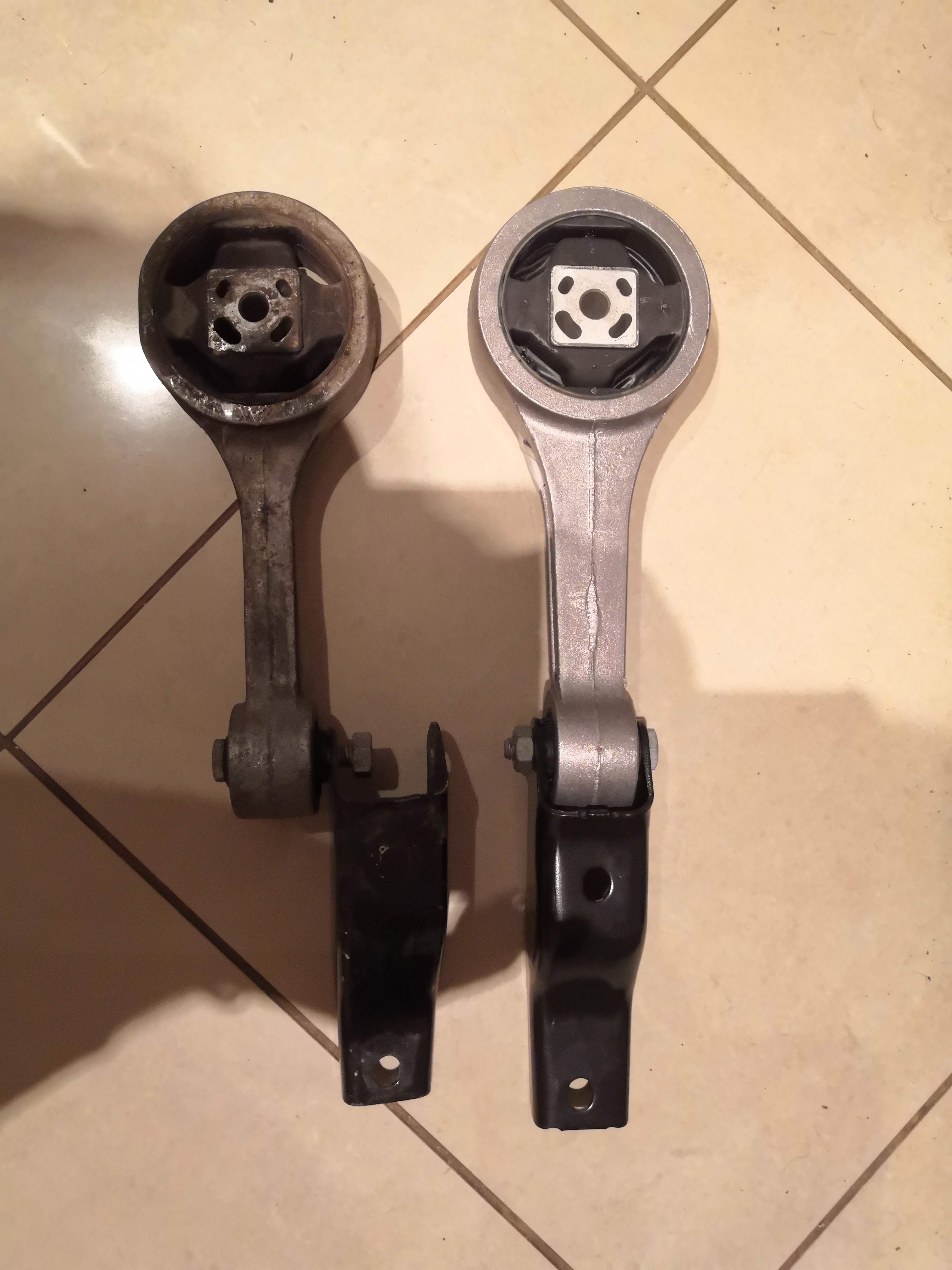

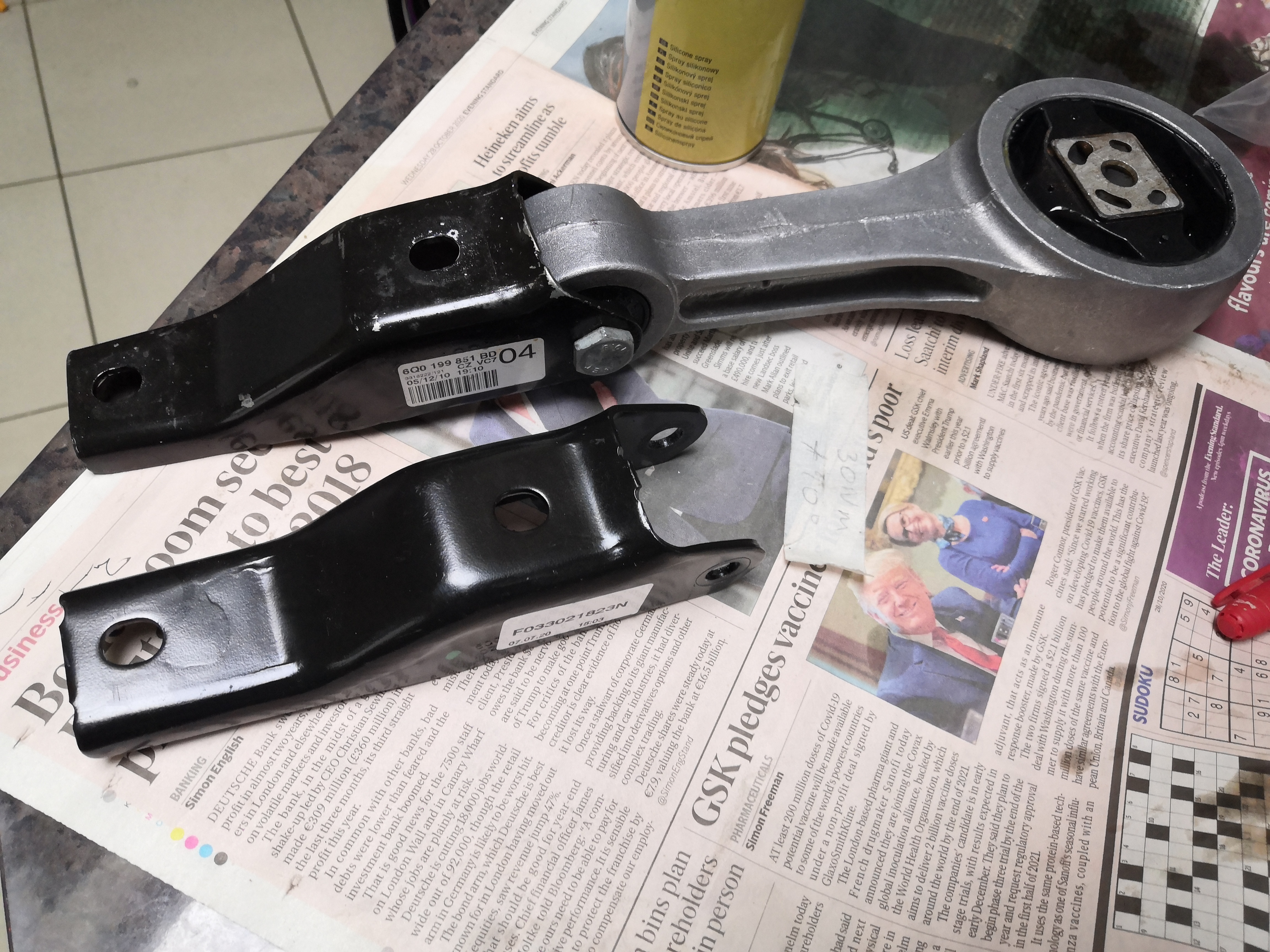

you'll have to swap over the bracket that joins the dogbone to the gearbox end,  .. taken from your existing dogbone.. as they're slightly different lengths:
LEMFÖRDER Dog-Bone / Pendulum Mount Engine Mount (Rear)  36324 01
aka.
VW 6Q0199851AP
Old Bracket swapped over onto New Dogbone:

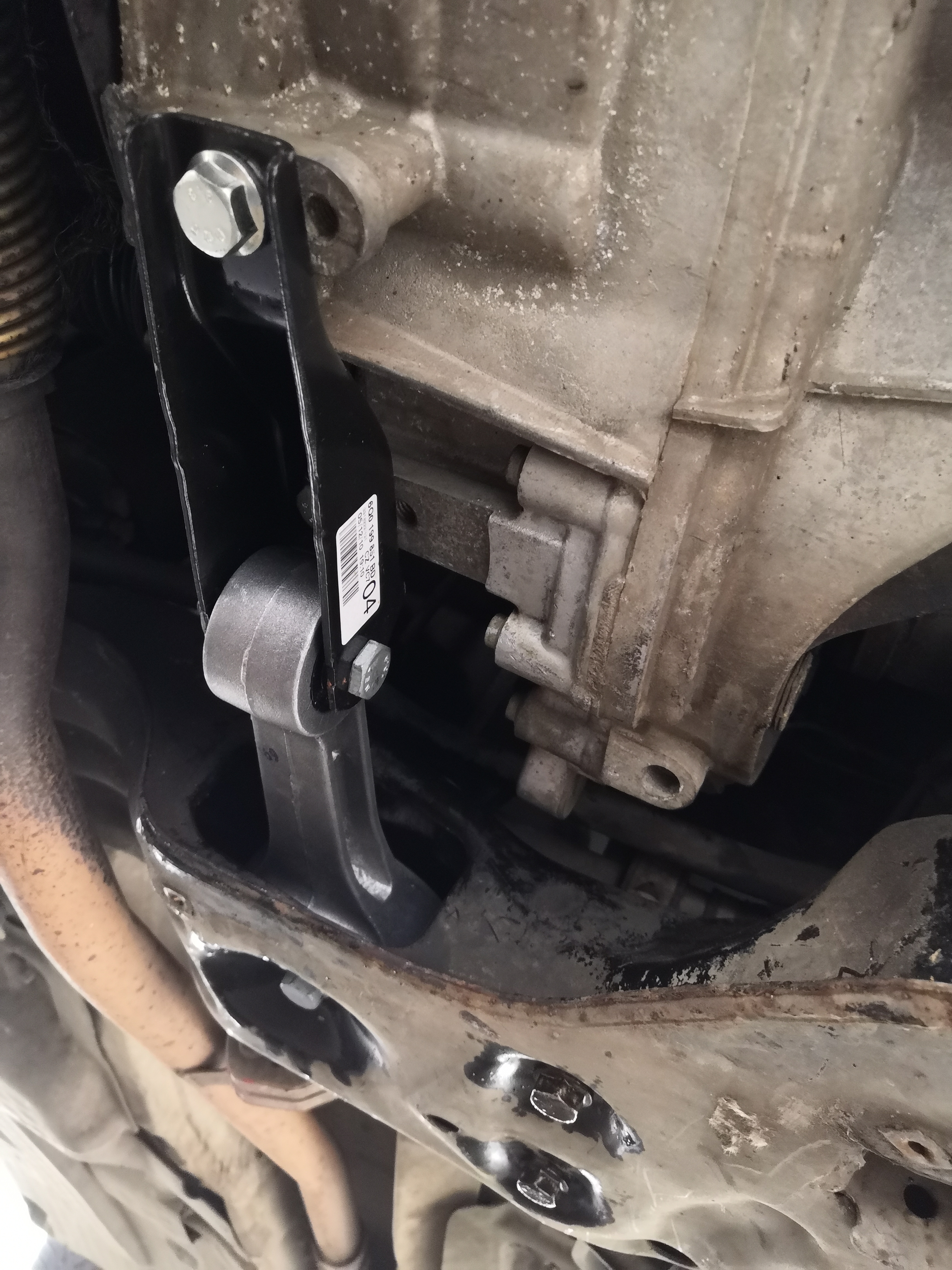

Fitted. and together with uprated:
LEMFÖRDER Transmission / Gearbox Mount  29978 01
aka.
VW 6Q0199555AS
... the nearside / passenger side wheel hop has completely disappeared 👍
..and definitely can't move the engine about with your hand .. like I could before..
If it's just the bracket differentiating the part numbers, then that's a win and the Vibra-technics will fit.
Thank you!
