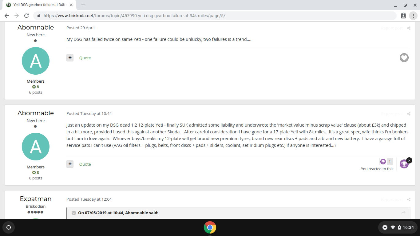

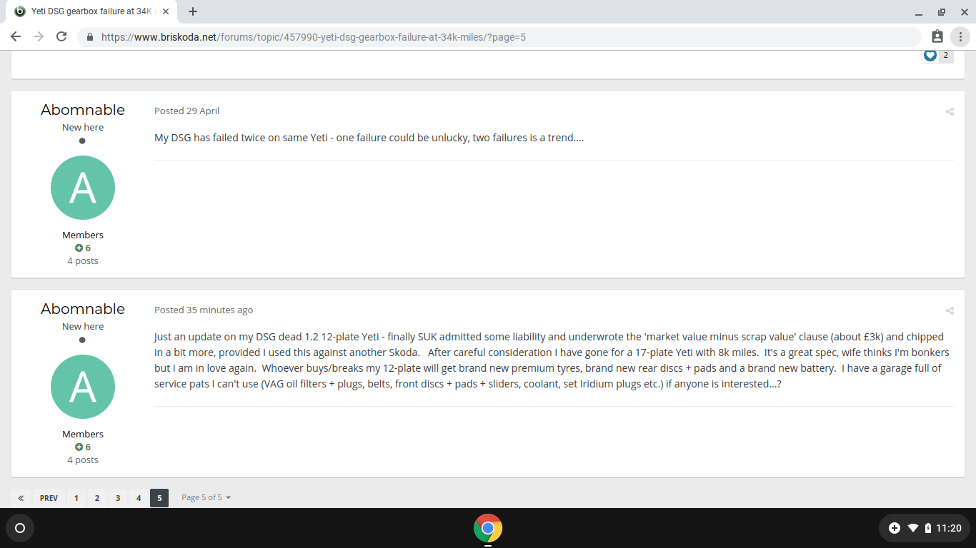

Below is from a thread in the Yeti Section.

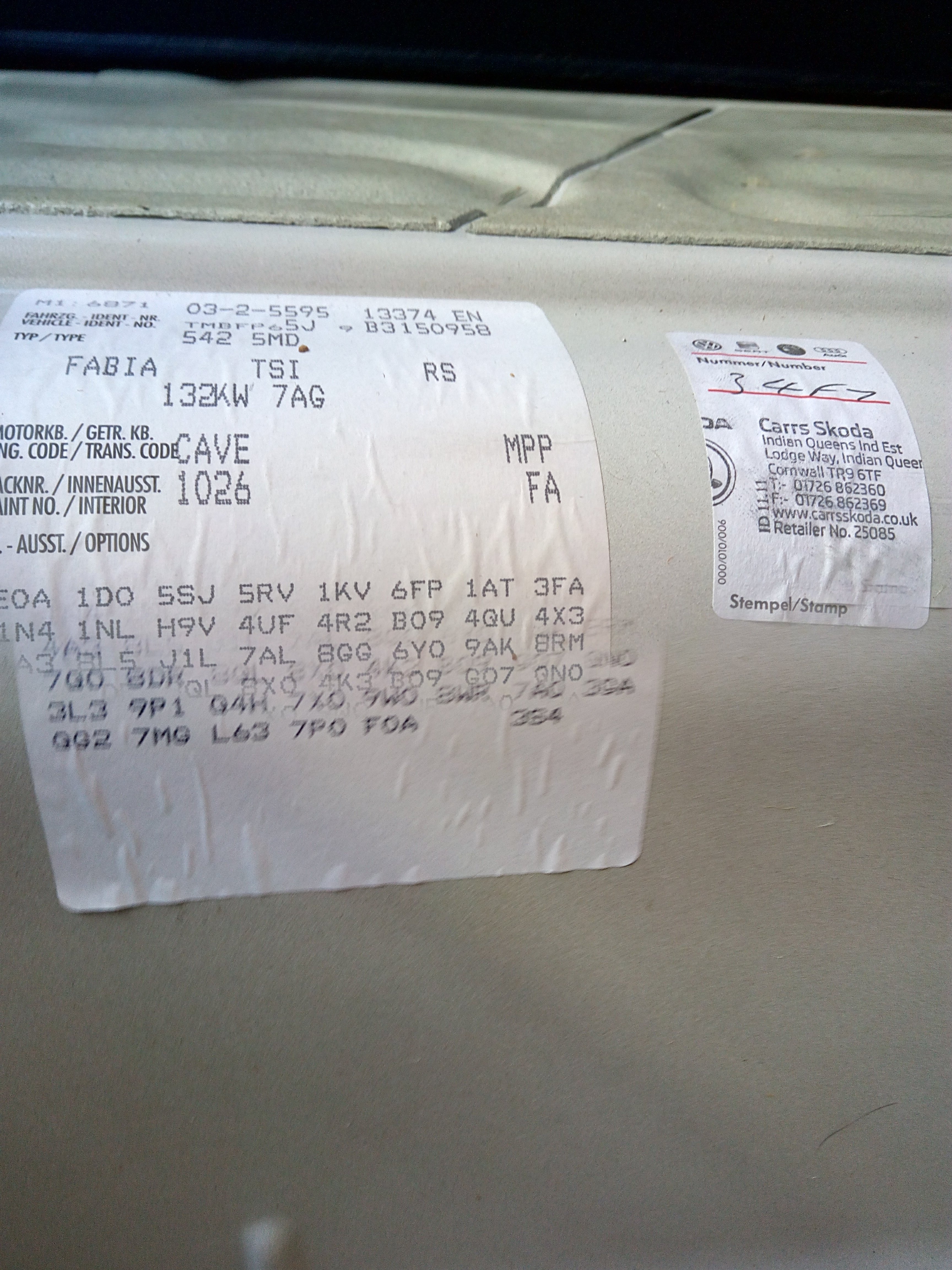

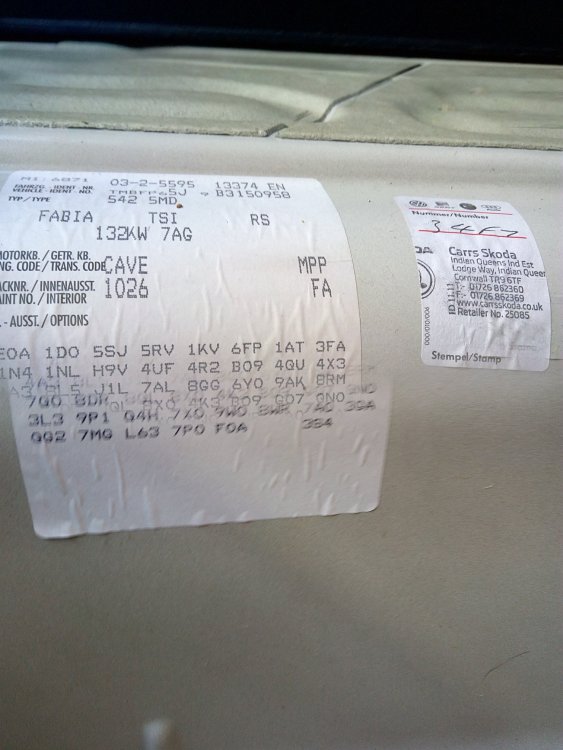

So did your car have 'Service Campaign' 34F7 carried out since May 2014?
Synthetic Oil changed to mineral and a software update.  There should be a sticker in the boot if it had this.

2009-2012/13 there was internal corrosion in the DQ200's so a World Wide recall (2012) excluding Europe that VW said was not affected as not Humid, not extreme climates and such rubbish.  Yet in New Zealand all DQ200's were Recalled and got new Mechatronic Control Units fitted for free.
But they still had to do a Service Campaign in Europe because they lie.
It really does not matter if your Clutch Pack is going, but it can help you get some help from Skoda UK even though they will say not.
There was fundamental design failures, they know it and in other World Regions they extended warranties, not in Europe though.
Point is you have been to a main dealers, told there is clutch failure, so see if some Dealership has done 'Service Campaign' 34F7 already.

Can you check your VIN on here and see if an outstanding 'Recall Action'?
& the spare tyre well to see if there is a sticker with '34F7' on it.
