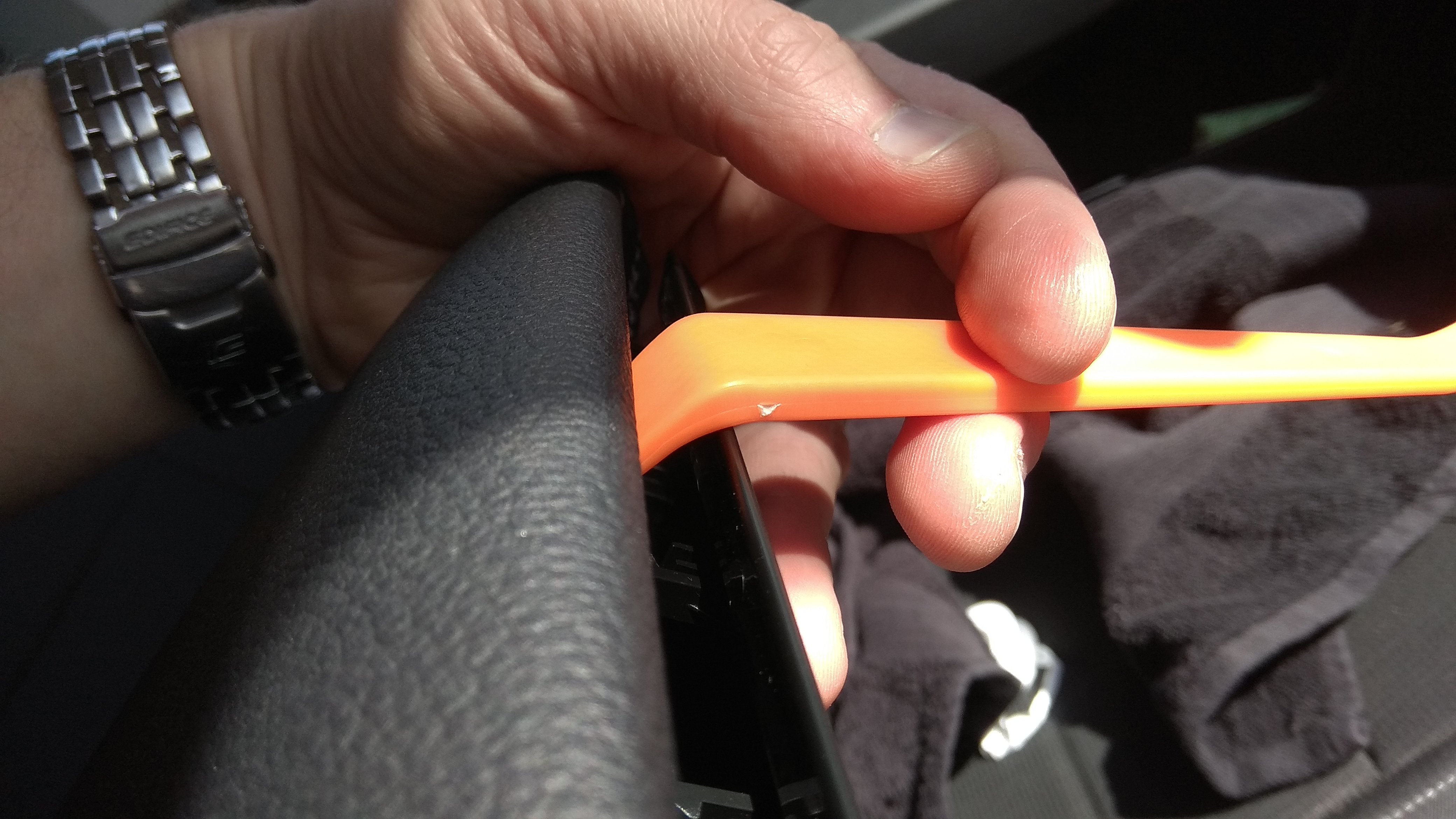

Any tips to removing the top and bottom parts?
i inserted removing tool into bottom part's edge and pushed just 1mm then moved 1cm forward and again 1mm,
after two full perimeters it gave up

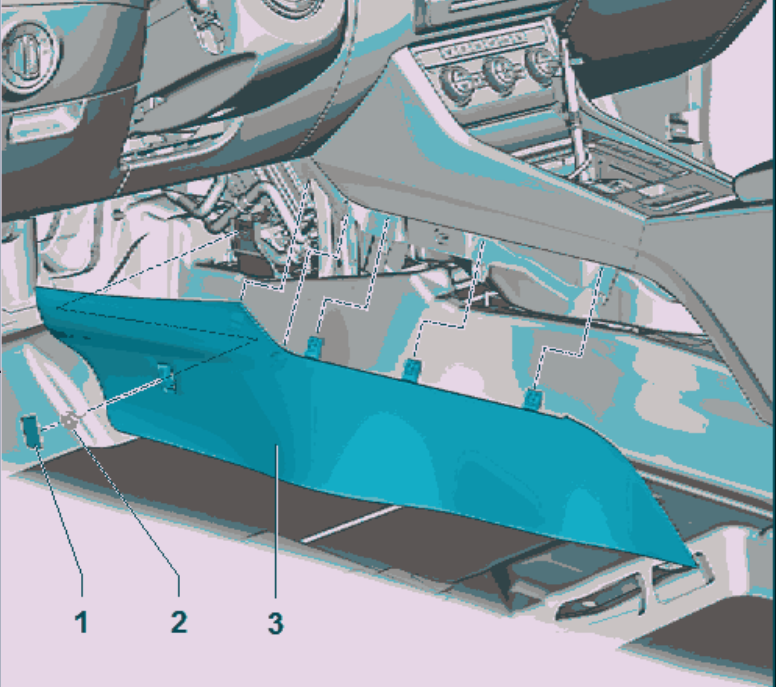

If I recall correctly the heater control panel was removed, the trim around the gearstick removed in order to gain access.
I may be able to come in from the side with a staw, silicone spray and foam bolstering... lets see.

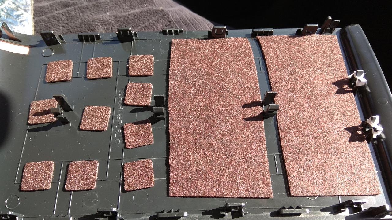

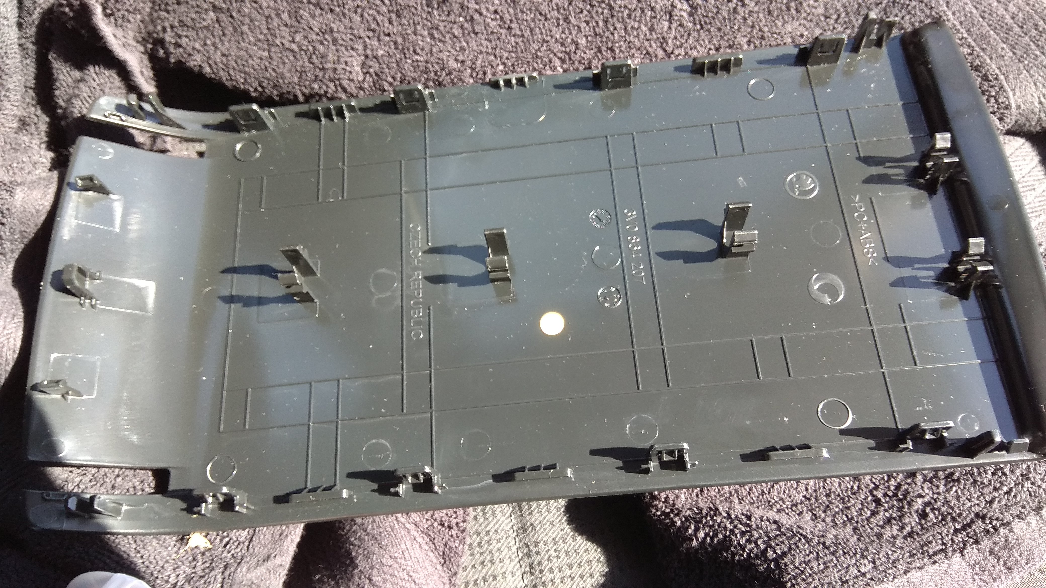

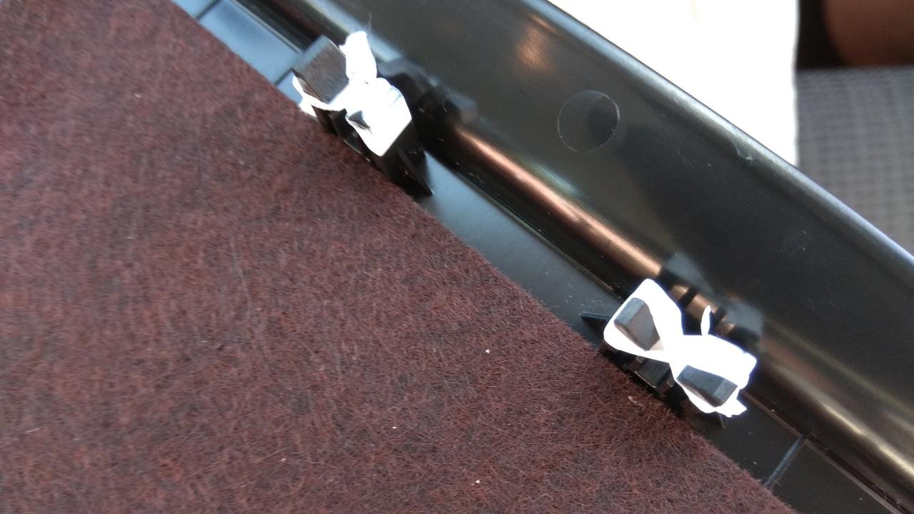

My creak was all on the bottom piece of plastic so prised it off, applied some felt pads and PTFE tape to the front tabs where is was noisiest.
Back together and lovely and solid.
Took about 15 minutes.
