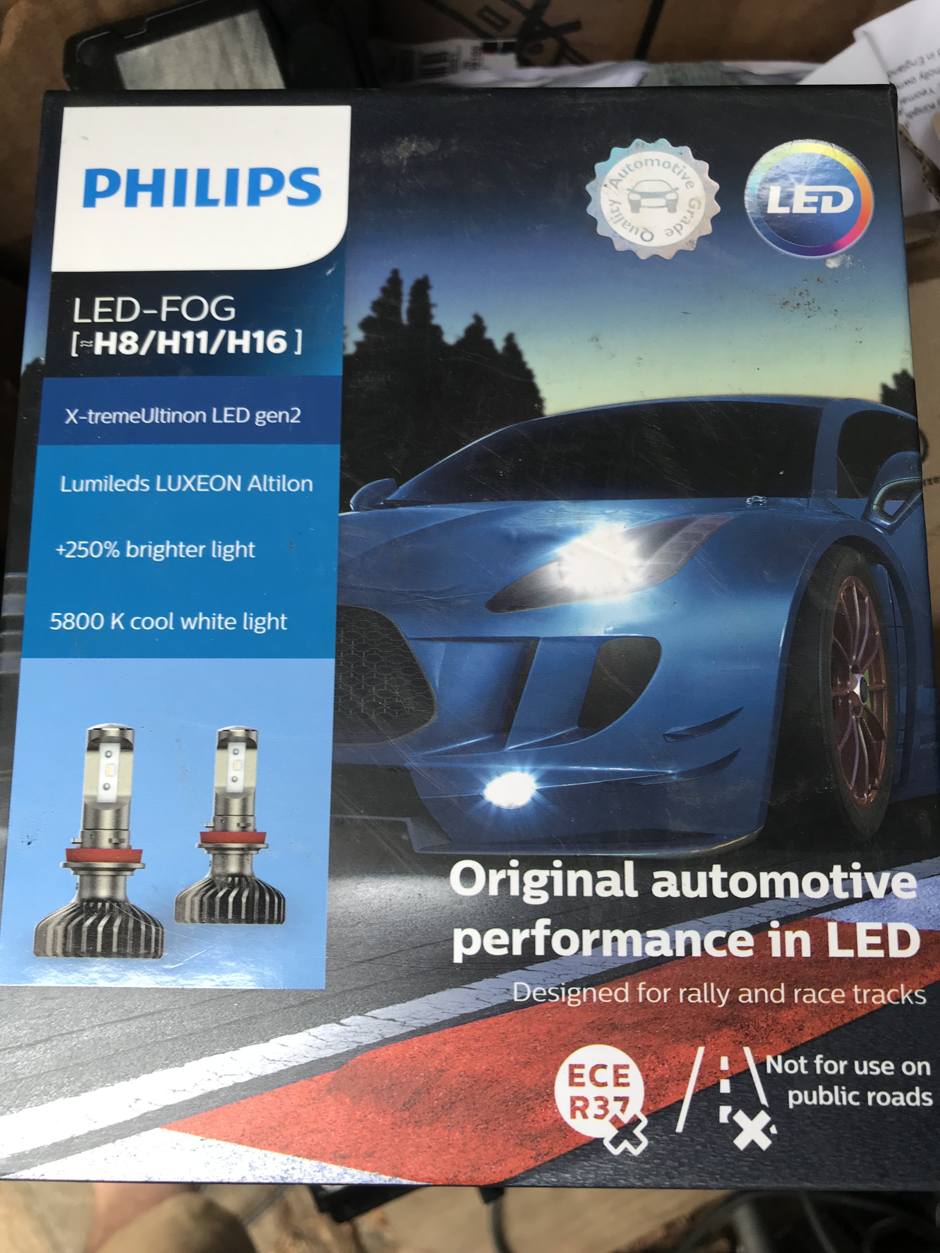

I finally found some good quality fog bulbs by Philips which look the same colour as the Xenon lights and have the correct beam pattern. Corner lights work as normal too.
No fault logged in the DIS which could have been turned off anyway with ODIS-e ( thanks for help with this Langers when sorting the rear LED units).
I also used their LED bulb kit for the DRL

I would think they are not cheap - quick look on eBay shows €100 to €160.
Keep in mind that the packaging also states "Not for use on public roads" and a few of the vendors point out that "PLEASE NOTE: These headlight bulbs do not have ECE approval for use on public roads: their usage is limited to ‘off-road’ applications."

re not for use on public roads, that is true, but using 100W H4 bulbs and any form of aftermarket xenon kit is the same. At least the beam pattern is correct and they are made to a very high quality you don’t blind people with these ones.
It is down to the expense of getting the approval more than it not complying with the rules.
Went through its mot without an advisory. I think if they looked blue or the beam pattern was a mess during the beam test they may have taken a dim view.
