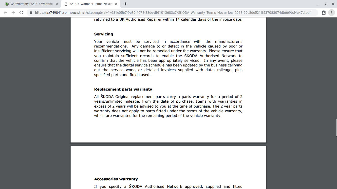

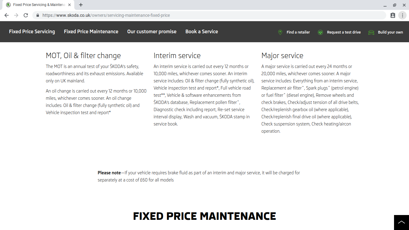

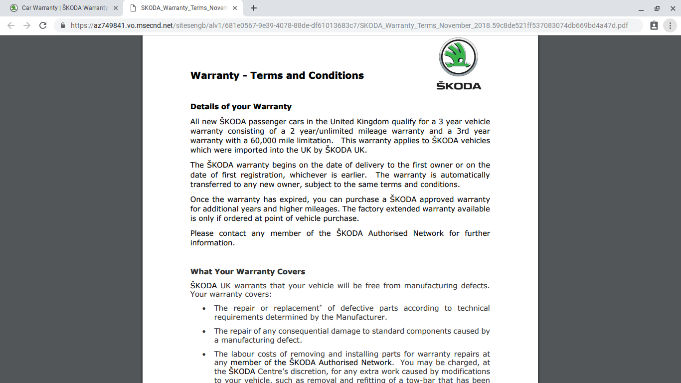

@Eccles
Read the warranty T&C's.
You say 'must be done'.
A Service Plan does not include Brake Fluid changed at 3 years and a Skoda Approved Car sold at 3 years with a 12 Month Warranty & FMDSH might not have had the Brake Fluid changed or the Air Filter.
It would be good if Skoda / VW did not say 'Manufacturers Recommendations'.
Skoda are who does not set out clearly in the UK / Europe / Globally what is a 'Recommendation',  a Service Schedule, a Guideline etc.
Some Dealerships will tell you the Spark Plugs are good for 65,000 miles, but then 40,000 miles is the Recommendation.
Air Filter is 4 years / 40,000 miles or sooner, but then you need to look see to know.
A City behind busses might have a blocked / dirty air filter sooner than country roads lined with Oil Seed Rape.
Pollen / Cabin filter at 2 years.  Oil Seed Rape, Sea Air, wet winters might need a Pollen Filter changed annually.
