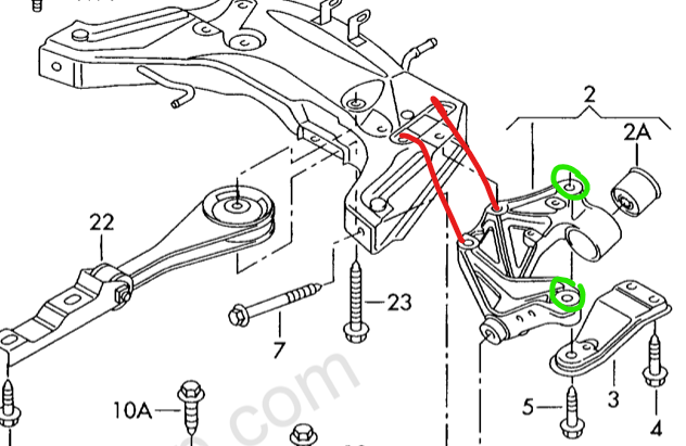

    Not the subframe, so much as the consoles plus subframe assembly.   There are two M12 bolts through each console that go vertically upwards into fixed points on the chassis. The holes they g

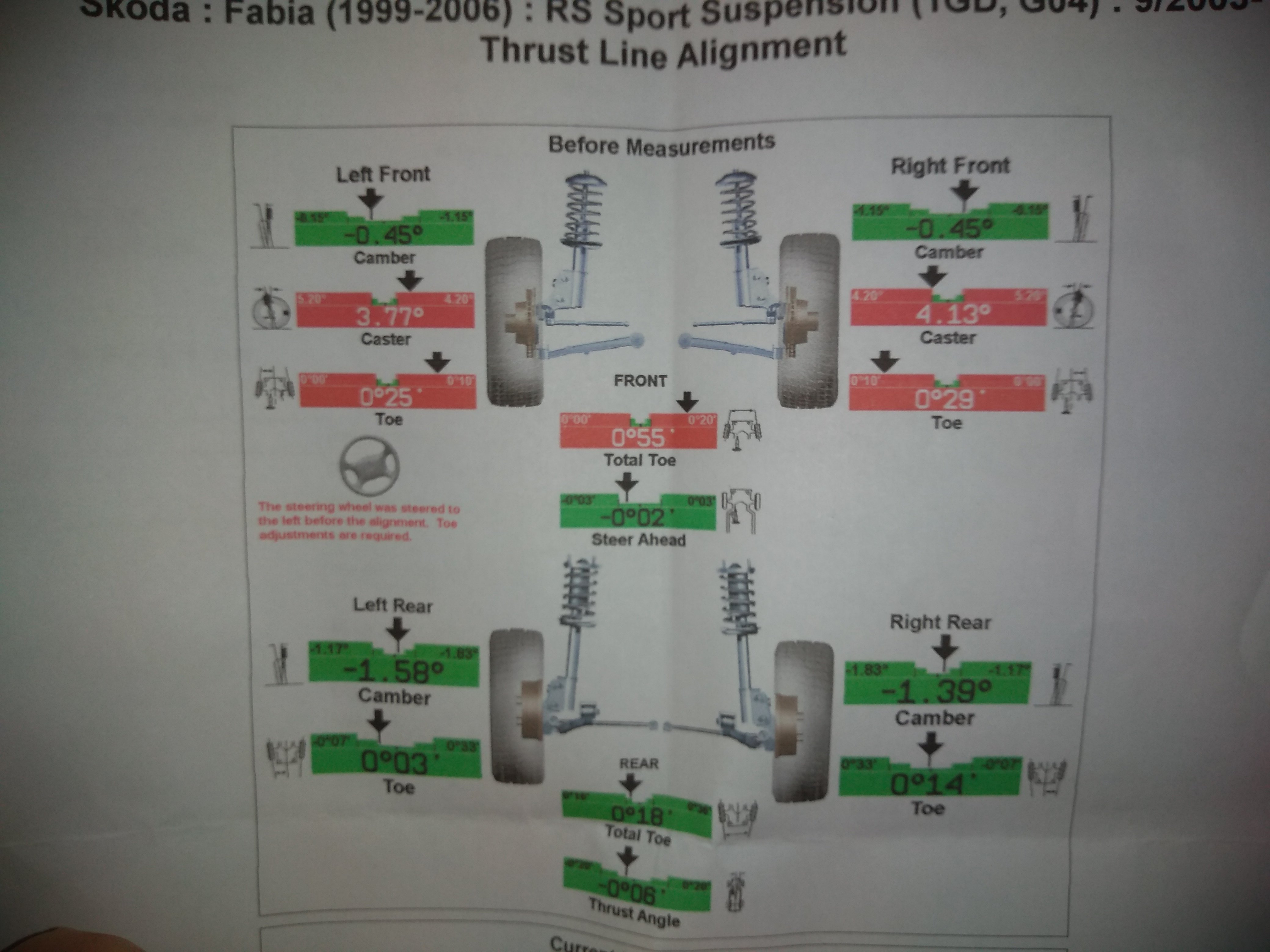

I don't see any 'before' measurements, just current ones?
Remember the figures I am quoting are from the KwikFit job I got done on my daughter’s late 2009 Ibiza, so it got an initial set of results then the toeing was adjusted and so a second set of results were printed off.
See here

The two red lines show the bolted joints between consoles and subframe (and steering rack actually). No meaningful amount of adjustment there.
The green circles show the two holes in each console that are a loose fit around the M12 bolts that mount the consoles + subframe as a whole to the chassis.  This does allow a small amount of movement in the X-Y plane. If X is along the length of the car, then this will vary caster angle(s), Y would then be camber, and 'equalisable' by moving the whole lot side to side.
Just to confirm,
Loosening the green bolts will allow adjustment in the X axis, forwards in my case to get more positive caster angle.
Do I then need to loosen the other two bolts with the red line going to them, or can the green circled bolts on console pivot/swing around them with them fastened up tight?

Think of the subframe plus a console either side as a single solid entity. All that attaches that entity to the car body/chassis is the bolts - two each side - that go through the holes ringed in green. No need to touch anything except those four bolts.
Two green left side and two green right side? Or two green left side AND
loosen two red bolts. Sorry to persist I just want to be sure. Ta

For what it's worth, I suspect situations like yours may happen where a previous attempt at changing a console bush (wishbone rear bush) has gone wrong and required a new/replacement console.
This can easily happen if the front wishbone bolt (the one I thought @Tilt was talking about before we learned he wasn't thinking Fabias) seizes in the console and breaks off in, or strips the alloy thread.
Imagine if the car is jacked up at just this one front corner (assuming driveway DIY job), while the knackered console is being unbolted from chassis and subframe, prior to the new one getting put in. The chassis could be forgiven for having a teeny bit of a twist in this situation, especially once the last M12 bolt holding the old console to body is released.
Then the new console gets bolted in and tightened up, with all the attention of the DIY'er focussed on sorting out the nightmare of the sudden increase in complexity and cost of the job, instead of the precise alignment of the new console/body position relative to where the old one was. That could explain the asymmetry you're seeing.
Any sign that either console is newer than the other?
This ebay listing from one of our own members has a photo that nicely illustrates the 'single entity' that is the subframe plus consoles (and even wishbones in this case) and the fairly gaping 17mm diameter holes that are ones I've ringed in green in the ETKA diagram.

I'm confused, all the caster measurements look to be within tolerance so I'm unclear what the problem is?
Layout of the results printout demonstrating its inbuilt crappiness and tendency to confuse.
Here is a link, I hope, to how the Hunter alignment bench is operated and shows how the castor measurement is "made" ie the steering wheel is rotated to give  "X"degrees of "turn" to the front wheels - just for information really, that is all!

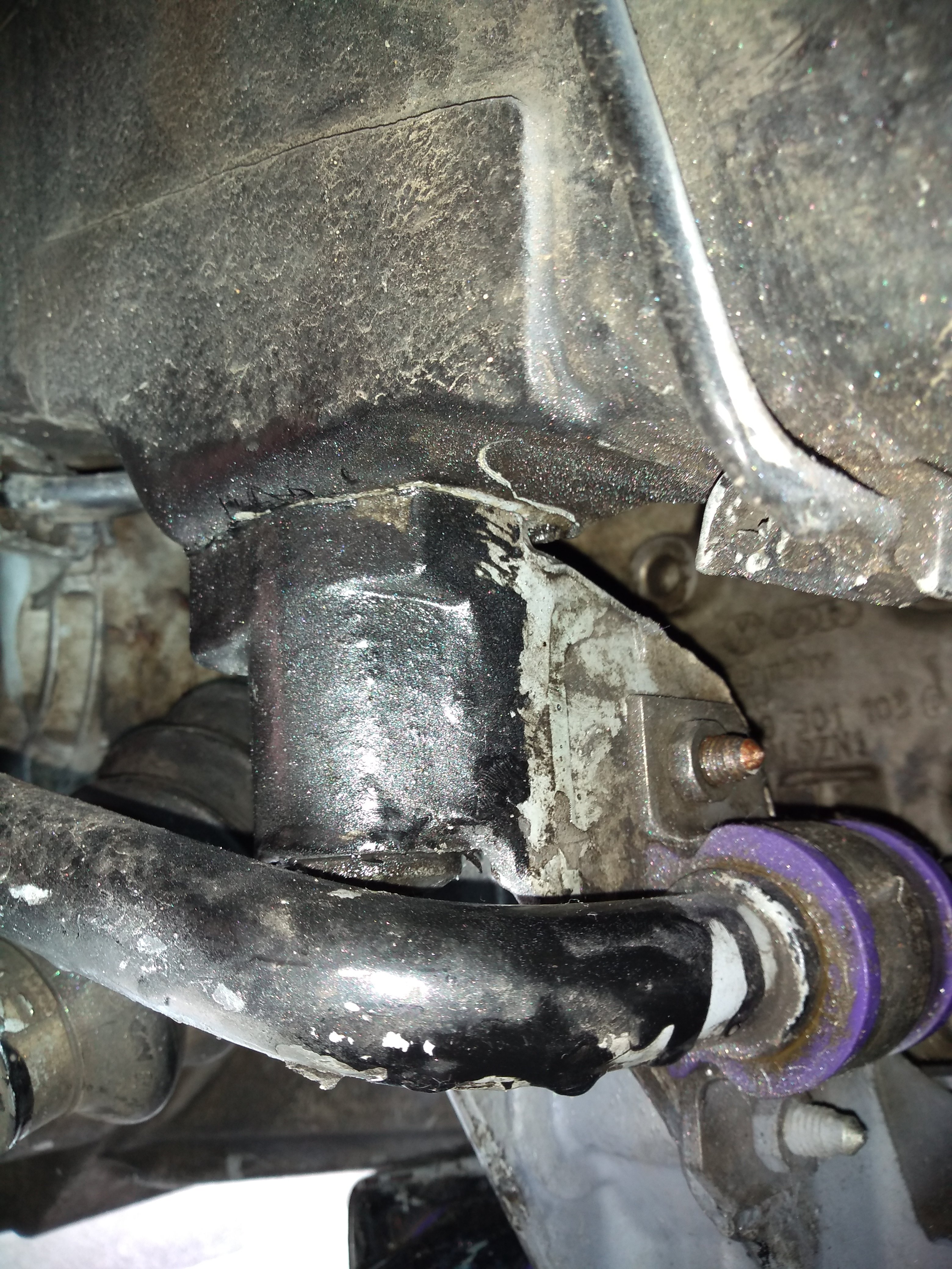

I decided in the end to adjust when I saw one of the front bolts marked in green was off centre, like the console had been pushed back. I have got at least a couple of mm maybe more.
See photo of after. The grey bit/ line s how's the movement I gained.
It helped with another jack to take weight/ support lightly the console. I managed to wedge wood between brake disc and wheel arch to lever / extend forward to make castor more positive. I'll get alignment checked again and see how it drives and report back.
Ps bolts came away ok, but I used gt85 1hour before attempting to remove bolts.
