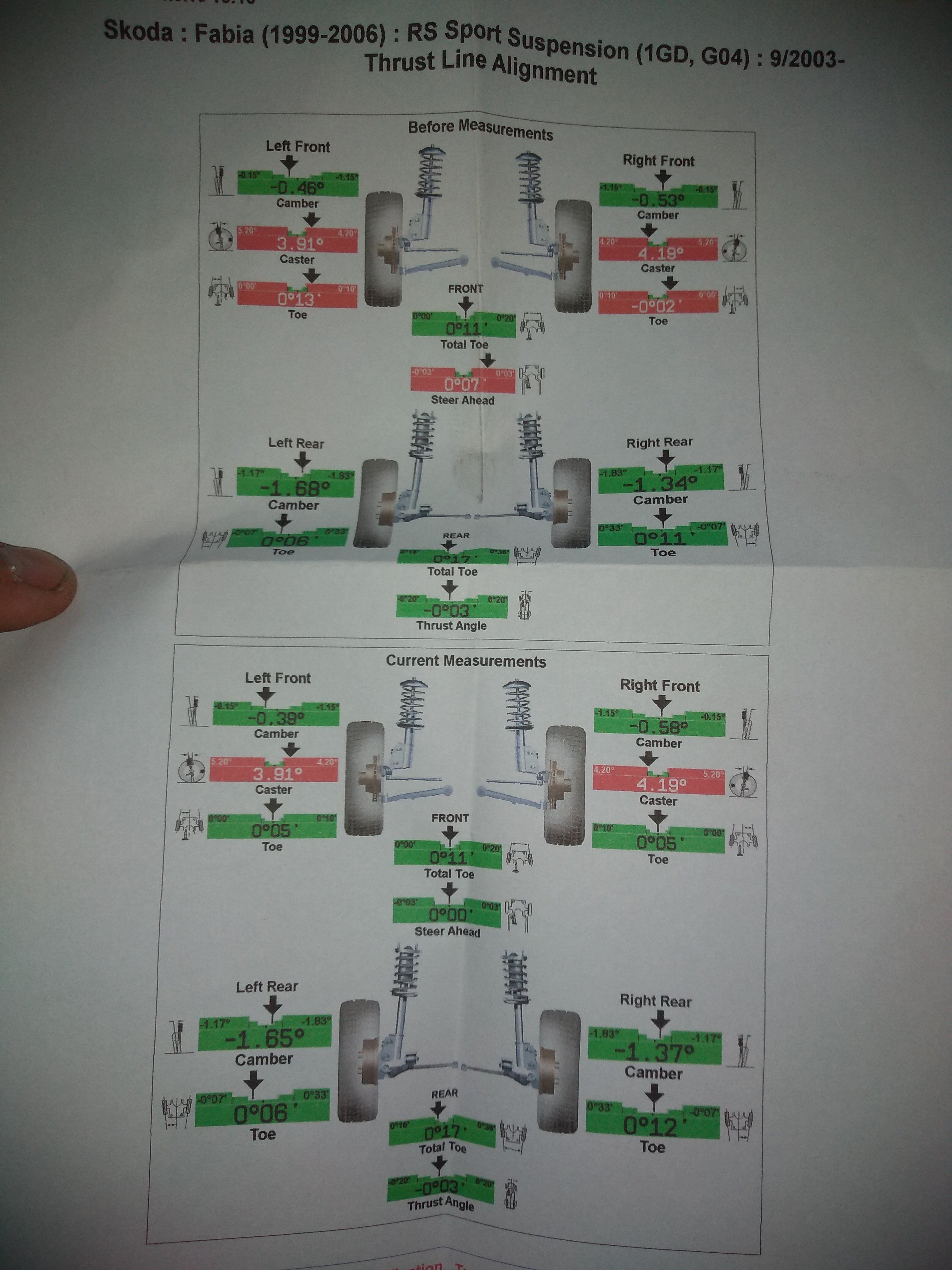

12 hours ago, bmbmdmb said:
Update:
After adjusting the caster on front left side by movement of console forward, a small change in caster has occurred, by 0.14degrees. The difference between left and right wheel castor values is now within 0.30 max castor. Probably not worth effort
This threw out the toe slightly, which was then readjusted on Hunter alignment system.
BTW the operator did turn wheel out to obtain castor value , as mentioned earlier in posts.
Since your deviation between left and right was already within the 0.5 degree maximum before your adjustment and the manufacturer's figures refer to a brand new car rather than an elderly car with tired springs, the point of the adjustment is somewhat moot.

30 minutes ago, sepulchrave said:
0.5 degree maximum
0.3max on the Skoda workshop manual online.
Yes, I would not have bothered if I had not been having an alignment done anyway. Thanks

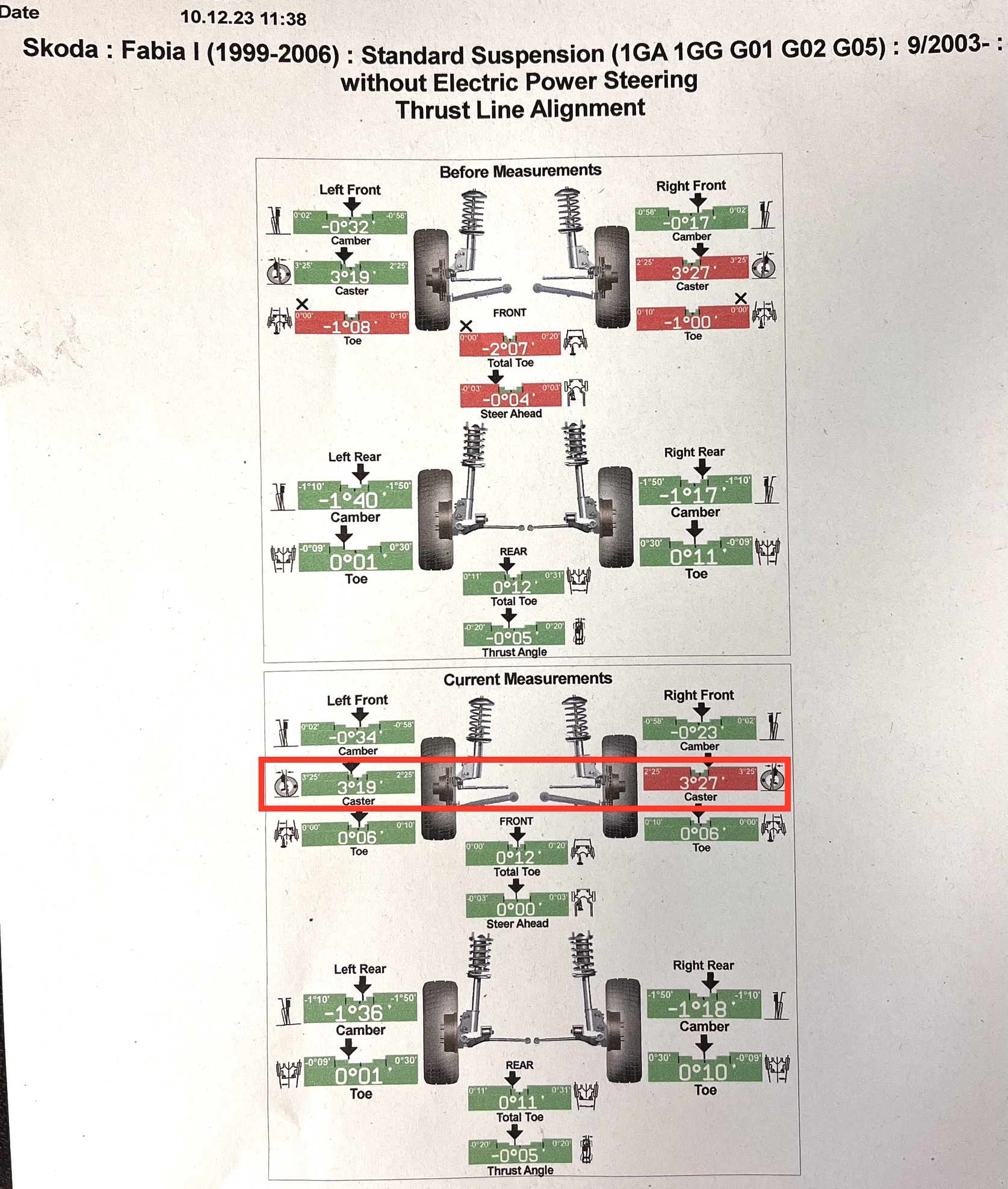

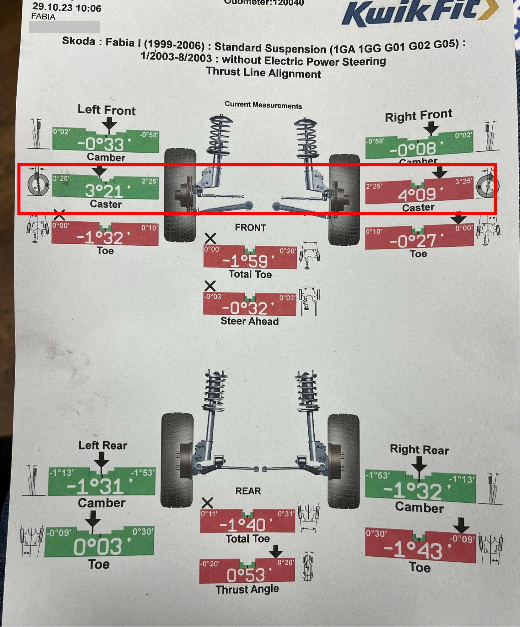

The issue was the caster; caster not positive enough on the left.
This thread has been a lifesaver as I think I've now sorted it. I know that I needed to move the bottom console further forward on the left to make it more positive (I guess to match the other side, I don't have access to fiddle with a hunter alignment machine)
I put the car front on stands, undone the four bolts as shown in the vid, (I just show one side in vid) (you will need a breaker bar for the top bolts) and then the subframe+consoles twist as one complete thing so the left is as forward as poss and right is back as poss. See video.
my car finally has stopped pulling left.
thank you all.
Hunter printouts are both before.
if I get one done soon. I will
add that as an after result.
Edited by Gman1978
