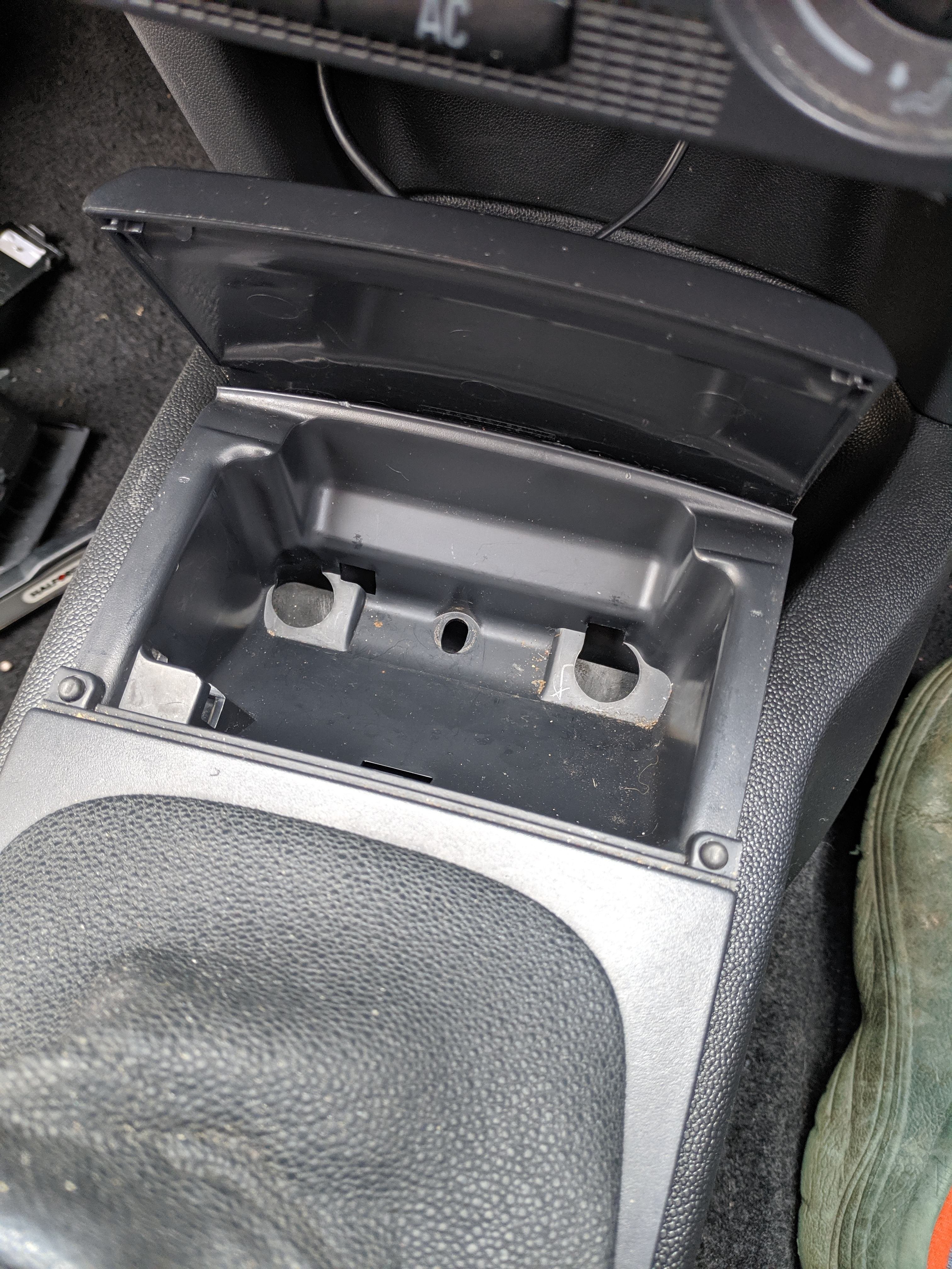

  1. Lifting the gear gaiter. This is a really simple step - Lift the ash/coin tray out of the front where you'll see three screws
    IMG_20190606_141034.thumb.jpg.52284403aef3050d9e97698642fa8a7e.jpg[image 2] Pictured is the holes, the screws have been taken out. These are T20 screws
  2. Unscrew these, removing them from the tray and placing them somewhere safe
  3. You can now lift out the tray and gear gaiter. The gear surround is clipped in (You can see the two left clip holes in image 1). Once unclipped you don't need to take it all off, otherwise you'd need to remove the gear knob.

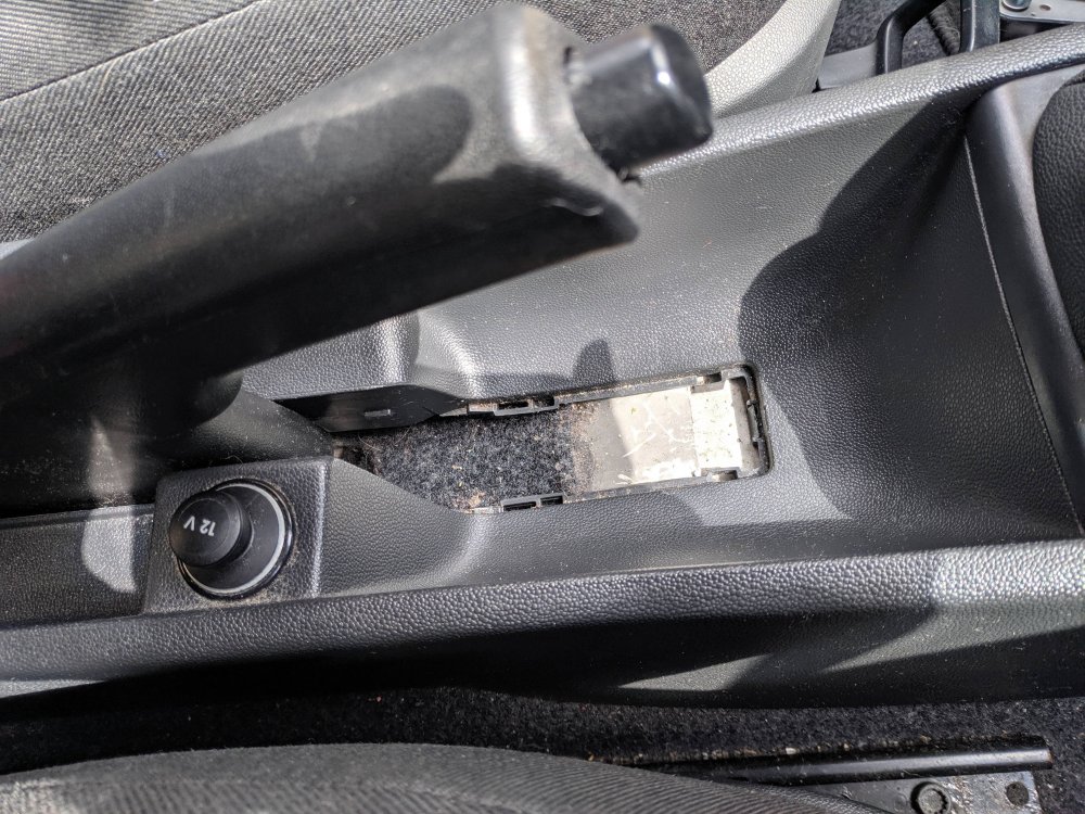

  4. Lift the tray at the back of the middle section. (The rear ash tray) where you'll see two  T20 screws
    This so happens to also be the location to adjust your handbrake cables.
    IMG_20190606_141025.thumb.jpg.3988011c168694228142e651359b9098.jpg[image 3]shows the rear ash tray removed, as well as the screws.

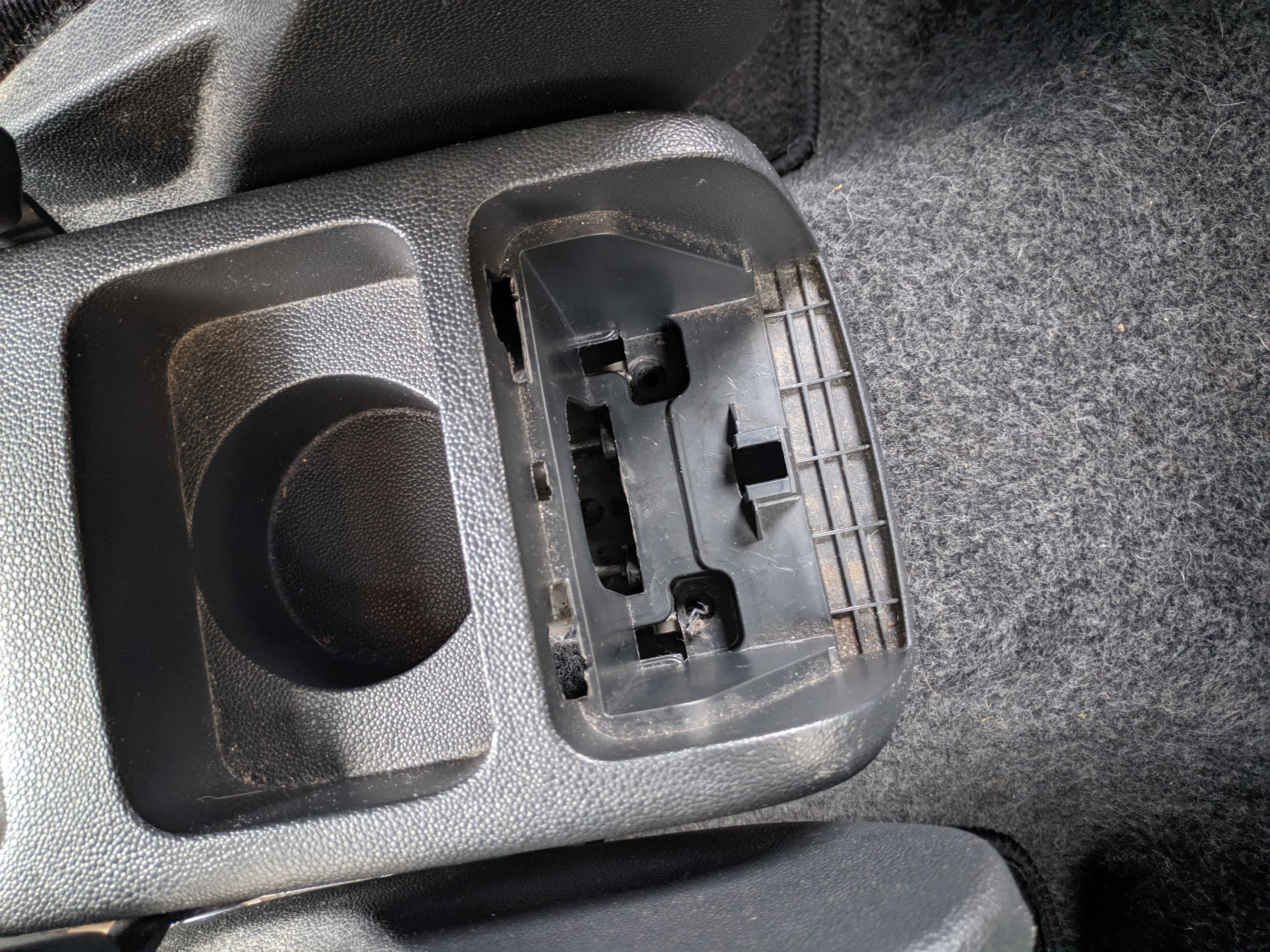

  5. Now we need to remove the cover located where the hand brake is. Again, you just need to pull it out which can be difficult but you may use tools to push the clips.
    IMG_20190606_141607.thumb.jpg.df0cfa2ee211abcdcc85a1b50705d418.jpg[Image 4] is the cover removed, here you can see the clips and all the dirt that collects there
