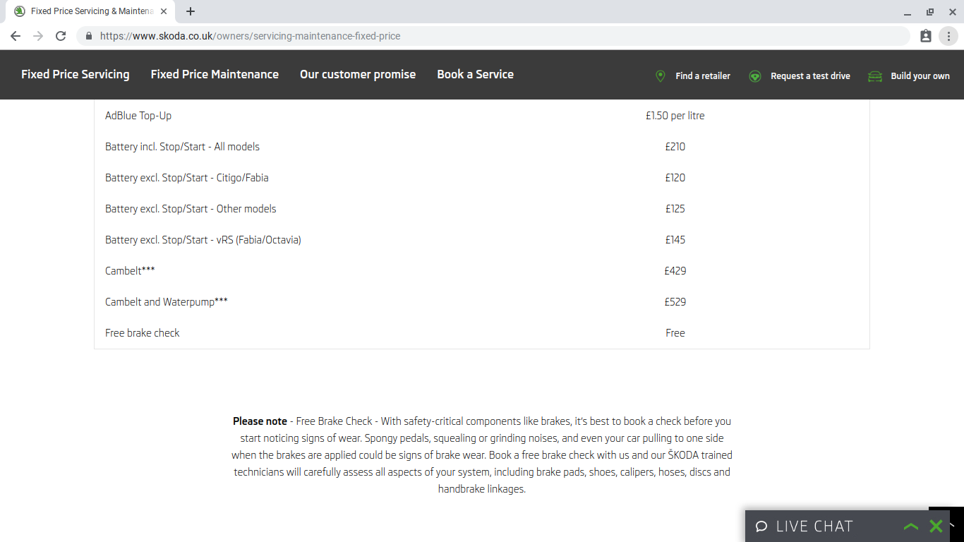

Free Brake checks.
Amazing how many MOT tests might show Scored Brake Discs, yet Skoda Approved Used cars are sold with Scored or pitted brake discs that the 'pre sales checks' do not have the Dealership technicians replace the discs and pads.
Brake servicing is sensible. but not part of Main Dealership services, or Service plans.
