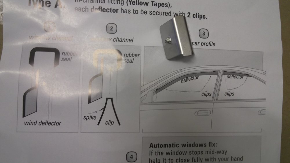

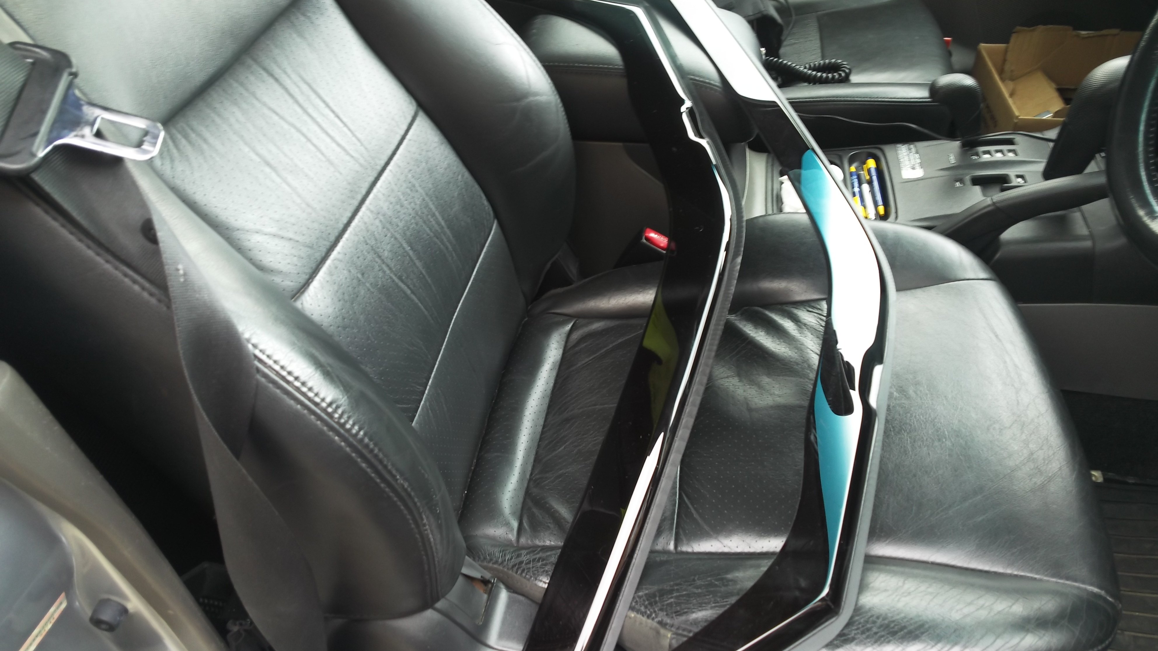

Todays arrived with different clips, showing different way around and also yellow tape on the deflectors. (Not red tape, stick to outside / paint.)
I will be gone, 10 minutes, or maybe 20.... Could be longer if they snap.  Room temperature is bl00dy freezing.
