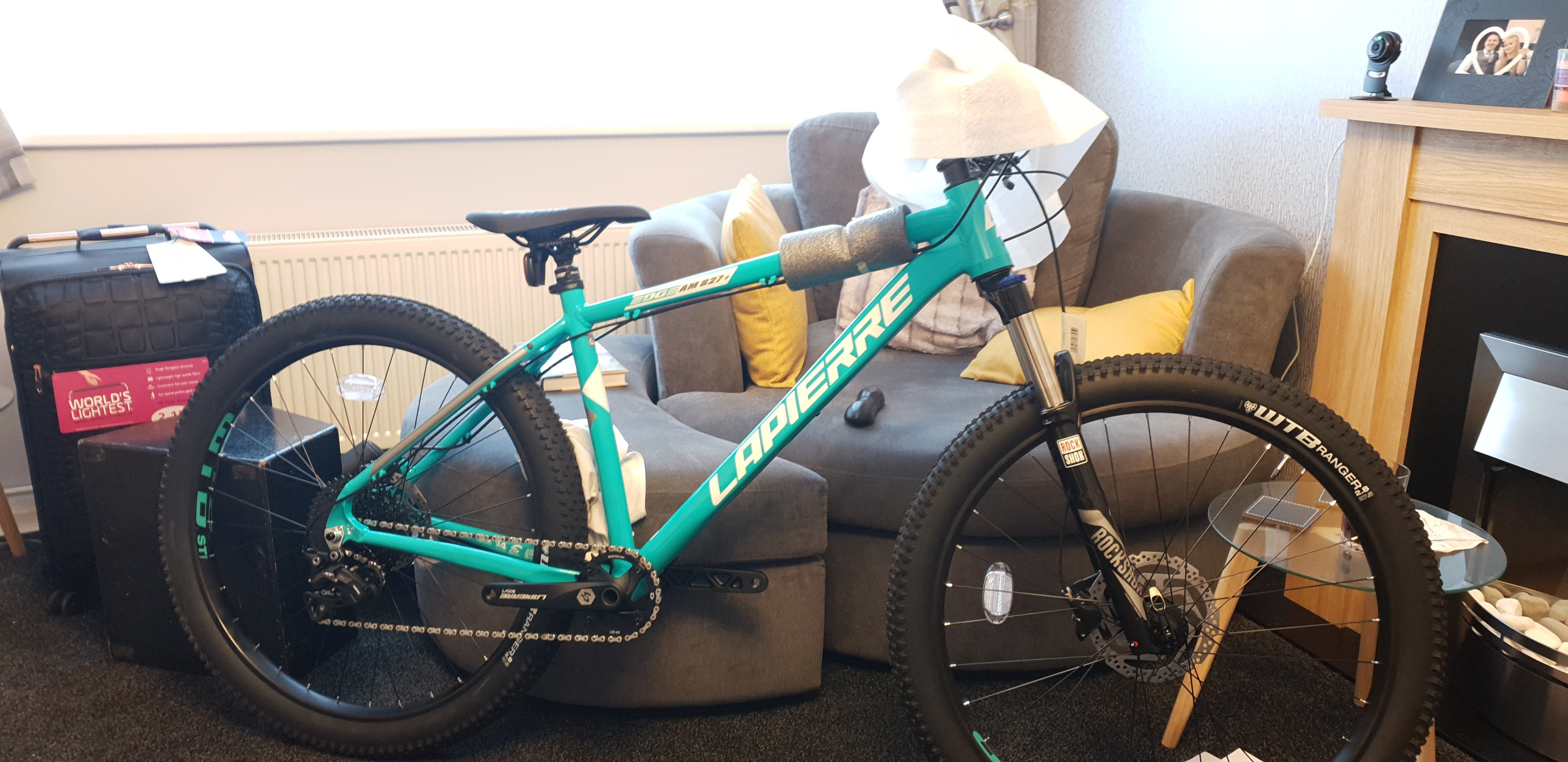

Ended up buying a LaPierre edge 827+.
Just need to go get some pedals and take it out now.
Looks good. Be interested in how the plus size tyres go.

so far so good, it's very smooth when riding quick irons out a lot of the bumps with the large volume although I want to change the front tyre as I've lost it a couple of times in muddy conditions.
next changes for it - go tubeless first to see if a lower pressure will help with traction at the front end  failing that ill move to a nobby nic or margic mary (MM was on my last bike and has been excellent)

Tubeless will make a big difference in grip, definitely try that first

 dropped the front pressure down to 20psi (tubed) rear seems to be nice at 30psi  was definitely better at Sherwood pines at the weekend - back again this weekend so try a slightly faster run this time. it's better but still not as confidence inspiring as MM were might end up swapping the front to a 2.6MM.
Ill be 100% going tubeless for the next run - any suggestions im running WTB I40 rims
ive heard sod rim tape and go for gorilla as this holds better (being tubeless ready- does this just mean the tyres or the rims are ready to go as well?)  I was looking at the Stans no tubes kit
Tubeless ready just means the shape of the rim is good for it. Still need tape and yes gorilla tape is good. I have Stan's tape in one and worked ok. Didn't in the other so went back to tube for a bit.
A tubeless inflator is a good idea too. Don't use cO2 jobbies. Unless the tyres are good to go with a track pump.
mine have both come already set up tubeless. 20psi is very low for a tubed tyre and you risk getting a pinch flat. My EX8 runs bontrager XR4's which are immense, never had problems even when others are complaining about a lack of grip.

Agree it's low however with the volume of air in the 2.8 plus size it seems to handle it quite well,  wouldn't go that low on my old 2.2 tubed
