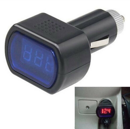

The round model (bottom) is the one I settled on, while the direct-plug models were grossly inaccurate and drew up to 40 mA.

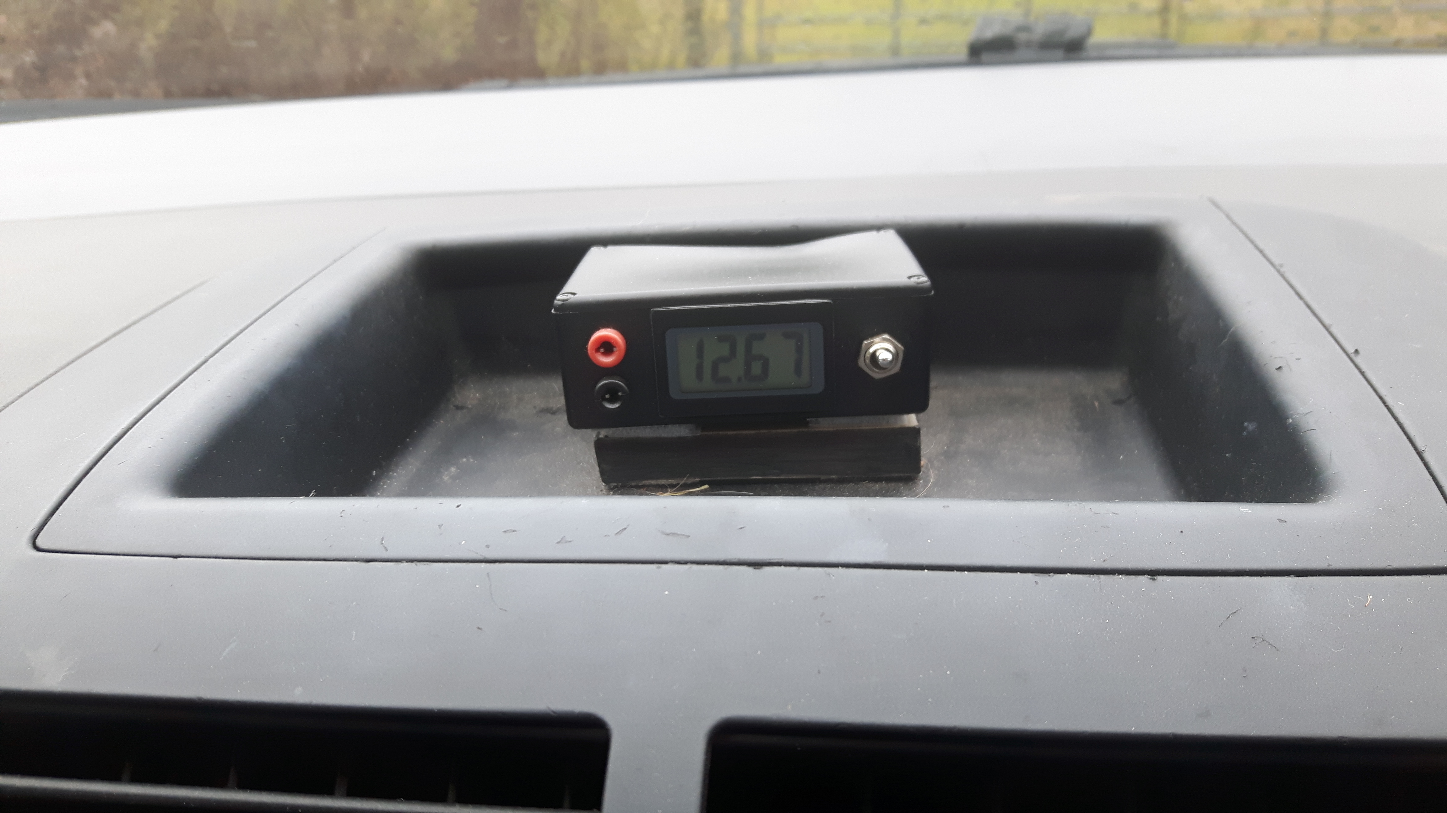

Can you clarify exactly what you’ve done here ab, you say it’s permanently plugged into the cigarette lighter but you also say the bottom one (13.8v ?) is the one you’ve settled on yet it appears to be a panel mount device.........Are you saying the bottom device is wired into the cigarette lighter circuit permanently?
Exactly.
The bottom model (displaying 13.8 V) is mounted on a  piece of aluminium sheet and resides raised just above the vane edge beneath the central armrest, turned laterally towards the driver's window. It's connected to the cigarette lighter by a short cable and standard 12 V plug.
55 minutes ago, agedbriar said:
Exactly.
Ah, I see, thanks.
Here's how it looks.
The wooden block is part of the support I'd made for my former Octavia. I figured it would look more solid than panel mounted directly to the aluminium sheet without any protection on the backside.
The car is currently connected to the battery charger, hence the reading.  :)
Edited by agedbriar

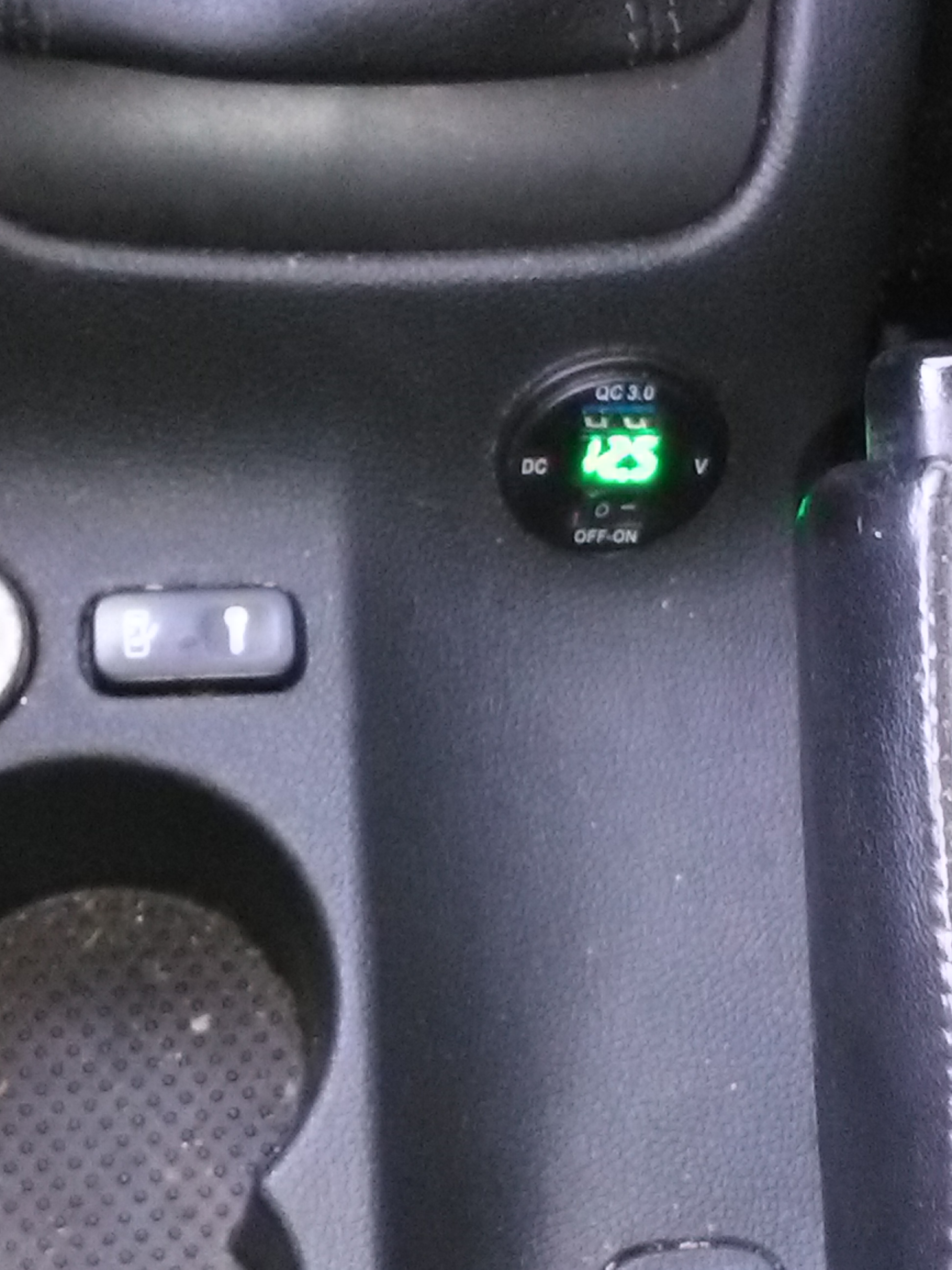

The one I use has a switch so consumes no current when its switched off, I leave it on so that I can see the state of charge through the passenger window, it was more visible in the console of the Octavia but this is the best location in the Yeti.
It has a USB port as well, accuracy of this one spot on, the last under-read by 0.2v which is still pretty good.
