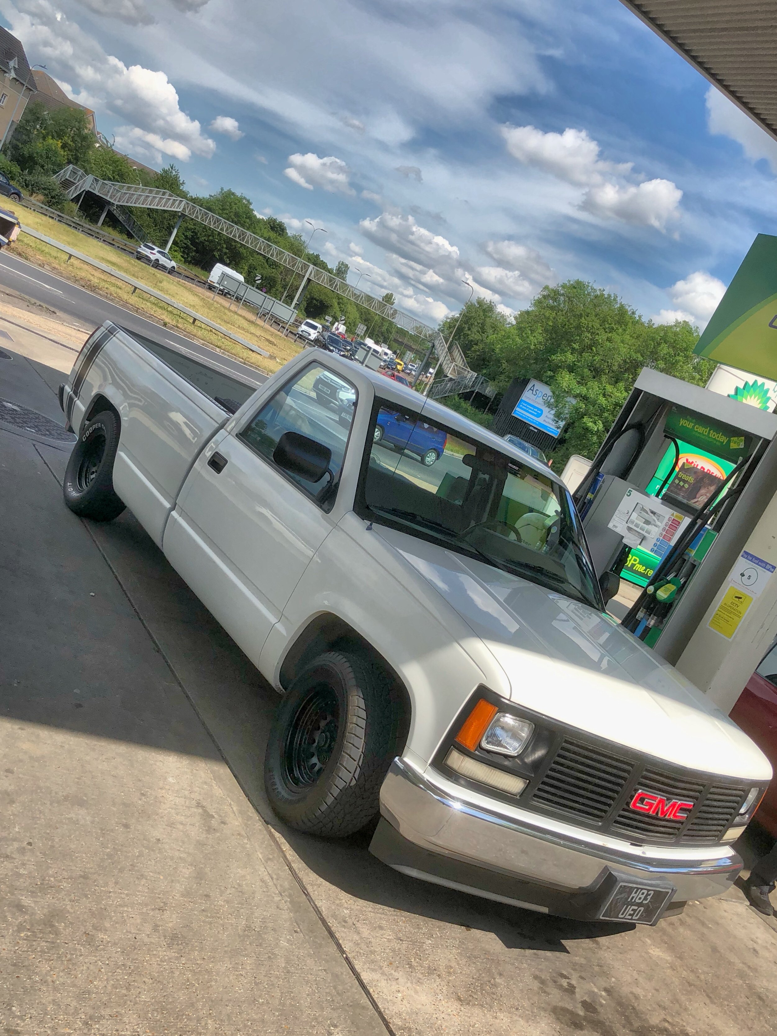

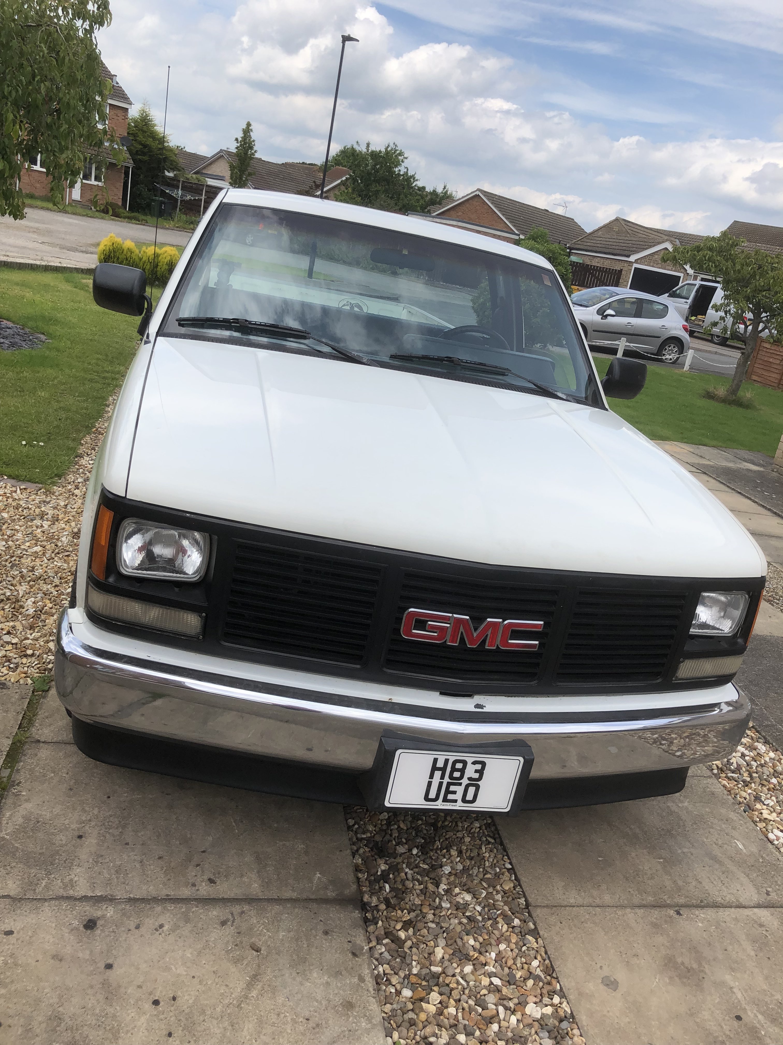

  • Done 150 miles this weekend and it’s been solid, have a pic. Going to my first show in it at the weekend so need to get the rest of my bits fitted before weekend

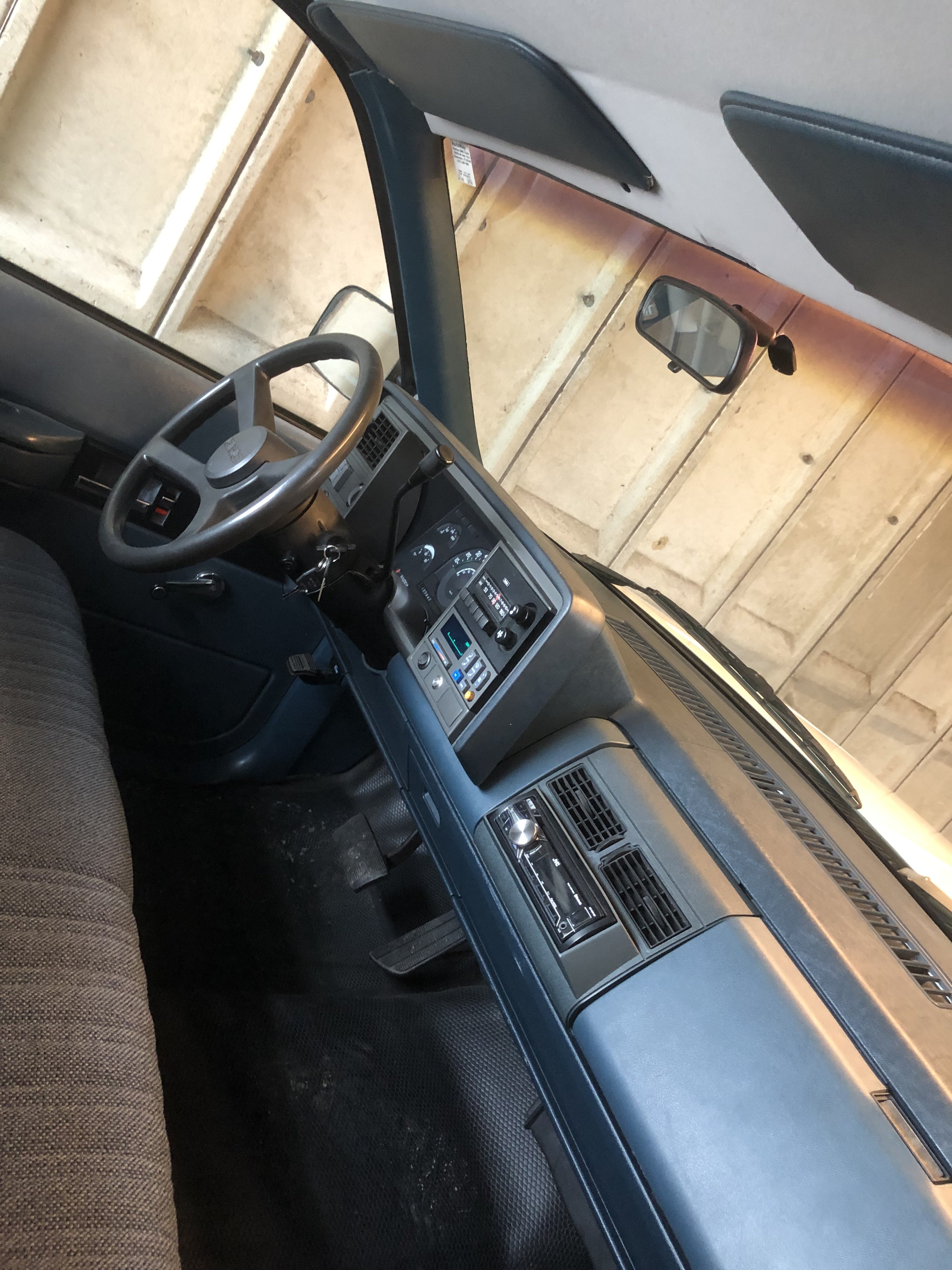

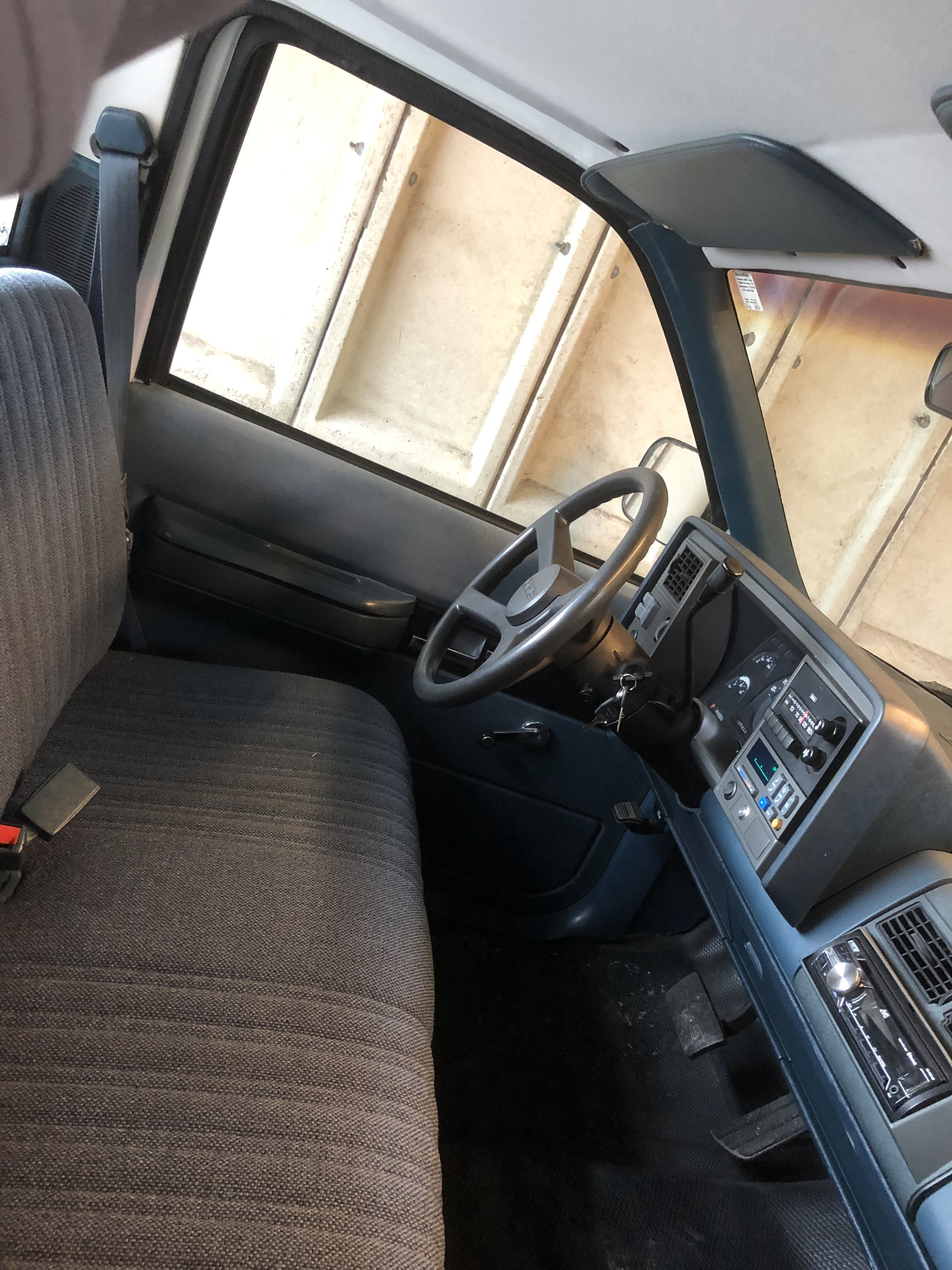

Already sorted a couple of little jobs, no interior light.
The bulb was in the ashtray which was strange, when plugging it in it stays on constantly which is probably why someone removed it. A quick google reviled that the dimmer switch for the dash lights turns the interior light on when turned to max, how strange, gave it a go and voila it switched off, there’s a extra top bit to the roller switch which turns it on, ingenious if you knew about it lol
Second job was wiring an ignition live to the stereo as it stays on all the time, easy job, popped stereo out and found some random wires left dangling from the original stereo traced an ignition live to this. Someone had wired the yellow and red power for stereo together so no wonder it was on all the time, job done.

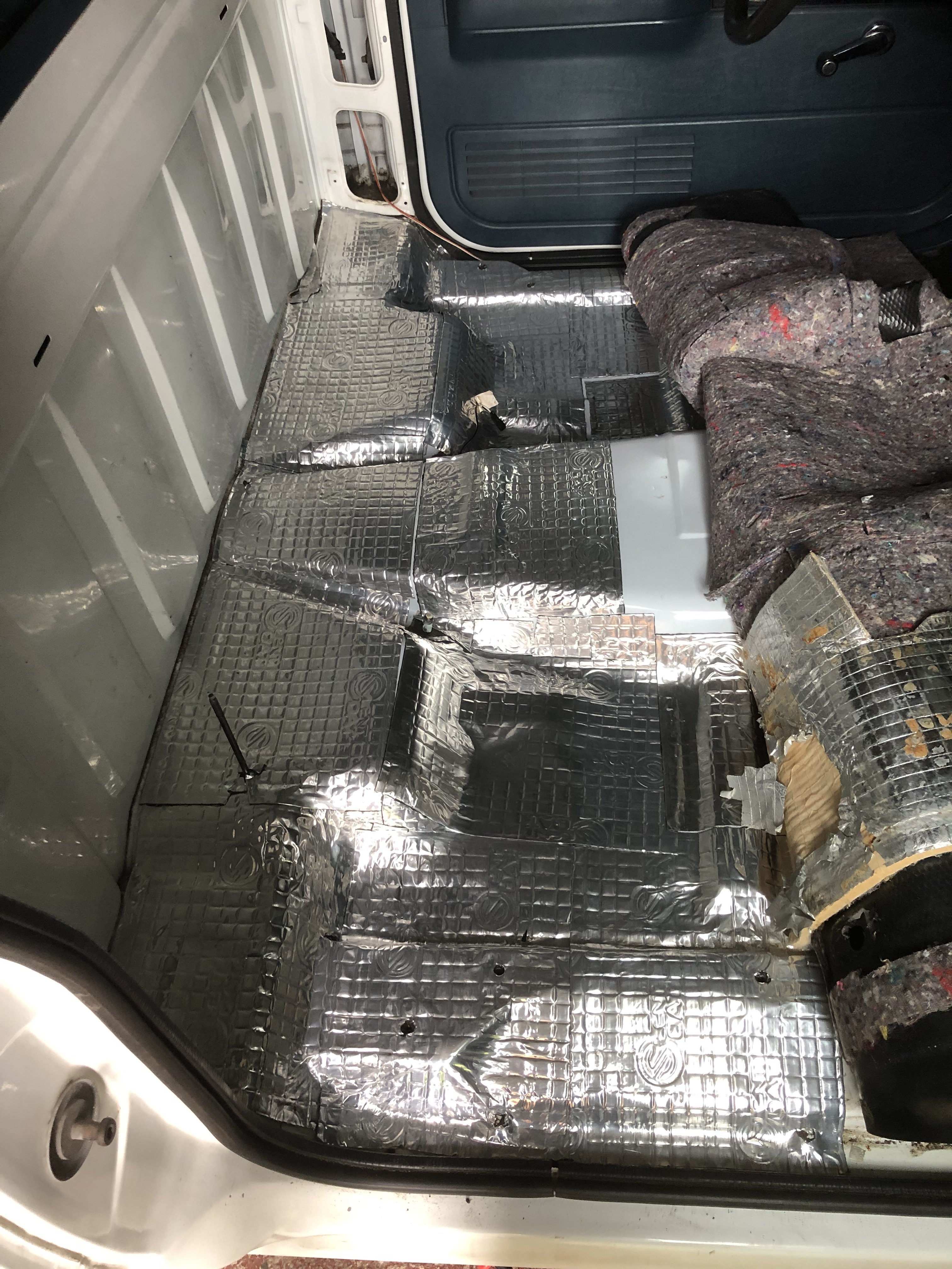

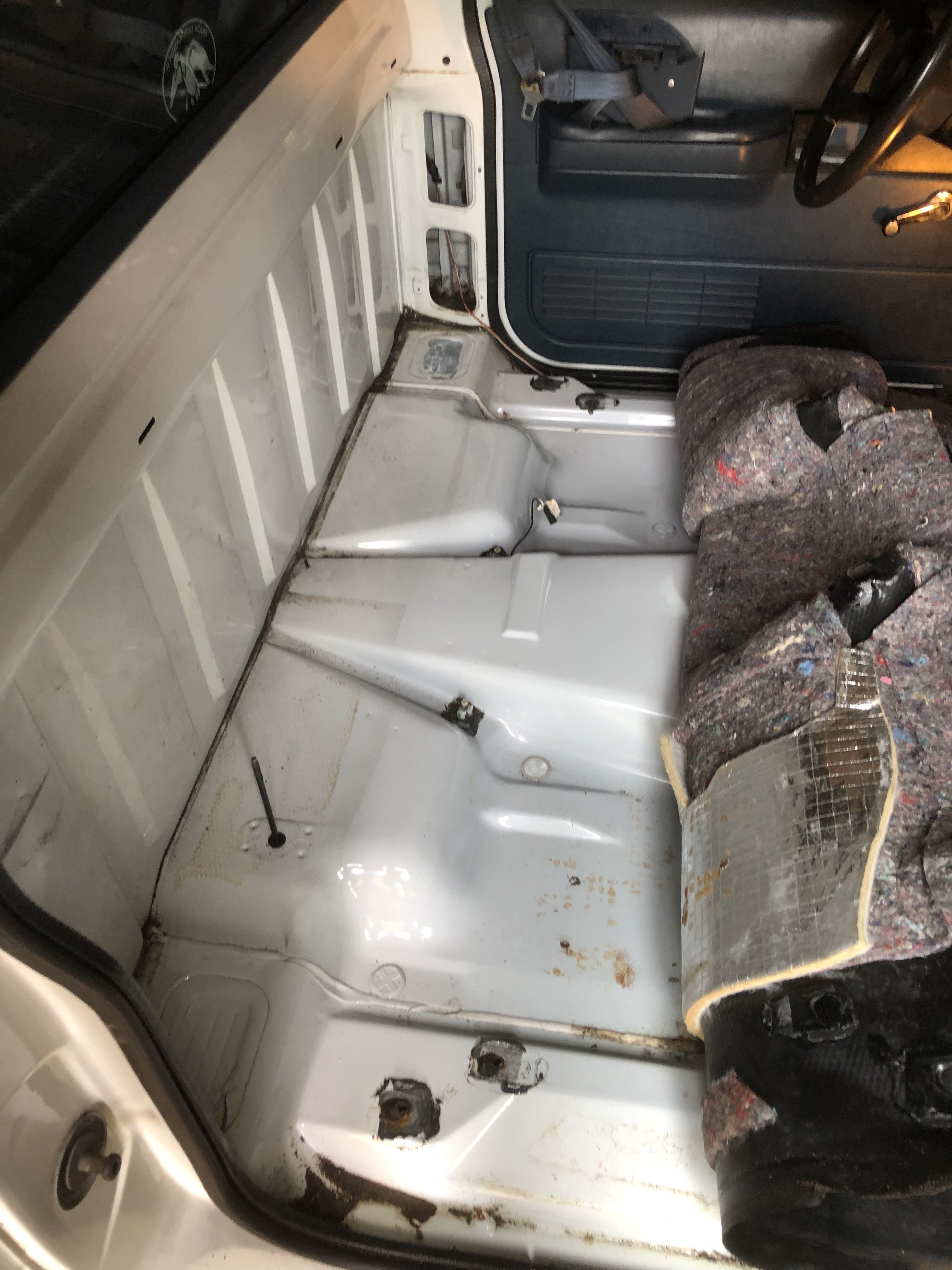

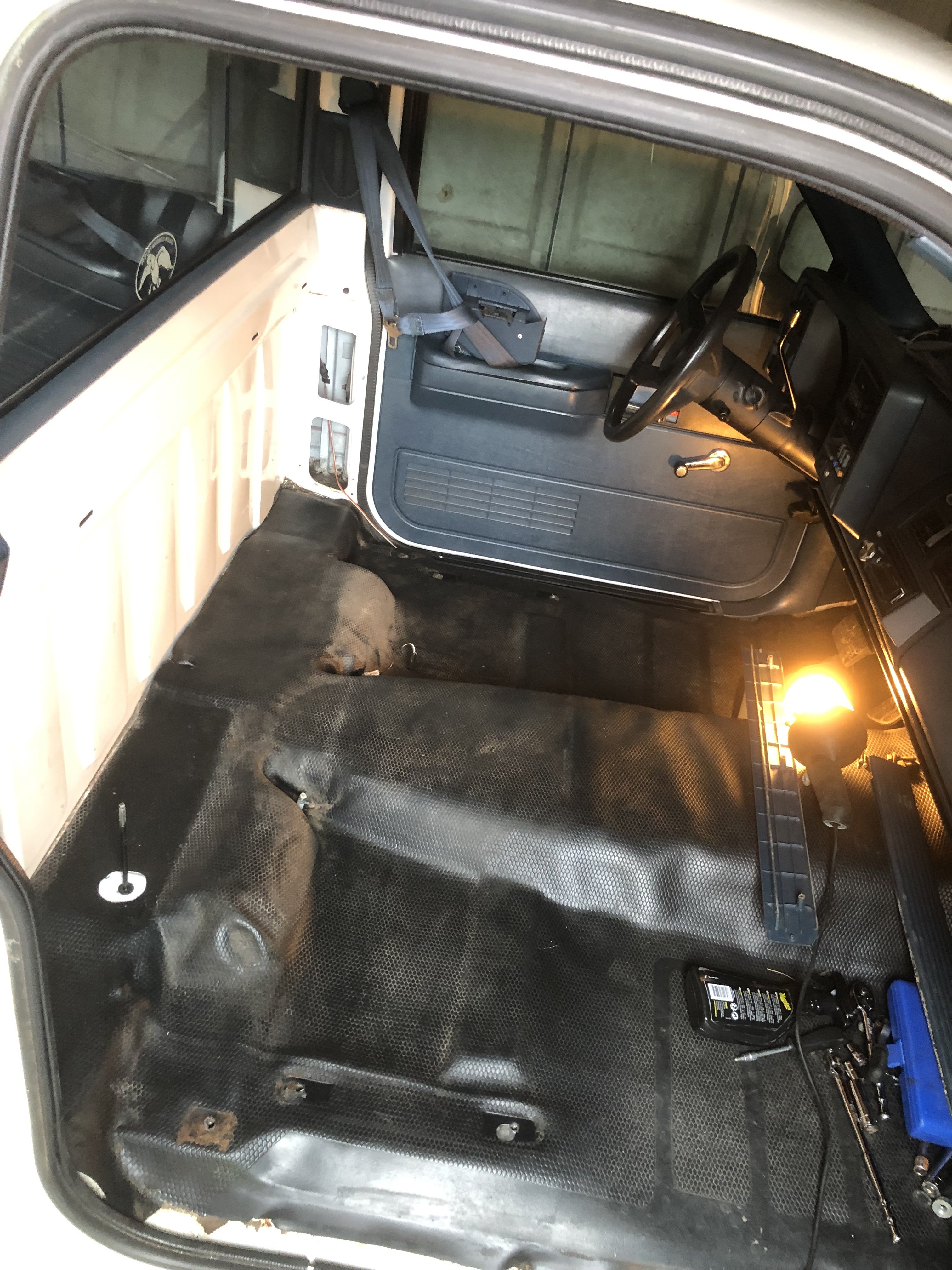

Next I removed the bench seat and added some silent coat to behind and under the seat, I’ve got some more on order for the front half, but also have some carpet coming for the front too.
i also want to get the rear bulkhead trimmed at some point. Also gave it a good clean inside

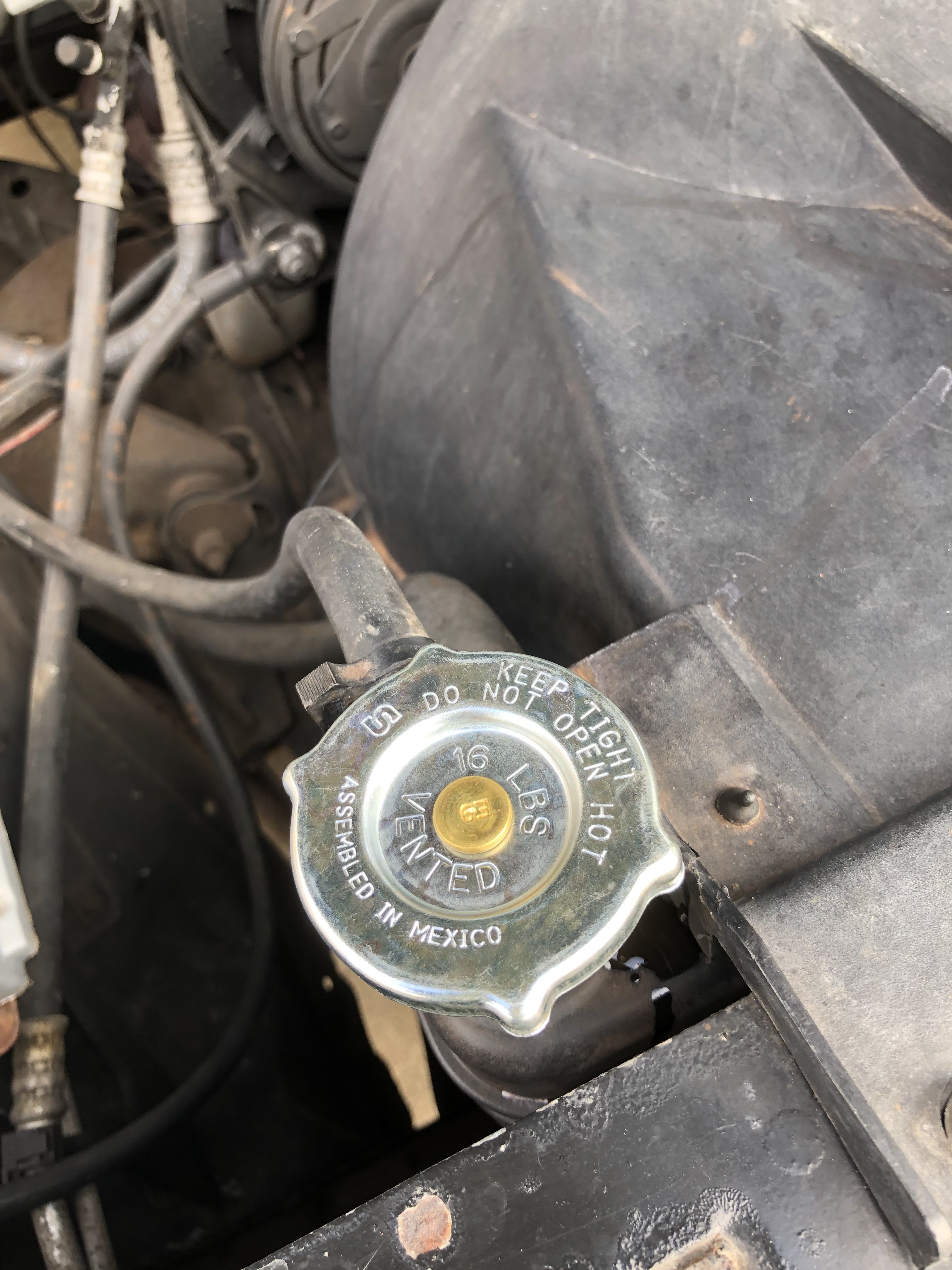

New Rad cap, seems to weap very slightly

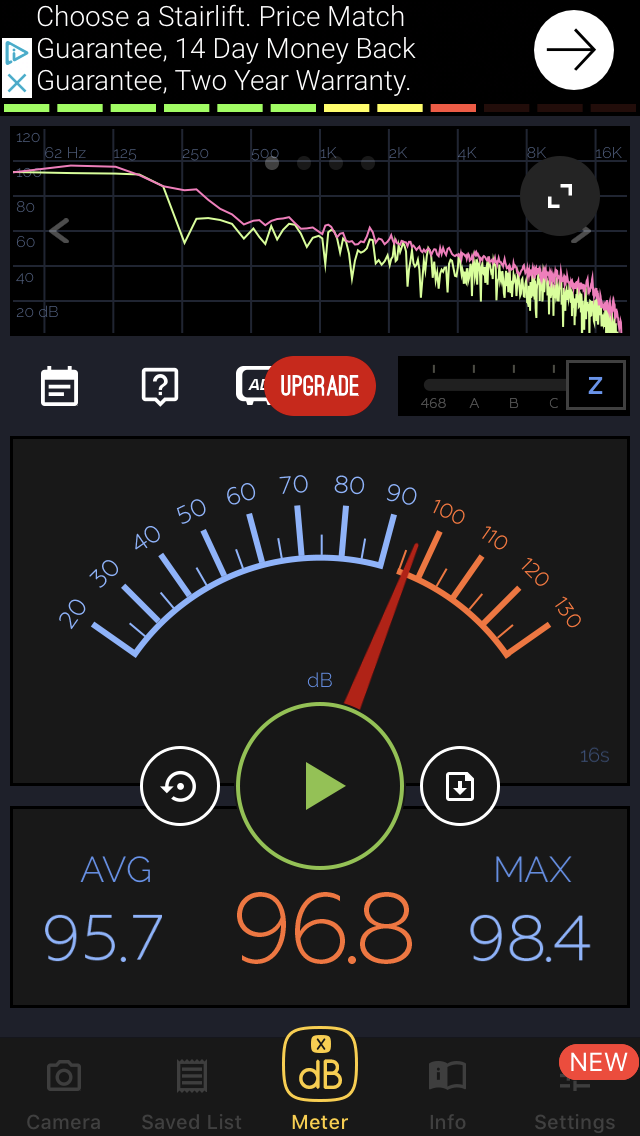

Few jobs for my day off tomorrow, coolant change. Silencer to fit and my legal plates have come :)
Silencer in, has dropped it a nice 7-8 dB on idle. I’ll get the whole exhaust done in next couple of months so just needed to be a temp job. U clamps everywhere lol

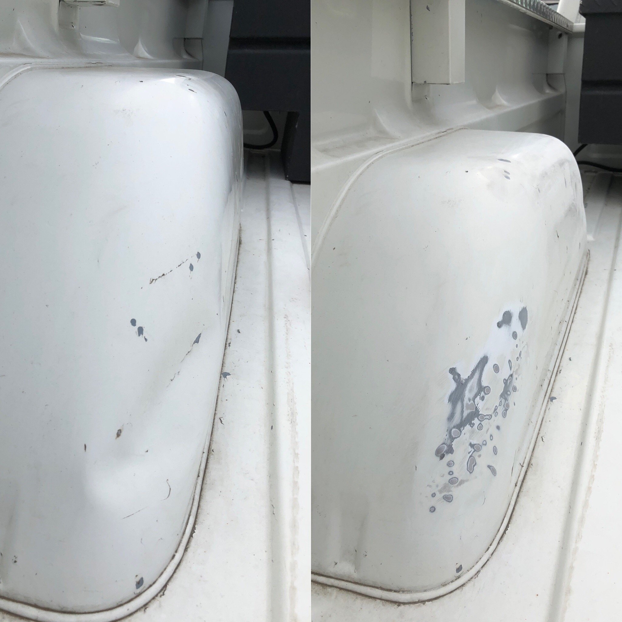

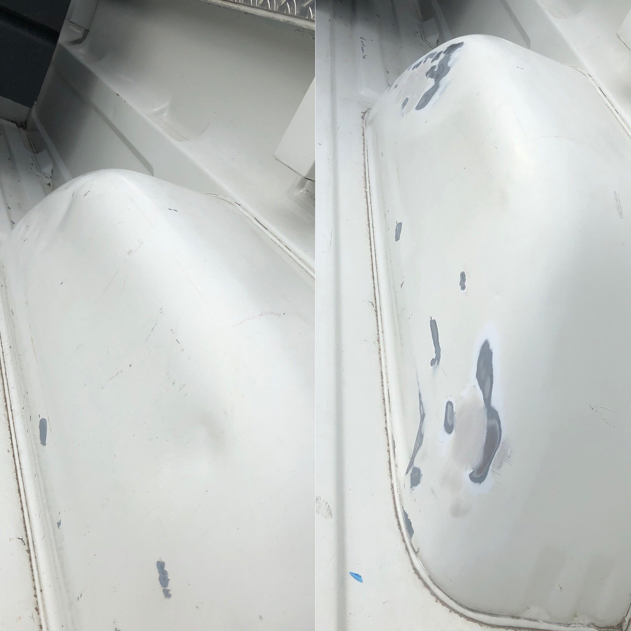

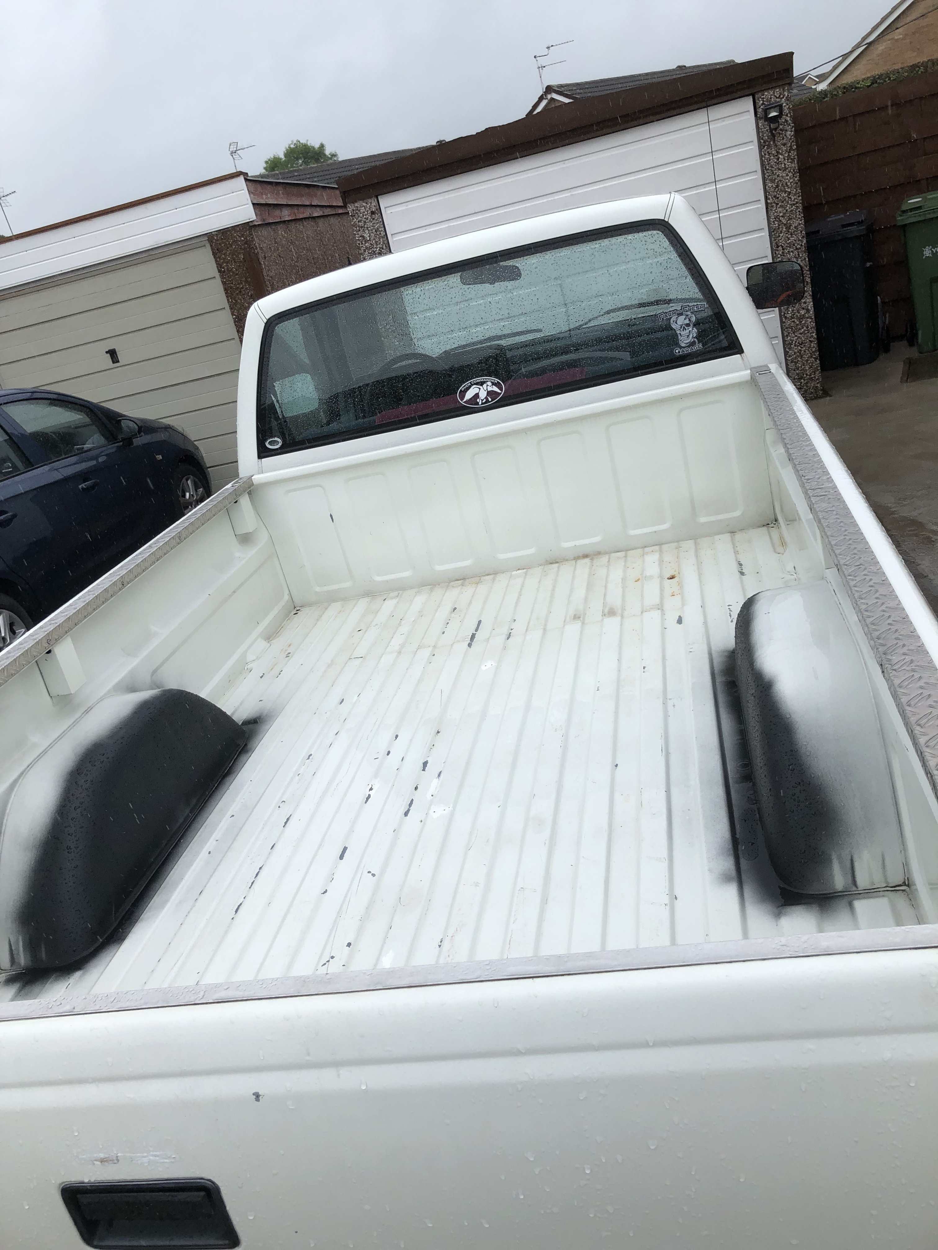

Ordered some rubber bed paint to refresh the bed area. Just need to prep and sort a couple of little dings in the inner arch areas. Went for a little run last night, first time I’ve seen the lights :)
Started to prep the rear inner arches before I spray the bed, I managed to reduce a couple of the large dints and it looks pretty decent, a little fill and some flatting back and just gave it a quick spray over and it’s come up pretty well. The paint will hide the little imperfections as it’s proper bed paint so quite thick and textured too.

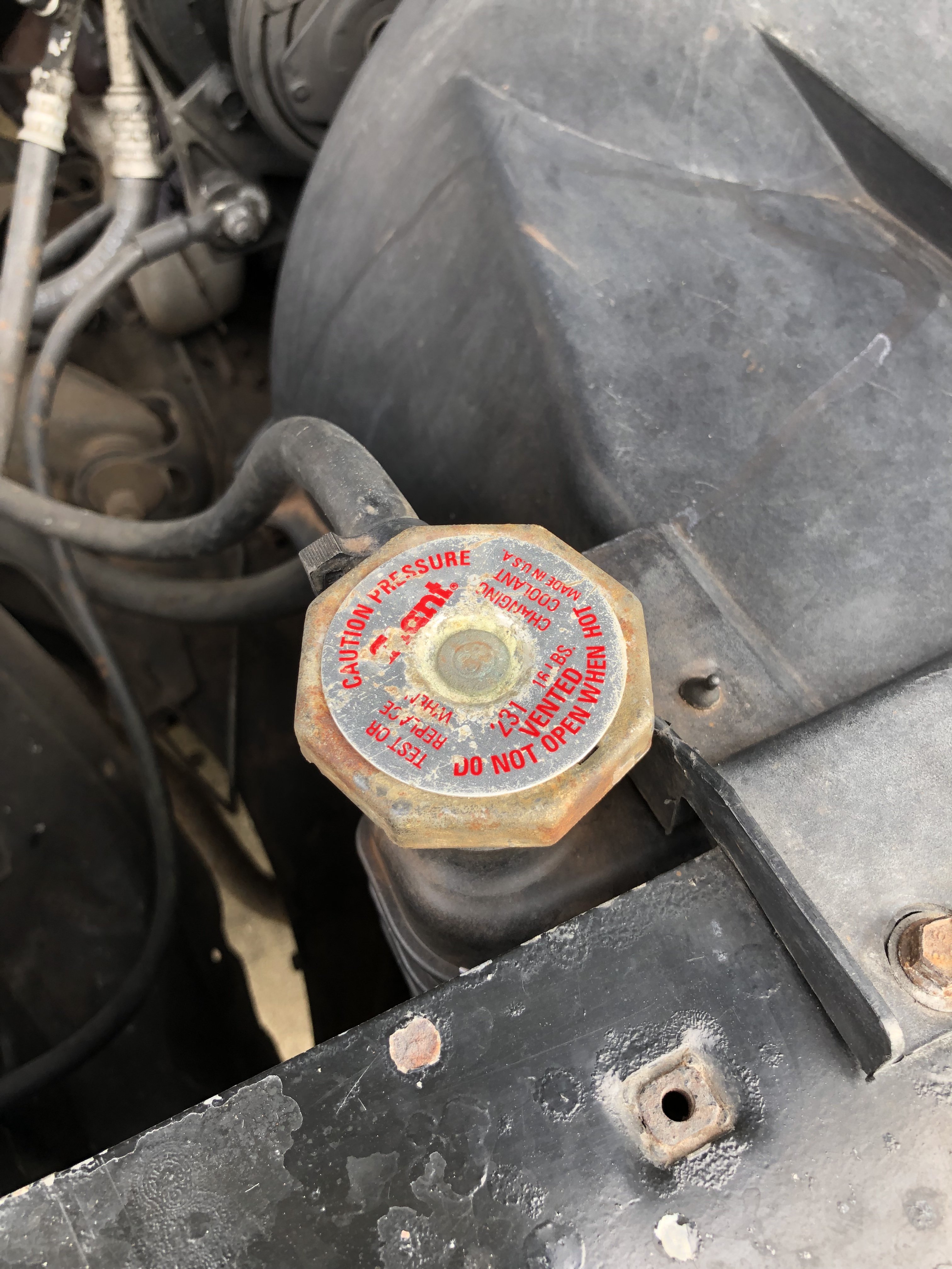

Also got a new coolant cap eventually from the states, old one was a tad rusty

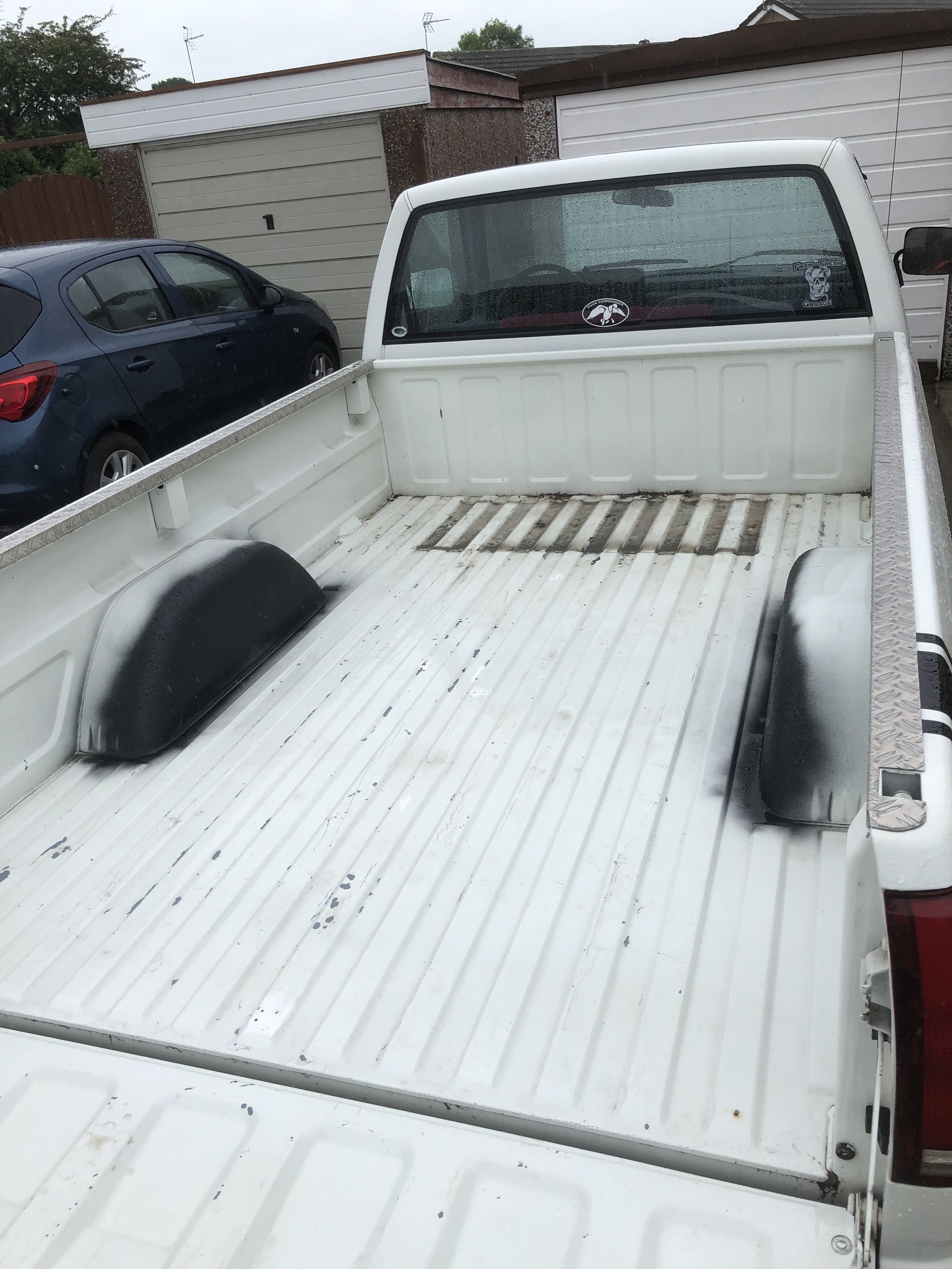

Removed the lockbox ready to clean up underneath ready for spraying the bed, looks so much longer without the box. Hopefully weathers getting better towards end of the week
