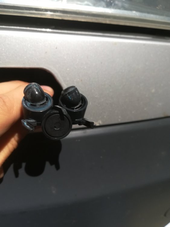

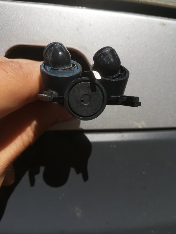

I have taken a closer look at the plastics where the cap is attached to and I am wondering if it is actually broken? Can anyone confirm?

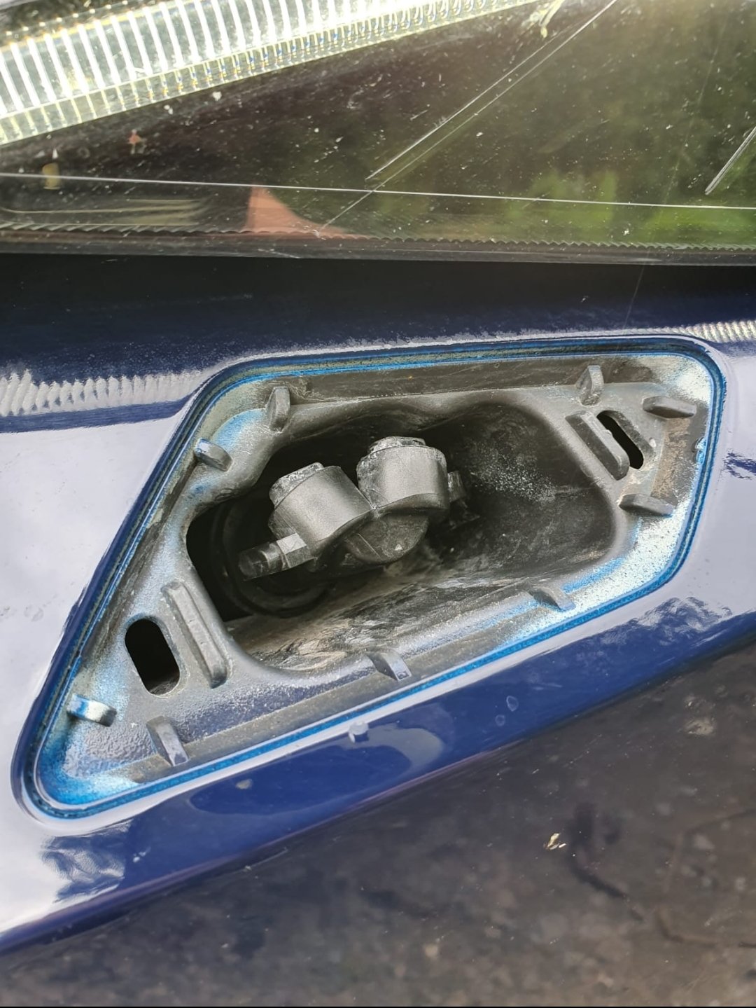

I have just randomly lost a cover for my left hand headlight washer jet cover which I'm gutted about. Ive been frantically googling a replacement and haven't found one yet. I'm thinking I'll try a few scrap yards then just take it to skoda so they can charge me £100 for it  🙄. I've tried Ali express but I can only see the mk2. Am I right in thinking this won't fit?
yes washer cover can still be attached to this nozzle. As 2 attachments are ok.. Do one thing take a piece of plastic strip and get it attached in same shape.. It will nicely work now also on 2attachments just paste it with a fix
Which varient you own? Skoda octavia mk1 or mk2.. Share jet nozzle picture

I'll post a pic shortly. Just at a restaurant. It's a superb mk3. 2016 plate. Not interested in this meal tbh as I'm bothered by the missing part. Retraced my steps through the narrow country lanes here but no joy.
Skoda superb mk3 washer jet nozzle as well as cover avail at aliexpress.. From which country you are?
UK mate but I can't find one on there for some reason. I get no results.
ok... you need only cover or jet nozzle also
I think it's only the cover. It was dark by the time I got out yesterday but here's a pic
