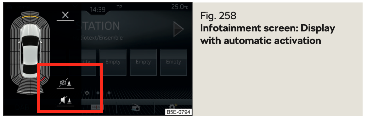

The icon is the one highlighted below. It shows up, together with the icon below it (that is to mute the sound of the beeps) whenever reversing or if moving slowly forward  and enabling the ParkPilot function.
My guess is that for the autobrake to be ON, the icon MUST BE white (it it is yellow, it means the the function is cancelled.
479329216_Screenshot2019-06-16at23_02_37.thumb.png.893d68c84f1ad9e02f7d7d01d9acfa01.png

It's called Manoeuvre Braking (or Manoeuvre Assist) and it was an addition on the facelift cars from 2017.
So yer, first time I've really looked at the icons whilst reversing - just been out and indeed, icons as described above. Both white.
I'll keep an eye on it and see if they ever come up yellow - obviously not going to be testing to see what happens when I reverse towards a wall with the icon showing yellow (if I can replicate). :)
@Stoofa: when reversing it's always white.
The manual says that the function can be activated in the infotainment menu, under Parking as I recall. And with the icons you can disable/enable the parking for a specific maneuver, afterwards it reverts to the default set in the infotainment.

If I reverse a bit quicker than usual, I notice the icon "greys out" - so that makes me assume that I'm going too fast for the system to activate.
