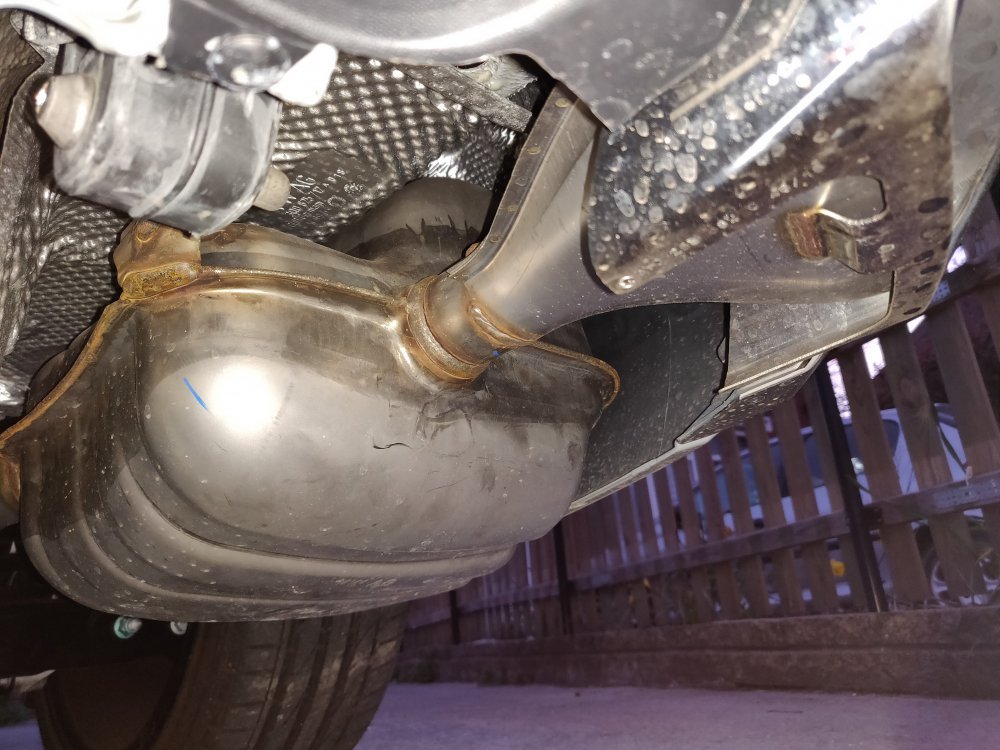

I was looking under my car (estate) and where the cat would be and there is two I got take a stab in the sack and say one is a particle filter can this be removed with out throwing a code on the dash

If you remove the PF then you'll fail the MOT as, as far as I'm aware, if your vehicle comes fitted from factory with it, it'll be tested / checked.  Also, it'll throw a code as the vehicle does look for it - it'd need to be programmed out.
BUT, I see you have a 280 Sportline - I'm guessing this is petrol?  If so, then possibly not a DPF (or petrol equivalent).

The exhaust in the 280PS is a valved exhaust. When you switch to sport, it opens the second path and bypasses, and that's how you get the change in exhaust note - it's not purely up to the revs increasing at idle. I think the 272PS has a slightly different exhaust setup, but I'm pretty sure the same principal applies. aka: You bypass that anyway when you want/need to.
However, it's you're referring to the new GPF on the 272PS, then I'm not sure what the situation is there.

It was one of the first things I checked when I got my 280 a couple of months ago - and was very relieved to see it still had the quad exhaust set up.
272 single exhaust below:
Edited by fencer
Unless you're swapping the turbo out for a stage 3, then removing the cat converter and/or GPF is absolutely frivolous. Most downpipes for MQB cars have cat converters anyways. Stupid idea.
