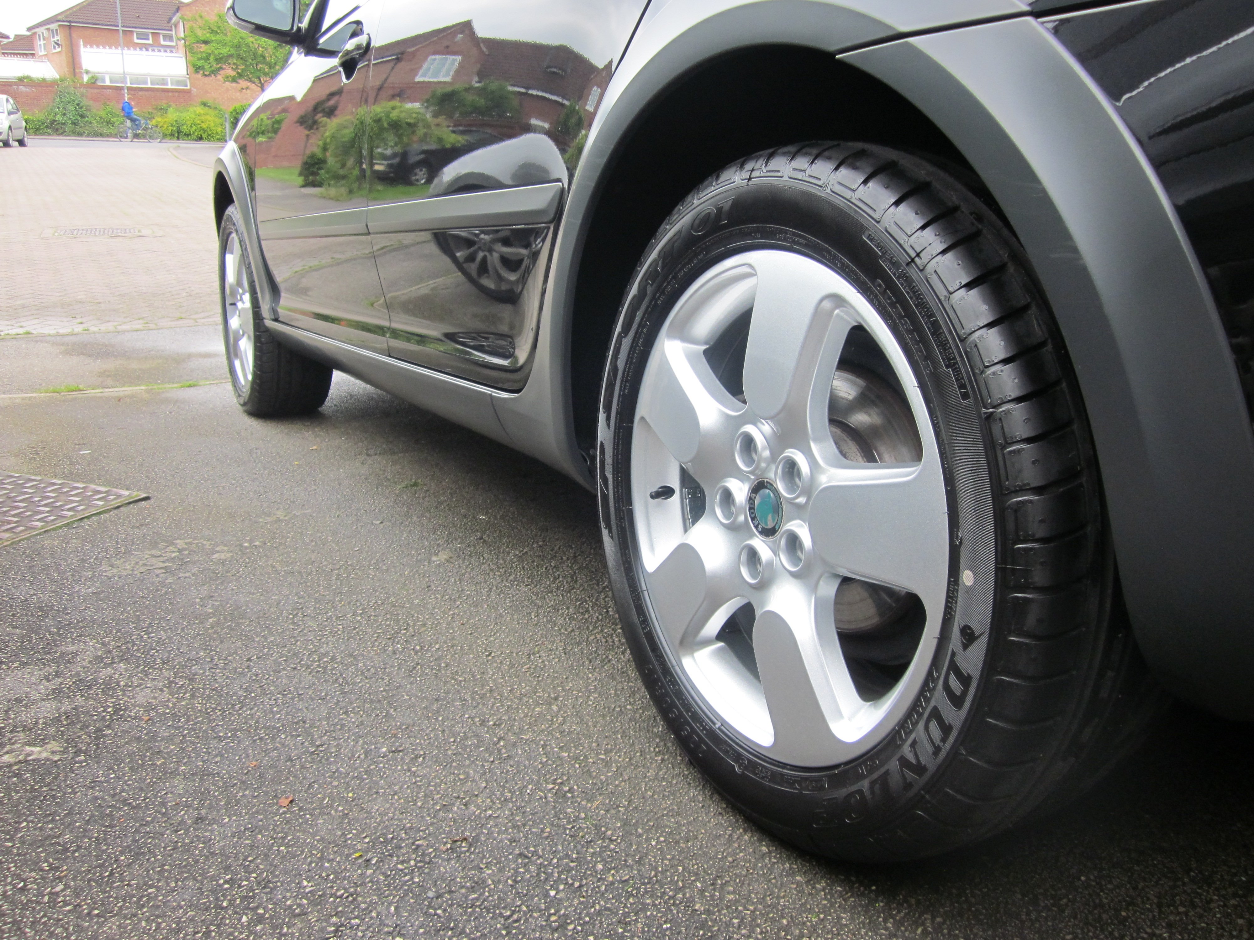

And Silver, how the hell are your wheels looking that good? Scabby is a kind description of mine...
Edited by tintinandcharlie
That photo was immediately after a full refurb.
There isn't one single Proteus alloy wheel out there that hasn't suffered from the dreaded whiteworm.
The Proteus on the MkII Scout was one of the first alloy wheels that Skoda launched in the UK with a polished / diamond cut finish, so needless to say most, if not all, are looking a little worse for wear by now.
I had several alloys replaced under warranty, but as soon as the three year warranty expired I had them refurbed and painted, without the diamond cut / polished finish.
I really liked the shine from the original finish though, so my only instruction to the guy refurbing them was that I wanted the brightest silver paint you can get :D
