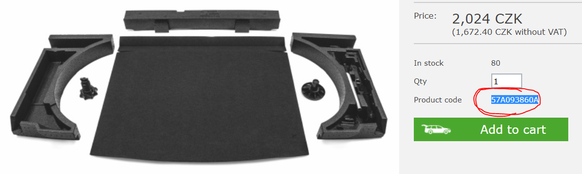

Having just bought a 69 plate Karoq Scout that was pre registered with 18 miles recorded and included heated windscreen, heated steering wheel and adaptive cruise control for under £25K it seemed a bit of a bargain but as there is no spare wheel I have managed to get a new space saver wheel for £35 and the Skoda 4WD wheel kit for £95 but is seems that as the existing boot floor is only basically carpet a replacement hard boot floor to raise the floor level is required - is that correct as the kit consists of:
Set contents: Left-hand polystyrene box, right-hand polystyrene box, polystyrene spacer, plastic nuts, fastening bolt with knob, luggage compartment floor pin, BOOT MAT, car jack, car jack crank handle, wheel brace, fitting instructions.
It states "boot mat" so is that the new floor?
The Skoda parts guy didn`t have an answer.
For Kodiaq Mat has hardboard underneath.. is about £100 - so I guess should have the board
The kit is £95 from a Skoda dealer (only £68 from Czech Republic) so if it includes the floor as well then that is cheap but it says its a mat which means carpet to me - all very confusing!
sorry - I should have said - the Kodiaq kit - including the mat - similar to your photo - has hardboard under mat..
