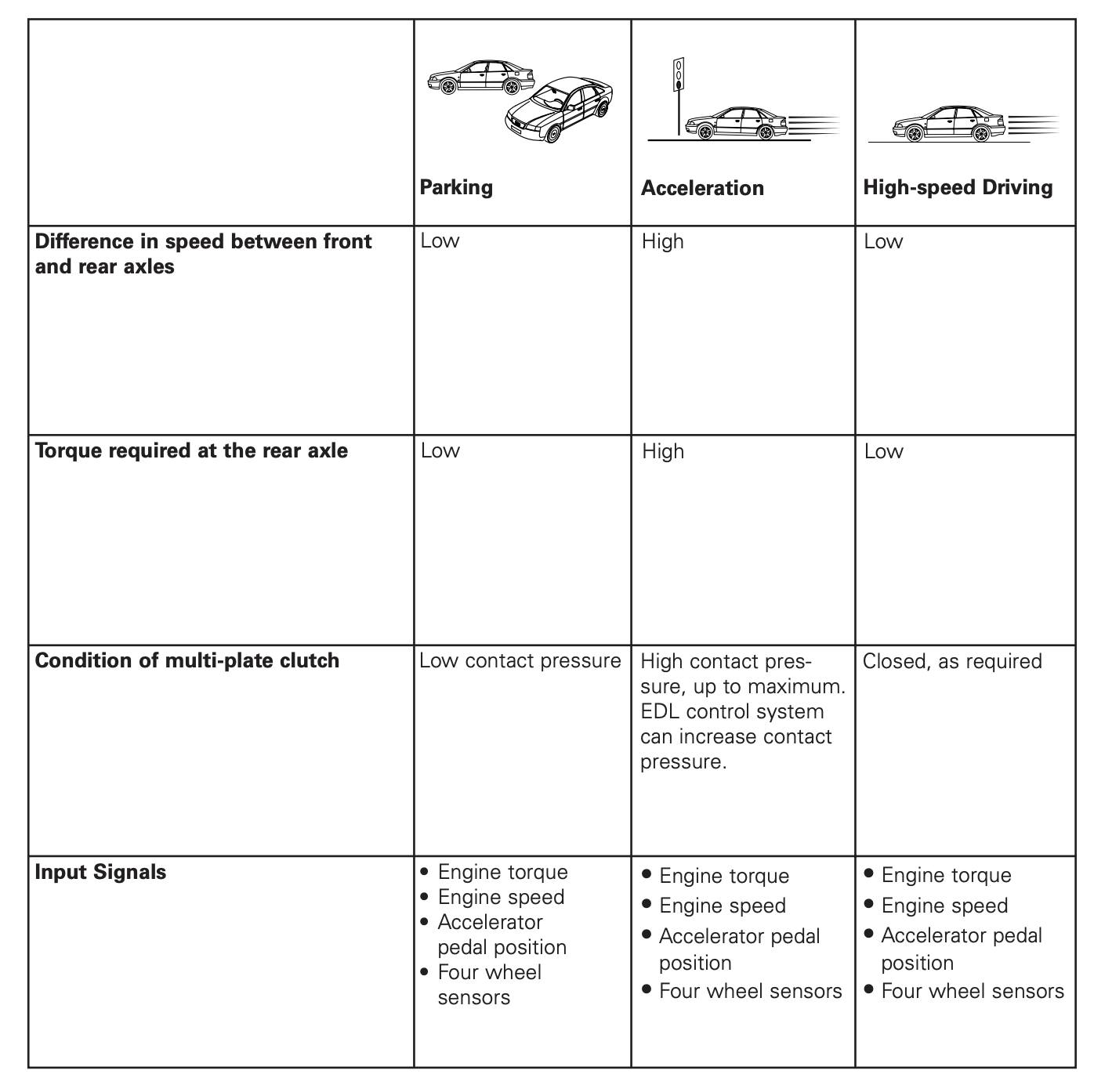

I have always been under the impression that there is always about a 5% drive to the rear and this increases when the systems detects probability to slip etc, probably not explained very well!

Correct - mainly because the multi plate clutch is spring loaded to take up any "free play", which enables the hydraulic progressive engagement to take place instantaneously when the ecu detects actual or potential need for the drive to "lock" up.
As said before, all automatic - and no, there are no diff locks - the ABS takes care of any errant wheel waving in the air. There are further tweaks, like an off-road button (if fitted) and switching off ASR (traction control) if getting into difficult territory!!
Don't forget, it's just a Golf 4x4 shopping car, but can be very capable in the right hands.

Alan Taylor kindly shared this with me after I shared my theory and assumptions on FB: http://www.billswebspace.com/HALDEX.pdf?fbclid=IwAR0-x6wvXAzePWT3ZXrz8SOC4Zq5zDQK9AndVewLLwWfn9A6E8_a1C1aJIg
The table on page 34 of the PDF is excellent at explaining how and when the Haldex engages:
It explains how the Haldex works, and even though it explains the 1st generation, it's applicable to the 5th generation too based on my fiddling around with the ODB II Live Data sampling. If you haven't seen the FB post, it's attached here:
