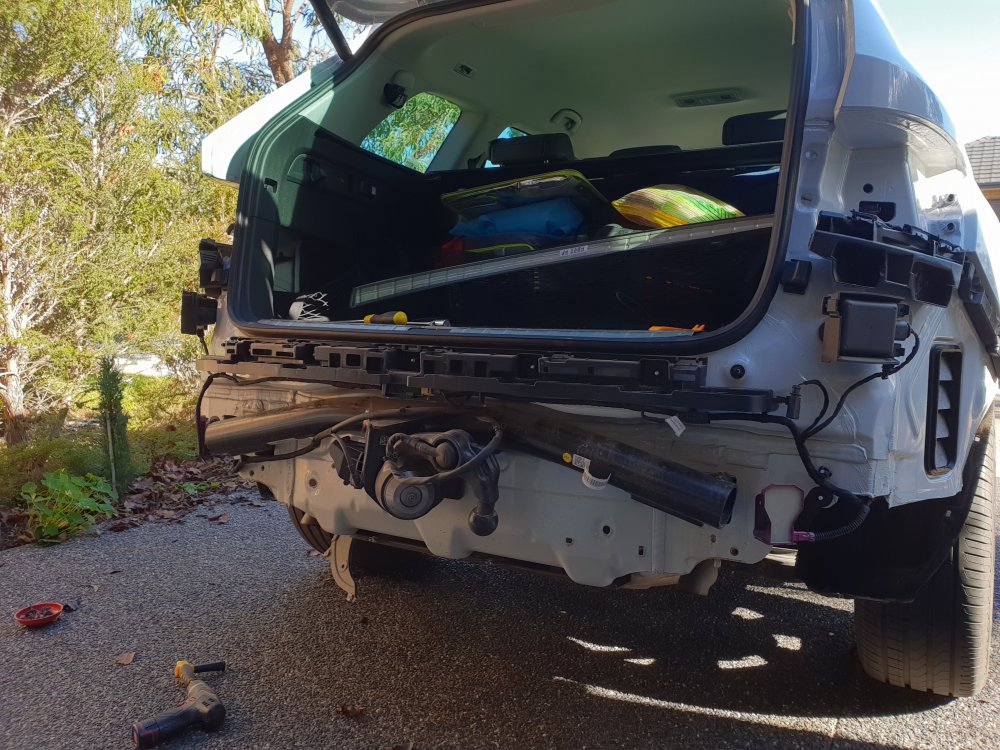

Its definitely possible, but a pain to fit.  The different exhaust on the VRS gets in the way, so more dismantling at the back was required.  Also the vehicle specific wiring that they supply fits, but the wiring loom seems further back and needed more of the gloxbox area to be dismantled to get to it.  All in all I think it took around 3hr 15 mins for him to do.  Looking at what he needed to do I think I'd have been there all week trying it myself!
Towbar bolted in.....

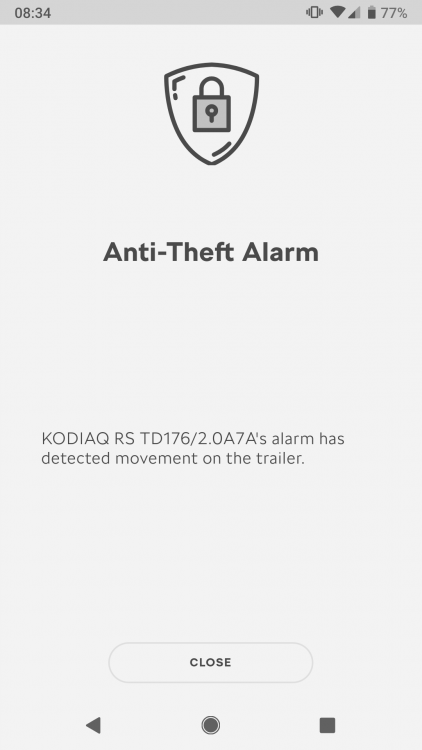

Fog light deactivated with the electrics connected, but the alarm didn't go off when disconnected. However, I may have had the keys too close (keyless entry etc). Will play with it a bit more, and read the manual!
Edited by ahar
If the car is locked, it doesn’t matter how close you are to the car with the keys. The alarm should go off if the car is locked when the tow bar electrics are disconnected.
Problem with the alarm solved I think.  Thanks to a previous car I'm in the habit of double tapping the lock button on the key, but turns out that switches off the internal movement sensors and the trailer alarm. If you single click to lock (as I should be doing) the alarm does notice the trailer has gone, and sends a notification to the Skoda connect app !
