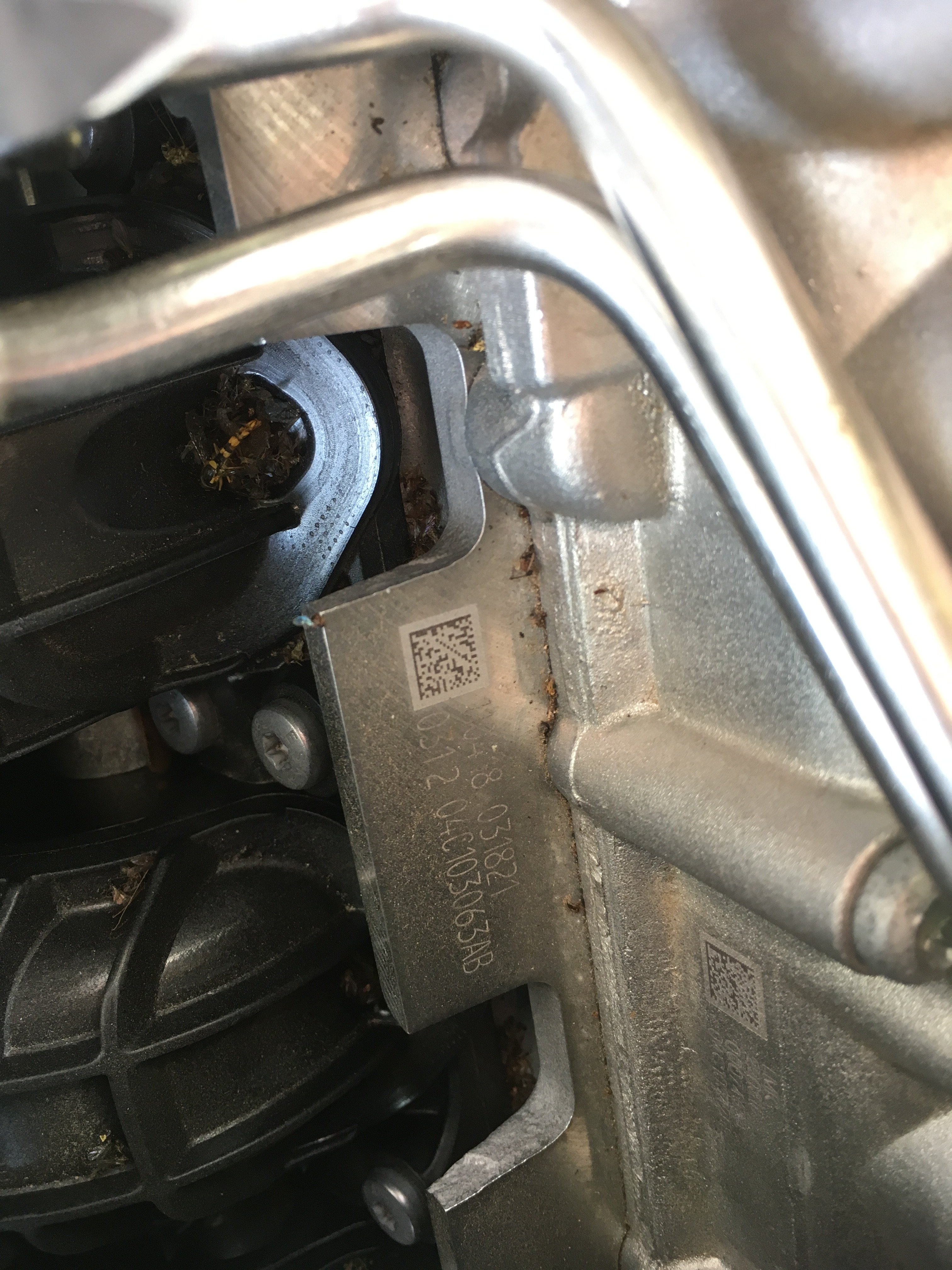

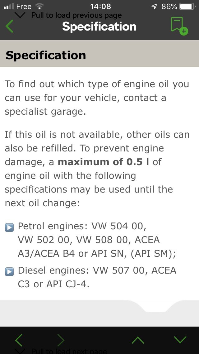

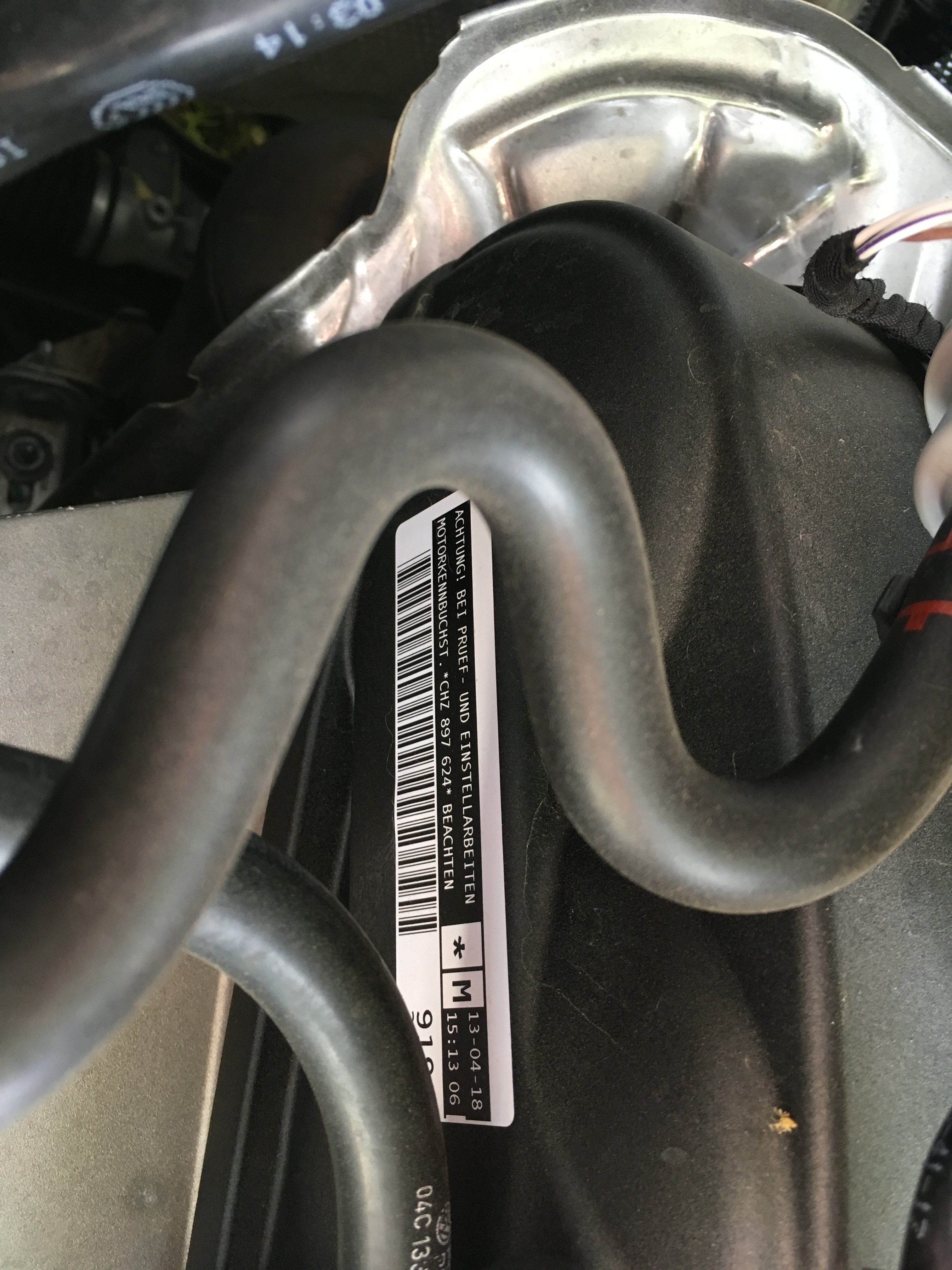

I don't have access to the printed manual right now, but have the car configured via its VIN in the MySkoda app. That gives me access to the manual, in theory that could have been the 100% accurate-for-this-car manual. But sure enough this is what it says about engine oil - exactly as the printed manual does.
I haven't yet had the time to figure out if the (very slow) app allows me to find the exact engine ID or if I have to dive under the bonnet for that.
I was going to include the VIN but then realised I don't know if that's unwise - but I can share it in a PM if anyone has free access to a VIN decoder that I don't have access to.
Can't see an ID plate pinned to the engine block, just an engraving on a ridge sticking out of the front of the engine (looks like some kind of serial number), and a sticker on a plastic part to the left of the oil filler orifice (seen from the front of the car) and that says "CHZ 897 624" and is dated April 13th 2018:
(Dang, I did not notice the sticker faintly visible above and to the right of the engraving, eyes being adapted to blinding sun and all)
So it's a late "C" engine which means it may or may not come with a GPF. Probably best to call a dealer. Any dealer given a reg number should be able to tell you. (though, that being said, when looking for 18mm ARB bushes, they all kept offering me 16mm ones, despite my car having an 18mm ARB!)

We'll see what they say in the (independent) workshop where we've been going, and what the price difference is here. The car will be put on a 1-year interval anyway.
Well, they said that they were told (by Volkswagen) to put in 508.0, presumably because I had not left clear enough instructions that we were going for the 1-year plan. I didn't ask about the price difference, but that stuff is 30€ per liter, i.e. roughly 4x the price of Total 504.0 rated 5w30 in a 5l bottle (and I'm quite certain we'd pay less for that oil in a workshop). In the end the appointment was cancelled because they weren't even certain their software was up-to-date enough to do the zero reset even for an oil change (and I learnt all that too late to make a new appointment at the VW dealer in the neighbouring village). Progress I guess...
