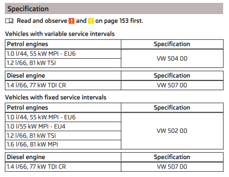

The manual for my car (late 2015) gives the oil specs for each engine on fixed/variable servicing. Now that doesn't cover the 1.0 TSI.
For early 2017 models this information is still there;
This is the last manual to show the oil specifications (early 2017); https://ws.skoda-auto.com/OwnersManualService/Data/en/Fabia_NJ/05-2017/Manual/Fabia/A06_Fabia_OwnersManual.pdf
Edit:Looking at the figures, it seems the 1.0 seems to follow the same specs as the 1.2. With fixed servicing being the same, and variable advancing over time.
Though that doesn't account for anything since late 2017...
Edit2: This is what's recommended for fixed servicing on my late 2015 1.2;
Interestingly Mobil 1's 0W40 is rated for VW 502 spec?

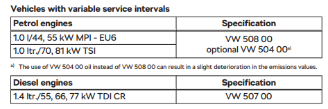

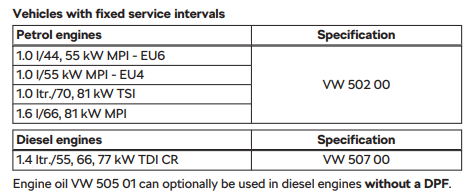

Edit: so you checked, I didn't just overlook the info in the 2018+ manual? I did check if it wasn't listed with the individual engine specs at the end (that would have made sense) but not elsewhere in the manual.

No the manual is very clear about what oil to use in your car. Just read it. There is no 'lock-in' as you put it. You don't have to use VW's own branded oil. Just the right specification. If you don't use the right spec oil, your engine will die early and maybe sooner than you think. Remember the VW diesel PD engine issues brought on by folks who simply didn't read their owners manuals and put the incorrect fully synthetic oil in their engines, only to find out sometimes just a few thousand miles down the road, that their camshafts had failed due to that wrong oil being used. This also sometimes totalled the engines with broken camshafts. I spoke to owners who had done this suffering broken camshafts and failed lobes and their responses showed how they just thought that oil was oil was oil as long as it was fully synthetic, it was ok! Totally wrong as they found out.
Q: What does the middle number stand for (the 70 in 1.0 ltr/70, 81kW)?
A: The '70' just refers to the 70Kw version of the engine.
Q: Has the 1.0l TSI changed in mechanical design between 2017 and early/mid 2018?
A: Yes, there are some very minor mechanical changes to the engine and also software. Also from Sept 2018 onwards all new petrol engine have GPF/PPF's. GPF/PPF equipped engines must use the 0-20w oils as these are low ash. Ash will kill your GPF/PPF over time. The new oils also use different lubrication technology to give the engine advanced lubricity and anti-wear characteristics without using zinc etc. They lubricate better than 5-30/40 oils and protect your engine better, and in addition allow the engine to attain the latest emissions standards that all cars much reach.
