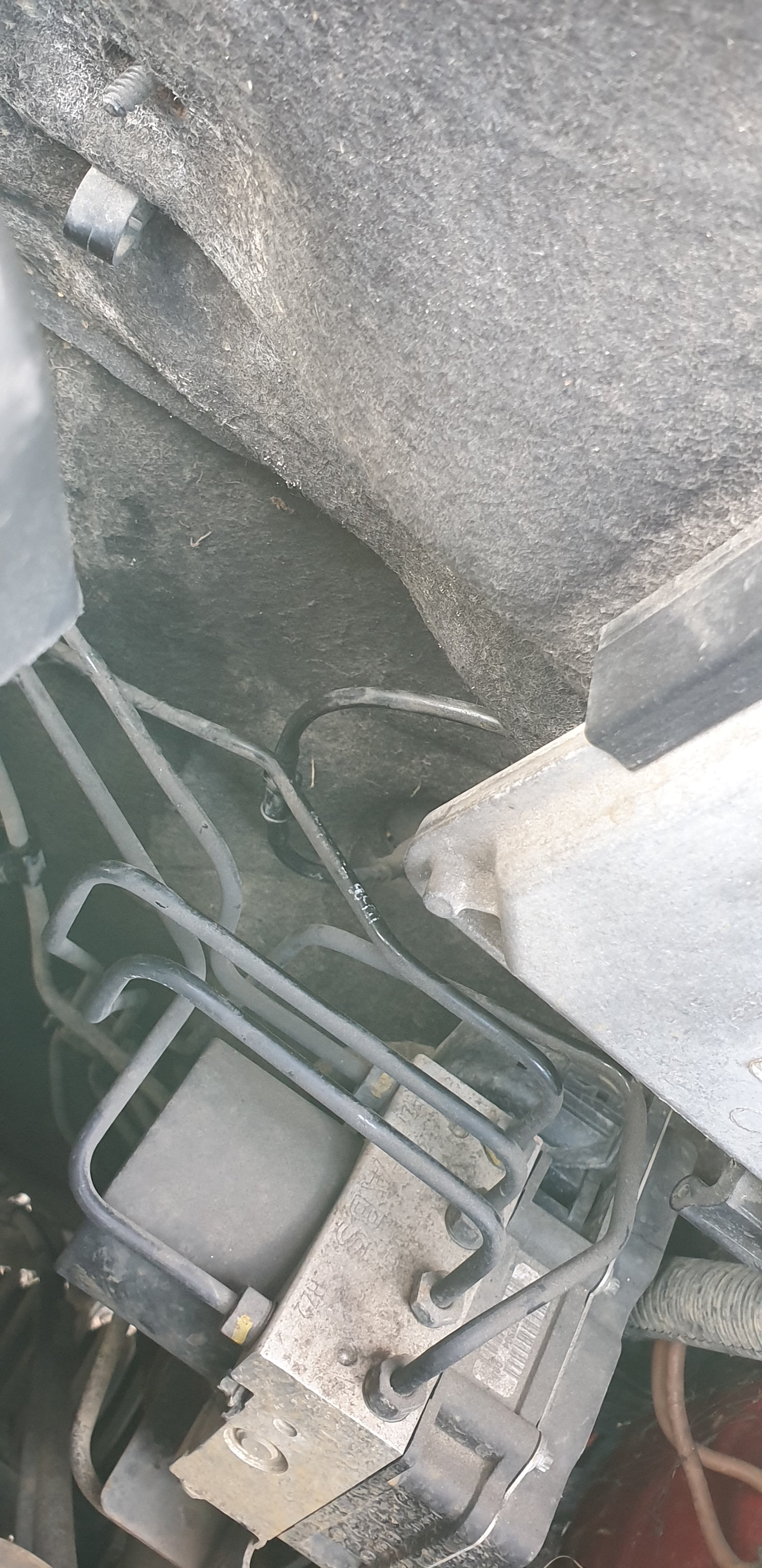

Unfortunately I dont think it's going to be that simple 😞
looks like mine is connected.
That's your fuel pipe.
Clear plastic pipe clipped to the bulkhead behind the ABS pipework.
He did say "it won't be that simple"; if he can't tell a fuel line from a water line it certainly won't be! 😉

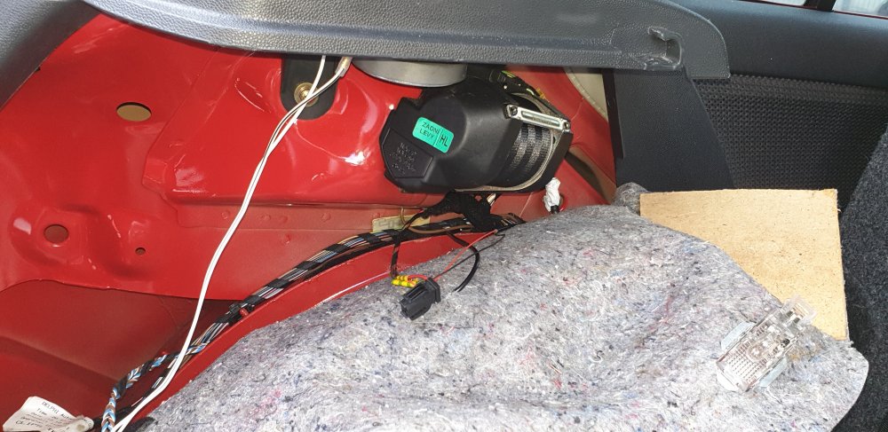

If there's nothing dropping to the ground, it'll be either that the outlet nozzle is completely blocked, or it'll be the connection just behind the trim by the nearside side rear seatbelt. Does the inside of the car smell of screenwash when you attempt to spray the rear screen?
Ah sorry! I dont know much about these things,

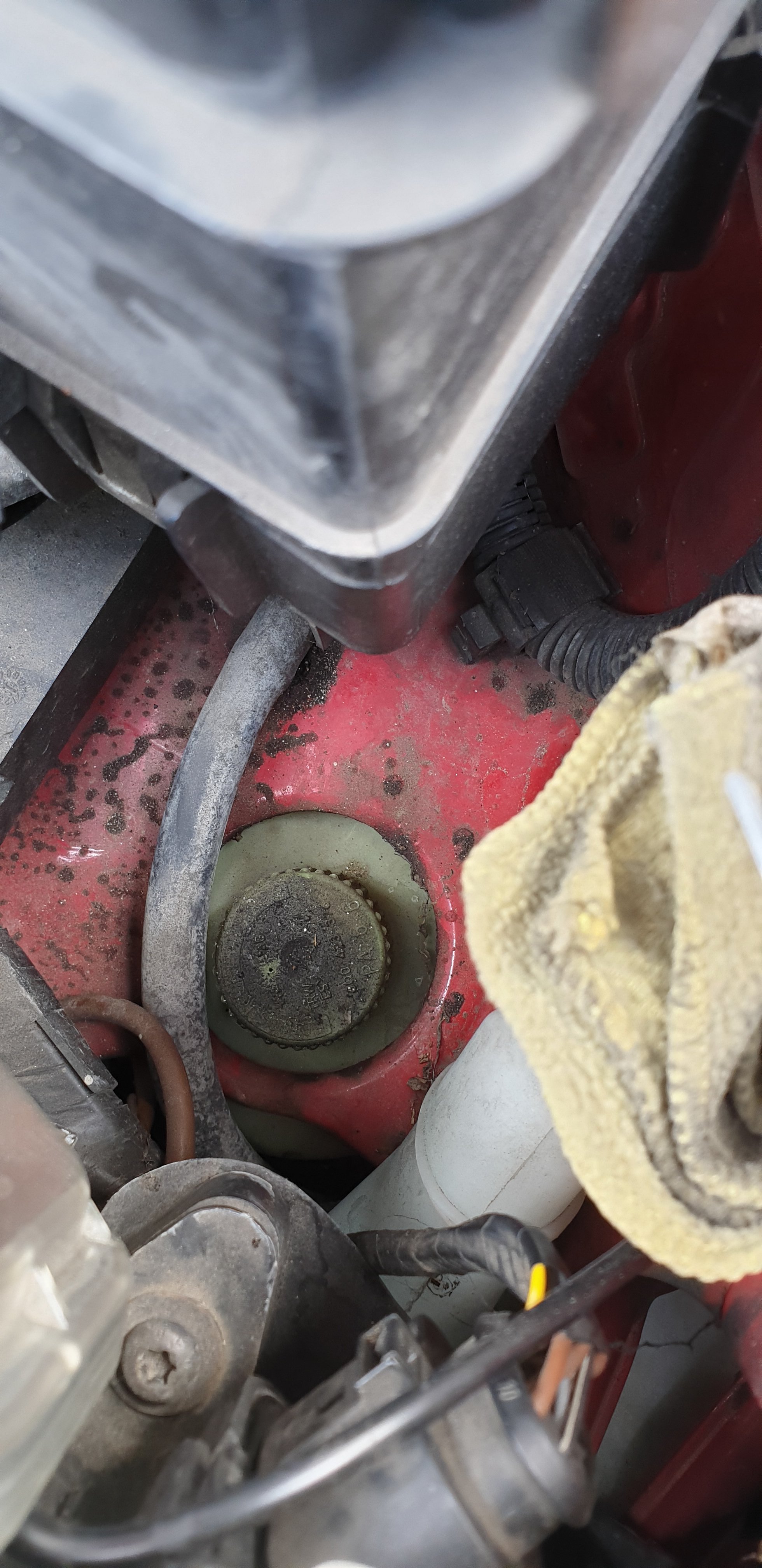

Could you possibly show me a picture of it inside the engine bay? Thanks!
Is it this black pipe?
  • Sponsor
Nope. That's the battery box drain pipe.

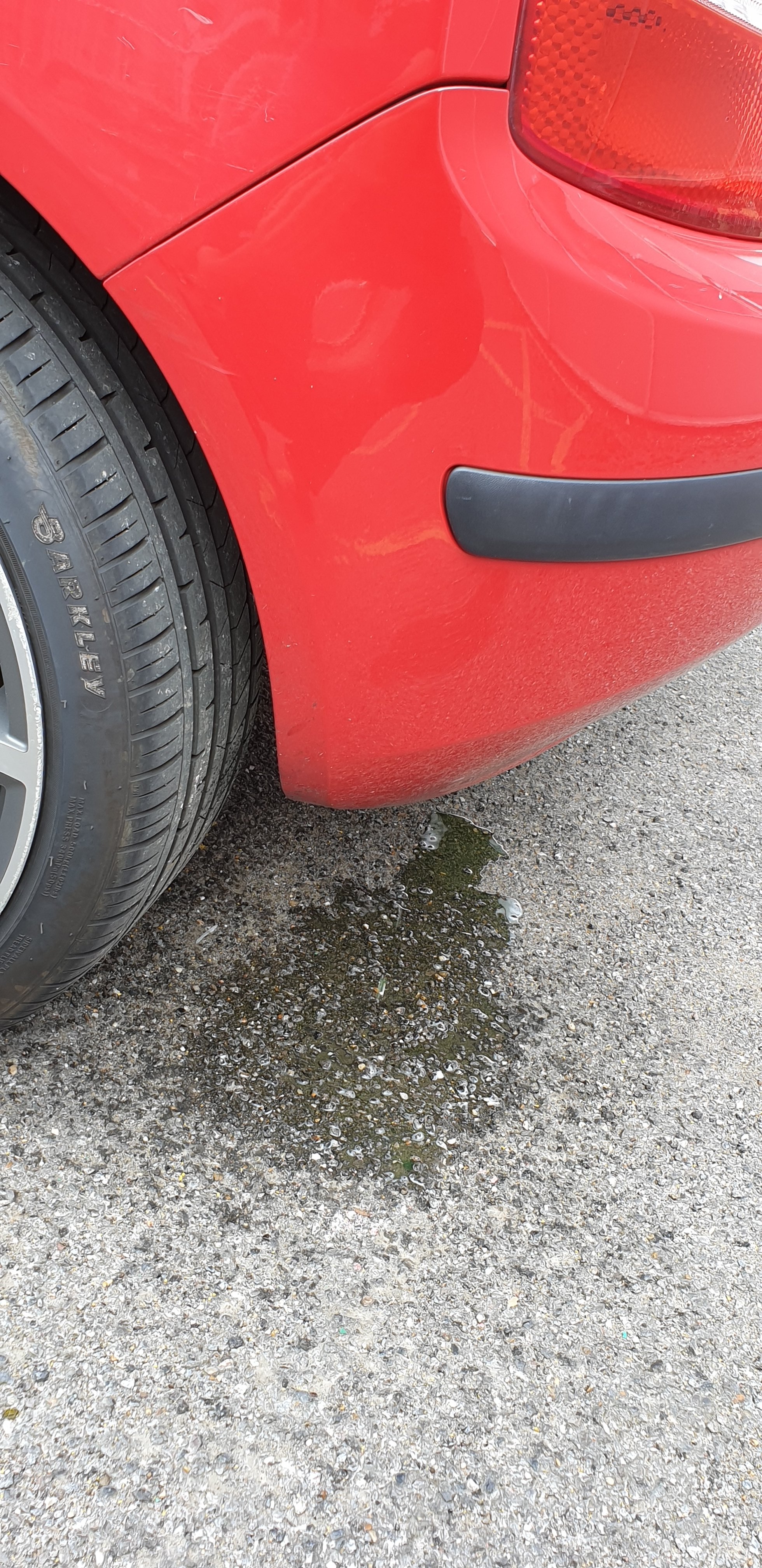

I think I found it! Ok so at the front there little pipe was disconnected, I connected that.
Know I can see screen wash leaking at the back of the car.
Any ideas how to get to that?

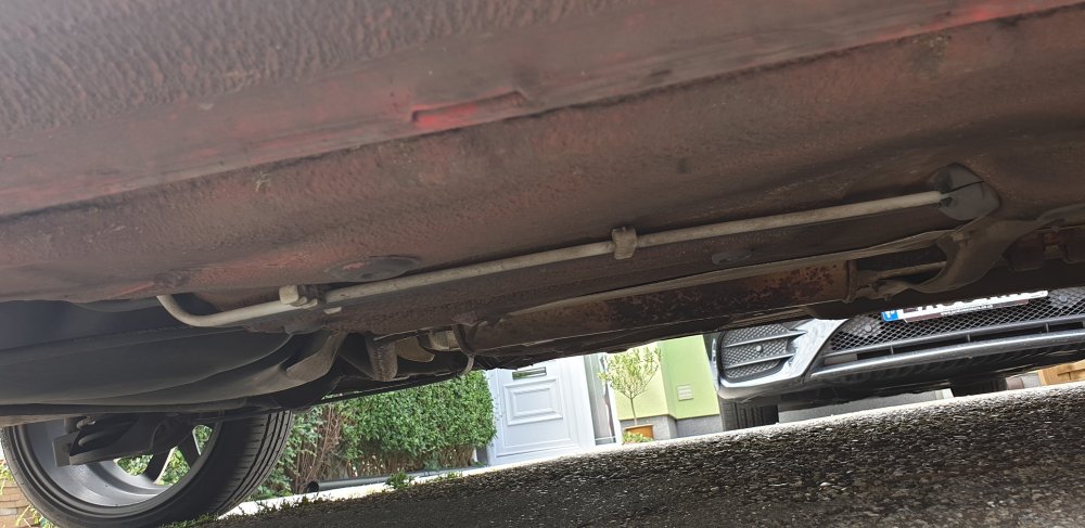

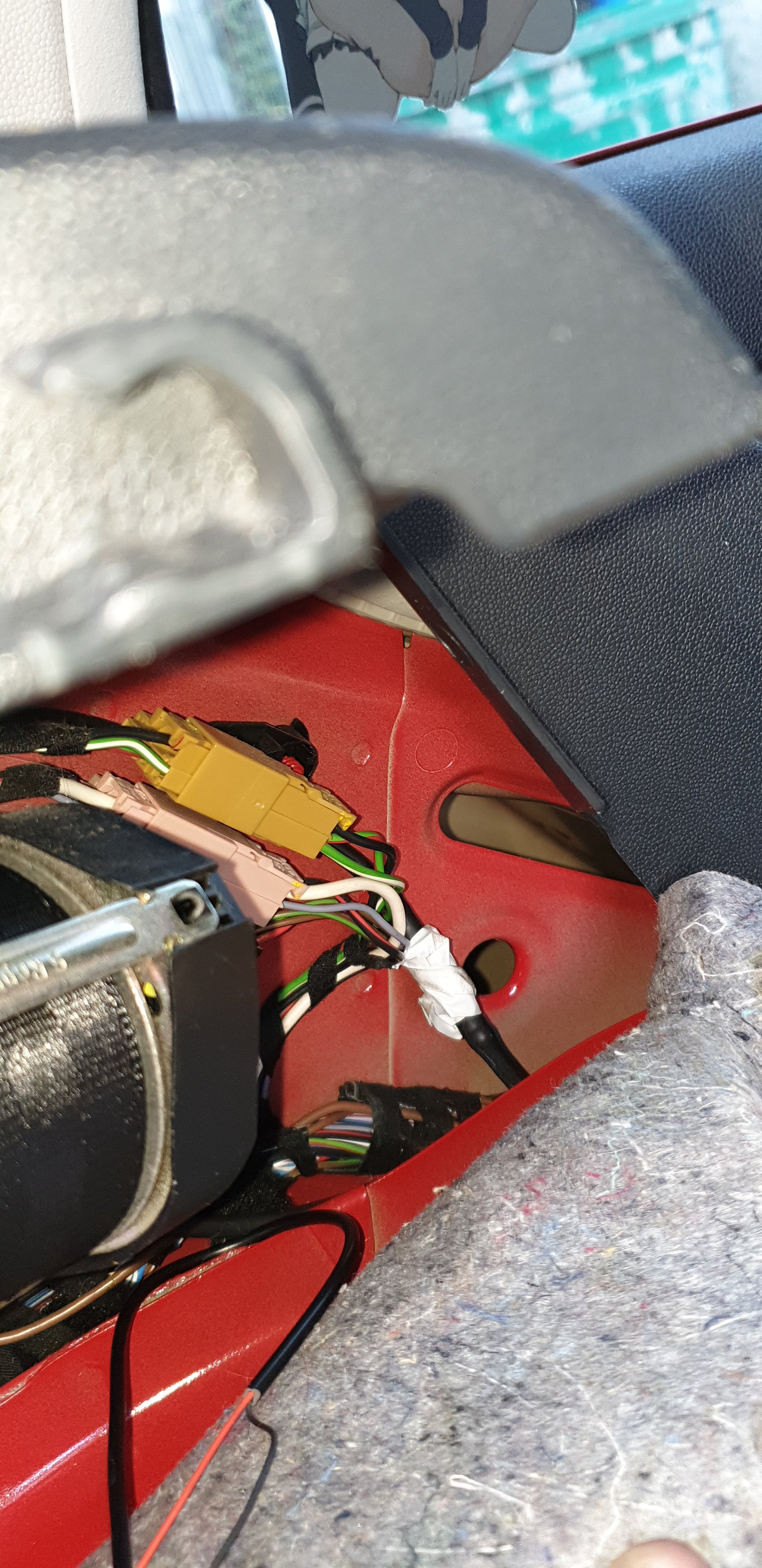

After I  disassembled my car I found it!
The Pope was disconnected where the rear speaker is.
I managed to find it by taking the wheel off and the plastic trim along with the bumper and follow the pipe and found it disconnected there.
I put some white tape over it just incase so it dont come off again.
Thank you all for help.

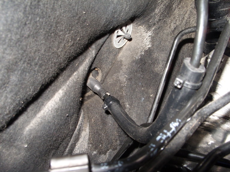

An much better fix is to get some Halfords 5mm vacuum tube and cut the awful OEM washer pipe connectors off and use the rubber vacuum pipe to join the washer pipe together. I did this both at that rear one and the joint at the bulkhead. Never had a problem since. Halfords sell that pipe prepacked off the shelf...
https://www.halfords.com/workshop-tools/garage-equipment/fuses-electricals-fixings/halfords-vacuum-hose-5-0mm
Edited by TMB
Someone else also suggested using heat shrink sleeving over the OEM joints, which I quite like as well.
Zip ties work as well.
