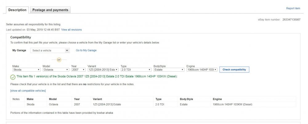

yea it does say its the correct one
also says
- Towbar incl. screws, bolts, plates
- Electrics 7pin (incl. recommended by-pass relya, L.E.D. ready)
- Swan Neck Towball ISO 50mm
- Fitting instruction
- Towball Cover
- Warranty (3 years)

turns out that one in the ebay link I showed you is not the right one for my car I sent them a message via fleabay messaging and they say no.

Thing is I cant seem to find one with the leccy bits for sale on ebay I thought I had with the link I put on here at the beginning but messaged them and they say no it wont fit
