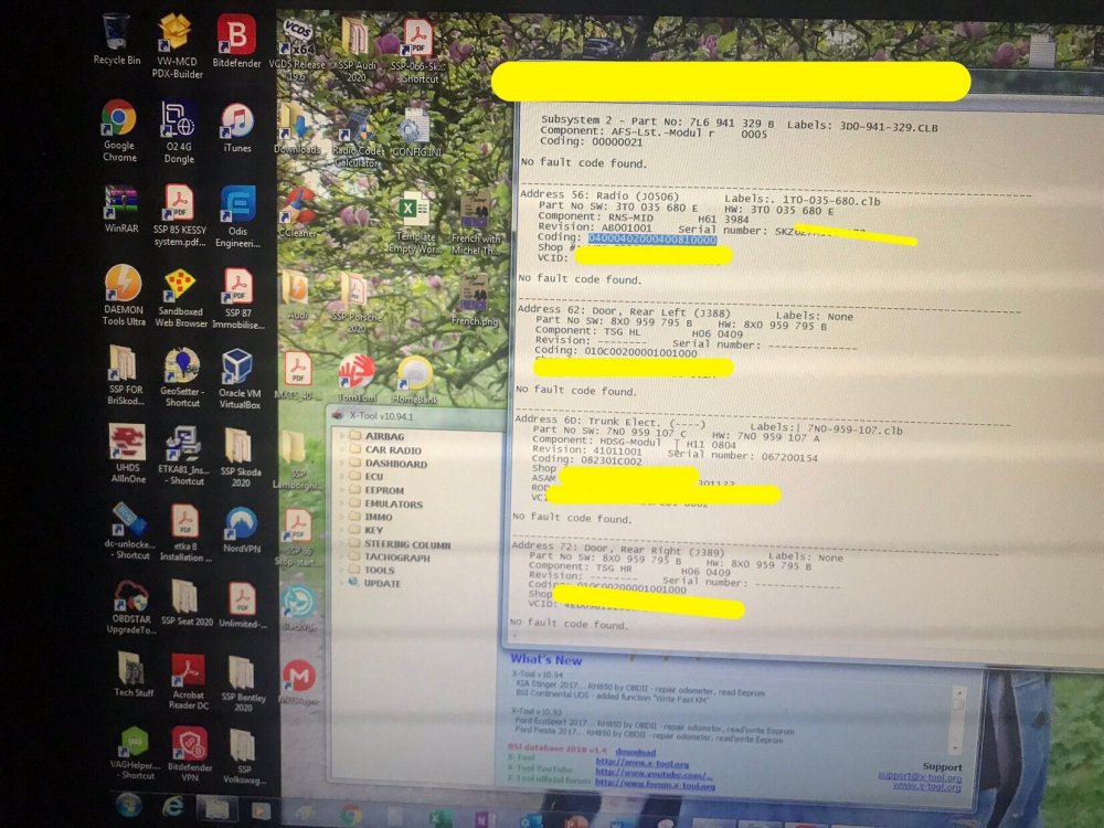

Zoom in to see my code, the park display shows with this code.
Edited by 3T51704x4

Change your coding string to this...
00060002000000811000
And buy VCDS instead of the tool you currently use to remove random coding here and there.
Note: this should address the missing OPS display. If there's anything else which has been changed by mistake then that will also need attention.

Well, that's a lot cleaner than the Gateway Installation list showed previously. Controller 9, no basic settings. That's a curiosity. I'd personally be looking at that and seiing if I could get that particular fault cleared by locating and trunning the Basic Settings it's complaining about.
Can you try going to address 09 (BCM) and uncheck byte 21, bit 7?
I don't think there is a description so there may not be a checkbox. If so, manually change it in the top box from ED to 6D.
It's just a suggestion based on an old scan you send me from OBDeleven. Everything else in byte 21 seems wiper related so it might help :)
