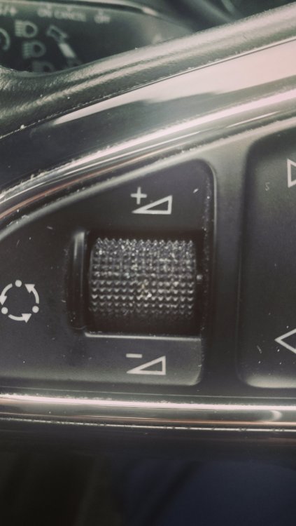

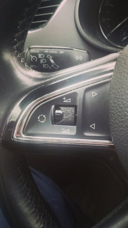

Hi all, the thumbwheel on the volume control cracked a while ago, it's been working ok despite this but recently it jams at some points, guess it's expanded due to the weather.
What are my options about fixing / replacing this? I expect I'll have to replace a whole part of the assembly? Take it apart and try and fix?

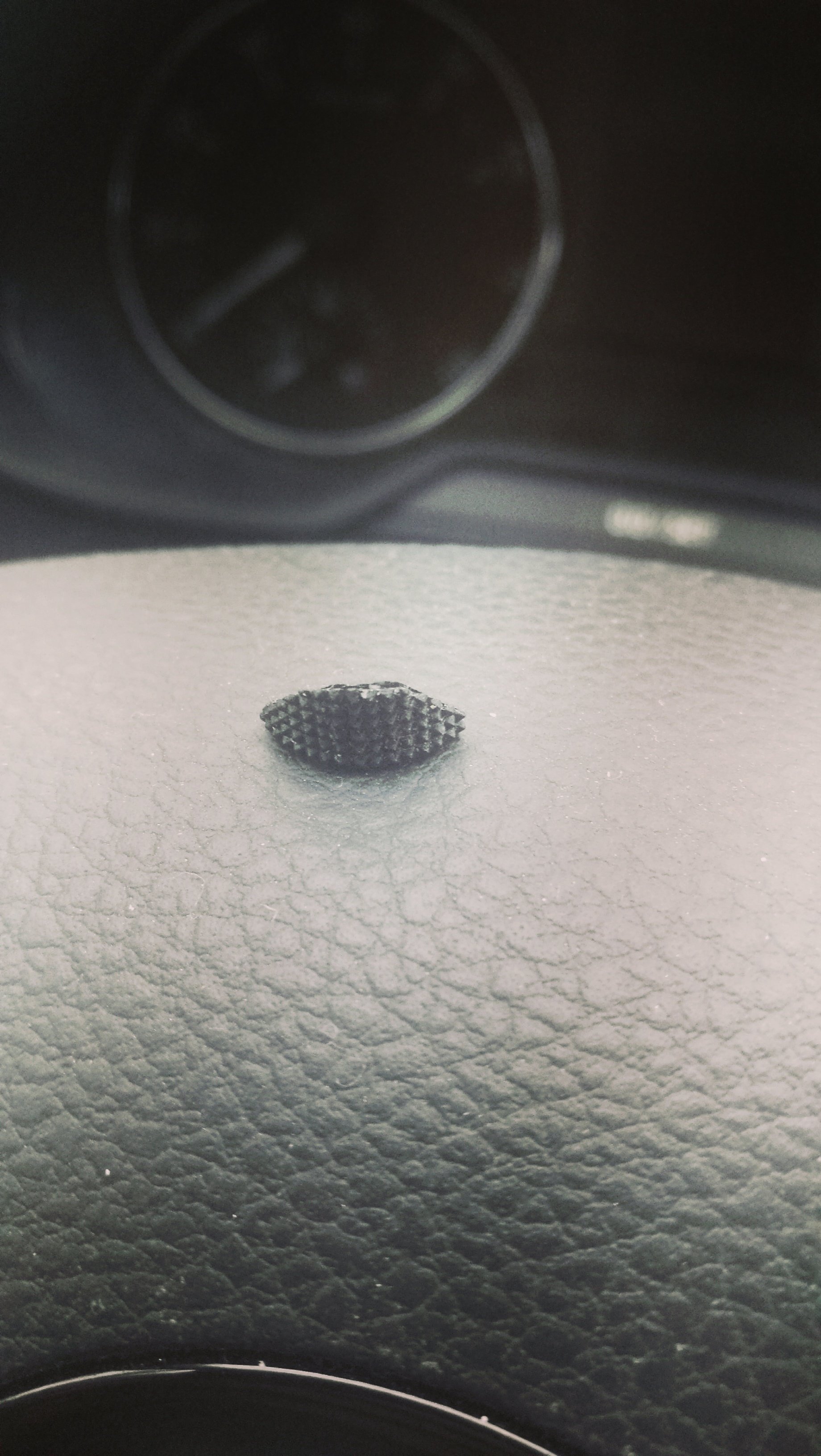

I've got 2015 Octavia Combi and the volume roller cracked, vehicle is not under warranty anymore. Didn't want to pay £300+ for spare part. Cracked piece was preventing the roller from moving properly.
Luckily I was able to get the cracked piece out by carefully sucking it with hoover and it was still in one piece. Then it was just matter of gluing it in place and all turned out well.

My thumb dial broke too and looked exactly the same as pictured above. I used the vacuum cleaner as per and managed to get it looking new again with super glue. Thanks for the info, I was at a bit of a loss before reading this.

Mine has decided to come apart this morning. Can’t really see how it can be bonded back together.

The volume roller on my '20 Karoq (assume the same across models) cracked, however mine went like a broken Hula-Hoop rather than just a piece coming out - it is as if the roller itself in hollow, rather than having a plastic inner, as the pics above show.
