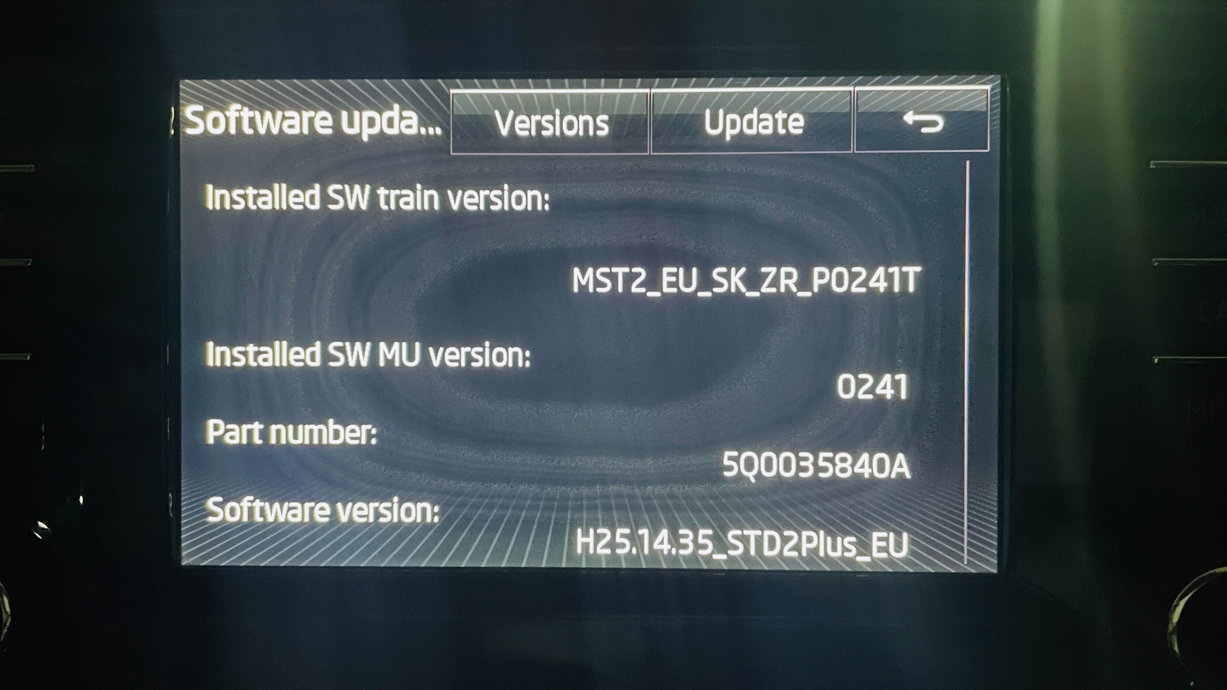

I can see only one update which also seems to be pretty old.
IMG_3177.thumb.jpg.b59a835d0469c895688702012018beb2.jpgIMG_3179.thumb.jpg.a513b2804204955ff43f014a95cc219f.jpgIMG_3178.thumb.jpg.423166ee2001a445c61e15da833caabb.jpg
Where do I download 0241-2 from? Or do I have to only connect an empty pen drive and it will download through mobile net? Please guide.
@dpen14 The first picture shows your current installed Software Train MST2_EU_SK_ZR_P0241T
This is also the correct location for firmware update button
Available is MST2_EU_SK_ZR_P0253T
The second image is only showing you what update(s) that have been applied, and what version you have running in the system
The third image, you should update via SD Card, I don't think anyone has ever had success with USB.
Download is via a private message, and you copying the extracted files to an SD Card.

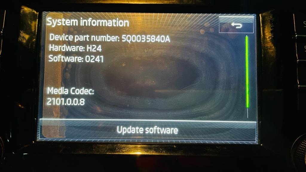

Apologies for replying to an older thread, but would anyone be able to send me a more up to date firmware for the below Bolero?
1630346833_Screenshot2022-11-15at20_27_31.thumb.png.b6e7d060e6a3ded27fda6182fc6a989b.png
Been having odd issues with CarPlay and was hoping that this may help.
Probably 0253, but you need to hold down menu/setup key to view software train and this is also the location for the firmware update button.

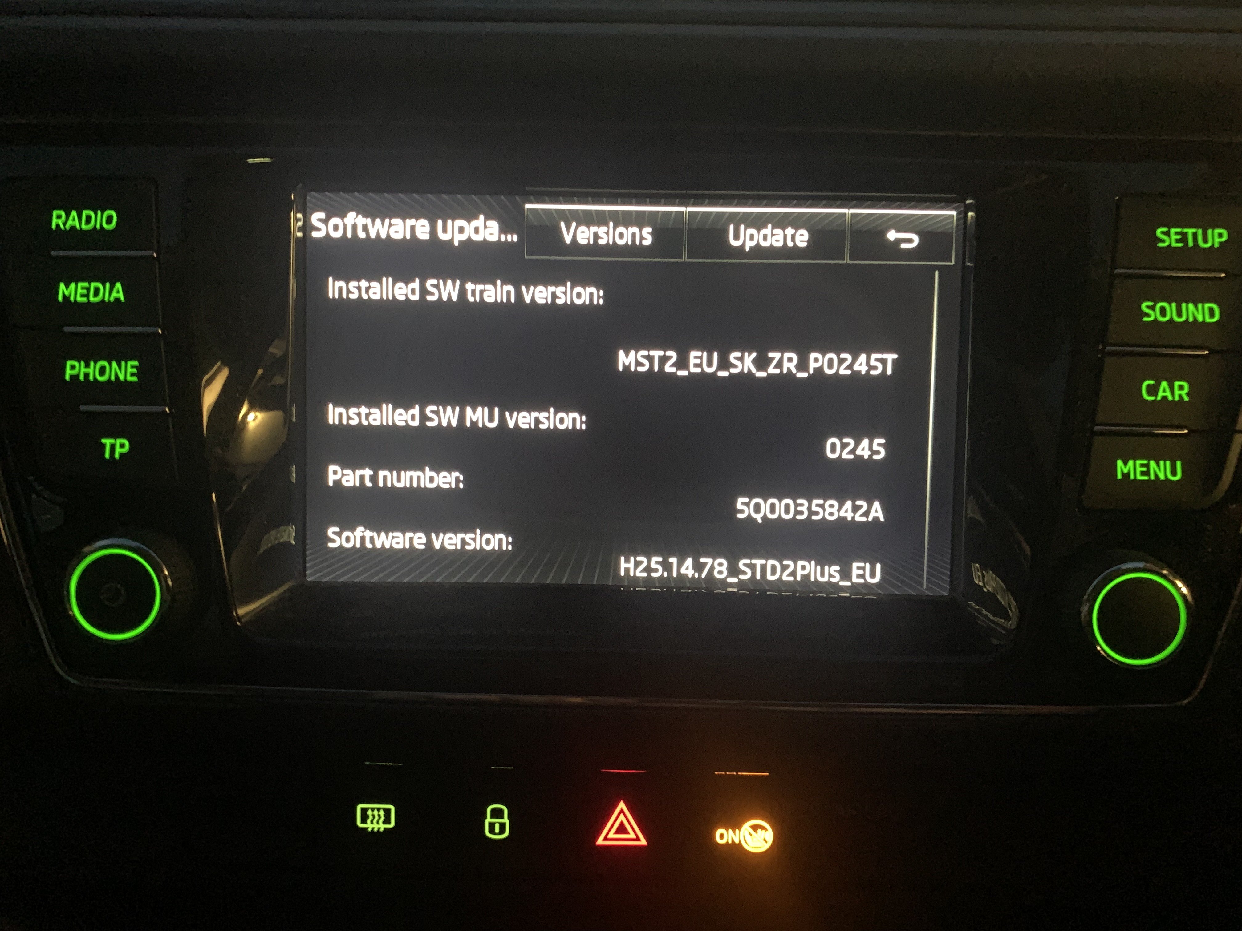

Is it possible to update with this firmware a SEat Leon with;
Hardware: H24 and software: 0245 ???
Many thanks
Many thanks
Welcome,
Please verify the full Software Train, hold down your Menu/Setup button for 10 seconds to enter the engineering menu.
MST2_EU_SE_ZR_P0245T <-- Should be yours
MST2_EU_SE_ZR_P0253T <-- Available
