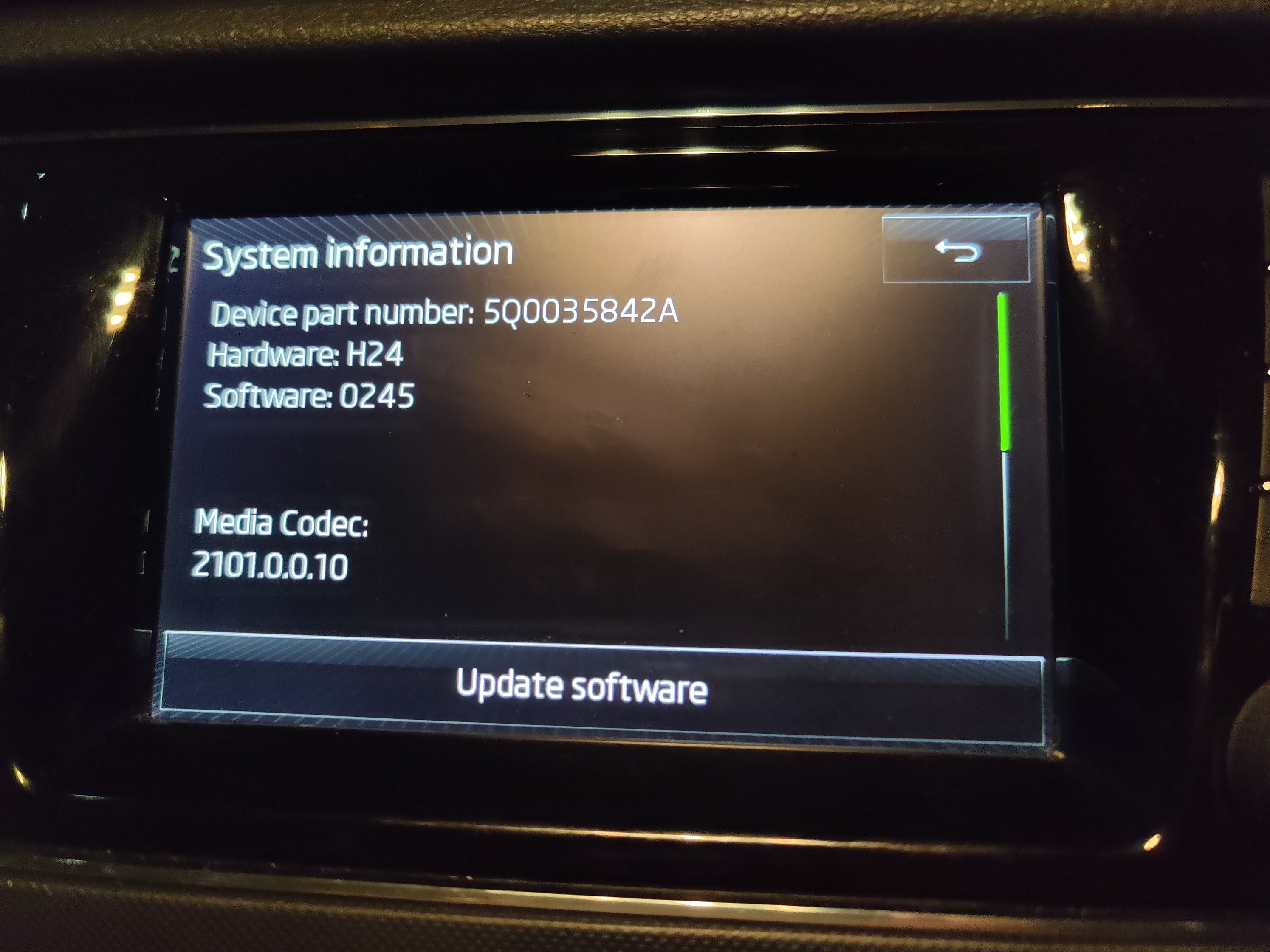

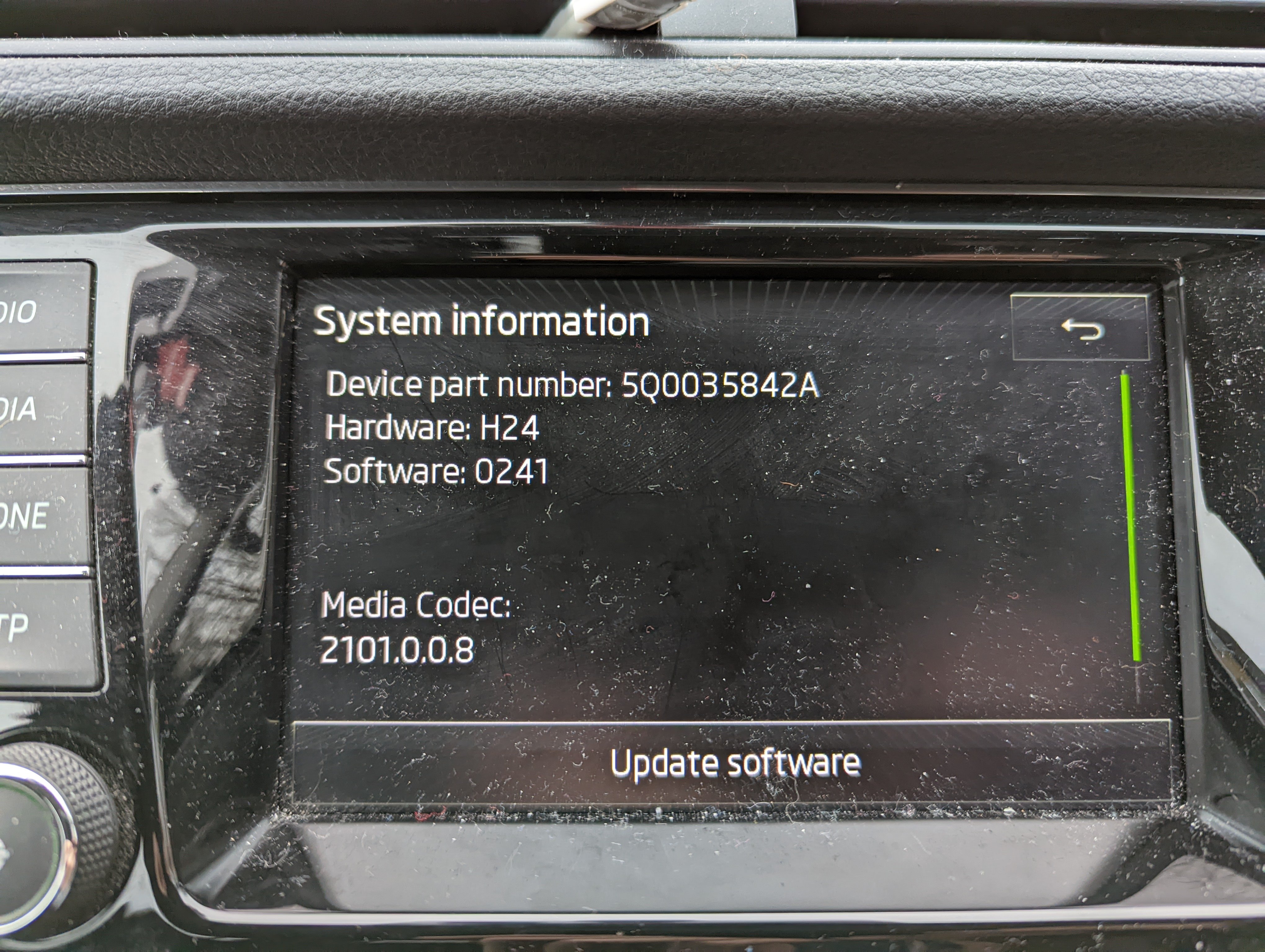

Is there an update to Infotainment System (5Q0035842A / H24) newer than 0241?

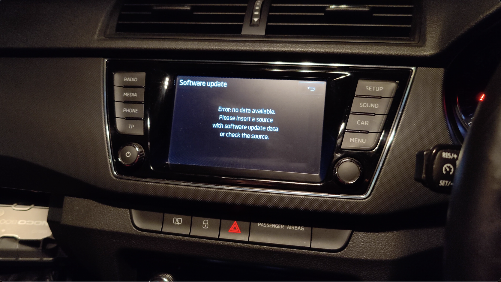

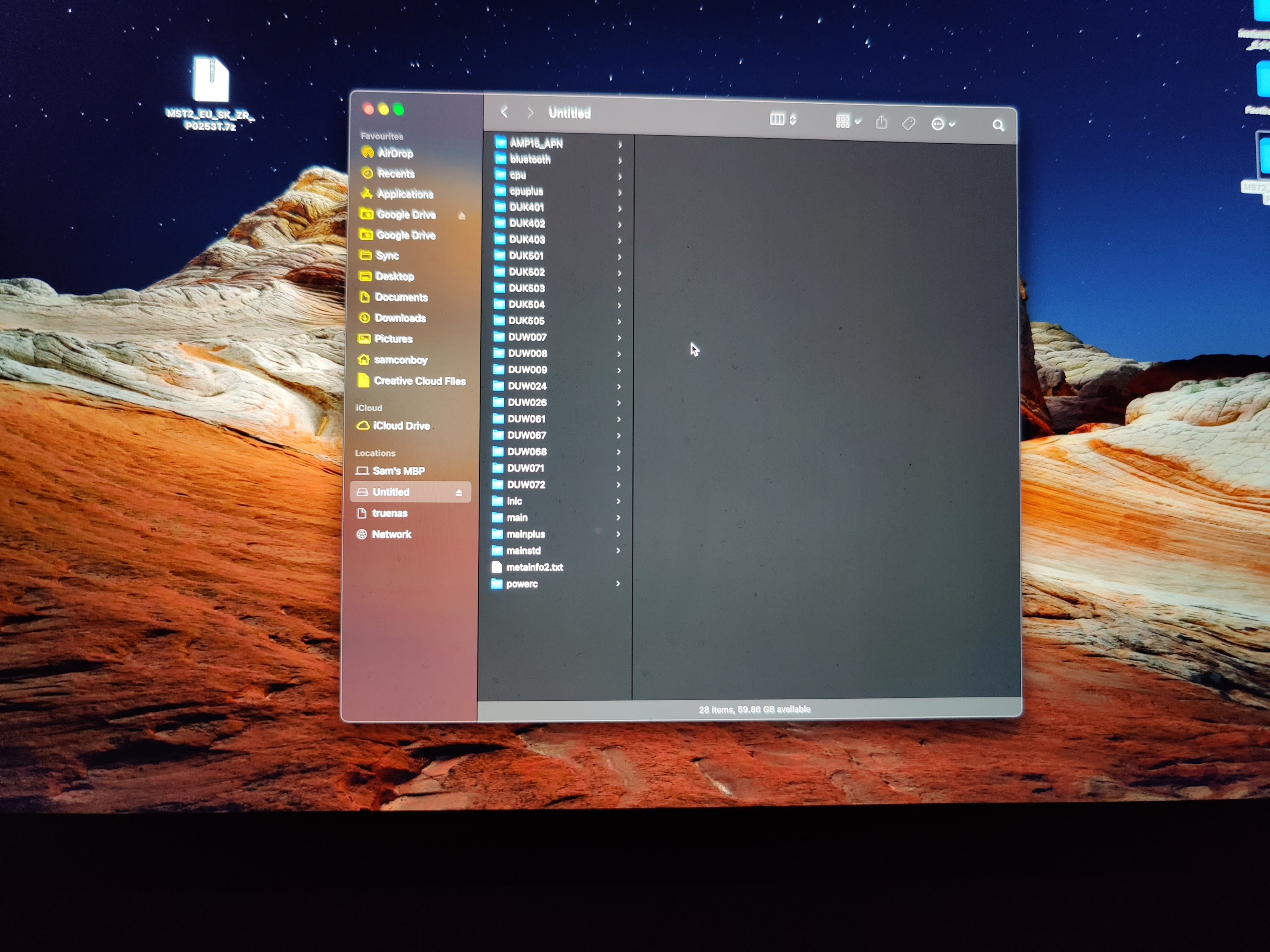

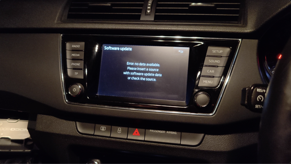

Any idea why this isn't working?
I've extracted the folder from the 7z, but when I put the entire folder in the SD card it doesn't work, and if I put the contents of the folder like below it picks up as a software update but I still get a "no data available" error.

@foxtrotoscar19 you  must start the update from Service menu (long press MENU button)

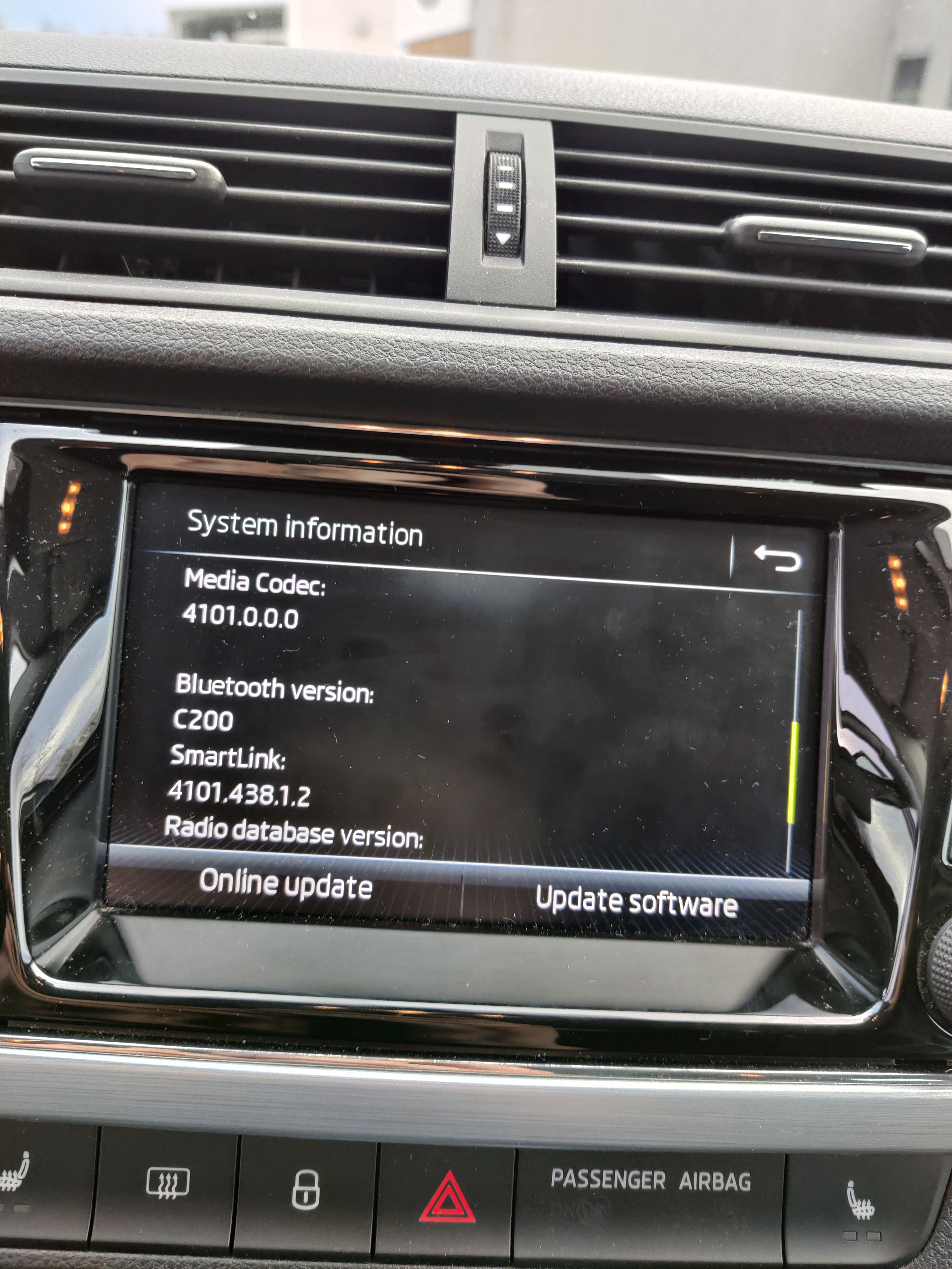

Hello,
Is anybody kind to tell me if there is a new update for my unit ?
Thank you!

Hi @pab567
Please can you PM me the relevant update for my unit?
@DanielMoise you already have the latest available SW version

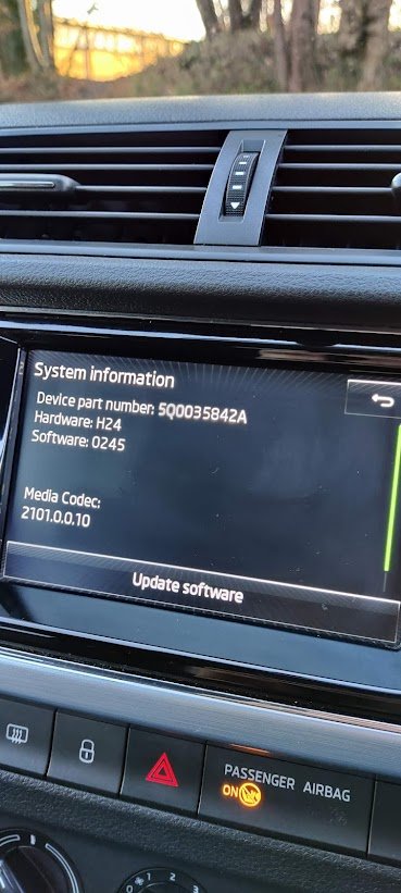

Hello ! @pab567
Thank you!

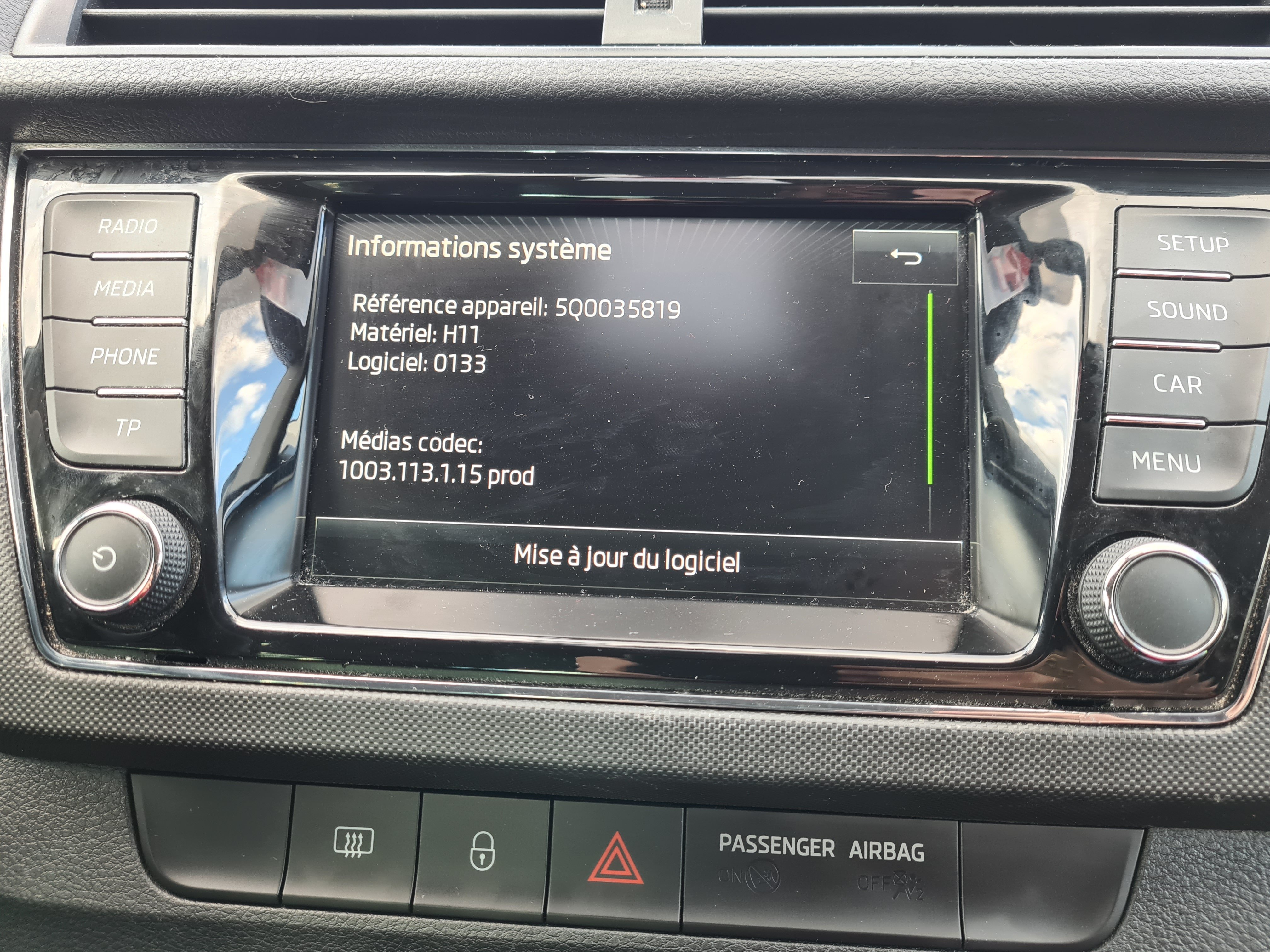

Hello ! @pab567
would you have a new update for my unit ?

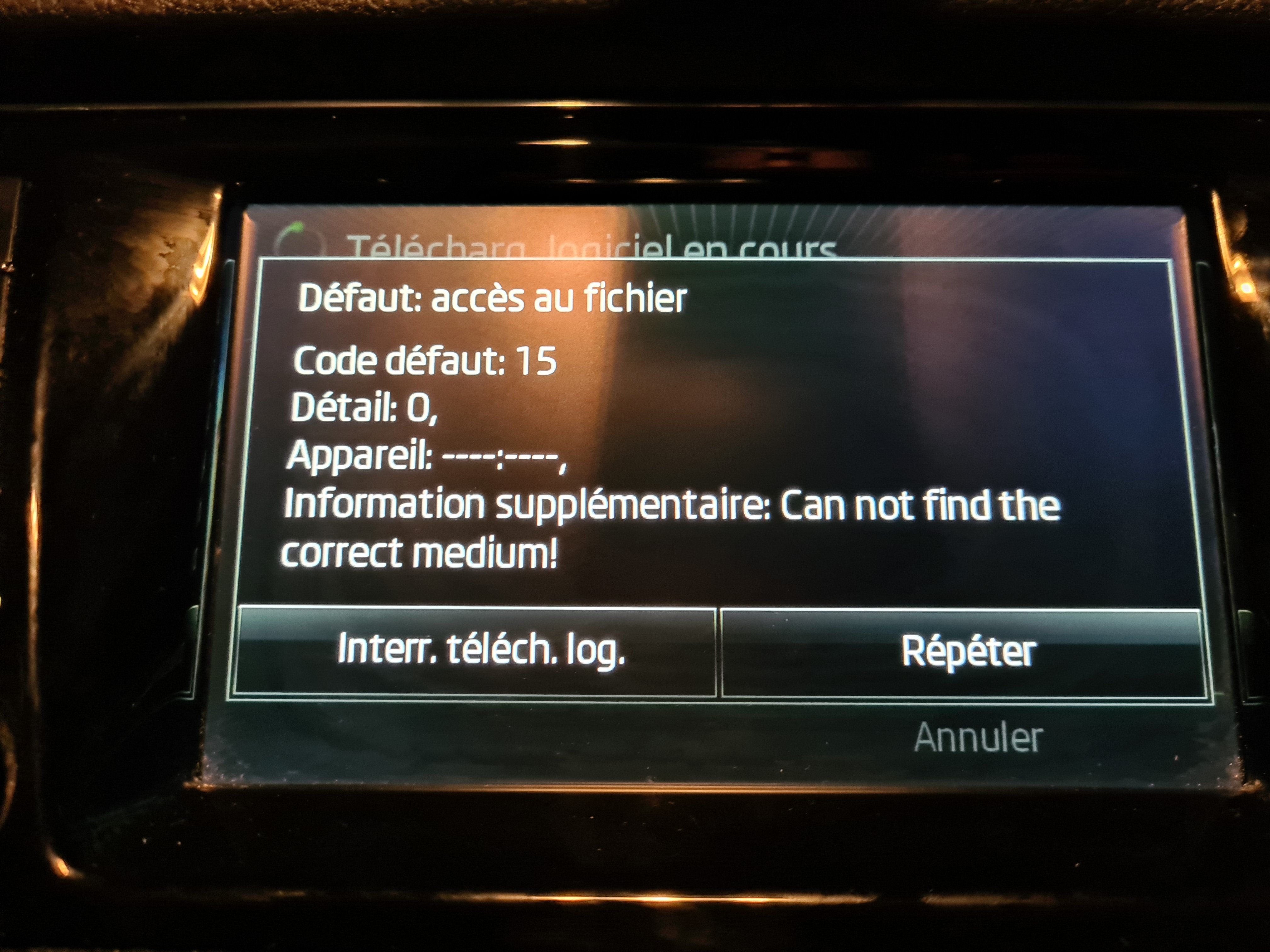

hello @pab567 when i try update it give me this error what am i doing wrong thank you 268312126_457953799271381_3826840793292885067_n.thumb.jpg.063adee748b3cbce08153078ab2a1899.jpg
In such case unfortunately I cannot help you 😞
