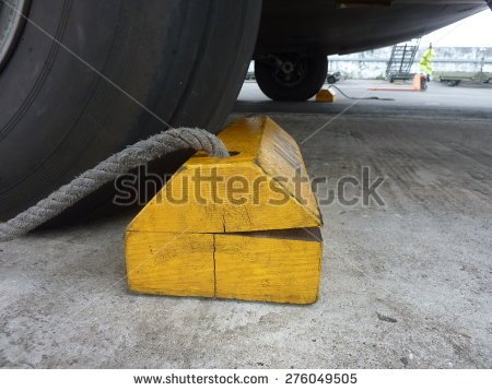

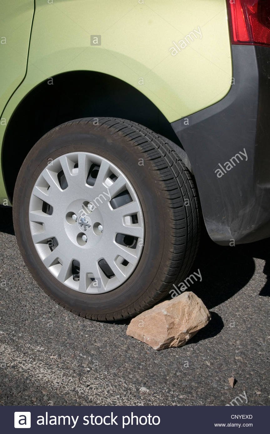

Check if the Skoda Dealership can supply this essential equipment for the vehicles they sell and maintain.
Necessary for parking on hills or over winter months.
wheel-chock-chocked-handbrake-hand-brake-brakes-hill-parking-on-roll-CNYEXD.jpg.4b2980a6422aa8cf6bb397f140a8f159.jpg
5a6eecef7d5f4_4b-HowtoChangeaTire-carparkedonaflatsurfacewithreartiresblockedwithalargepieceofwoodarrowpointstowoodpiece.jpg.70cea9aacada2e9003d62dd5fc209e72.jpg

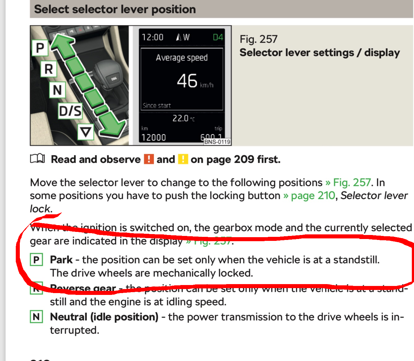

6 hours ago, Changeman said:
They also tell me the transmission does not mechanically lock when in park, a perspective which is disputed by Skoda technical UK.
From the book of words.......
"A parking brake is integrated in the differential to secure the vehicle in the parked position and to prevent the vehicle from creeping forwards or backwards unintentionally when the handbrake is not applied.
When the selector lever is moved to the 'P' position, the parking lock is engaged. To do this, a locking pawl engages in the teeth of the parking lock gear."
Also my DSG, (also a DQ250) does not roll on any hill when in 'Park' no matter how steep. The dealership is telling porkys I would suggest they consult their manuals and self-study guides again
I would suggest something (like the emergency release) is stopping the parking lock engaging allowing it to roll.
