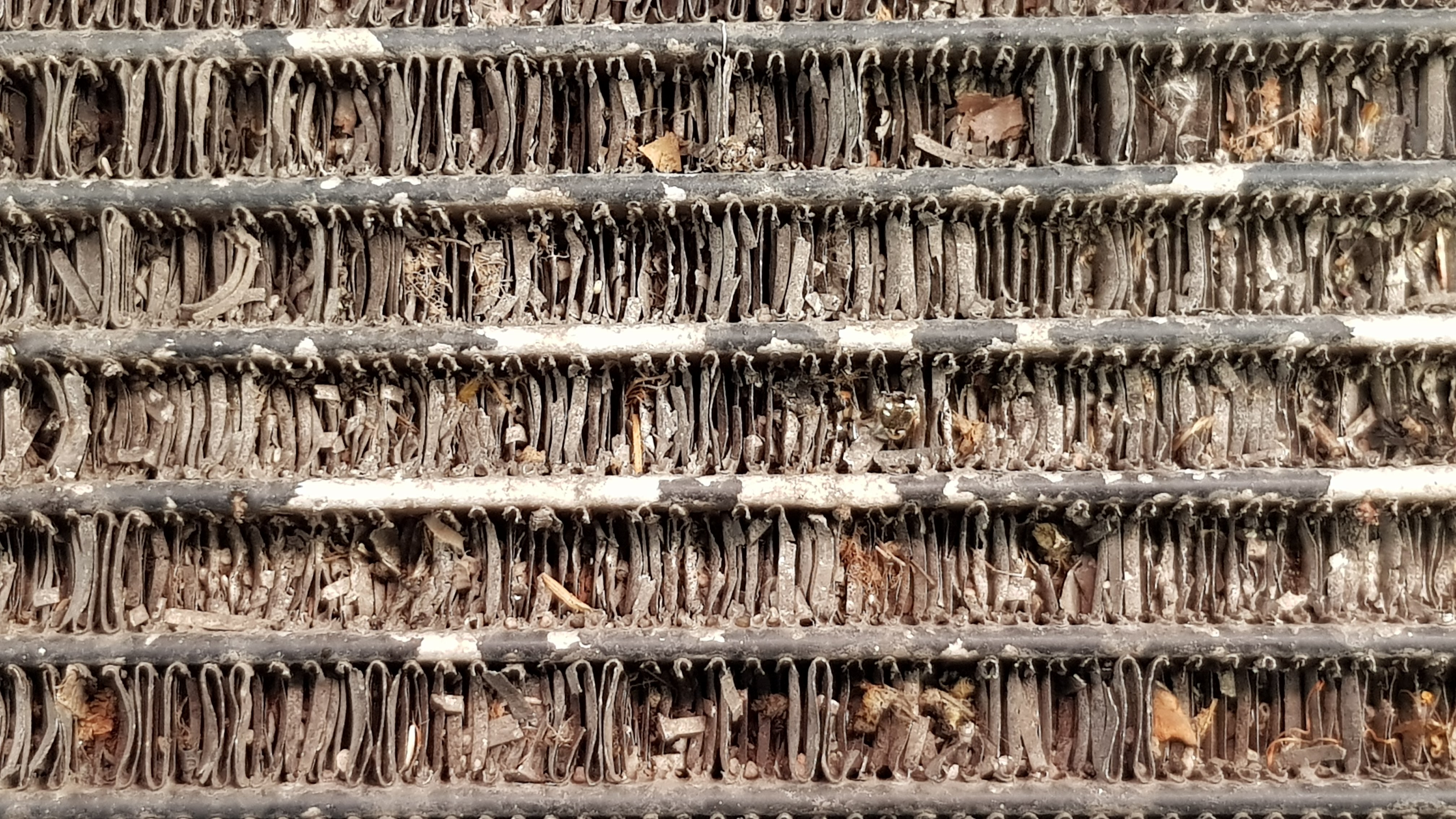

Here's a peek at the condenser through one of the apertures in the lower grill.
The entire visible surface is like this....no way is that letting a full flow of air through the intercooler behind it!
Have you tried blowing out the bugs from behind, water hose jet perhaps.
Fins don't look too mashed, just lots of bug and dirt debris blocking, which will be dry, brittle and pretty easy to remove
A soft brushing will get rid of some, water jet more. Just requires a bit of perservence with a soft toothbrush
To get access to blast out from behind would mean taking the condenser out.....I think if I was going to the effort of doing that I'd just replace it.
