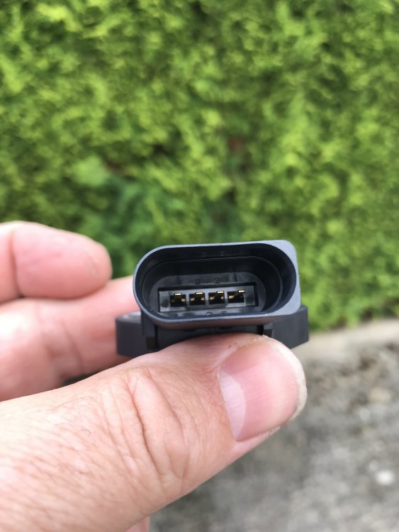

To verify the sensor and cable I need the specification or at least the pin layout on the sensor, I can not find either when searching on the web.
Would be great if someone have this information or any other idea?

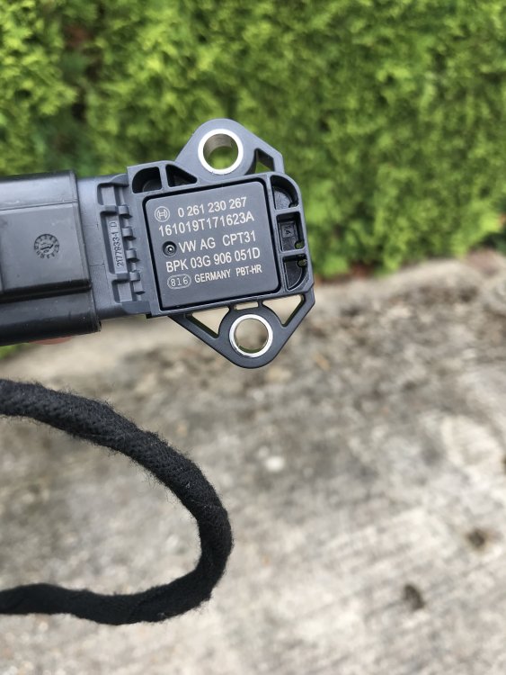

The original sensor part number is:
0 281 002 977
03G 906 051E
BR

Look at the MVB for word 01 and find the actual and specified boost for the thrust sensor, then compare with the ambient pressure reading of the engine ecu, should be very similar with the engine off, ignition on. You more than likely have a broken wire within the PVC which may look OK.

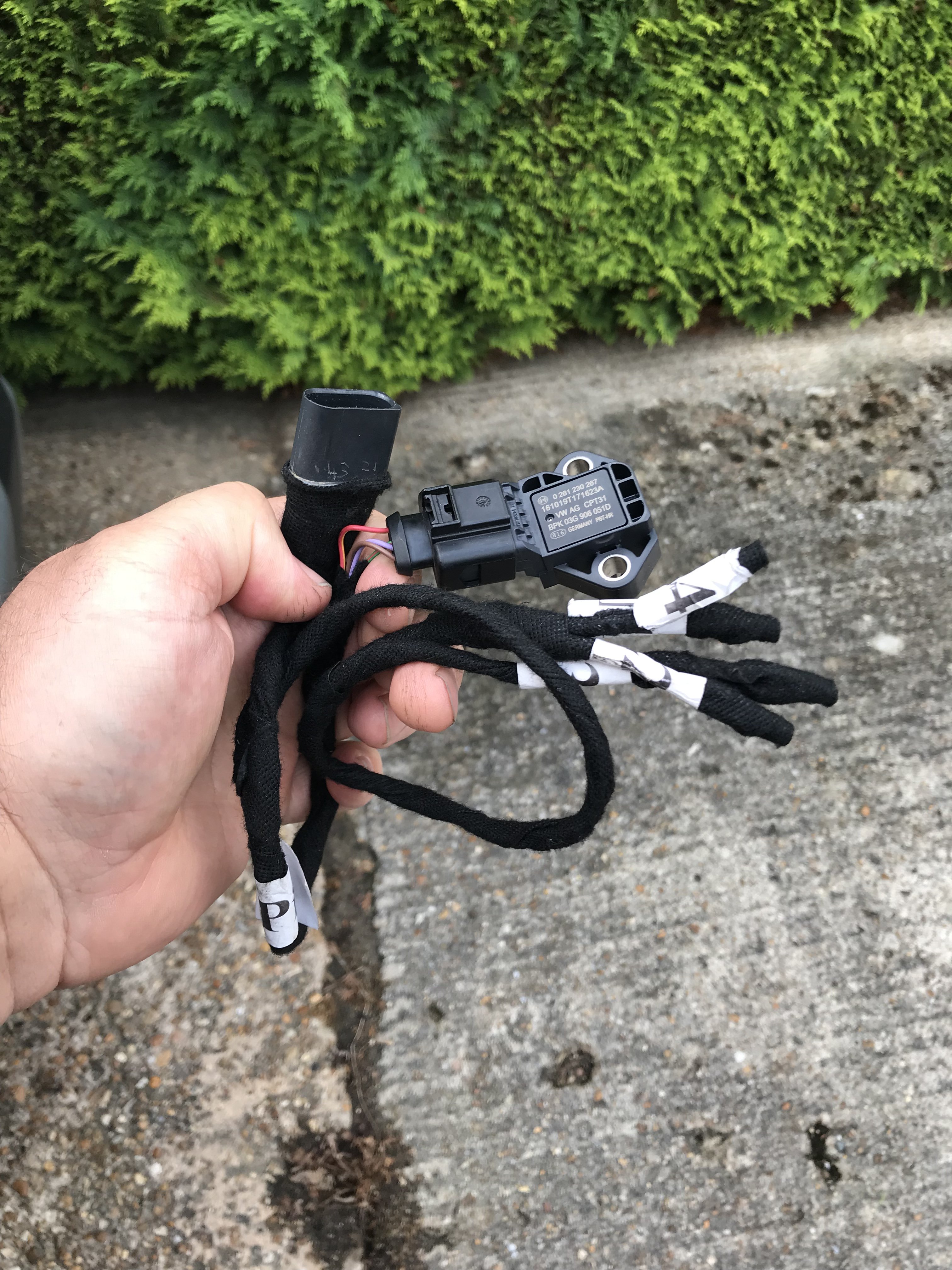

 Will get my CFD out later to confirm. Should look similar to this although yours is an E, the wiring will be the same. This is a test lead I knocked up to do inline tests.
NB don't take any notice of the colours I used for the test lead.
Edited by 3T51704x4
This info is current for my VIN, NOV 2011 on
G31 - Charge Pressure Sensor (parts call it a thrust sensor)
G42 Intake air temp sensor in same housing as G31
J623 - Engine ECU old school word 01 new school address 01
T94a- 94 pin connector on engine ecu
T4bl- Black four pin connector somewhere on or around the gearbox.
All wires are 0.5mm
Pin 1 of G42 is brown which goes to terminal 1 of the T4bl connector then to T94a/66 which means pin 66 of the 94 pin connector.
Pin 2 of G42 is yellow which goes to terminal 2 of T4bl then changes to red/green out of T4bl (still pin 2) to T94a/30 (pin 30).
Pin 3 of G31 grey/black to pin 3 T4bl to pin 17 T94a
Pin 4  of G31 purple to pin 4 T4bl to pin 83 T94a
So:
Pin 3 5V in to sensor for both G31 and G42 via engine ecu
Pin 1 Earth for both sensors via engine ecu
Pin 2 variable signal back to engine ecu for G42
Pin 4 variable signal back to engine ecu for G31
If you plugged in a known good sensor, the fault must be either wiring or much less likely, the engine ecu.

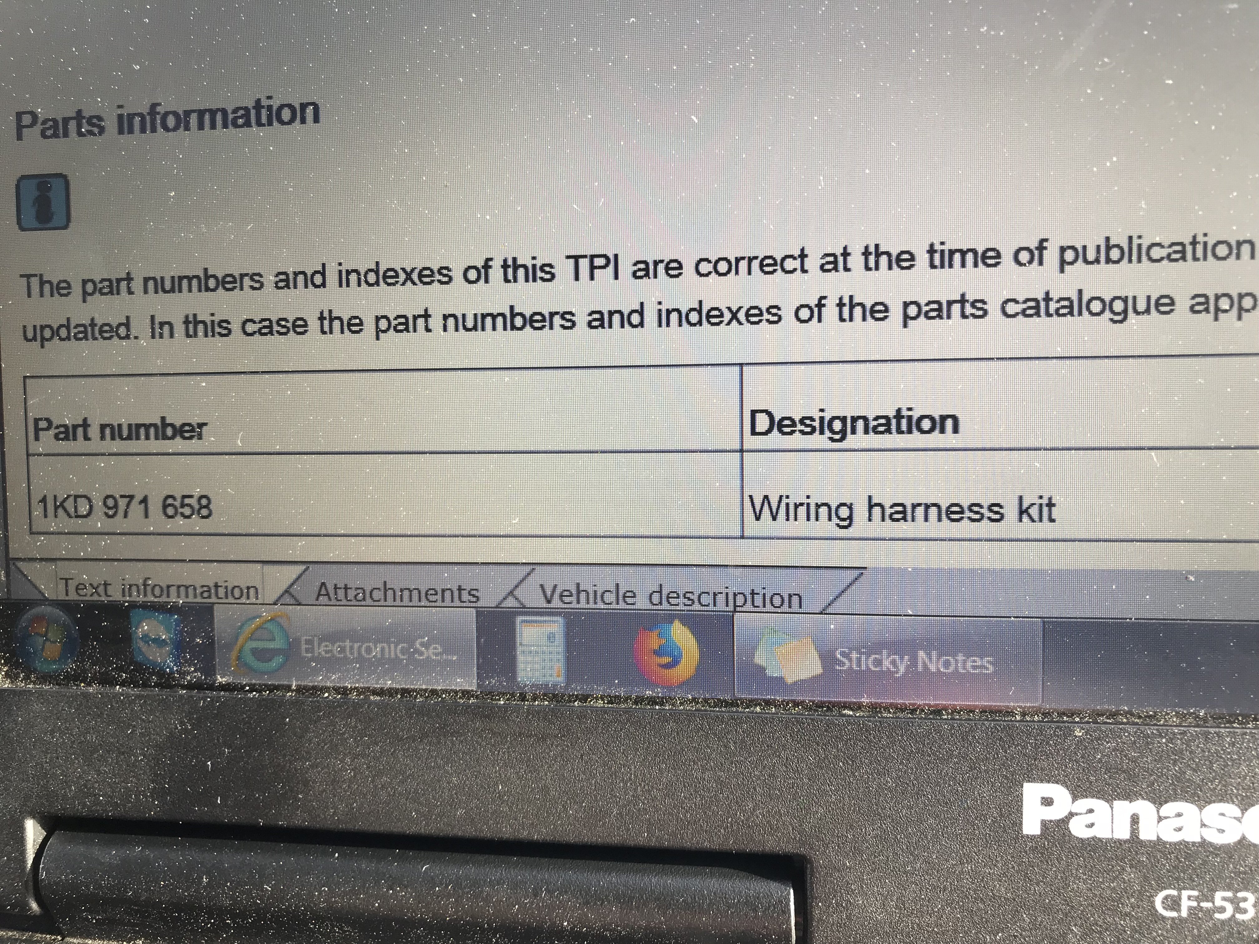

VW were plagued with wiring issues with the boost sensor a number of years ago. They did release a wiring harness overlay for the TDI to rewire the sensor back to the ECU,
I remember they did a loom kit for the boost sensor on the Passat, will have a shufty through hst at lunch to see if I can find a part number
I have a VAS 1978 kit so could easily make one if not.
I was the only one that ever used ours, everyone else was scared.
Ha, best tool in my view. Love using it

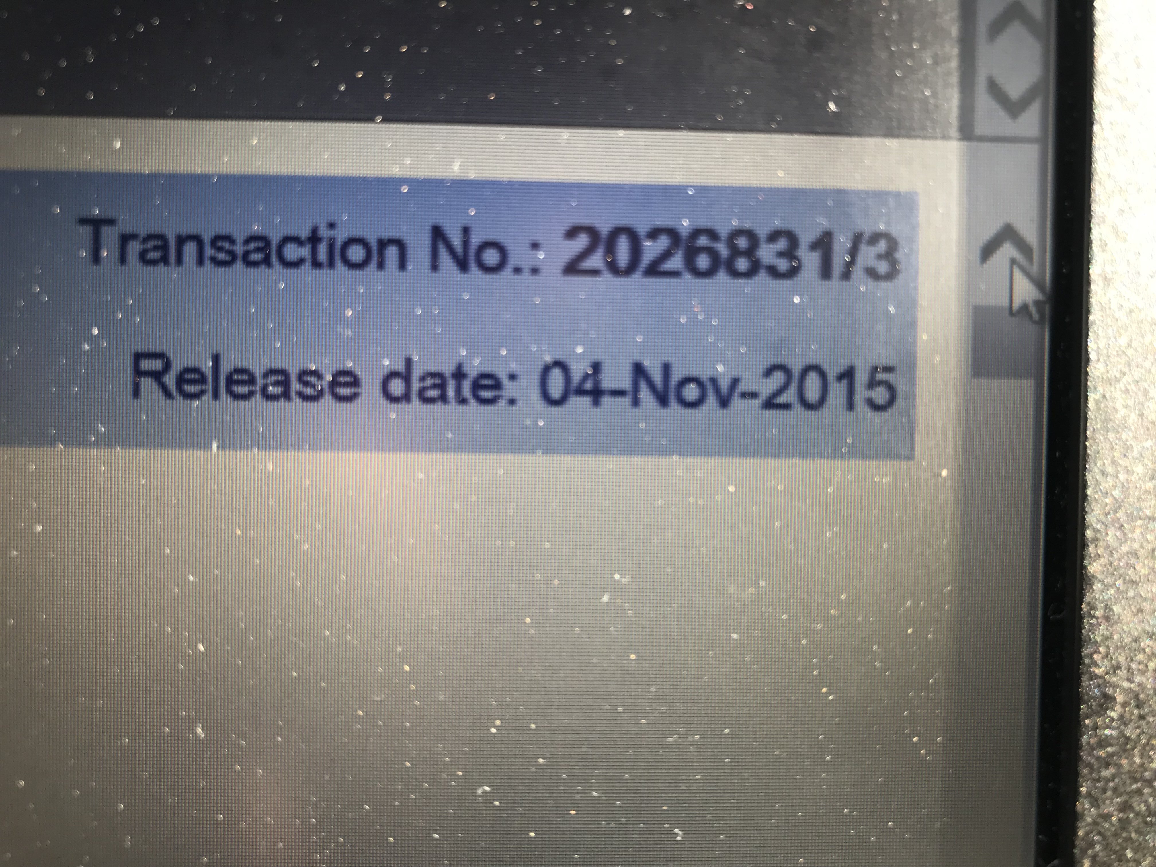

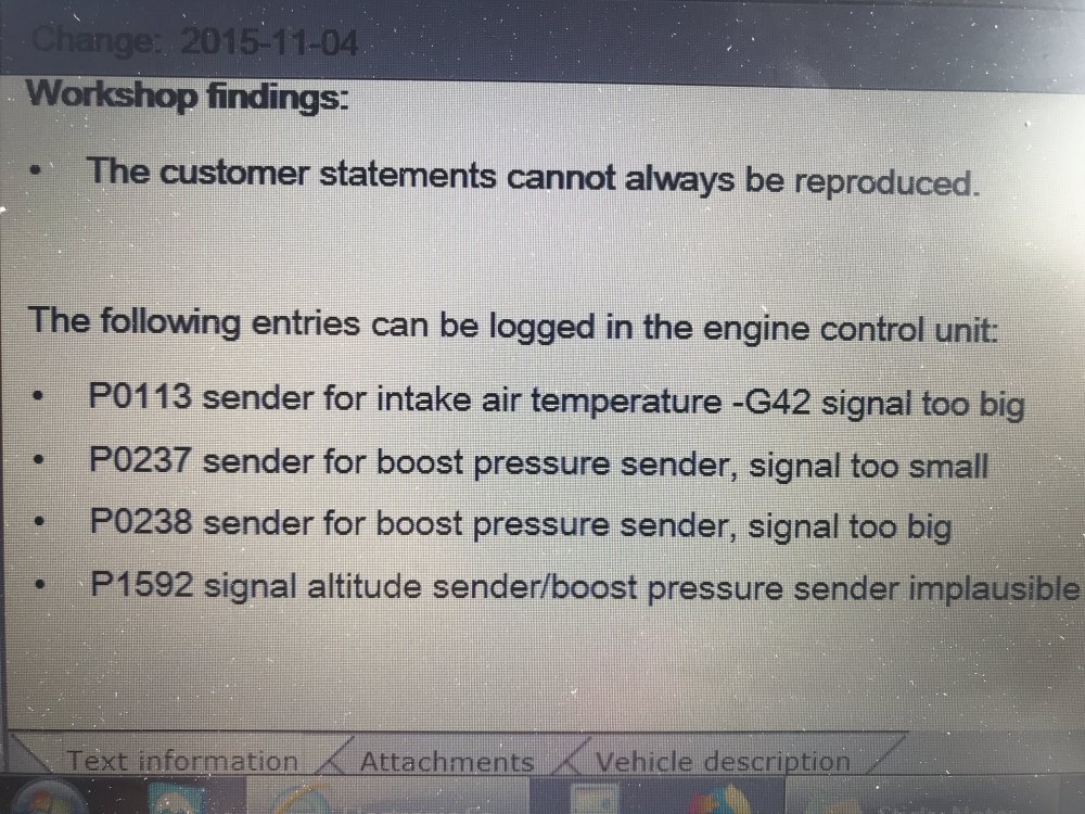

Found the TPi last updated in 2015. (But the info was avail back around 2011)E8F1D07E-F8B3-4266-8A09-1ECAA983DA2C.thumb.jpeg.d9d4be6e7f1b162621a5f2e05d9fdcb2.jpeg
Edited by 3T51704x4
Plucked that one out of obscurity that’s for sure.
@Tech1e
You reminded me I had seen a bulletin for the boost sensor, just had to try and find it.
At least if the garage fit the kit, you know it will be sorted once and for all.
Edited by 3T51704x4

Hi!
I got some answers.
They worked according to TPI 2027092/3.
(sorry for swedish)
* TAGIT FELMINNE FELKOD FINNS
* KOLLAT TPI HITTADE ETT SOM STÄMMER PÅ KUNDENS BESKRIVNING
* FÖLJT TPI KONTROLPUNKTER
* PROVAT ATT BYTA G31 BLEV INGE BÄTTRE
* GJORT GUIDAD FELSÖKNING FEL
* KOLLAT TURBON OK
* MÄTT TRYCKET I LADDRÖRET DET STÄMMER
* MÄTT STRÖMMEN TILL G31 FRÅN MOTORSTYRDORNET DEN STÄMMER
* MÄTT JORDEN FRÅN MOTORSTYRDORNET DEN STÄMMER
* MÄTT SIGNALKABEL FRÅN MOTORSTYRDORNET FEL MOTSTÅND I KABELN
* LETAT FELET PÅ SIGNALKABELN HITTADE ETT BROTT PÅ DEN I KABELSTAMMEN
* LAGADE KABELBROTTET PROVKÖRDE BILEN DEN FUNGERADE SOM DEN SKULLE
* TAGIT FELMINNE FINNS INGET KVAR
The replaced 30 cm of the cable close to the map sensor.
* TAGIT MISCELLANEOUS ERROR CODE FOUND
* CHECKED TPI FINDING A CONFIRMATION OF CUSTOMER DESCRIPTION
* FOLLOWED TPI CHECK POINTS
* TRY TO REPLACE G31 WAS NO BETTER
* MADE GUIDED TROUBLESHOOTING ERRORS
* CHECK OUT TURBO OK
* MEASURE THE PRESSURE IN THE CHARGING TUBE IT'S CORRECT
* MEASURING THE POWER TO G31 FROM THE ENGINE CONTROL THAT IS CORRECT
* MEASURE THE EARTH FROM THE ENGINE CONTROL IT IS CORRECT
* MEASURED SIGNAL CABLE FROM MOTOR CONTROL TORN ERROR RESISTANCE IN CABLE
* MISSED THE SIGNAL CABLE ERROR FOUND A BREAK ON IT IN THE CABLE TUBE
* REPAIRED CABLET TRIAL THE CAR WORKED AS IT WOULD
* TAKING THE ERROR MEMORY AWAY.
