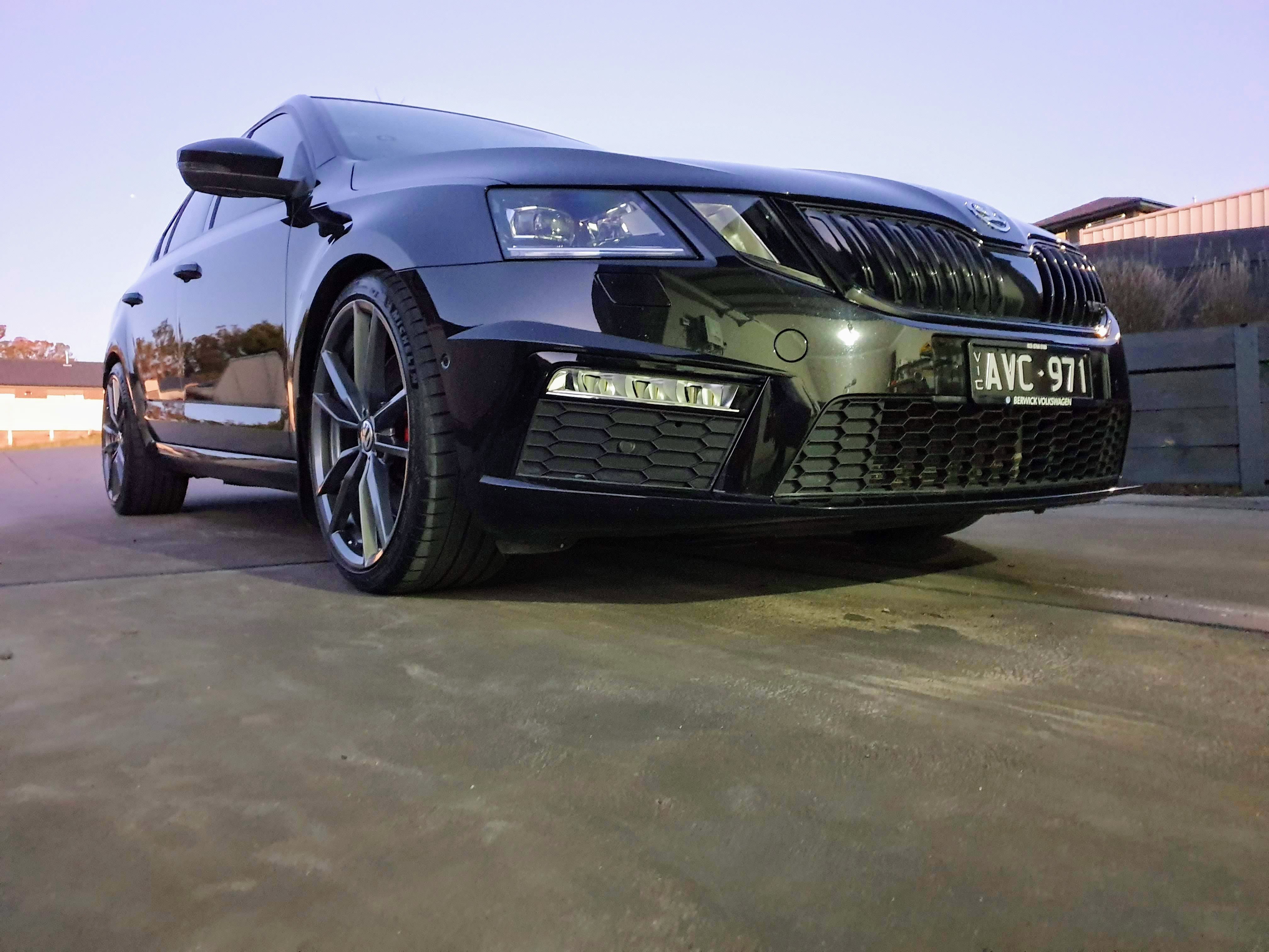

Brilliant,  thanks.  Thats two votes for the ET45.  From the picture of StealthRS245 I reckon you could push the fronts a little more.
