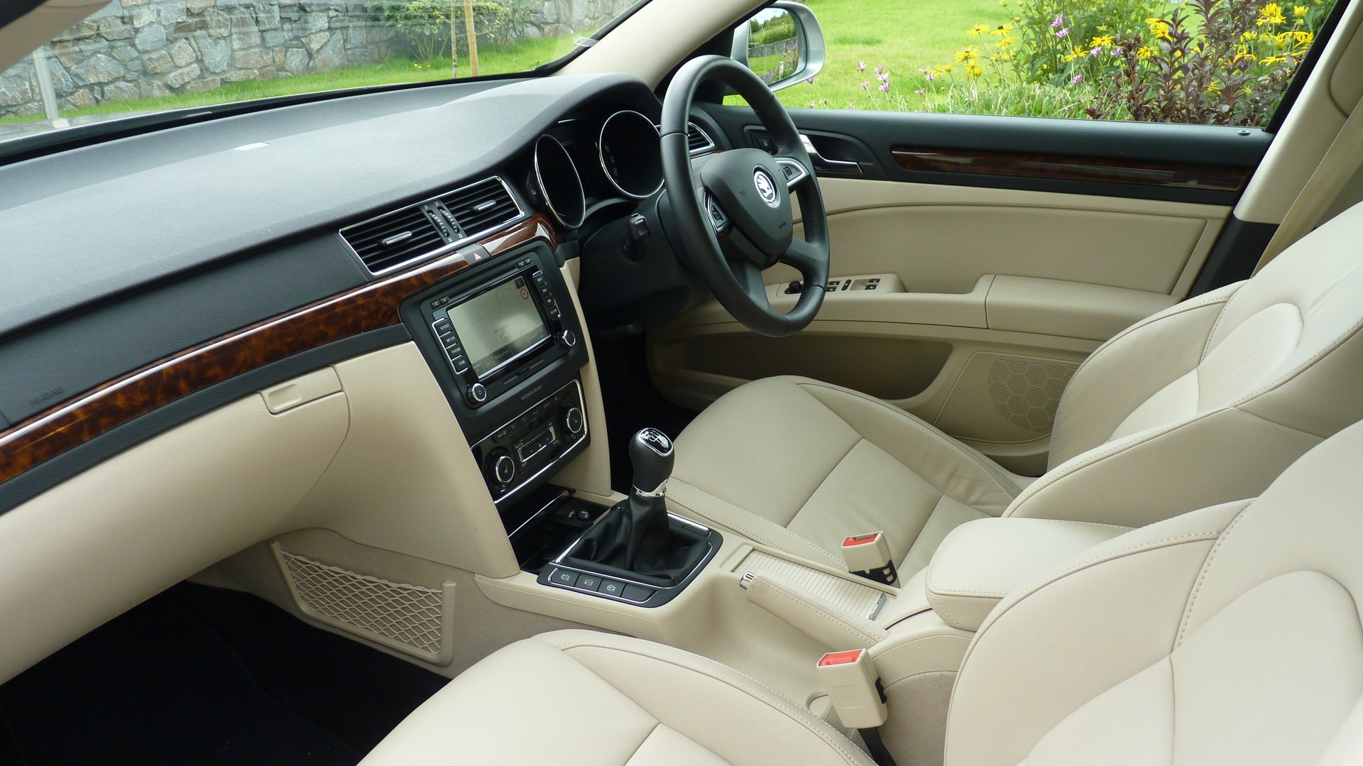

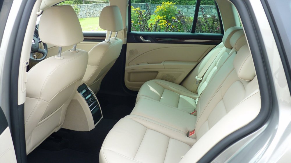

Oh boy, found two cars, both very nice but ... black leather or cream leather interior....? Tough call, I do like that Skoda have decided on black carpet with the cream leather, a very wise choice!
Ivory looks nicer, especially with blue or burgundy paint, but it'll show up the dirt more.
I have the beige leather on a Cappuccino car and it all looks very coordinated. The other plus (purely my opinion) is that you get a beige headliner, whereas the black interior gets a grey headliner which I never like on cars.
The dark carpet is a plus - works well with a black dash - its practical and it looks good (in my BMW owning days the light interior with a dark carpet cost extra and was referred to as "Highline").
I've had no issues keeping it clean but then again, dogs go behind the dog guard in the back and I don't have a litter of chocolate wielding kids to maintain! If you're looking at 2010 models, it should be pretty easy to judge how well its worn. when I was last collecting my car from its 5 year timing belt job, i had a good look at the second hand Superbs on the lot. I thought the ones with beige looked "fresher", though this could be a result of the owners cleaning it more often because of the colour! Maybe the back ones were a bit busier hiding the dirt....  😉
My Superb Elegance also has the beige leather interior - I love it!!!  The only issue I have is with the front interior door pulls - the plastic on the actual handles has turned to something resembling chewing gum!  I have patched them up using self adhesive beige vinyl - acceptable but not perfect.
