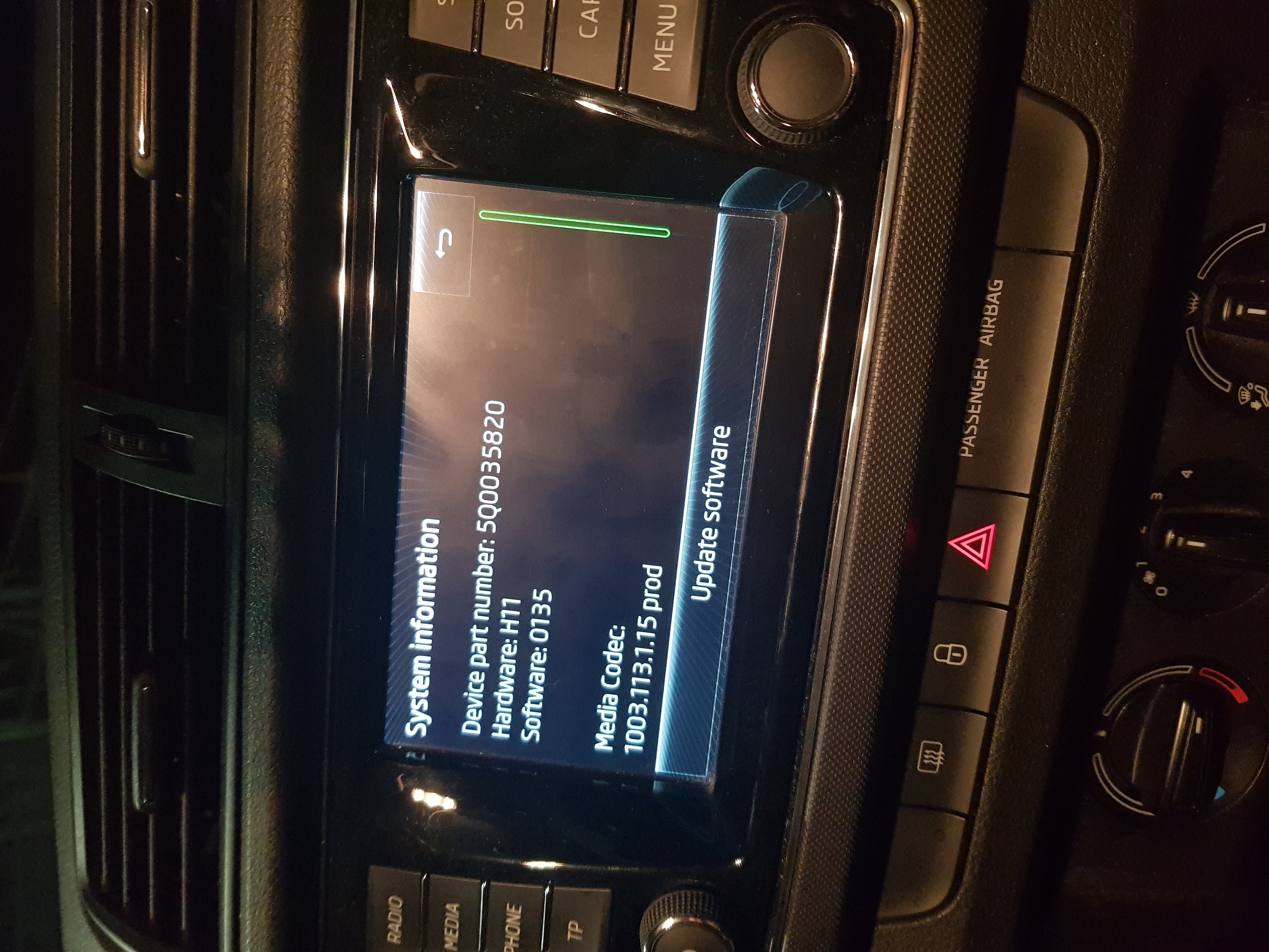

Hi @pab567
Could you have a look into my fabia's system and see if there is an update for it, skoda's website states no but you never know.
Thanks in advance.
Device Part Number :5Q00035840B
Hardware:H11
Software:0135
Media Codec:
1003.113.1.15 prod

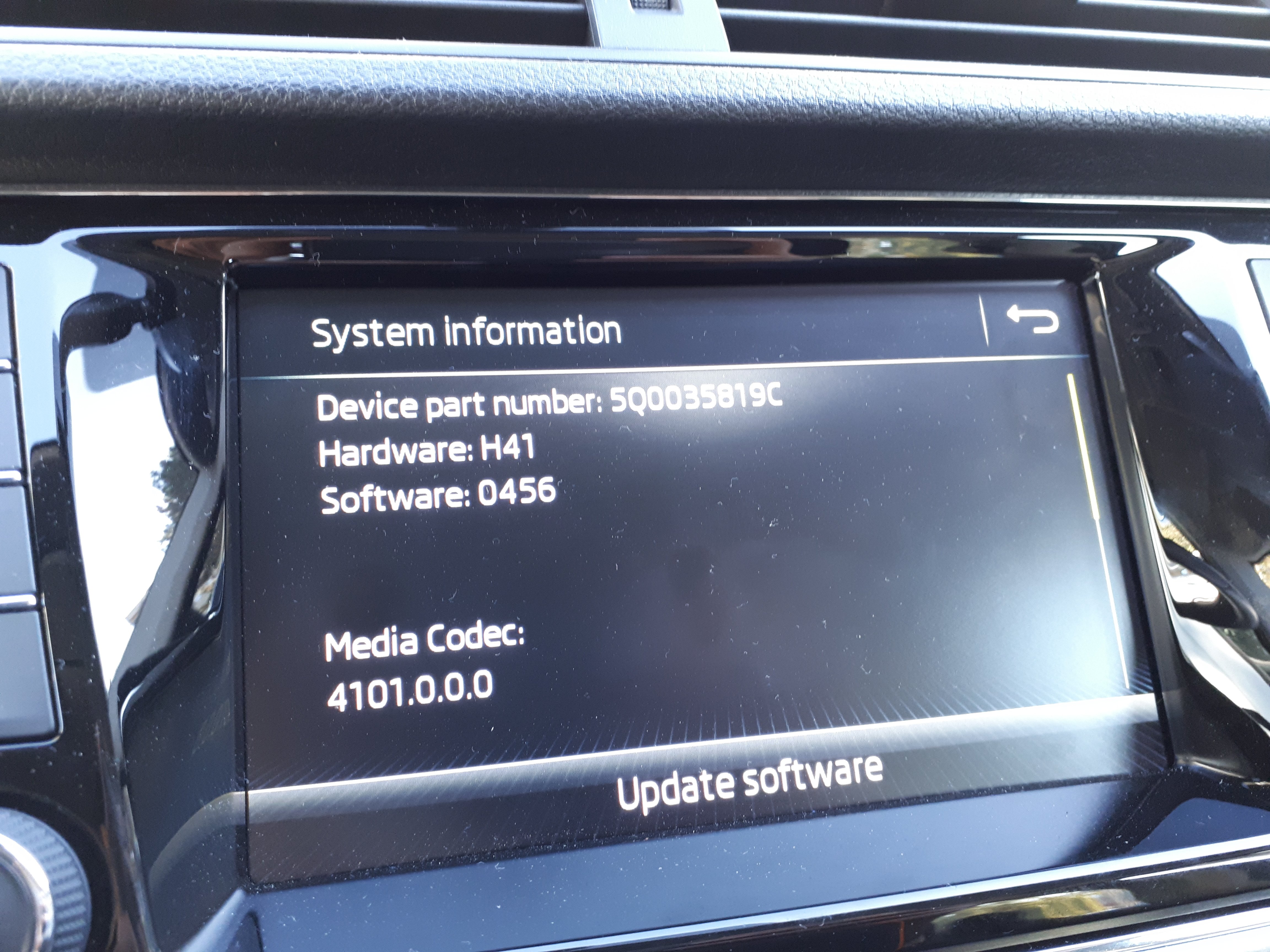

Is there any update available for hardware H41? My current software version is 0456.
The car is a 2017 Skoda Fabia mk3, in Romania (left hand drive), and the head unit is a Bolero.
One minor annoyance I have with it is that I purchased the car without paying for the SmartLink option, however SmartLink shows up is in the menu.
When I select SmartLink, it shows the message "Starting Smartlink..." but it never starts up.

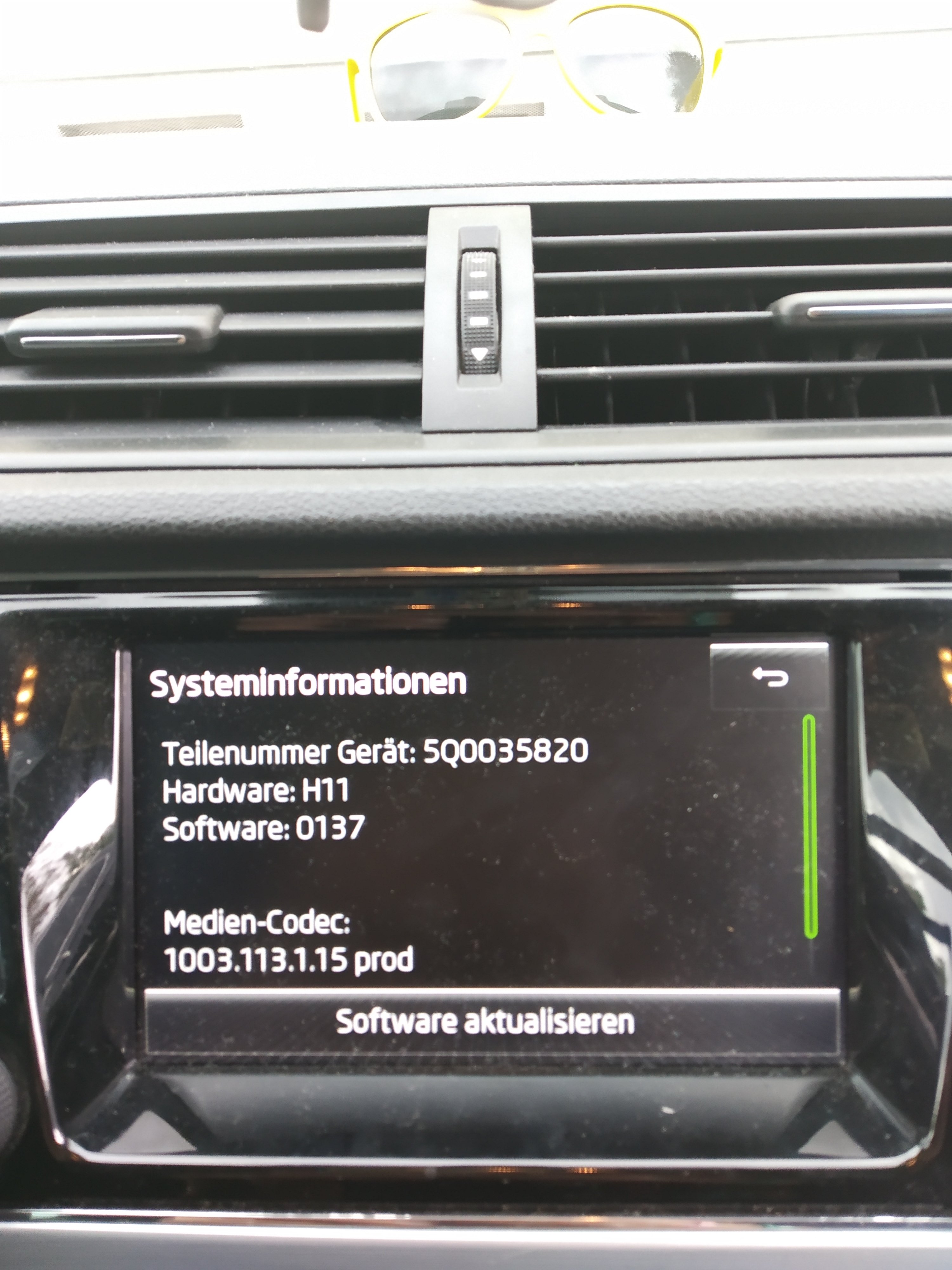

Hi all please can someone help me. I need smartlink or android auto
device part no. 5Q0035820
hardware H11
software 013
media codec 1003.113.1.15 prod
PLEASE PLEASE HELP
Check your PM

Unit replacement required 😞
Unit linked to vin. I have bought a new one but won’t work because it’s not linked to my car. Went to Skoda and they say you can’t change unit
