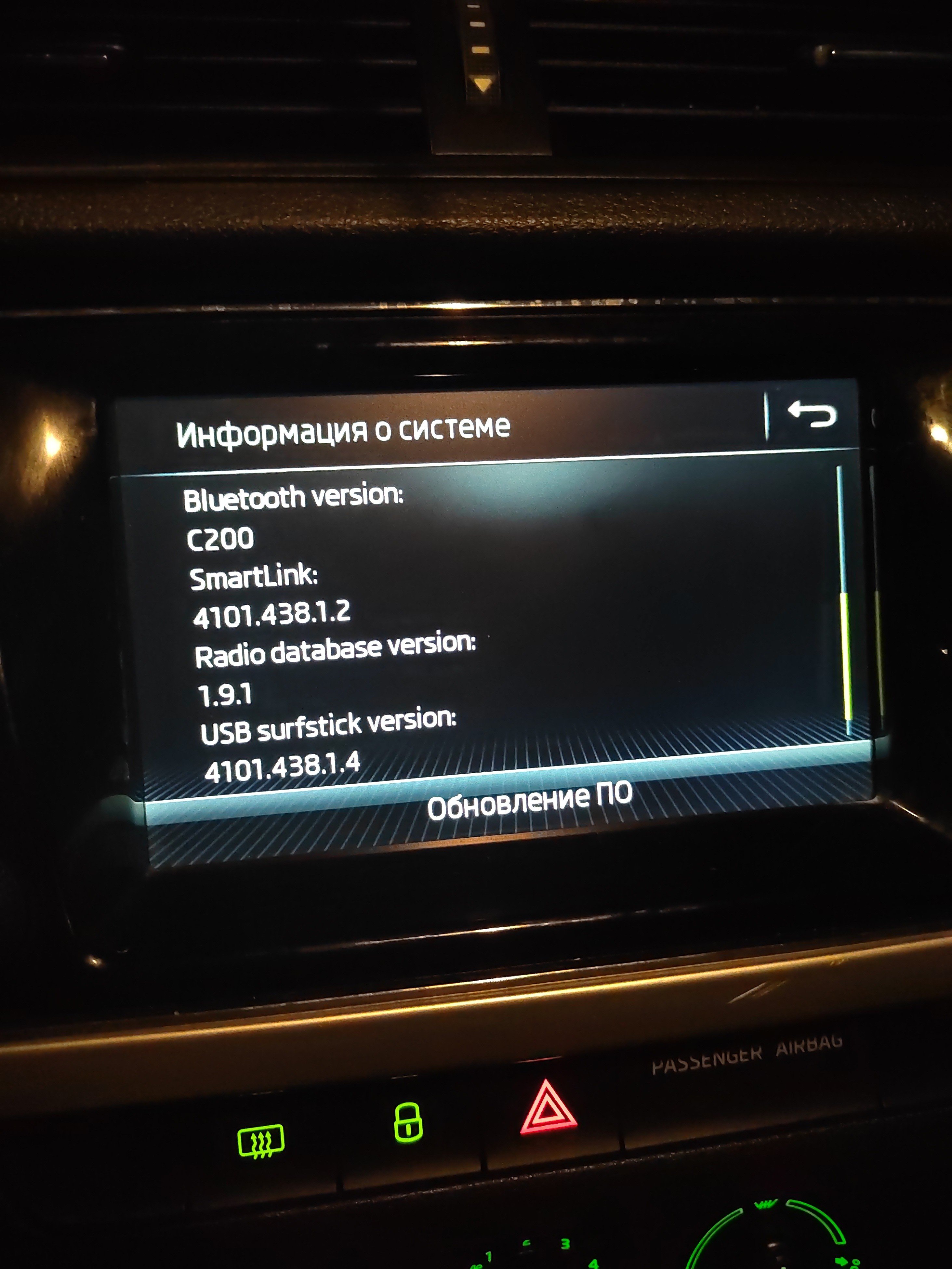

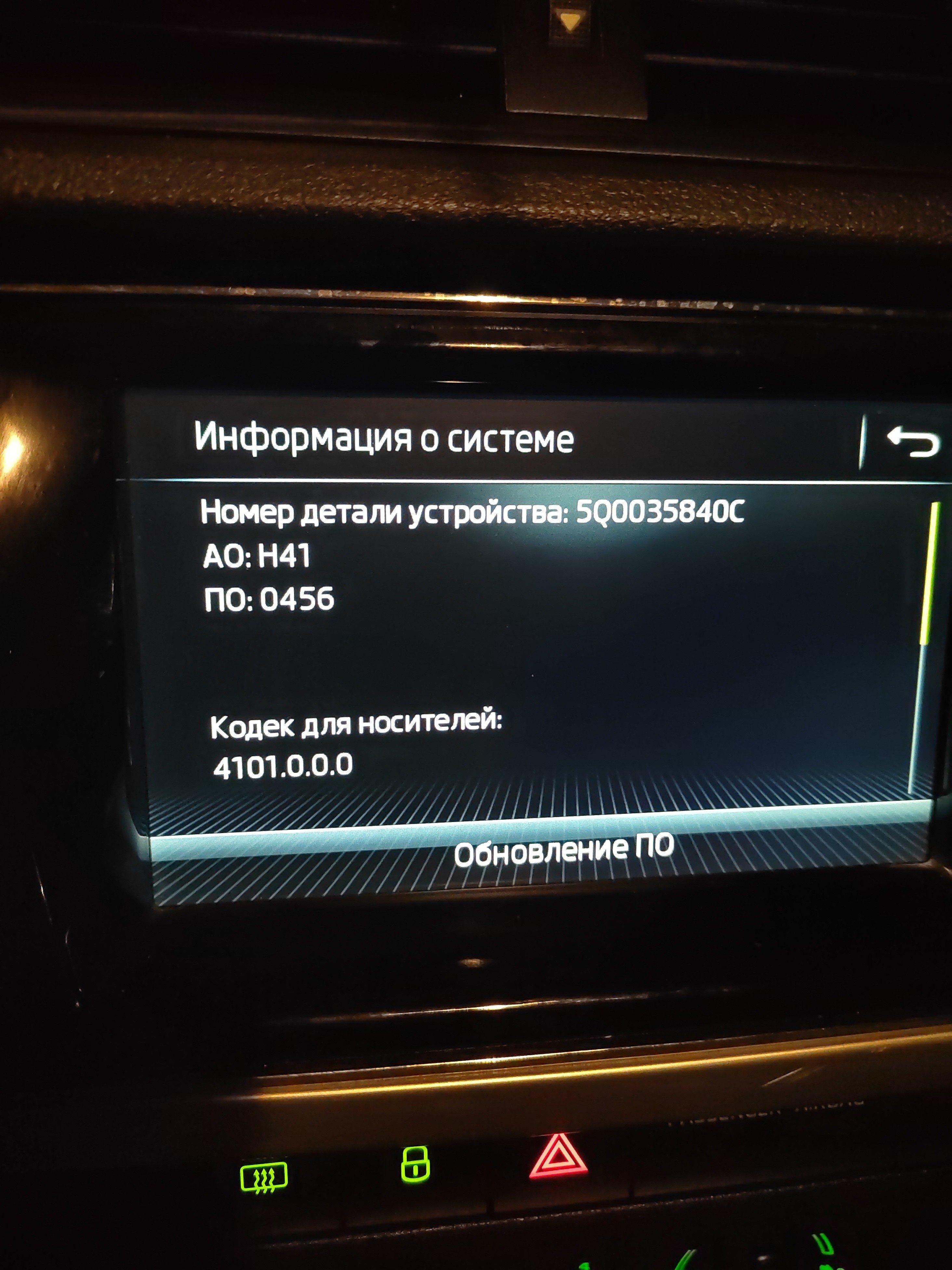

Hello! I have 5q0035840C
H41
Sw: 0456
Does anybody has updates?
I've got issue disconnecting android auto. Sometimes it's happen when USB cable slightly moved inside the socket.

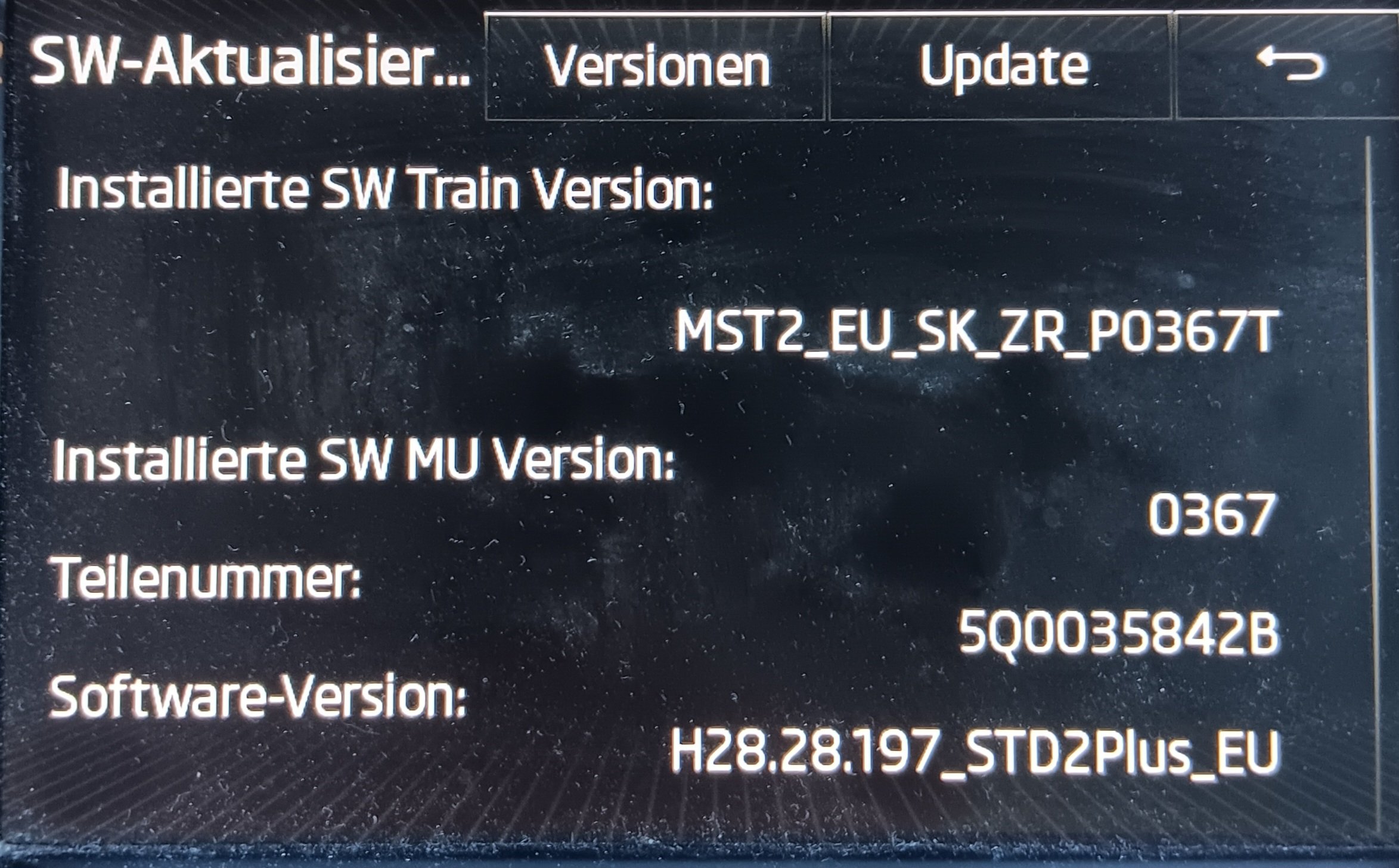

Thank you very much pab567!

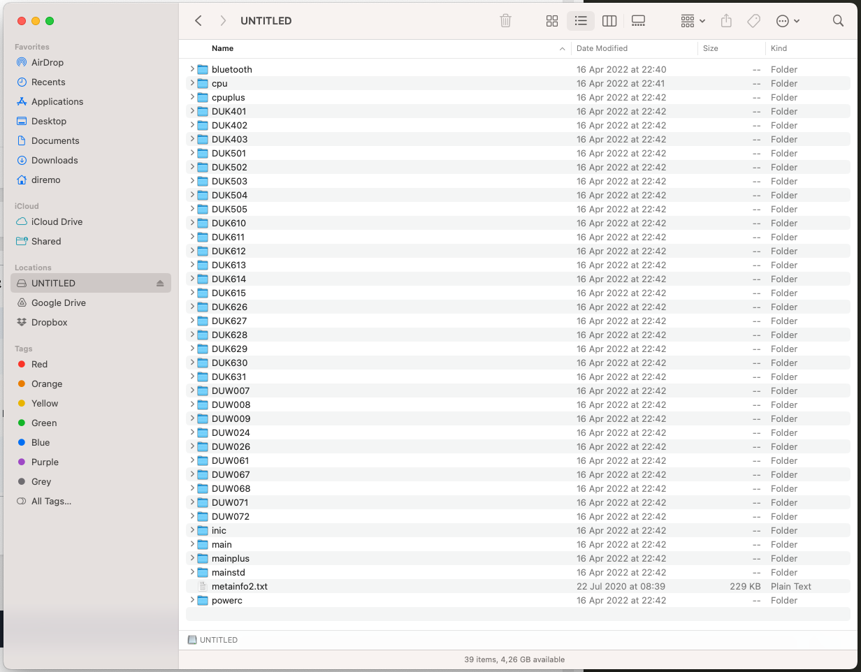

But I can not get the system to detect the firmware. I tried 3 different USB memory sticks. 8GB, 16GB and 128GB. I formatted them on Windows and on Mac as FAT32. I unpacked and placed the content in root on the drive. I tried updating from the Menu > Settings > System menu but also by holding the Menu button for 5 seconds. Bolero does detect the USB stick but absolutely not the firmware. The "select source" menu is all greyed out - CD ROM, USB Memory and SD Card. It's a Skoda Fabia so there is no CDROM or SD Card.. just a USB connection. I have updated this Bolero once before in 2020. It worked fine back then. Before it was on version 353 and I updated to 367. The update that I can't get to work is the 369. Is there a bug in 367 that prevents from detecting firmware on USB?
Of course there is SD slot, it is located inside the glove box. Look into your car manual. Basically do not use USB but SD and follow the procedure:
1. format SD (max 32GB) under FAT32
2. unpack to root (metainfo2.txt and all the folders must be placed directly on SD, not in any folder)
3. insert SD card into the slot
4. enter Service Menu (long press MENU button)

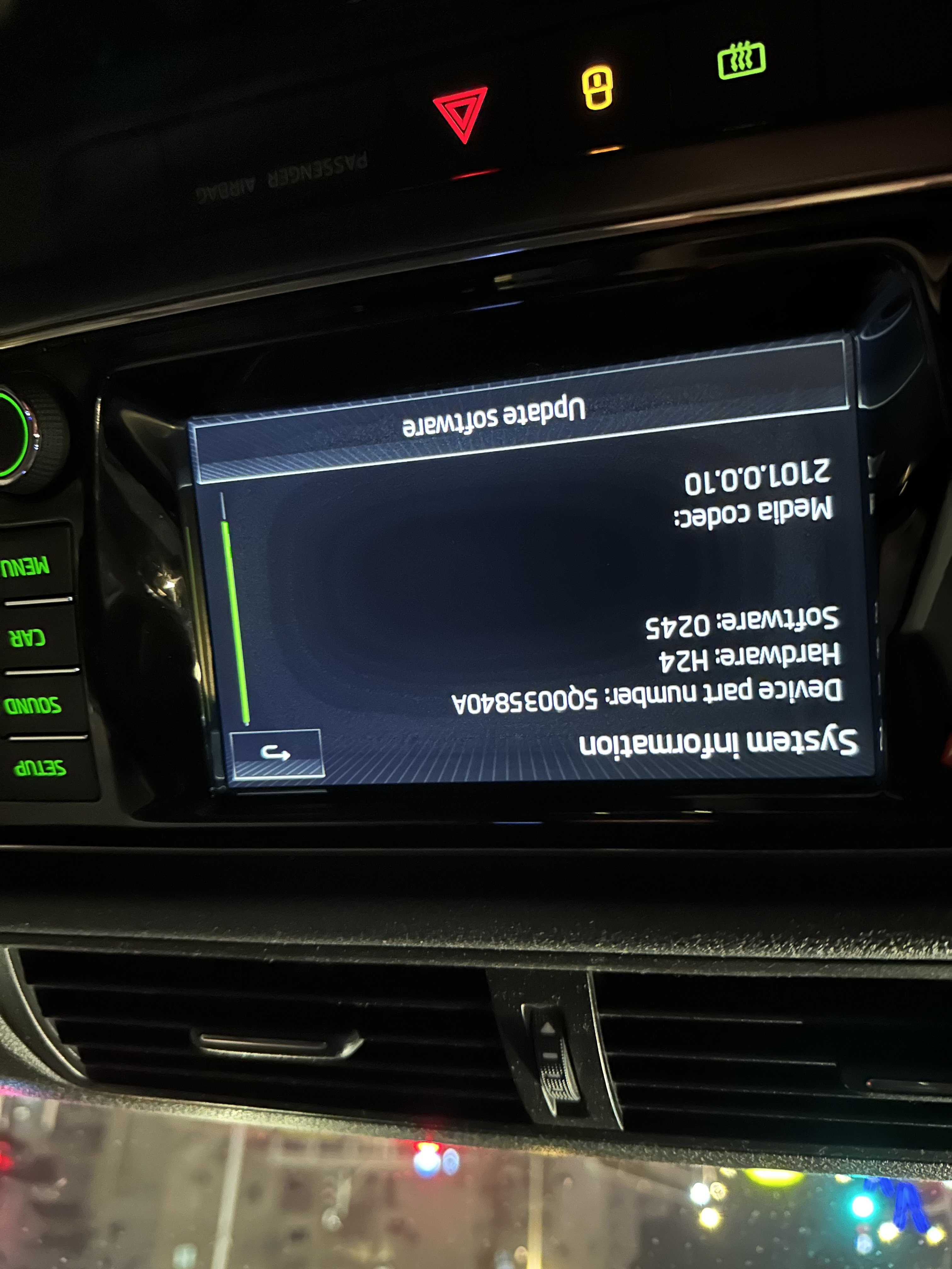

Hello, I got a Skoda fabia 2016, do I need to upgrade my system?
Thanks.
No clue why the picture is upside down, tried to rotate and it still uploads it that way.

Thank you! I found the SD card slot and the update went fine!

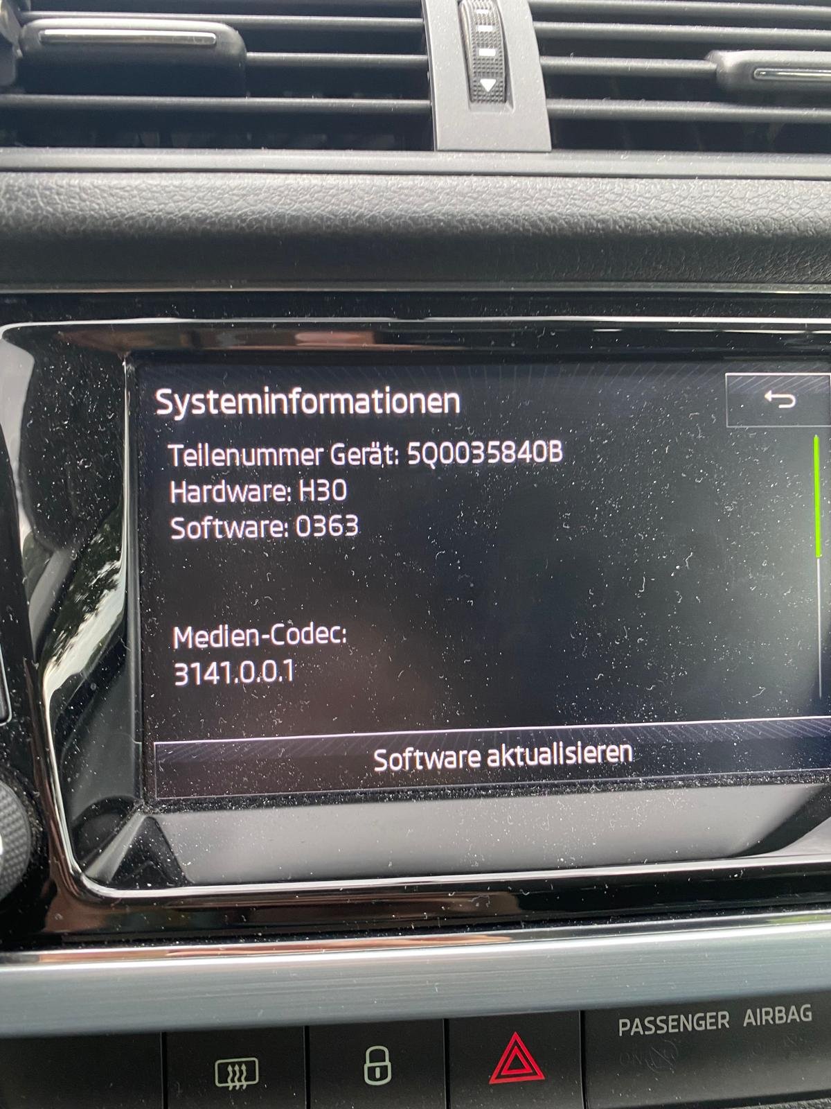

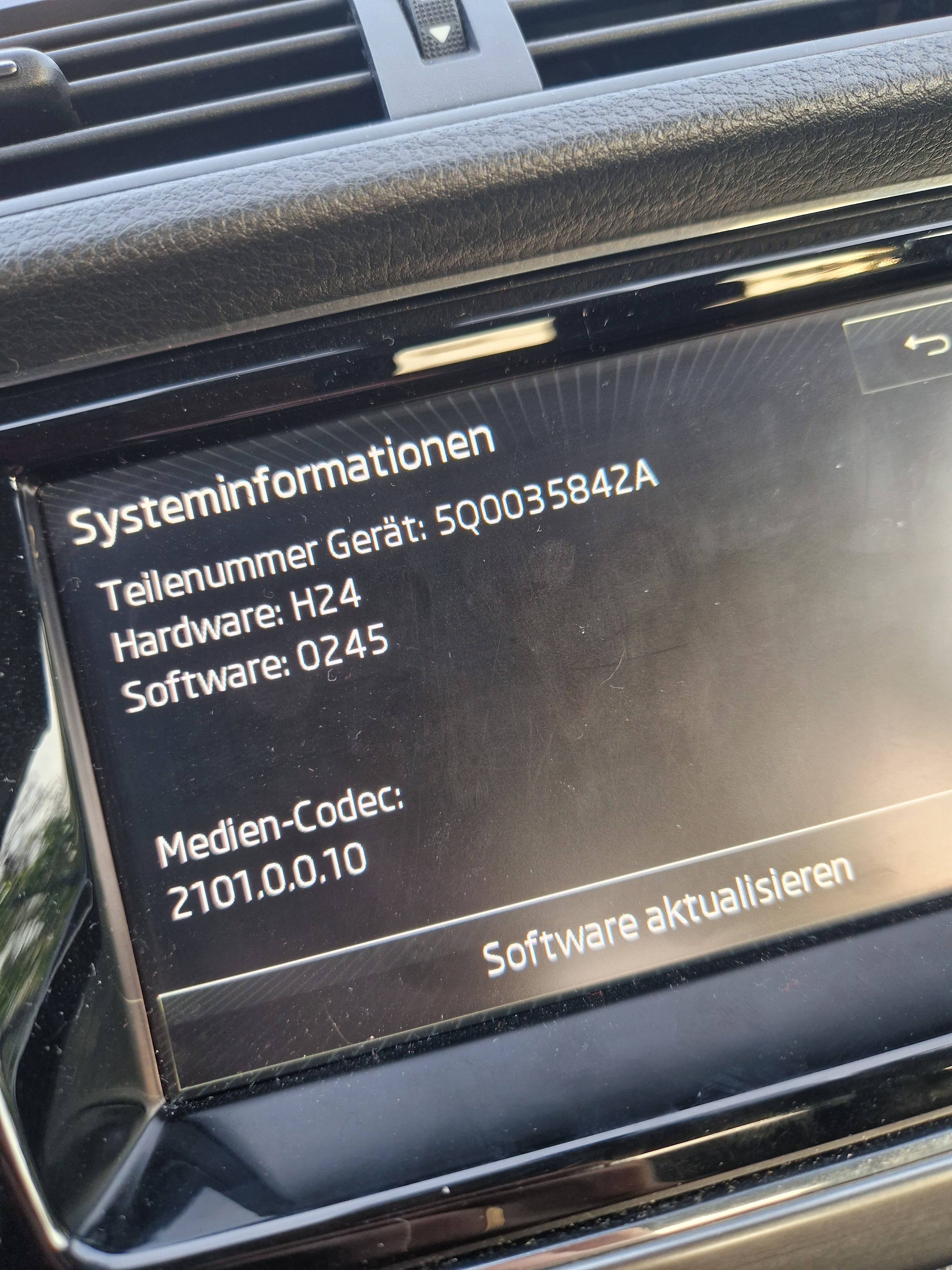

Hello,
i need a Update for my Fabia 3 (2015)
Current information:
Device number: 5Q0035840A
Hardware: H24
Software: 0241
Media code: 2101.0.0.8
Can someone send me a Updatefile or Link
Thanks a lot
Greetings

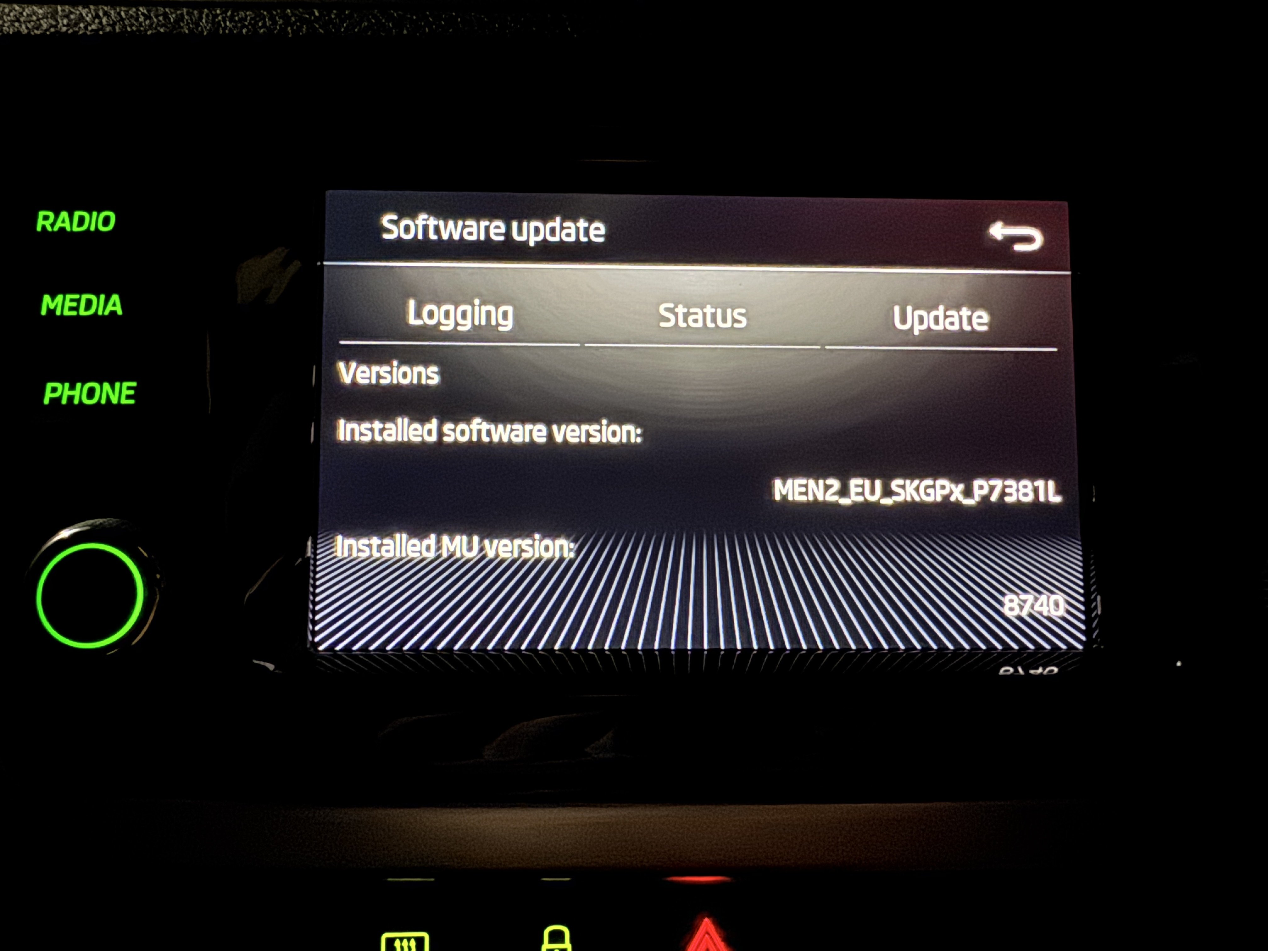

@pab567 hey! My software is on 8740, I’ve been told that 8742 is no longer available and that I need 8755, do you have the link for this please? My CarPlay constantly skips and pauses and I’ve not been able to use it since I bought my car! I’ve attached a photo of my system software, 2018 fabia colour edition IMG_3633.jpeg
Check your PMs for download link

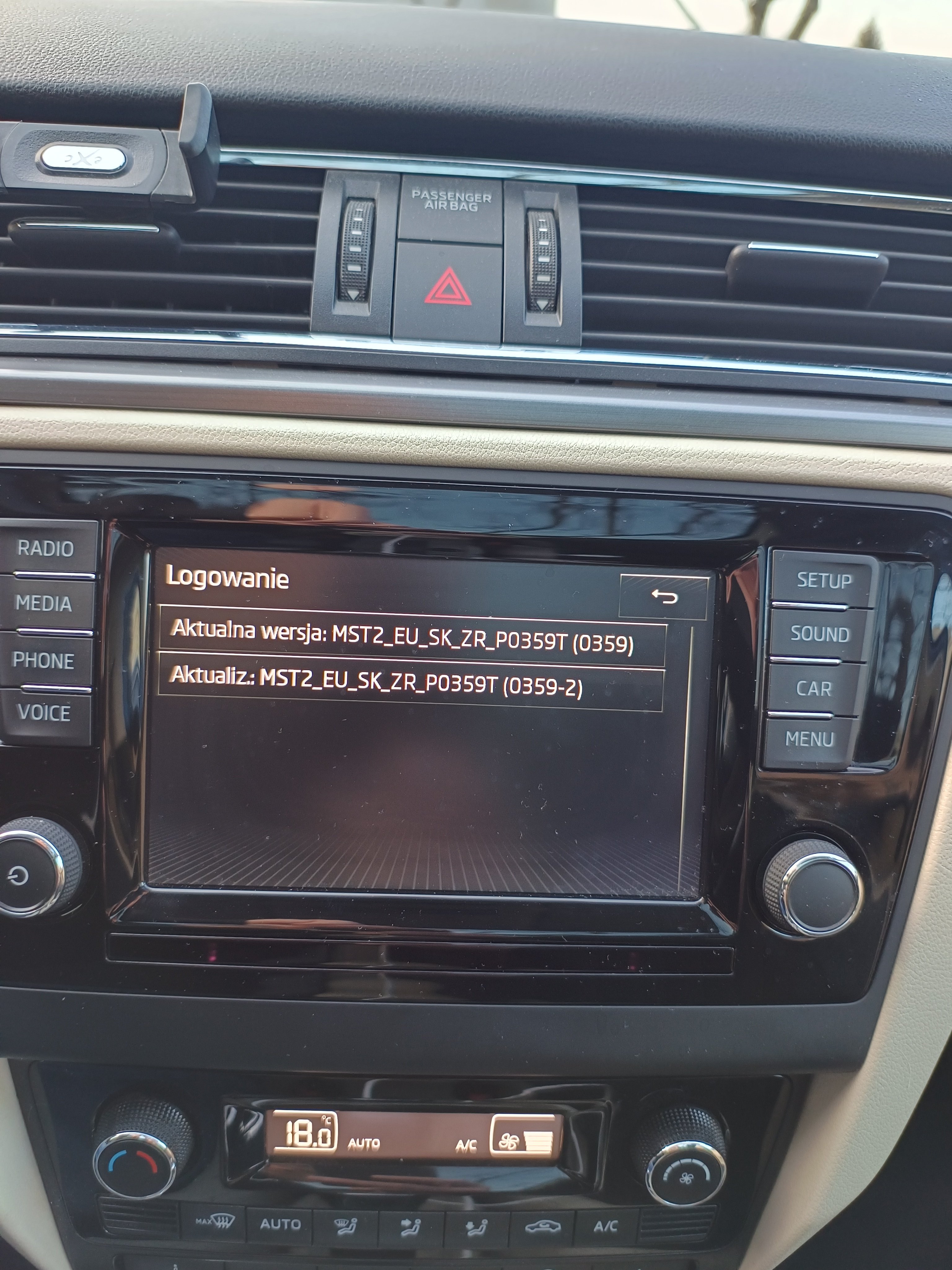

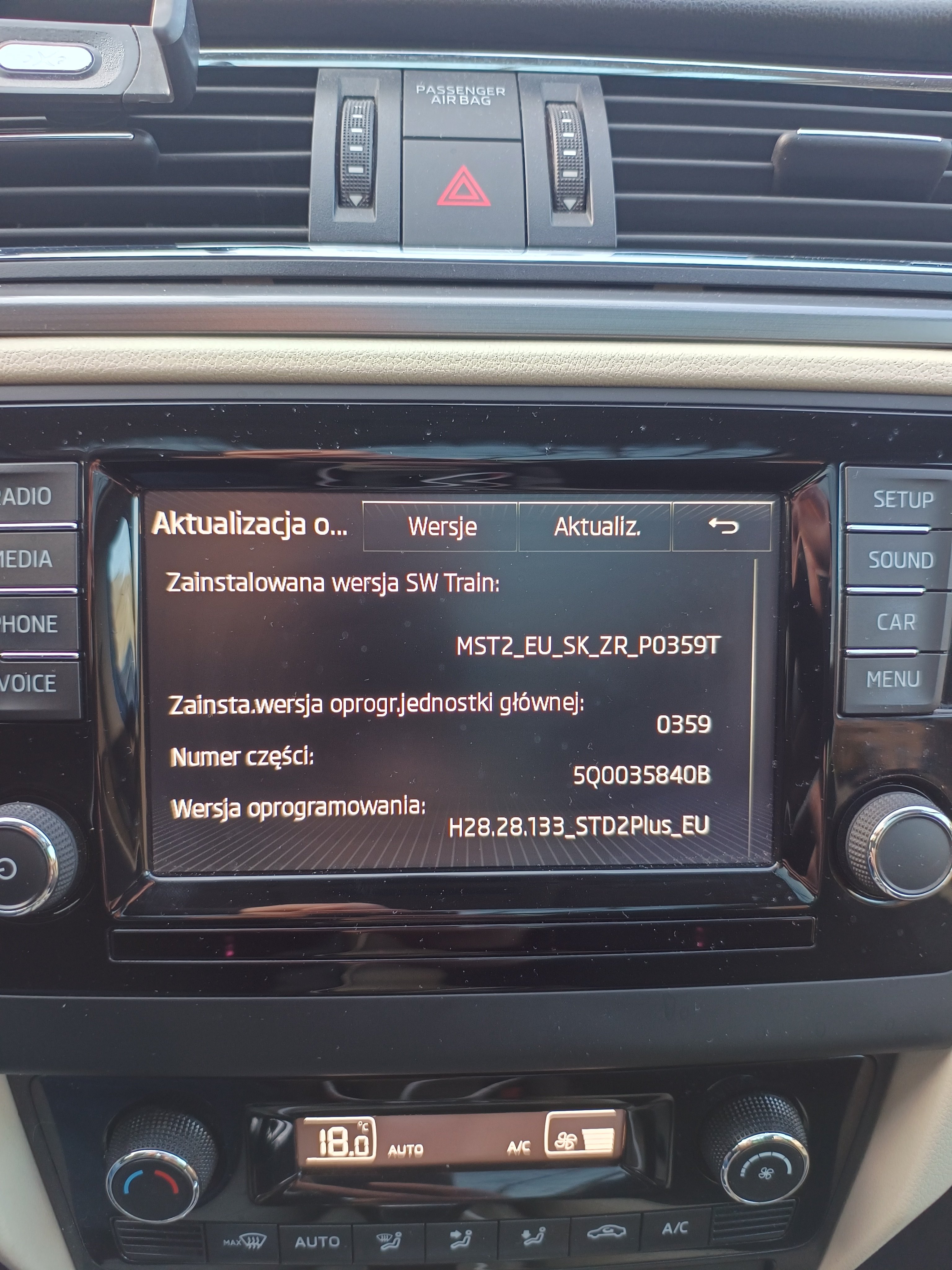

Hi @pab567 , i have this version.
Do you have an upgrade?
The system crash every day ☹️
Thank you
There is no newer version for your firmware. How does it crash?
Some days it's all ok, other days it doesn't work. The dispay turn on, on the Skoda logo but don't start. Even if I wait several minutes. When the system doesn't work, also the usb doesn't work (don't charge telephon or other.. No electricity comes out)..
This doesn't look good - intermittent failures are the nightmare for analysis and finding the root cause. Having a log could help but for this you need PC connected with UART to the unit when it fails.
