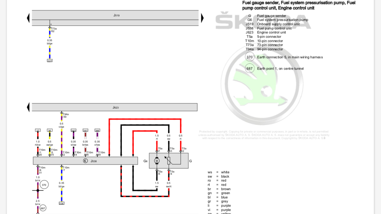

Hi guys, so I’ve been going over the wiring diagrams over the last couple of nights. I’m hoping someone might be able to help me with the one thing I’m stuck on.
On the Mk2 2010 onwards the fuel pump and gauge goes to a fuel pump control unit which for the life of me I can’t find in zap7 or anywhere else.
Can anyone tell me where it would be or point me to a part number? Or if I’m being dense explain it to me lol

Physically, located on top of tank. I quote:
1.21 Fuel pump control unit -J538-
1.21.1 Fitting location:
Under the right rear bench seat, on the fuel delivery unit
All the fitting locations are right at the end of the wiring pdfs.
In 7zap/ETKA, electrical section, searched the word fuel, got this:
https://skoda.7zap.com/en/cz/fabia/fab/2011-697/9/919-919030/
Well I just look thick as now especially since I looked at that several times last night haha
  • Sponsor
Ctrl-F is your friend. 🙂
It’s just a fancy relay really, not that much to it.
I thought it was basically a relay I just couldn’t find it last night and was starting to think it was built into the pump. 😰lol
So with this I believe the only wiring I need to address is to add two additional wires to the pre cat lamber sensor but I’ll probably just replace the MK1 connector with a MK2 and run the additional wires round the loom to keep it looking as original as possible.
Then the fuel pump I need to get the feed from the gauge before it goes to the fuel pressure control unit for the MK1 gauge cluster so the gauge still works, the existing wire will be okay for that. I’ll then need to run the wire to connect the pressure control unit to the ECU and the earth cable as well.
other than that I think I just need to check the fuse connections and earths and I don’t think there is actually going to be much more wiring to plan other than what wire goes to what pin on the ECU.
