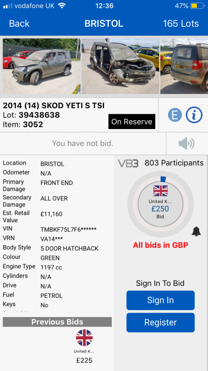

@RoottootemootThe entire car its up to £225 at the minute auction ends in around an hour but it’s for the entire think but it’s pretty badly damaged.

Obviously I wouldn’t want anything that heavily damaged but it still runs so yeah I don’t think £250 is bad lol.

Sorry when you mentioned a price i thought you meant a price and not what bids are at.
All the auction action will be in the last few minutes so there's no way that yeti is going for arfur monkey.
I would say that the 1.8T conversion is considerably easier since there are precedents and lots of help and instruction available, what you want to do is about the same level of effort and complexity as a 2.0 TFSI conversion using a different donor vehicle.
It ended at £250 no more bids were placed. That little blue bit on the circle was the equivalent of about 3 seconds when I took that picture.

It wasn't sold because it didn't meet the reserve, you may be bright but you haven't any experience which means your confidence dramatically exceeds your ability, please don't take that the wrong way, it's valuable advice freely given.

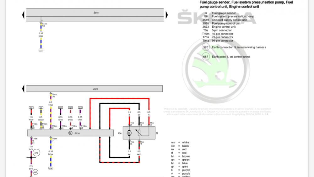

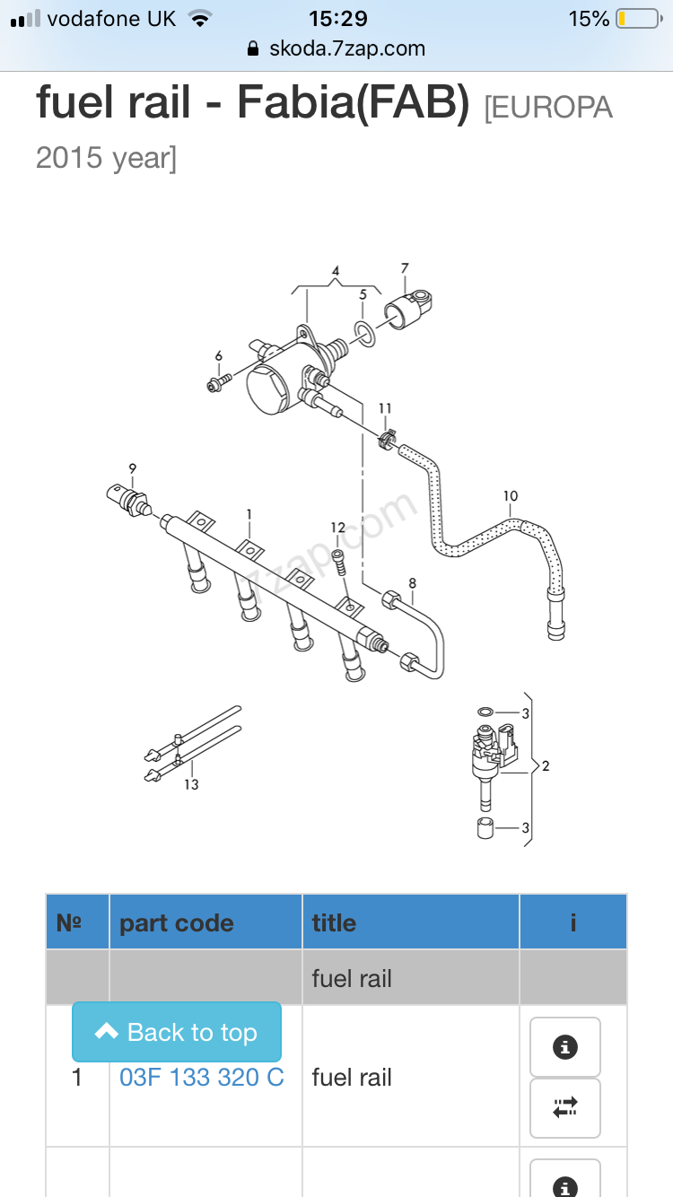

High pressure fuel pump and sender swap. - Sender/Gauge swapped and pump fitted inline with some fuel pipes needed modifying/adapting.
Slightly puzzled why you think you need to use a different fuel pump? The pump and gauge sender are one unit inside the tank.
On the schematics I’ve looked at on the CBZ there is a high pressure fuel pump in the engine bay aswell as the sender in the tank. Obviously if I’m wrong tell me lol.
4 being the fuel pump
